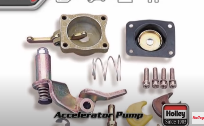

But the falling flat when you punch it sounds like a bad accelerator pump.  The diaphragms crack, I think.  Vague old memories.

Accelerator pump could be a possibility but you would think it would bog and then pick itself up. Just transition badly but it doesn't do that.

I'd start with making sure you've purged all old gas (just because it can't hurt), then look at the accelerator pump per Zed Head's advice.  Check to make sure you're getting good squirts in both primaries when you pull on the accelerator rod.  Even with a good diaphragm, I find that the passenger side accelerator pump orifice in my 4bbl Holley sometimes gets plugged, especially after sitting all winter (and I run Stabil every fall).  I've had to clean out the orifice with a needle in the past when I couldn't get it to flush out on its own.

I would agree with your expectation if it was an accelerator pump issue. Even with no accelerator pump at all, you should be able to nurse it to WOT and full load. And even if you didn't nurse it, I think it would bog bad, then catch and scream.
