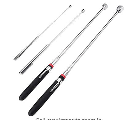

July 14, 20214 yr comment_625011 A magnetic part picker might help. Edited July 14, 20214 yr by Zed Head Link to comment https://www.classiczcars.com/forums/topic/65590-shifter-pin-irritating/#findComment-625011 Share on other sites More sharing options...
