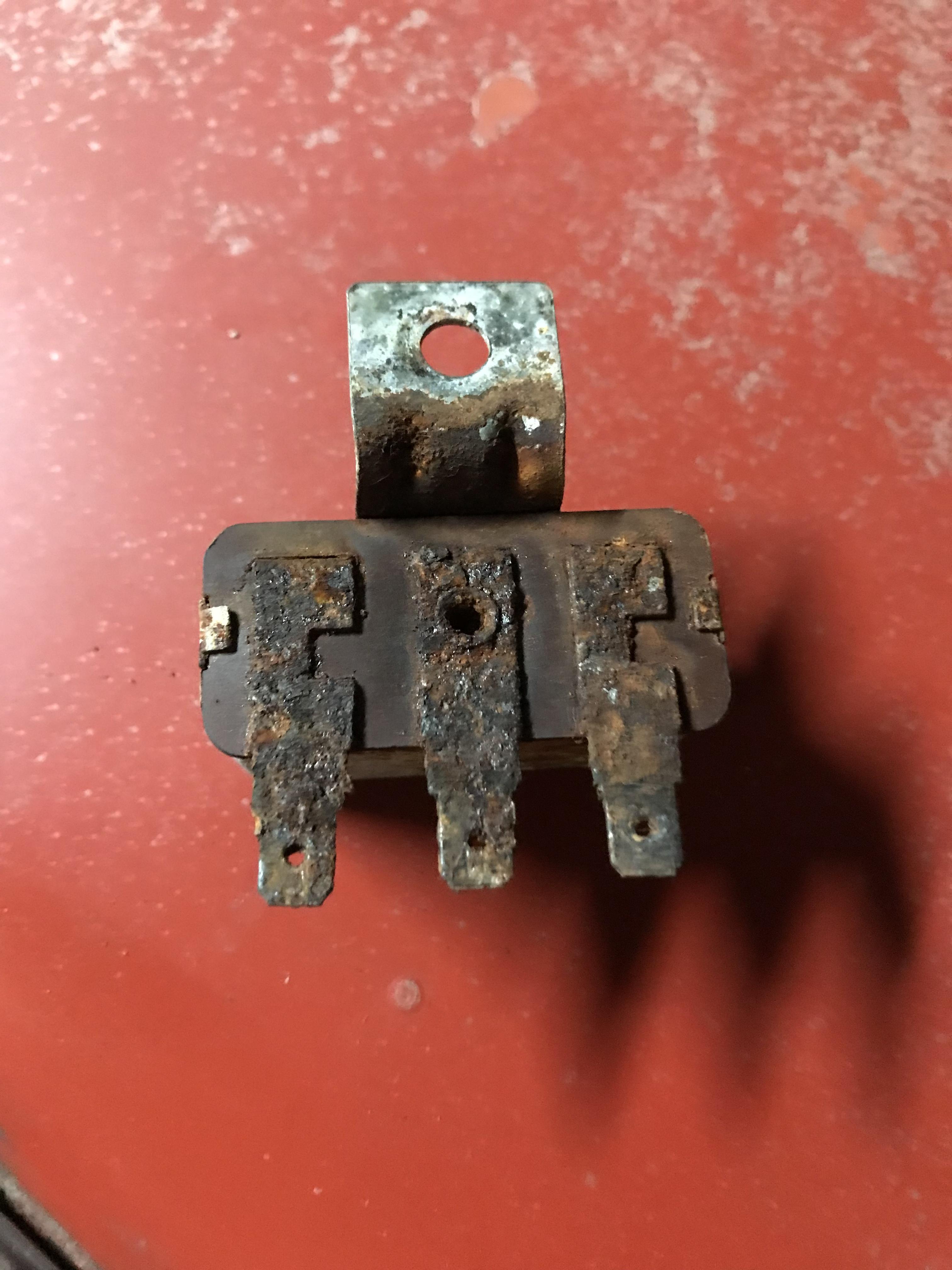

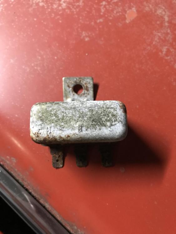

Ok.  Took my tester and touched green light at c6. Got power.  Then thought I needed the relay out.   I got it out !!! When I shake it it sounds like a pile of dust in there.  Here are some photos.   Good or no good??? And I now need to clean female spade connectors.  Do I use contact cleaner???
No, it was No Good.  I had a spare.
Your relay is a typical 4 pin relay (two of the pins in yours are connected, that's why you only have three terminals).  You can buy them for a few dollars at any auto parts store.

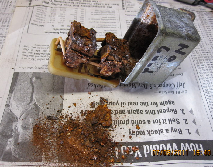

It sounds like its likely a relay problem as Zed H pointed out. Did you get the relay open yet?
Zed H: Any idea how a relay can get so corroded? How bad were the rest of the relays in that relay panel?
