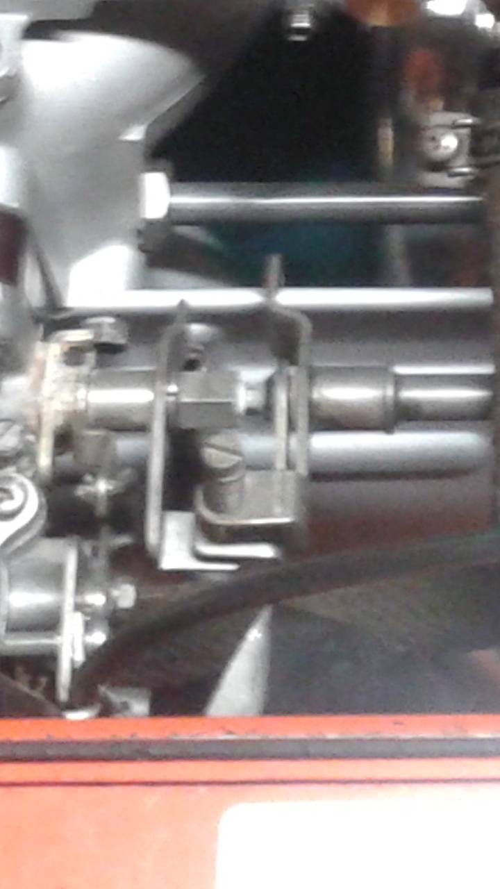

Make sure these flats are in the right order. I put mine back on wrong and it shot up to 2 or 3 thousand rpms.Screenshot_20210501-174022_Gallery.jpg
