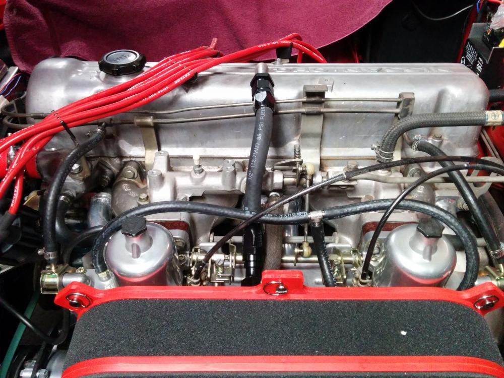

I drilled holes in the back panel of the K&N set up and stuffed the hoses in there. Make them slightly small and the hose will seal them up.
Well that’s an easy solution!  Why didn’t I think of that...  sometimes I tend to overthink things. Thanks @Terrapin Z

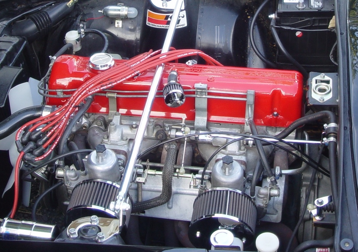

I just run a separate small k&N off the valve cover breather. I suppose if you have a lot of pressure in the engine it could get messy. Mine does not.
It is quite a bit bigger than the carb overflows. I am not sure if there is enough room to stuff it in the back of the K&N plates.
My carb overflows circle around under the carbs, back to the k&N's

I ran these for a while and had room for both carb vents and vent from valve cover which overall maybe a little cleaner by reburning the crank fumes.
Now I've switched again, but still have all hoses connected.
I didn't like the idea of running hoses from the float bowl vent to the air filters. As long as it's just fumes coming out that's fine but in some cases fuel can come out. Especially bad if you have headers. So I ran some clear yellow Tygon fuel line from both vents to the nozzles of couple of Sriracha bottles taped together where the windshield wiper fluid used to be. The caps with the nozzles need to be loose on the bottles or it won't work. So if there's overflow while driving or adjusting the floats no big deal. I've never gotten more than about 1/2 ounce of gas in the sriracha bottles.
If you car has been sitting awhile like mine was until this week it makes it easy to prime the bowls. It's way easier to pour a little gas down the Tygon lines than it is to try to get it down the vents.
For the cam cover vent I previously ran a hose from it with the open end between the K&N's. Using an ITB now. Haven't decided about that vent. Hope no bugs go in.
