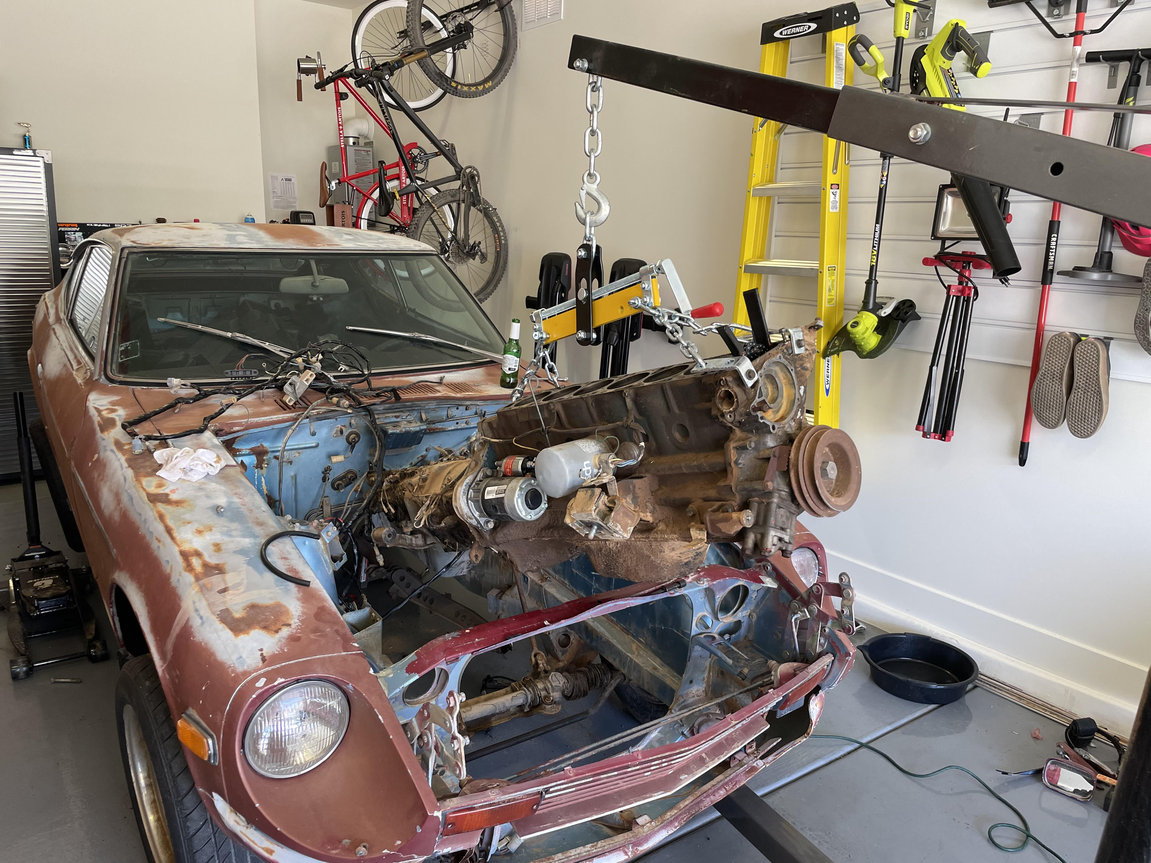

May 22, 20214 yr Author comment_621986 Bought a bunch o parts from Zcardepot to get the engine refresh going. They should arrive today. Also picked up an engine stand, hoist, and leveler. Preparing to pull the block tomorrow and trying to decide where to hook up the chains as my head is already off. I plan to use the driver side bell housing bolt then unsure for the front passenger side. Any recommendations since my head is already removed? Link to comment https://www.classiczcars.com/forums/topic/65237-barefootdans-280z-build/?&page=6#findComment-621986 Share on other sites More sharing options...
May 22, 20214 yr comment_621991 I have used the head bolt holes and old head bolts to pull the block out, never had a problem. Link to comment https://www.classiczcars.com/forums/topic/65237-barefootdans-280z-build/?&page=6#findComment-621991 Share on other sites More sharing options...
May 22, 20214 yr Author comment_621993 56 minutes ago, grannyknot said: I have used the head bolt holes and old head bolts to pull the block out, never had a problem. Oh DUH. I don’t know why that never crossed my mind. Thank you! Link to comment https://www.classiczcars.com/forums/topic/65237-barefootdans-280z-build/?&page=6#findComment-621993 Share on other sites More sharing options...

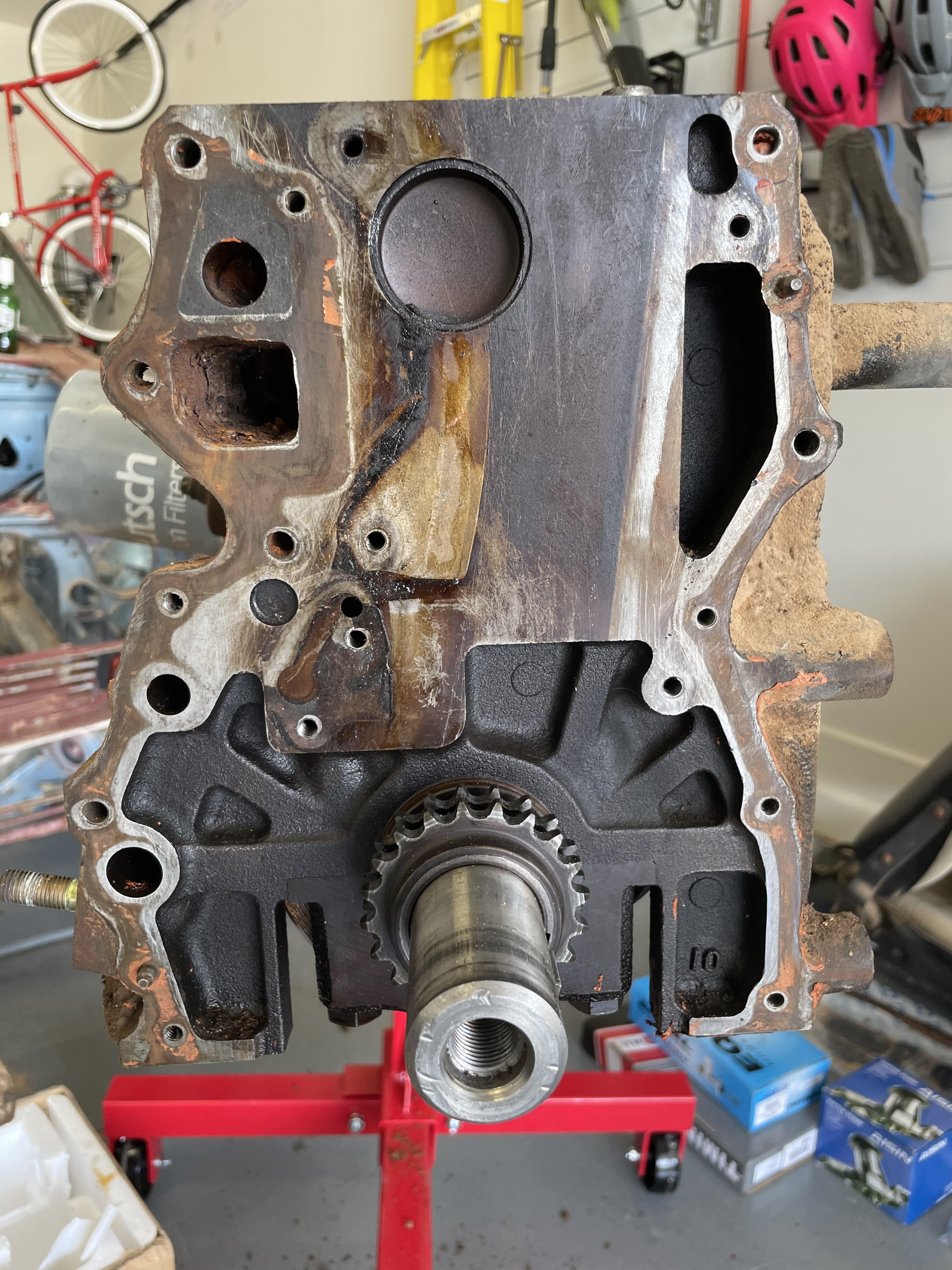

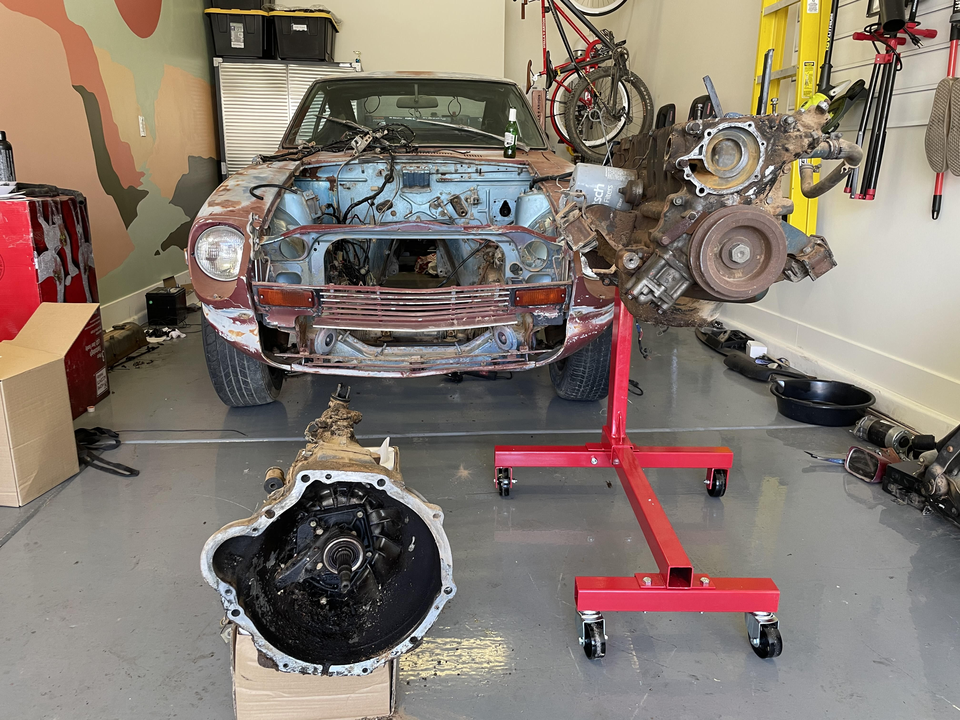

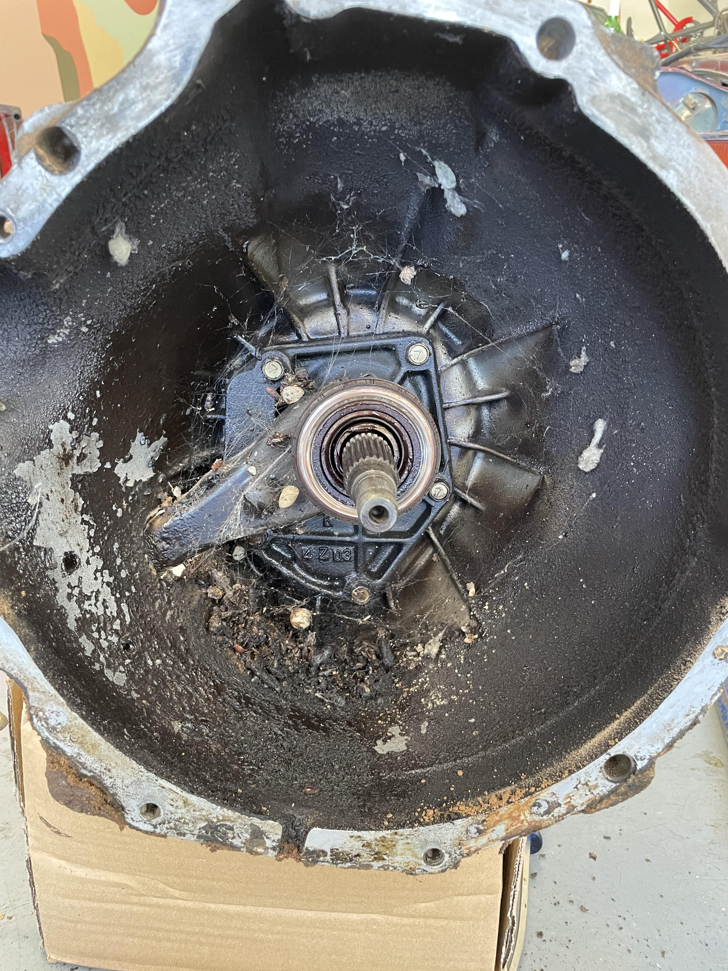

May 23, 20214 yr Author comment_622029 Big milestone for me today! My first engine removal. Took about 2 hours solo. Zero issues along the way which was awesome. No seized bolts, no rounded bolts, nothing broke! I ended up using two water pump bolts for the front as I didnt have a short enough bolt for the head bolt holes. I cant wait to start cleaning this up and refreshing. Check out the spider nest in the bell housing 😨 Link to comment https://www.classiczcars.com/forums/topic/65237-barefootdans-280z-build/?&page=6#findComment-622029 Share on other sites More sharing options...

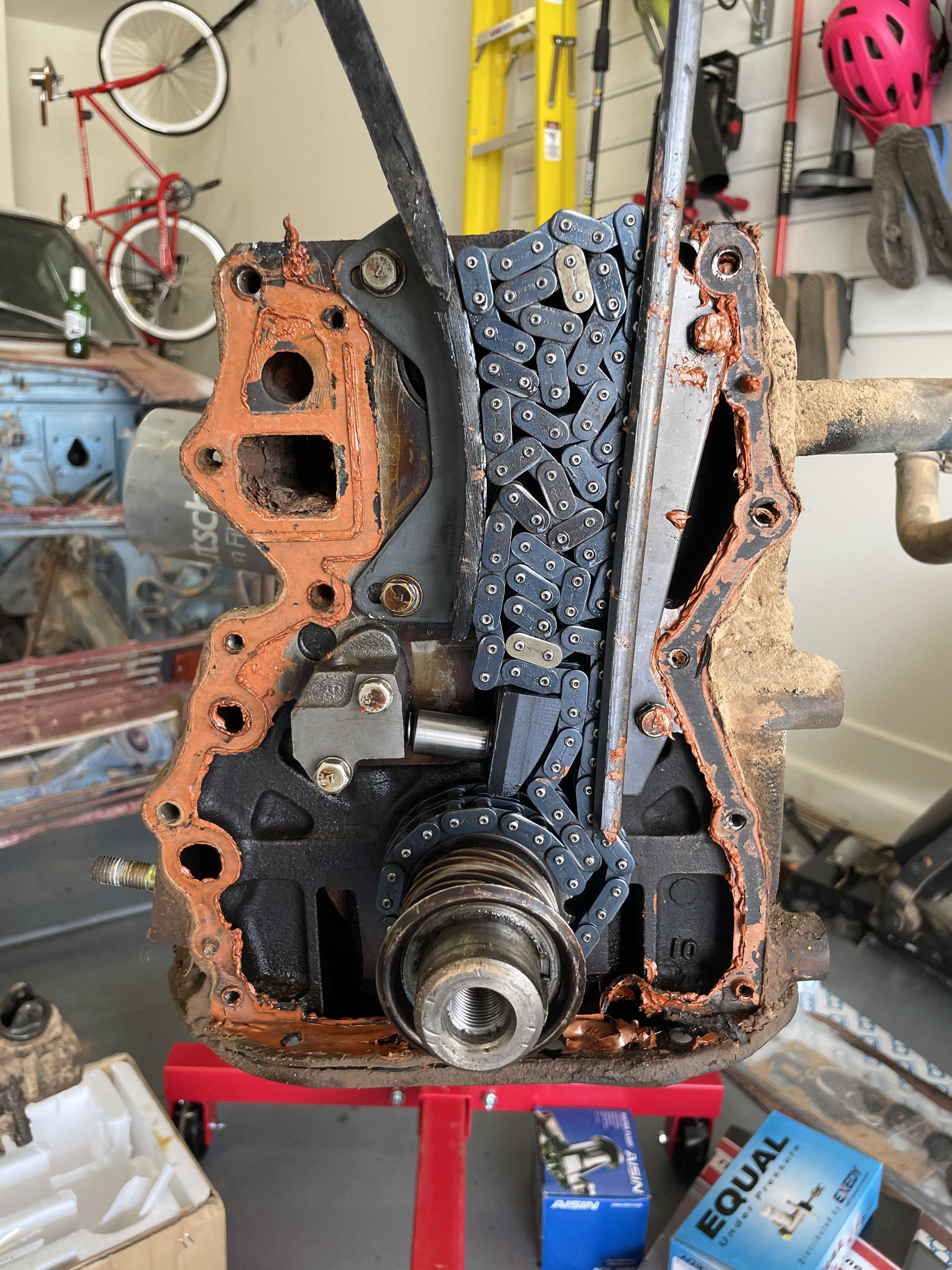

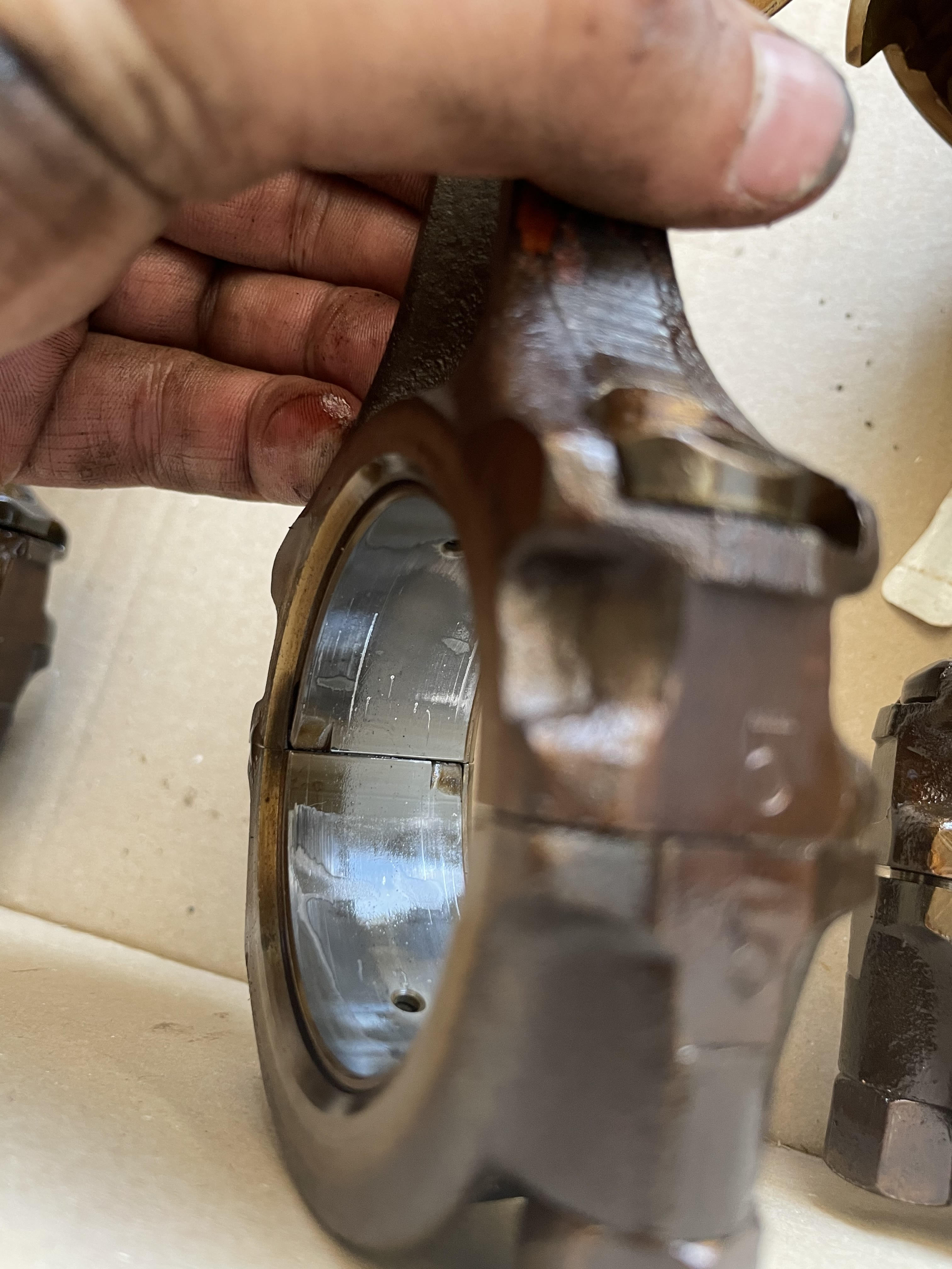

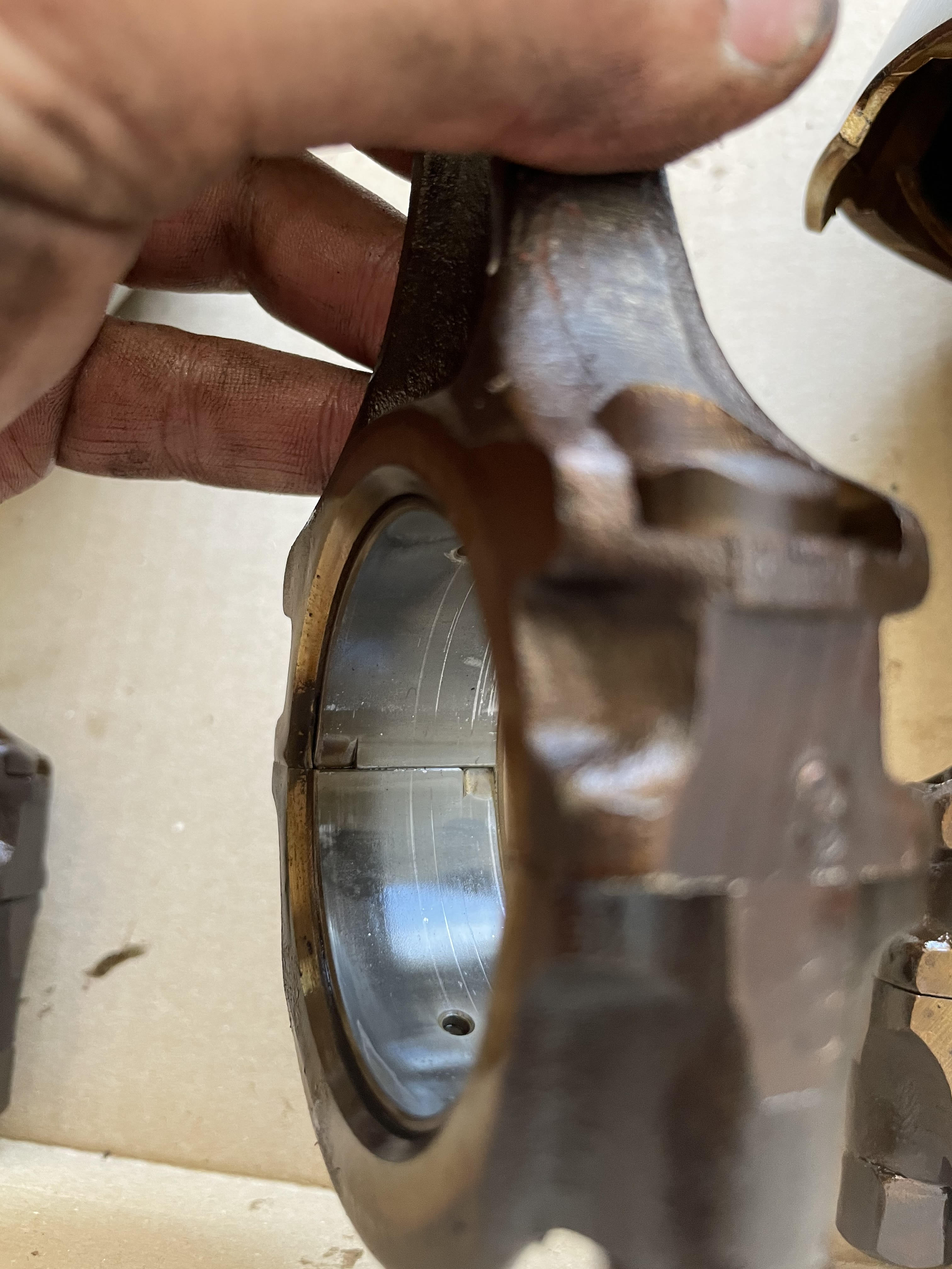

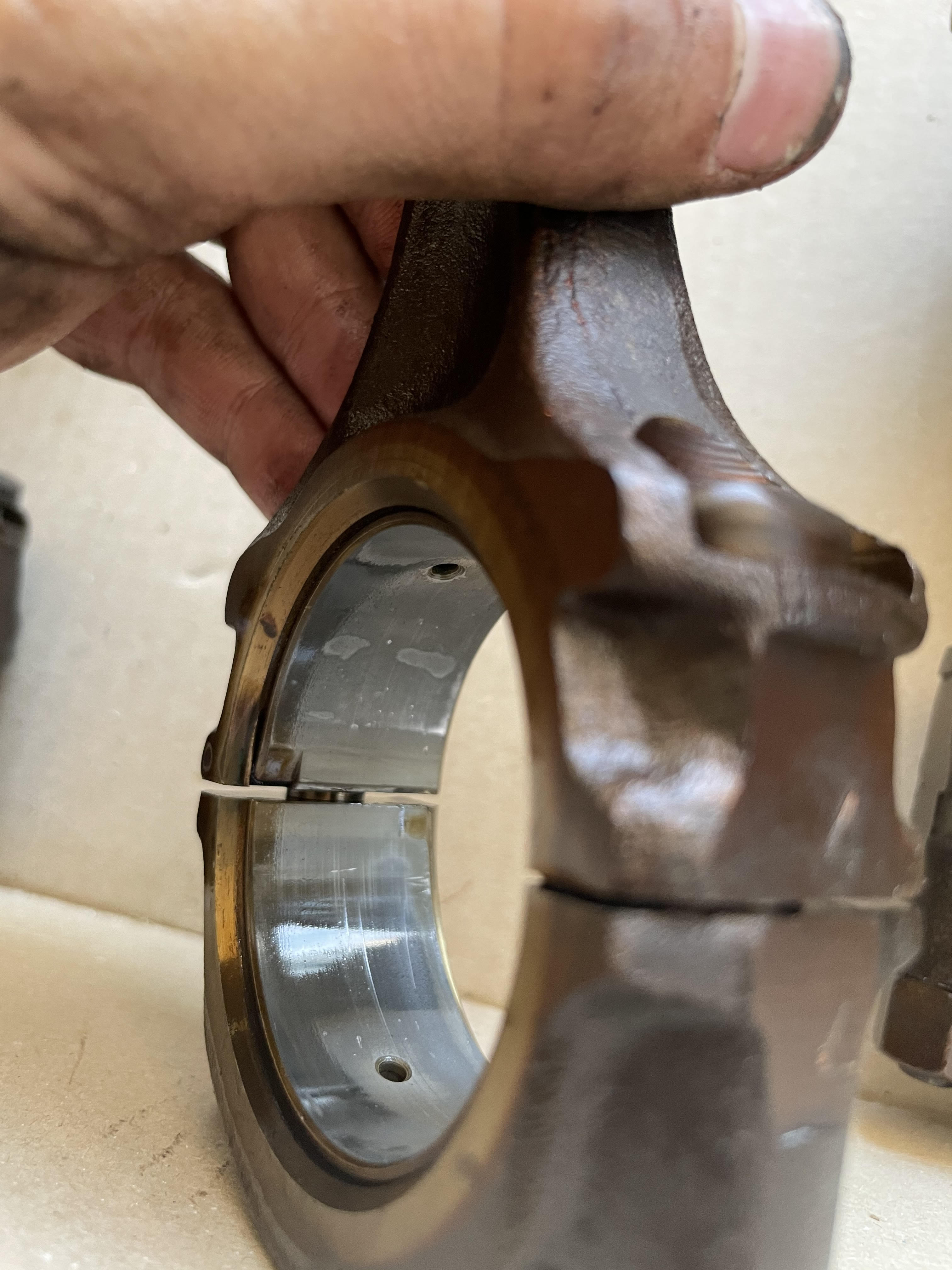

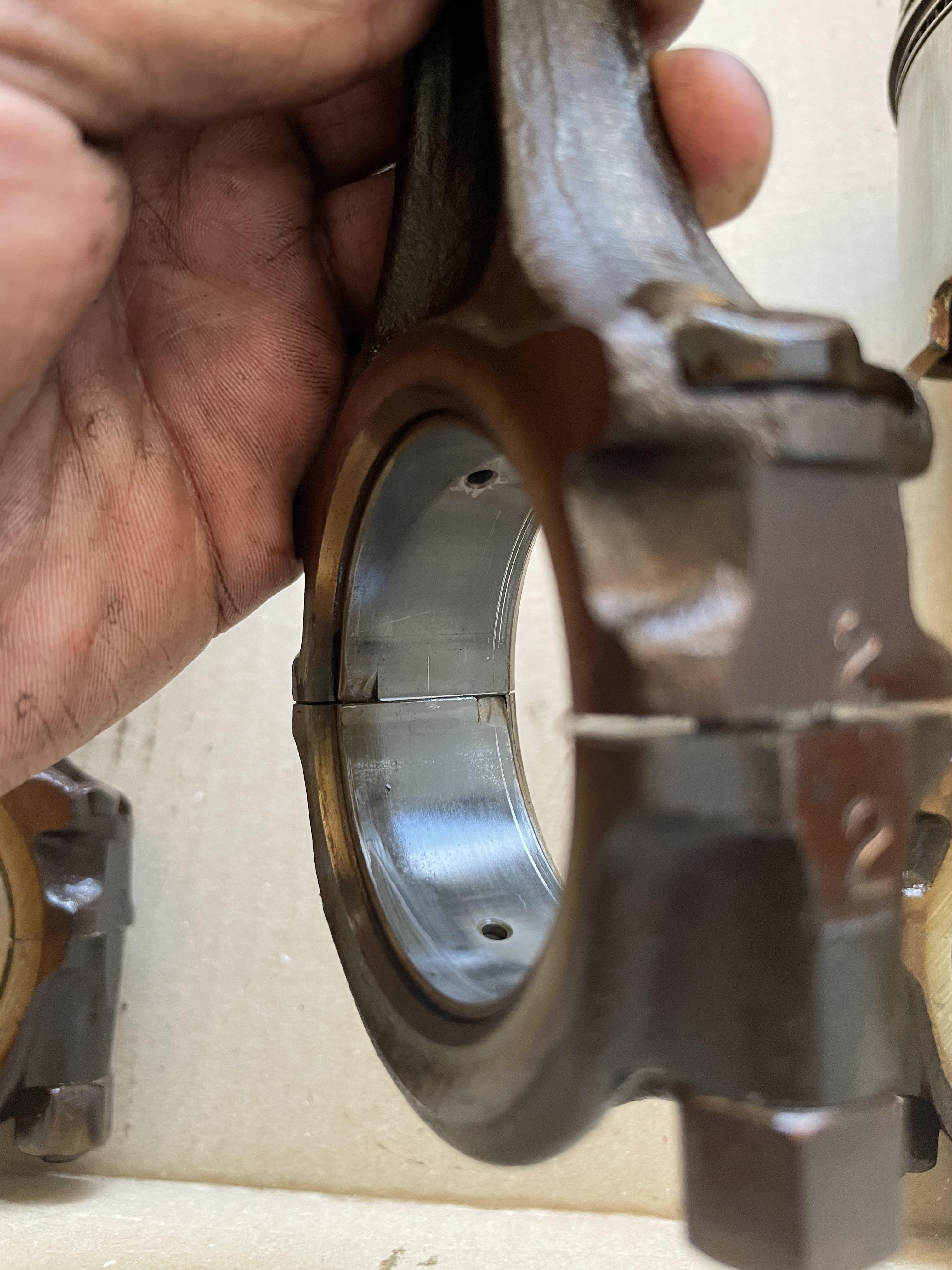

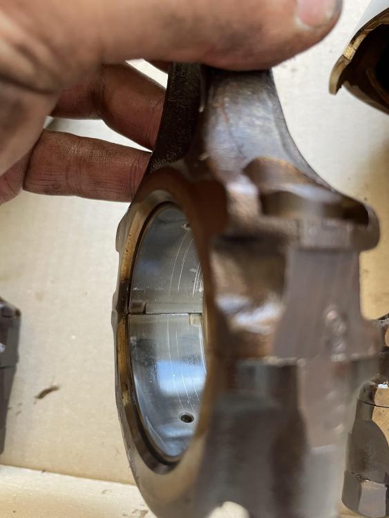

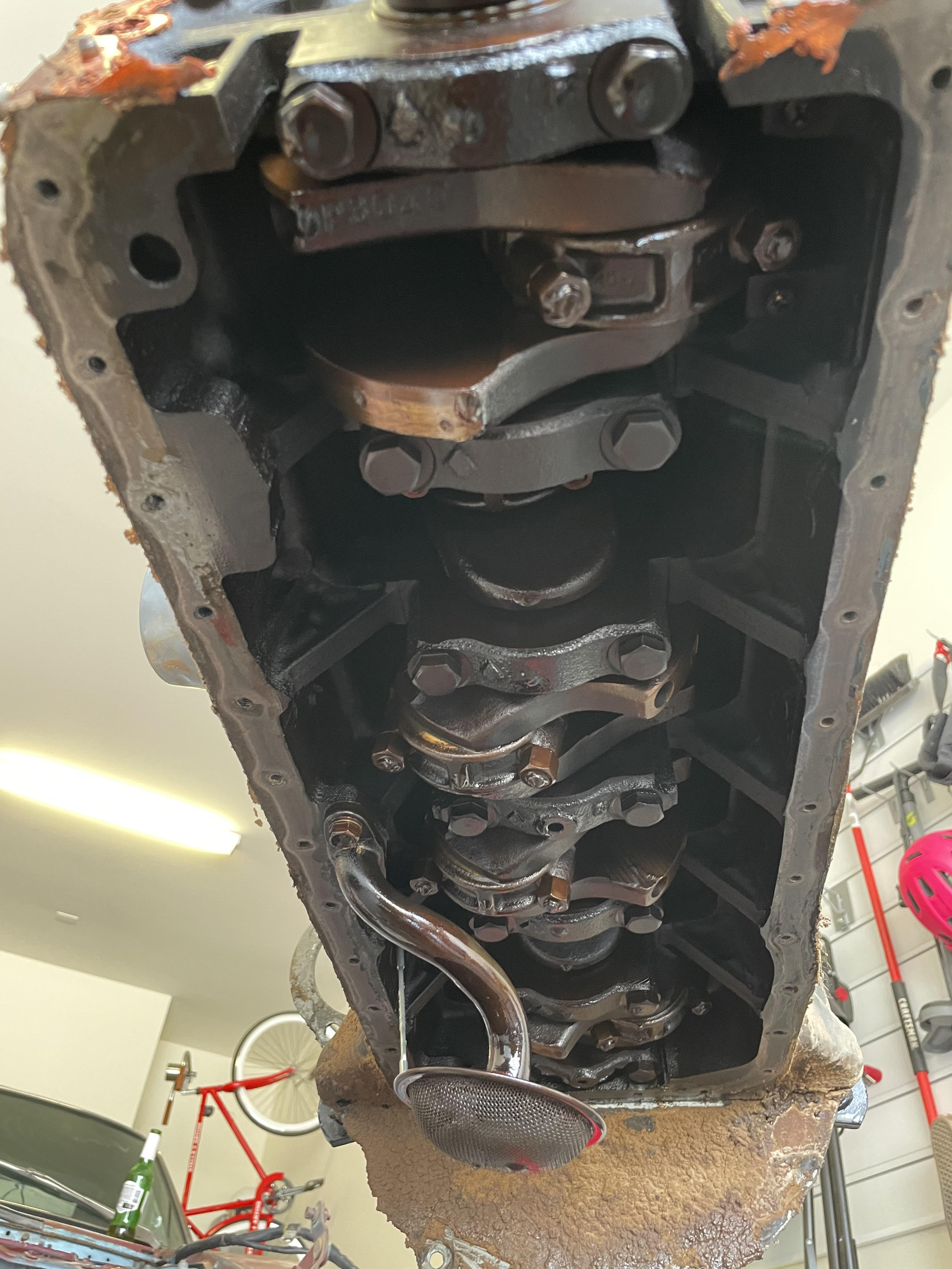

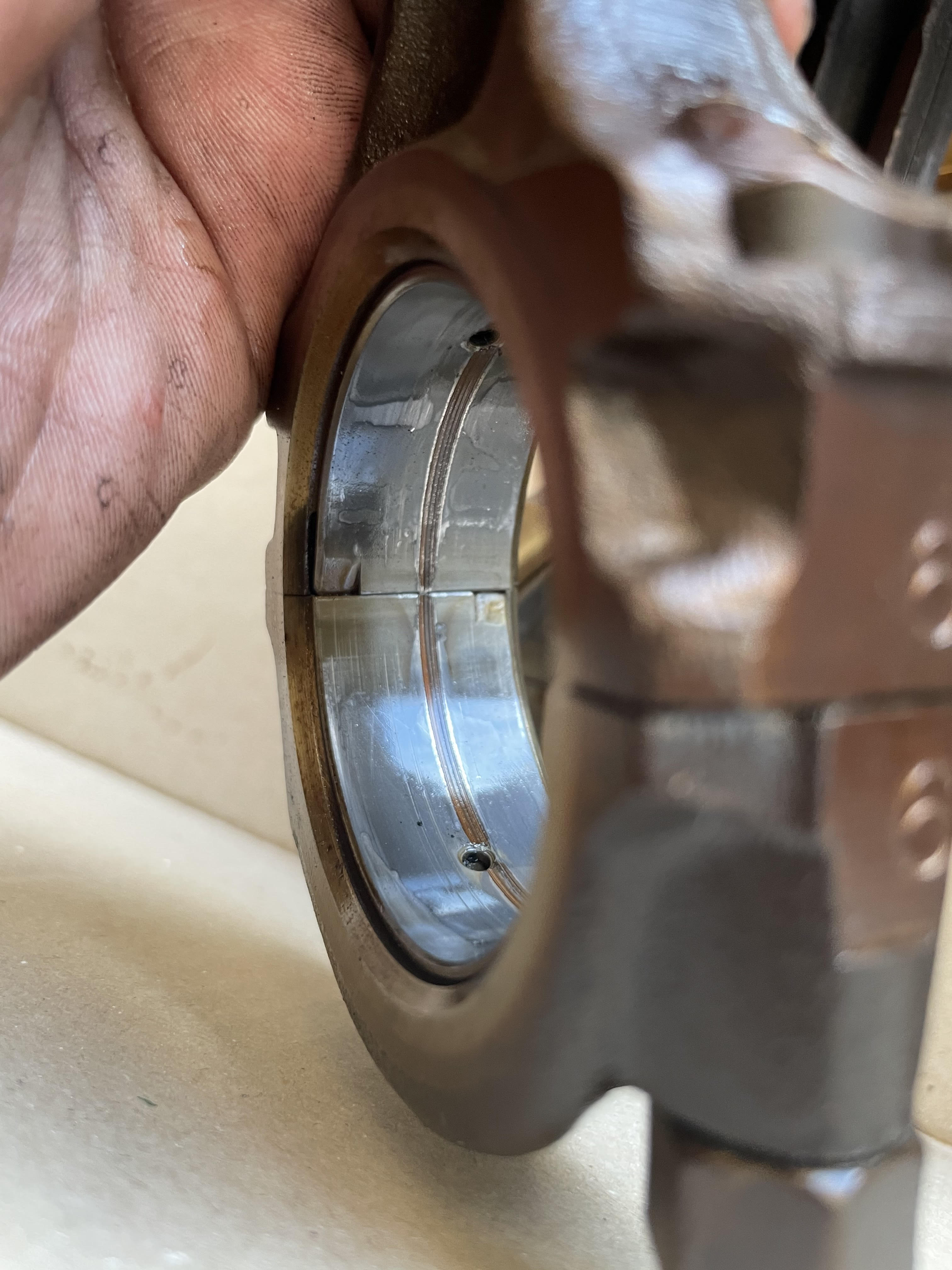

May 26, 20214 yr Author comment_622180 Got the bottom end all torn apart. Someone LOVES red RTV...Bearings are not looking hot. Going to definitely replace them. Link to comment https://www.classiczcars.com/forums/topic/65237-barefootdans-280z-build/?&page=6#findComment-622180 Share on other sites More sharing options...
May 26, 20214 yr comment_622181 What do the crank journals look like? Link to comment https://www.classiczcars.com/forums/topic/65237-barefootdans-280z-build/?&page=6#findComment-622181 Share on other sites More sharing options...
May 26, 20214 yr Author comment_622194 Surprisingly well in comparison to the rod bearings. I haven’t undone the main caps yet though. there is a very slight score in one of the journals but I’m optimistic it came be polished out. Link to comment https://www.classiczcars.com/forums/topic/65237-barefootdans-280z-build/?&page=6#findComment-622194 Share on other sites More sharing options...
May 26, 20214 yr comment_622195 Does Nissan stamp numbers on their rods and caps? Or does it look like somebody has been in there before? The bearing wear seems odd, but I'm not an expert. Haven't seen many. Link to comment https://www.classiczcars.com/forums/topic/65237-barefootdans-280z-build/?&page=6#findComment-622195 Share on other sites More sharing options...
May 27, 20214 yr Author comment_622280 Someone was definitely in the front and top. But the bottom looked fresh from any marks. Link to comment https://www.classiczcars.com/forums/topic/65237-barefootdans-280z-build/?&page=6#findComment-622280 Share on other sites More sharing options...

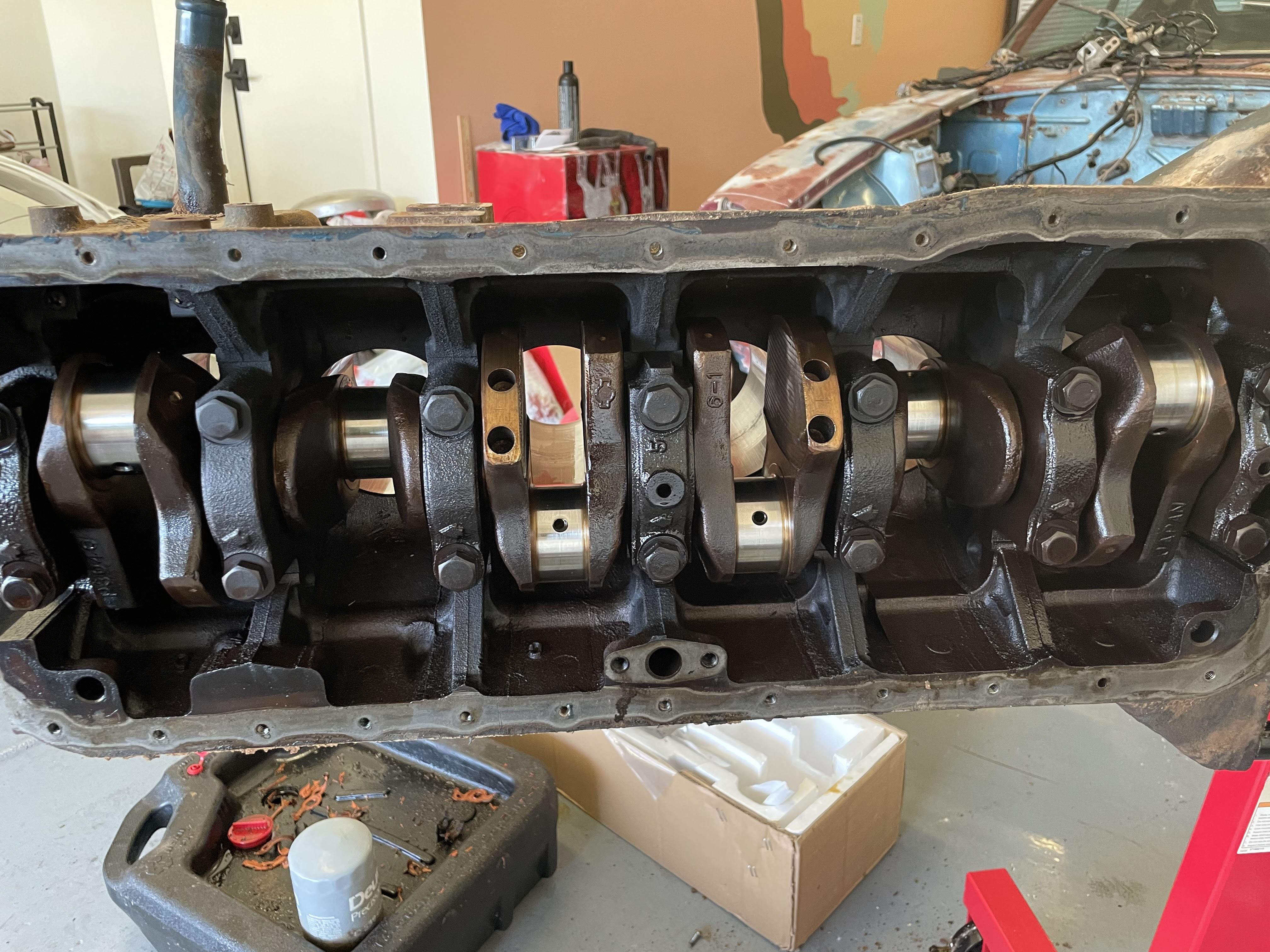

June 16, 20214 yr Author comment_623583 Been slowly making more progress. the crank is fully out and the journals look surprisingly well in comparison to the rod bearings. I was worried for a bit...Next step is to drop the block off at a machine shop for a thorough cleaning. Unfortunately I will be out of town for the next month for summer so the build is on pause for now. AZ summers dont make it fun to work in the garage! It was 117 out yesterday Link to comment https://www.classiczcars.com/forums/topic/65237-barefootdans-280z-build/?&page=6#findComment-623583 Share on other sites More sharing options...
