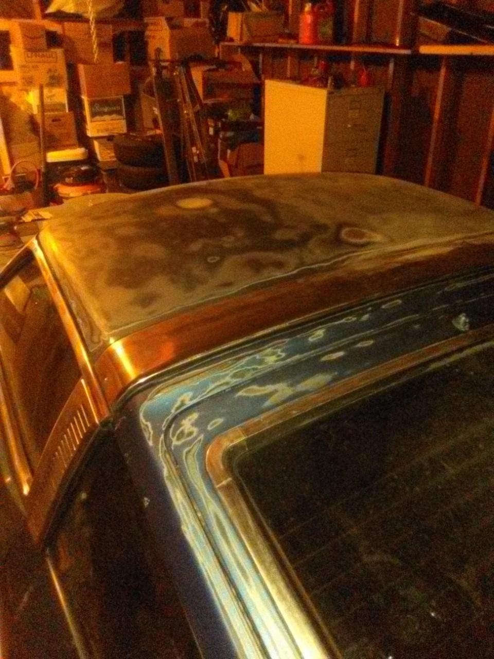

I met an acquaintance recently who has the same car sickness I do, except with Mitsubishi Monteros.  He has access to a paint booth and painting experience.  He says if I prep the car, he'll show me how to paint it in the booth.  I buy supplies.
Can't beat that.  I'd like to get started right away so as not to waist the opportunity.   So my question is probably a silly one, but I'll feel better knowing for sure.

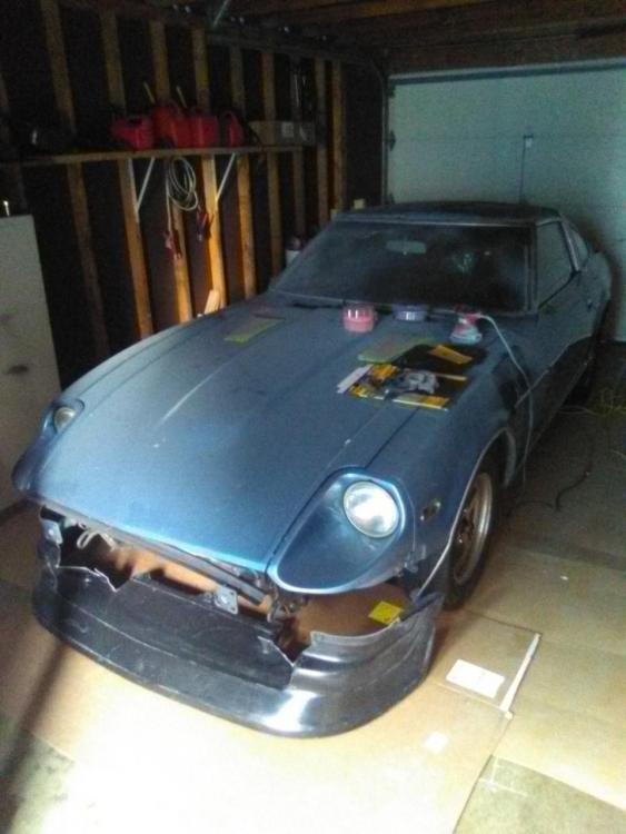

I will. Bodywork is not my strong point so I'll have to doctor up the photos haha. But I got started today, in the spirit of pictures or it didn't happen.

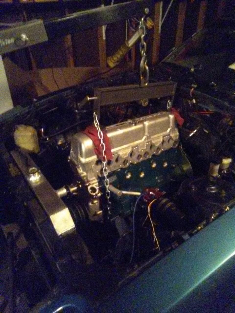

No decent pictures of the engine build. The phone is too low end for anything close up.
