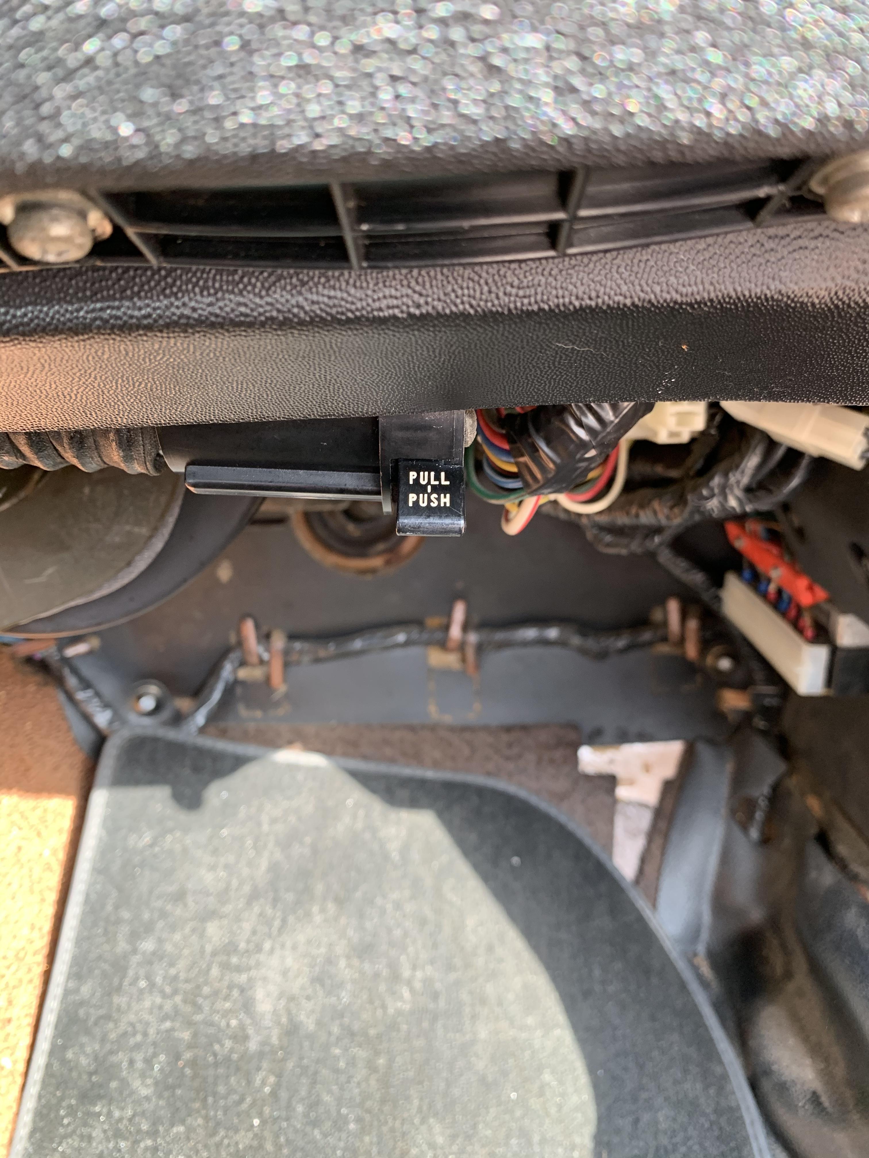

I looked in the Owner’s manual and it says nothing about this Push/Pull thing. I assume it’s for the AC or vent system.  It sort of a rotary housing with a slider that moves back and forth.  Doesn’t seem to have a stop pushing it towards the front of the car.  I had the fan blowing and couldn’t tell if it did anything when I moved it.
I know someone here know what this thing is and what it’s supposed to do!
My 76 had something similar on the driver's side.  It just blew air down on my feet.  Can't remember if it said pull-push or not.   The hose looks factory Nissan on yours.

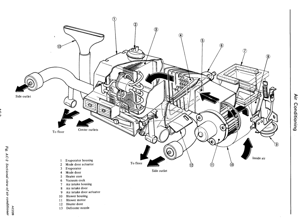

Edit - it's in the AC chapter of the FSM.

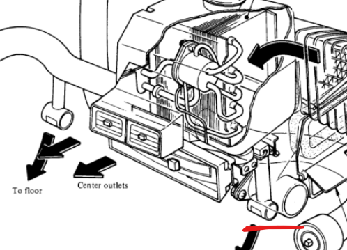

I don’t see anything that looks like it on this diagram.  It definitely isn’t one of the numbered items.  It is located to the right of the blower housing and a hose in and out.
It’s  definitely factory, can came with AC from the factory.

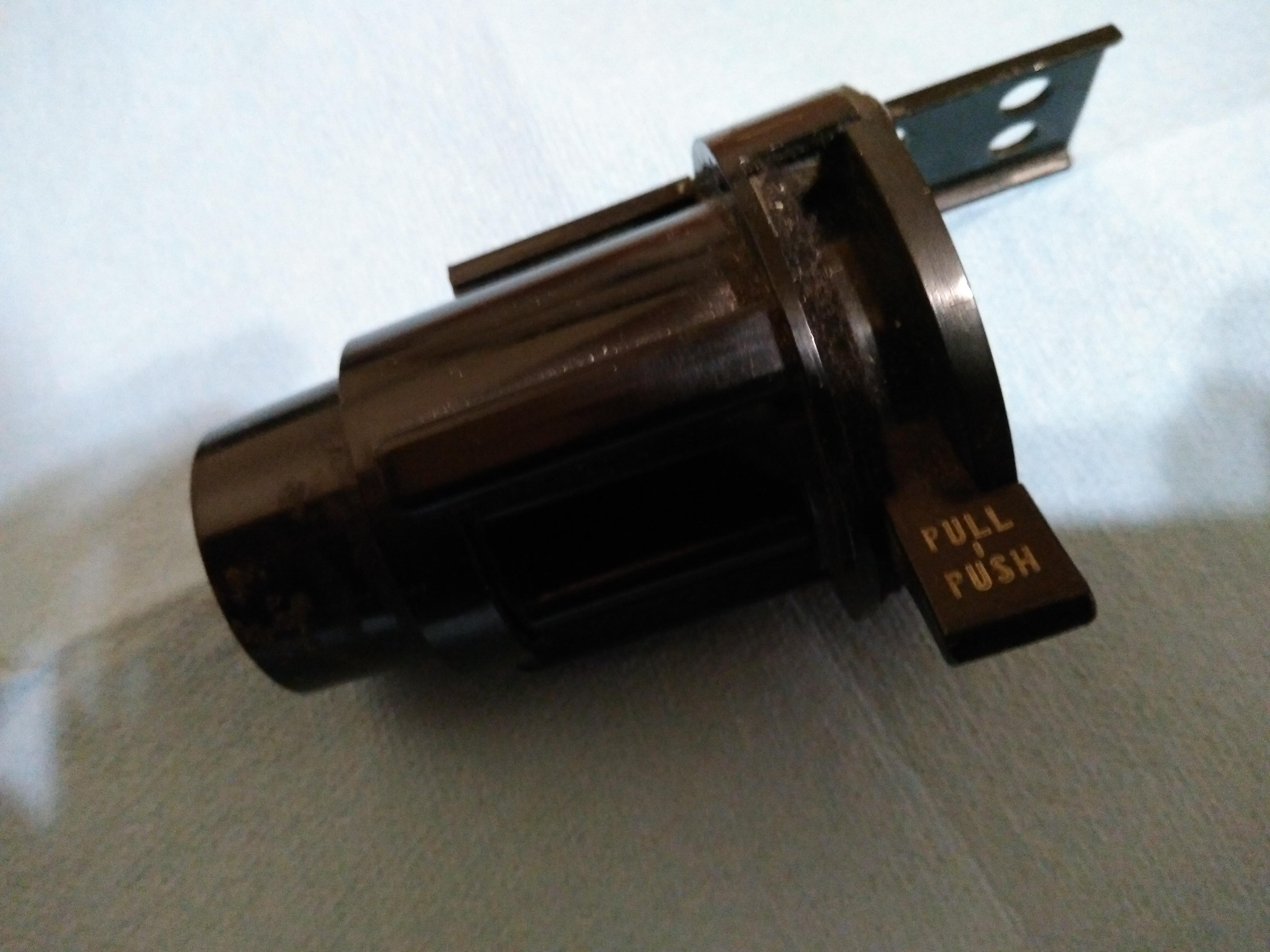

Here is one I have ...    Lever opens a rectangular shaped vent opening.
I think all the AC optioned 280's had them,  many lost over the years from po foolery.   Push to close, pull to open for that big blast of cool air on your feet.

The drawings are just representations.  The hoses are smooth, the defrost tube does not shoot straight up, the front vents look different.

Thanks, that’s it.  Now I know how to close it.  Hopefully that forces more air through the rest of the vents.
