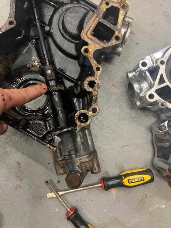

Just got in new timing cover. Once the 4 bolts of oil pump are out does it and the spindle just slide apart? I dont want to force anything and break it off....
thanks
Yes, once the 4 bolts are removed the pump drops right out.  If the cover is still on the engine, and the engine is upright, the spindle will fall out too.
When I have removed oil pumps with the engine still in the chassis, I found it helpful to pull the distributor, and clamp a needle nose vice grip on the distributor drive tang, so the spindle stays put.
You will find that assembling the new cover to the engine will be easier without the spindle and oil pump in place. Once you get the cover on, it will be a bit tricky to get the spindle in the correct position so the distributor will line up correctly.
Good luck.

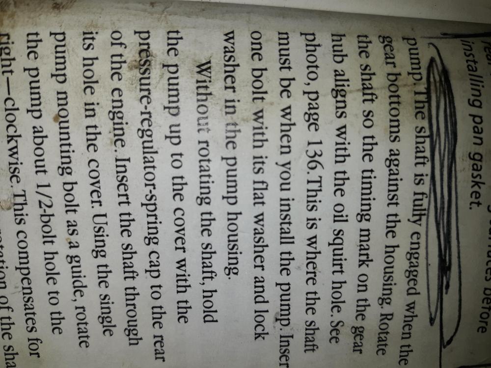

I agree with RacerX. It would be much easier to put the cover on without the pump. The way you have to time the spindle with the crank gear also. There's a trick Tom Monroe's book has that works for me. I'll post that in a little while when I can find it.

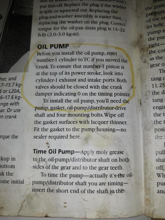

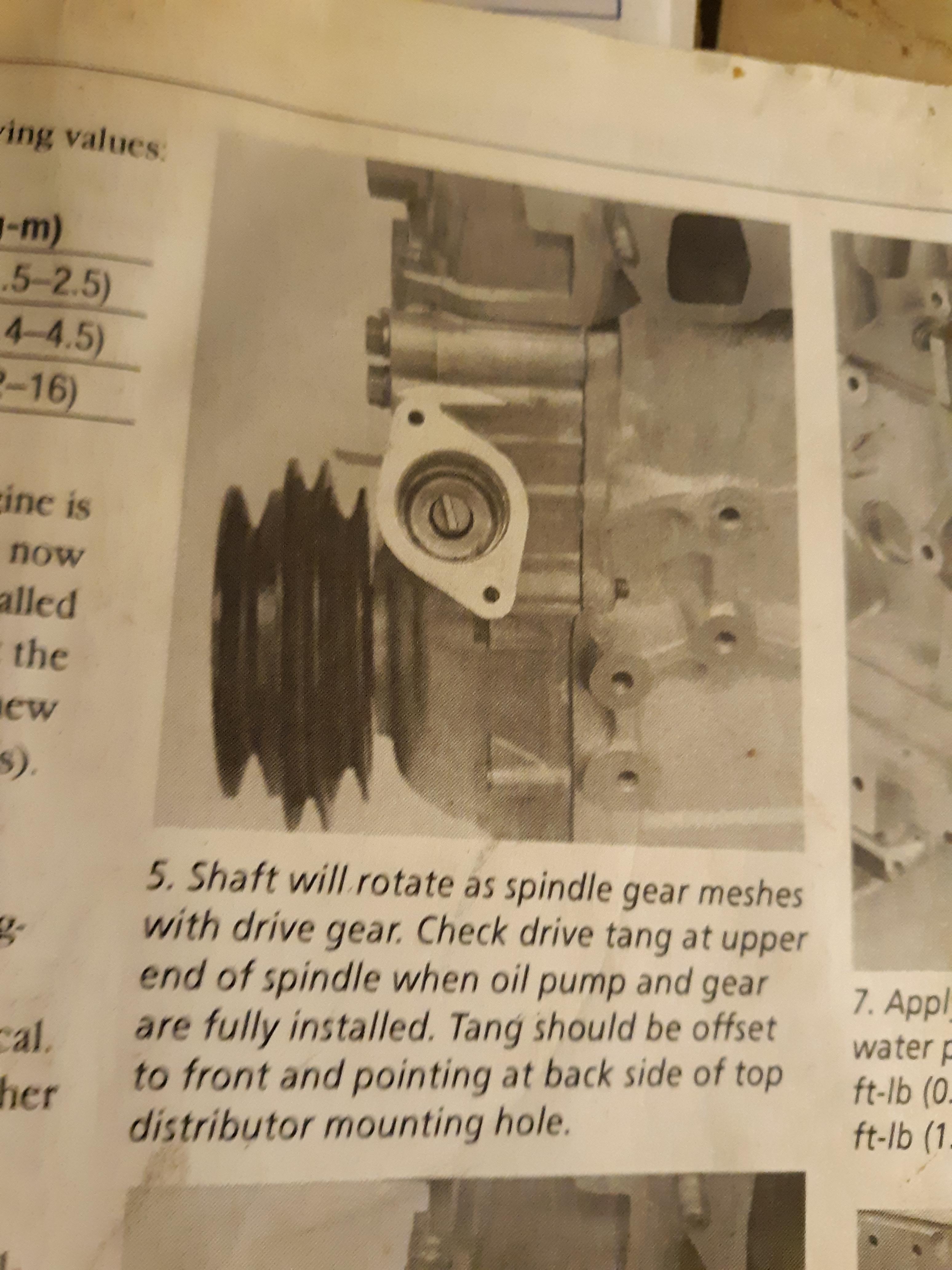

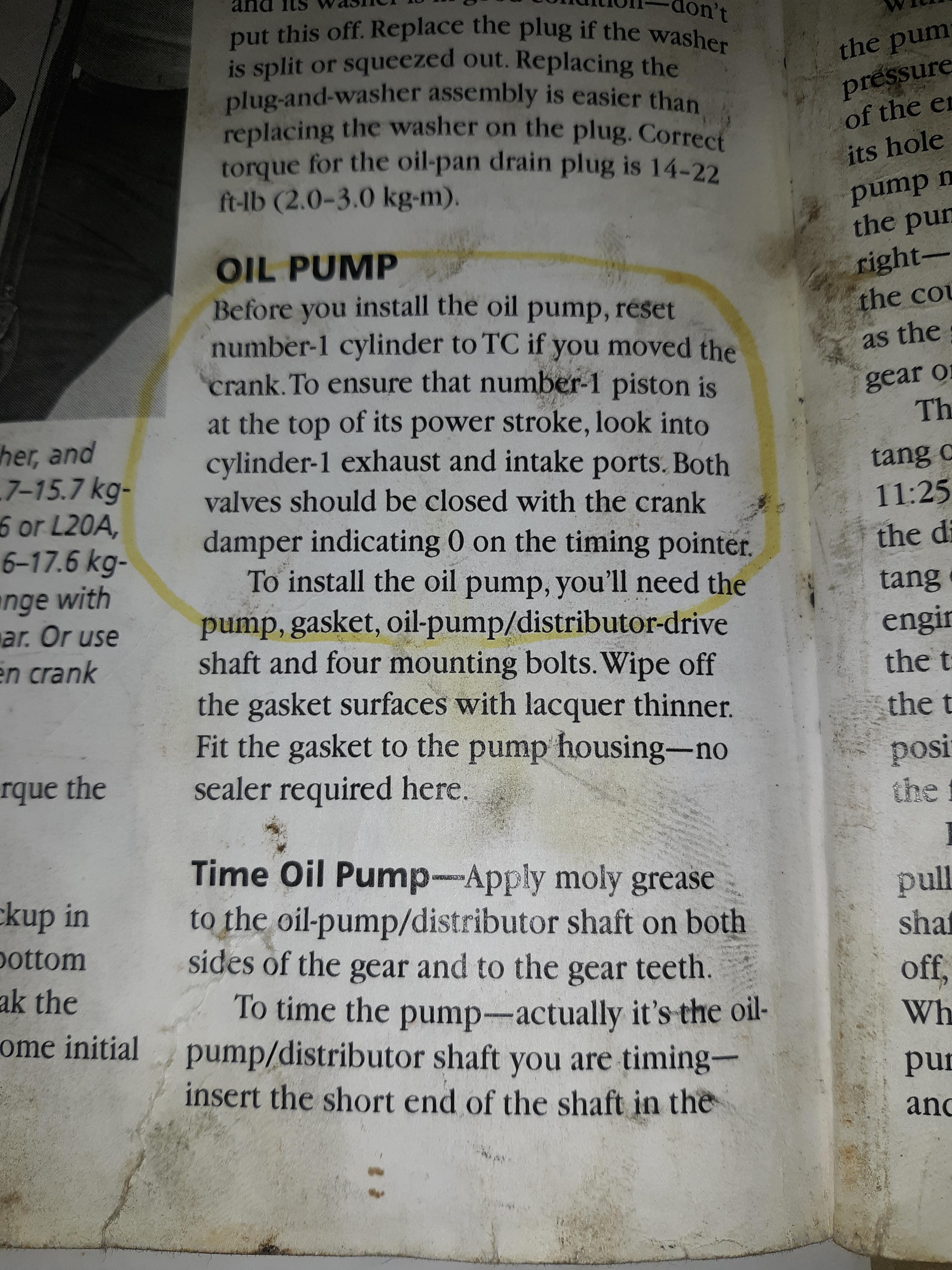

I took some pics with my phone. I can scan it for you tomorrow if this isn't readable. I'll put them in order with the finished position photo last.
Well that didn't work out like I'd hoped. Sorry, scanning would be better but I can't until tomorrow.
Edited by siteunseen

There's a lot of ways to TDC. You'll have to get the valve cover off which is no big deal and then the 1st 2 cam lobes should look like rabbit ears. That gets you in the ballpark. Then get #1 all the way up top, I use a piece of straw. Anyway it's tough the first time, it was for me but after you've done it and figured it out it gets easier.
