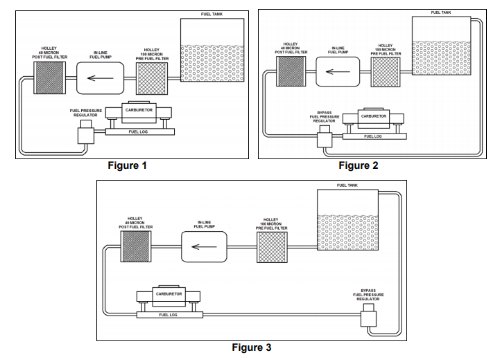

From the instructions on Holley's website:
I used the configuration in Figure 2 for the 12-804 FPR, but again, I did not use a stock 260Z or 240Z fuel rail.
well Zed Head, when I spoke to holley tech yesterday I was told it is a different regulator!  the 12-804 is a dead head type like in STEVESJ diagram #1. they do not make a 1-4 psi bypass regulator .  STEVESJ diagram # 3 is the way it should be setup when a z car has a return fuel line. [note Holley bypass regulator] what the hell is the difference between the bypass and the dead head style I do not know.  Holley tech recommends not using the dead head on the return line only bypass style. so right now I am just improving the looks of the engine bay with a nice coated fuel rail and not being covered in asbestos like my 260 rail . so when the new rail gets installed I will put the pressure gauge on the supply line with a tee and take a reading at different rpms and see if it changes. if it stays steady at around 3- 3.5 lbs then there is no need for the regulator. if it does not, then I would like to have the ability to dial in a perfect pressure setting. now in this day and age we can do that on a 45-50 year old system. does it matter on a performance aspect probably not . but being stuck home with the covid and crap all around I need projects to keep from going out of my mind .  this helps and the z will like !!
I think that you just need to know how the regulator works.  The mechanism of pressure control.  You can use a bypass regulator with three ports and make it do whatever you want, deadhead or bypass the carbs.  That's how Aeromotive does theirs.
I don't really understand how the Figure 1 regulator does its thing.  I'll have to dig in to it.  I do know though the pump will put out maximum pressure in that type of system, so if you have a high flow/high pressure pump in a Figure 1 setting, it's going to be working hard but pushing nowhere.  Probably the noisiest possible configuration.
I think these things are why the car manufacturers control the pump power with the ECU now.  They lower voltage at low need, and raise it at high.  Flow control.
