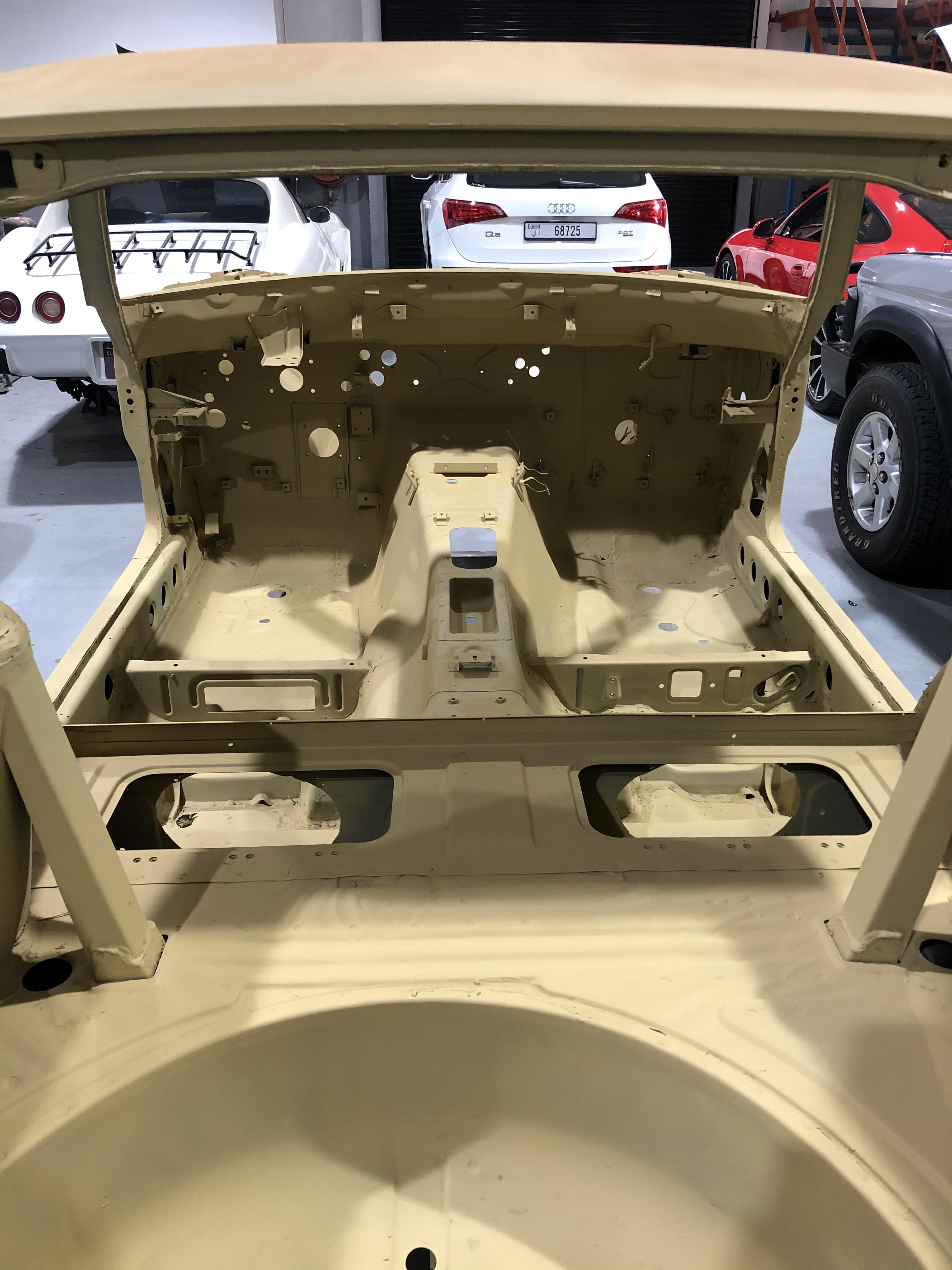

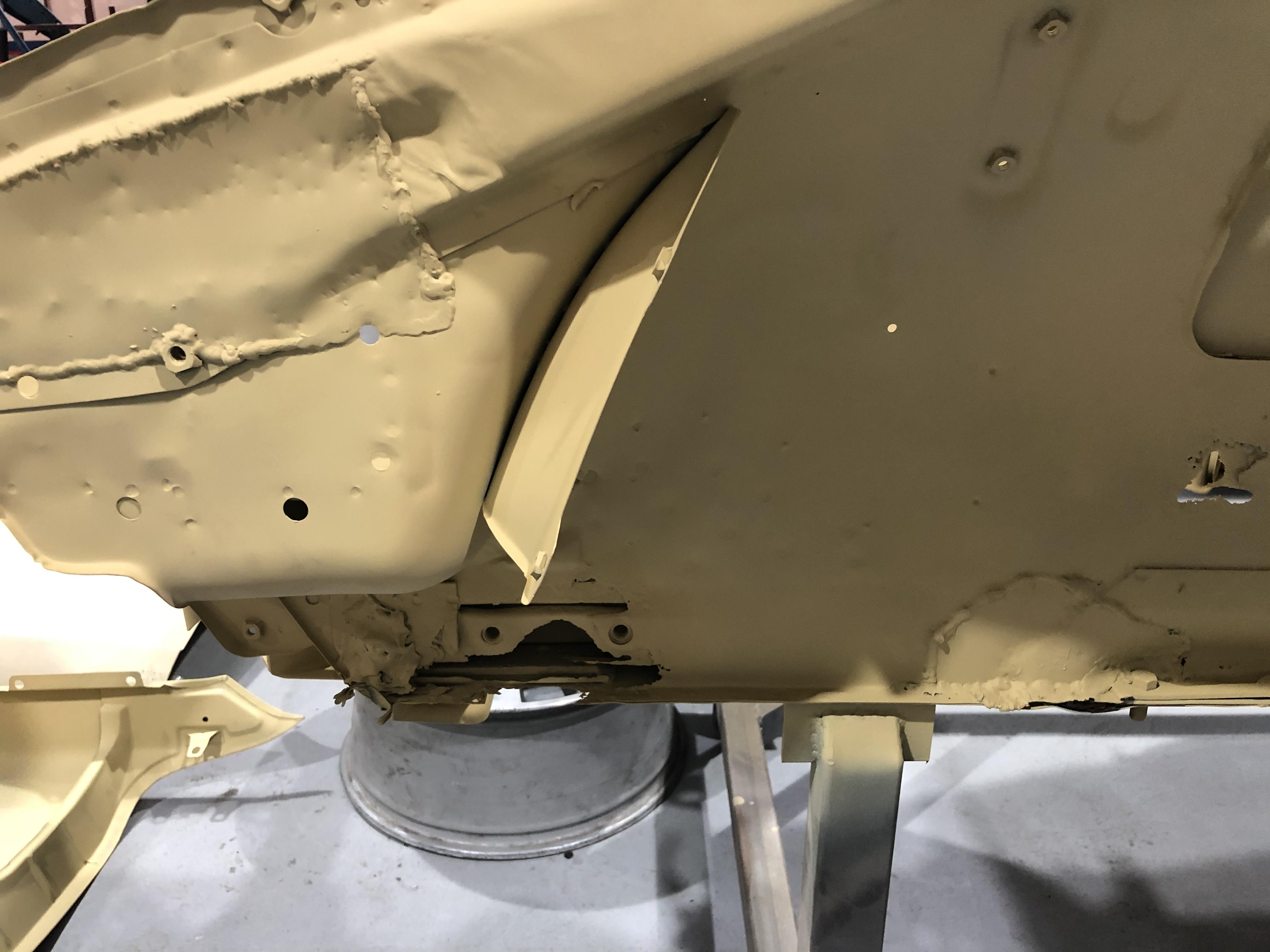

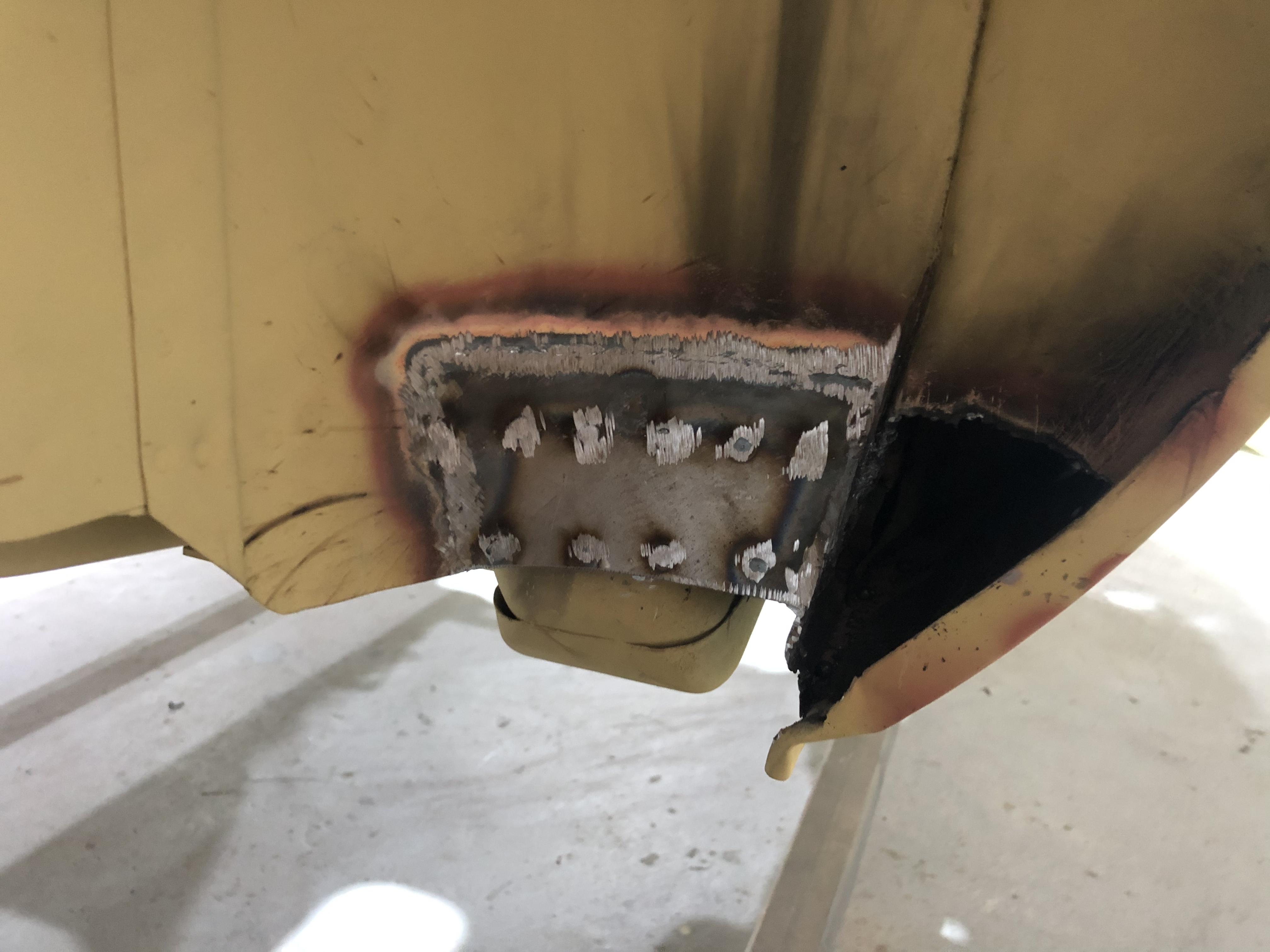

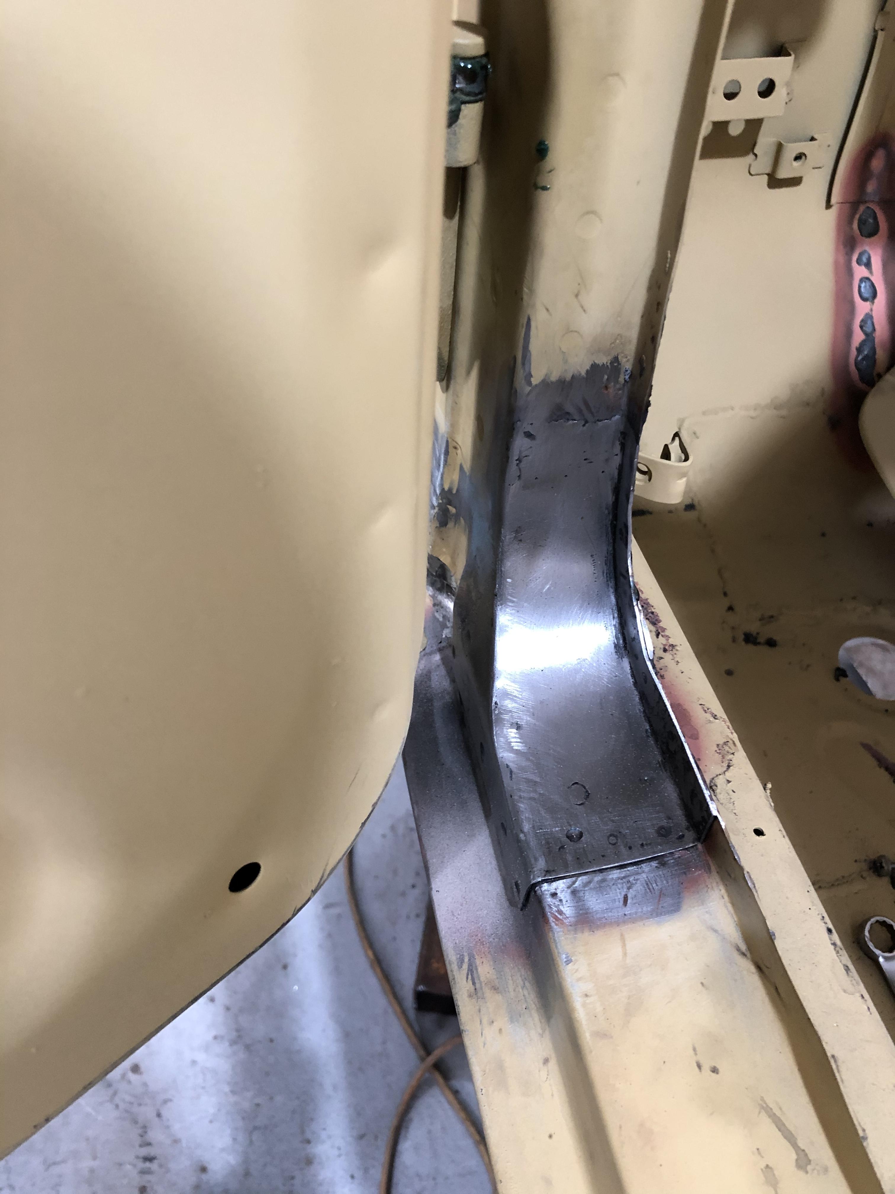

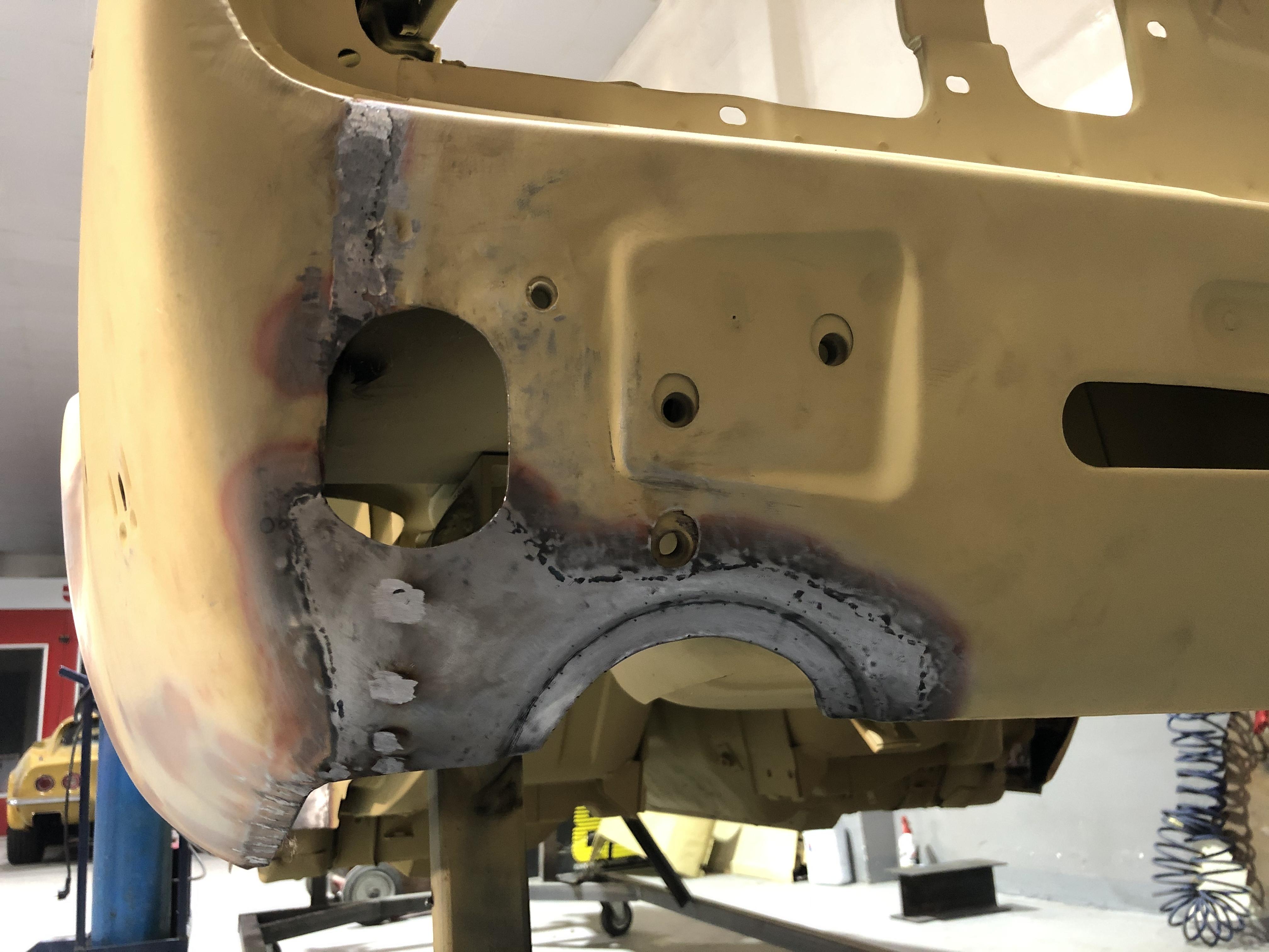

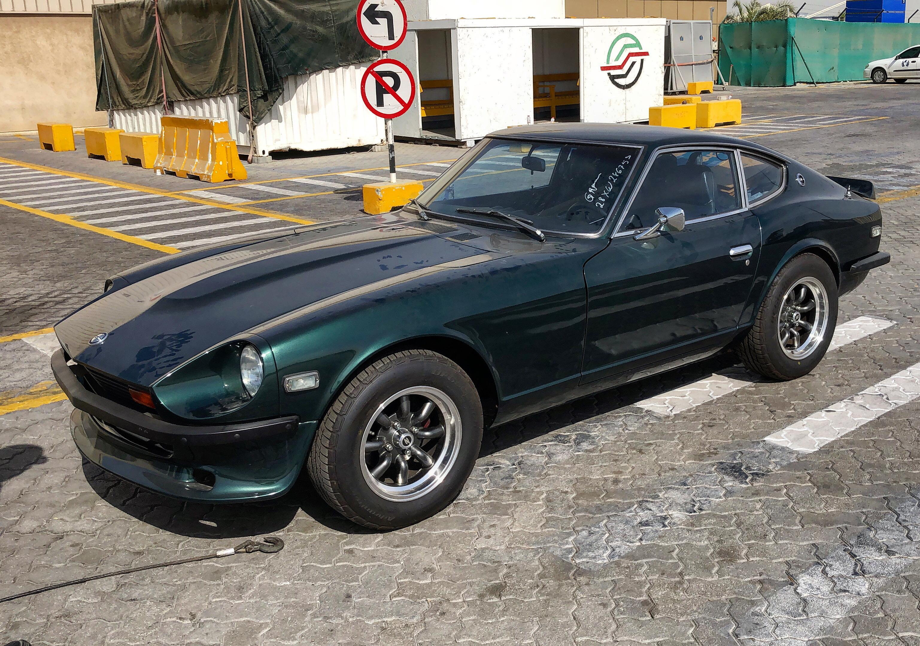

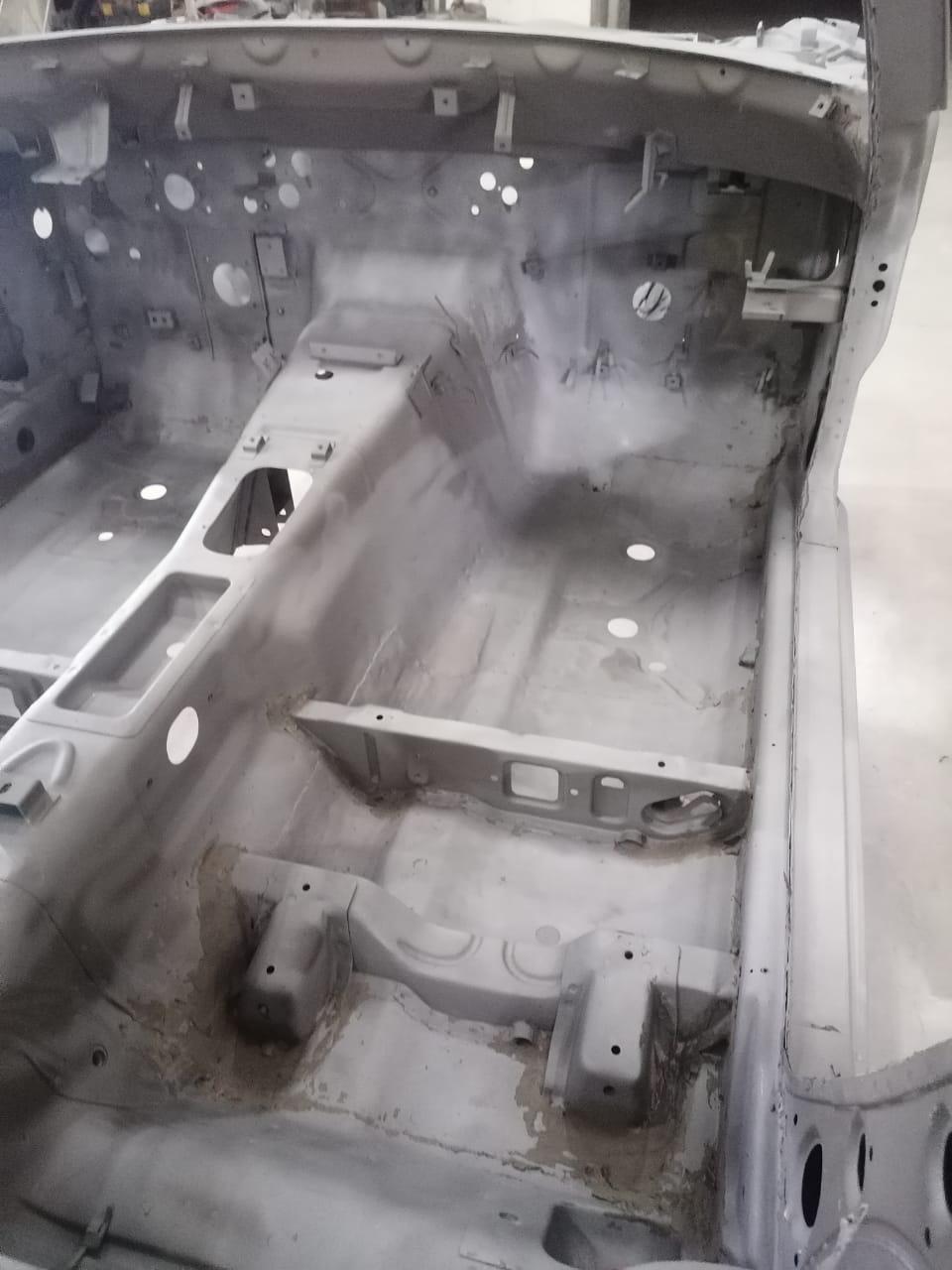

Posted January 4, 20214 yr Popular Post comment_613848 Hi Guys, First of all, I'd like to wish everyone a Happy New Year and the very best health ! I am new here but can already appreciate the overall dynamic and supportive mindset of the neighborhood ! End of May 2020, insomnia hitting, I somehow ended up on BaT at 2am and got my hands on a beautiful 280 Z from April 1976 with its original matching number engine + 1981 280zx 5-speed gearbox (the original 4-speed also came in a box). The car is originally from Nebraska I believe, but transferred to Ohio in 2016. Obviously with COVID-19 and loads of excuses from the transporter (CFR Rinkens - DO NOT recommend), the car reached Dubai (UAE) mid September 2020. From the previous owner in Ohio: To Dubai, fresh out of the container, 4 months later. The plan from the beginning was very simple, as the car had already been through some body work and was repainted at least once in 1998 from its original Pacific blue (DAT 307), I wanted to give it backs it's factory glory and color, but with a personal restomod touch under the name Zinta Heritage (Zinta meaning: From early in life, you have asserted your individuality, learning through your own experiences, relying upon your ingenuity and practical creativity to accomplish your objectives with independence and determination). I decided to have it fully dismantled and sandblasted (we can see the dated Pacific Blue remains in the engine bay). This is when surprises knock on the door, a lot of body "repair" badly done, plenty of patches, poor quality welding and so on, especially on both front ends and the floor. Some rust holes showed up as well, but can we blame a 44 yo car from Northern states ? Nop... Then, following my original vision to make her "as new" the work started, removing patches, cutting, hammering, welding... As of now, the body work is 70% completed, the floor kit arrived from Zedd Findings (Big up to Charlie Osborne for his support) and will be replacing the old one. Some other area to be finalized in the next few weeks, cleaning the engine bay from the "useless" pieces, deleting the side markers (front/rear), deleting the unused rear bumper holes, closing the ugly speaker holes made in the toolkit hatch and some overall rear panels hammering for perfect alignment with doors (as they were probably replaced in 1998 as well). I also managed to get some parts in prevision of the rebuilding process: - Jenvey ITBs kit with 480cc injectors, MS3 Pro Evo ECU, DG508 ignition coils, OneSixIndustries CAS, complete engine seals/gaskets kit, timing chain kit, water pump, T3 front/rear strut brace, T3 weld-on coilovedr kit (car came with unmounted KYB Excel G), Prothane bushing kit, full weatherstrip kit. In the meantime I was also keeping myself busy restoring the dashboard and gauges (obviously cracked and hidden under a plastic cover). It will be eventually wrapped in dark black alcantara, but I didn't want to wrap a piece of garbage... Regarding the gauges, I got my hands on some LED rings and bulbs in order to get some decent lighting, and decided to redesign the speedometer (originally imperial and I need metric) and tachometer and have them screen printed), as well as giving a neon orange touch to the needles. The painting should be happening within 2 or 3 weeks, and then the reassembling process will start. Happy New Year to you all !     Edited January 13, 20214 yr by BAS_DXB Link to comment https://www.classiczcars.com/forums/topic/64925-1976-280-z-from-ohio-to-dubai/ Share on other sites More sharing options...

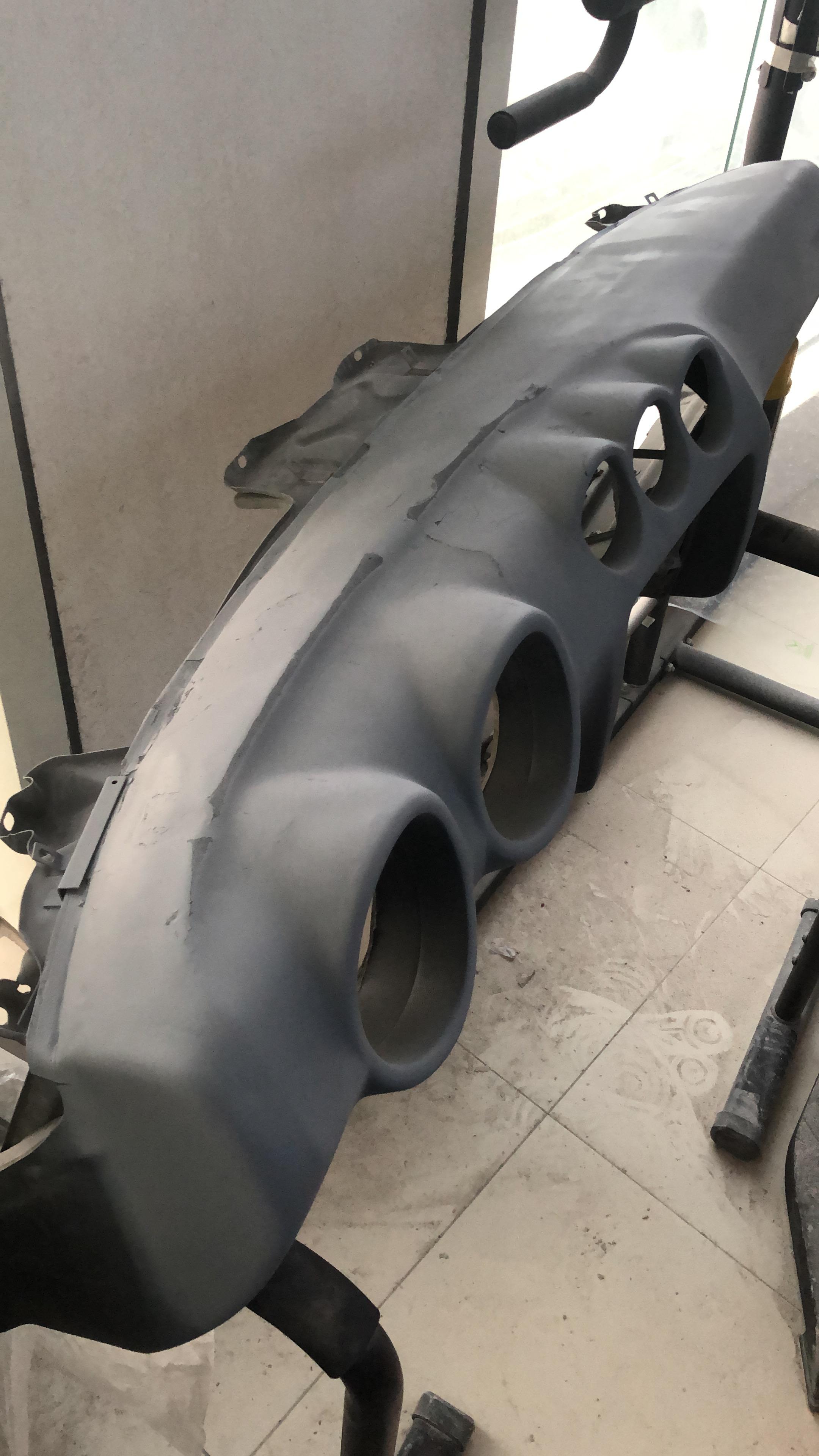

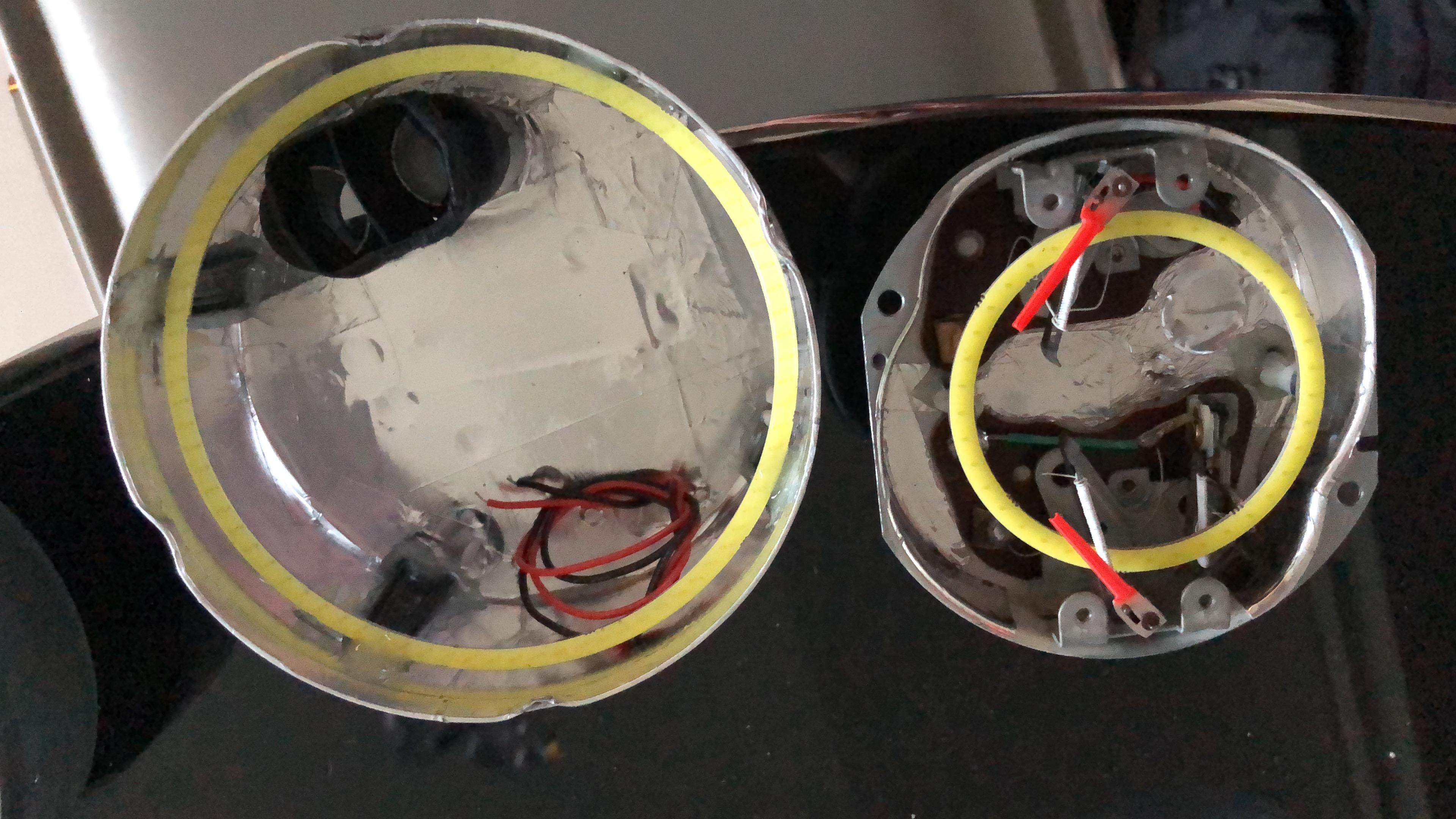

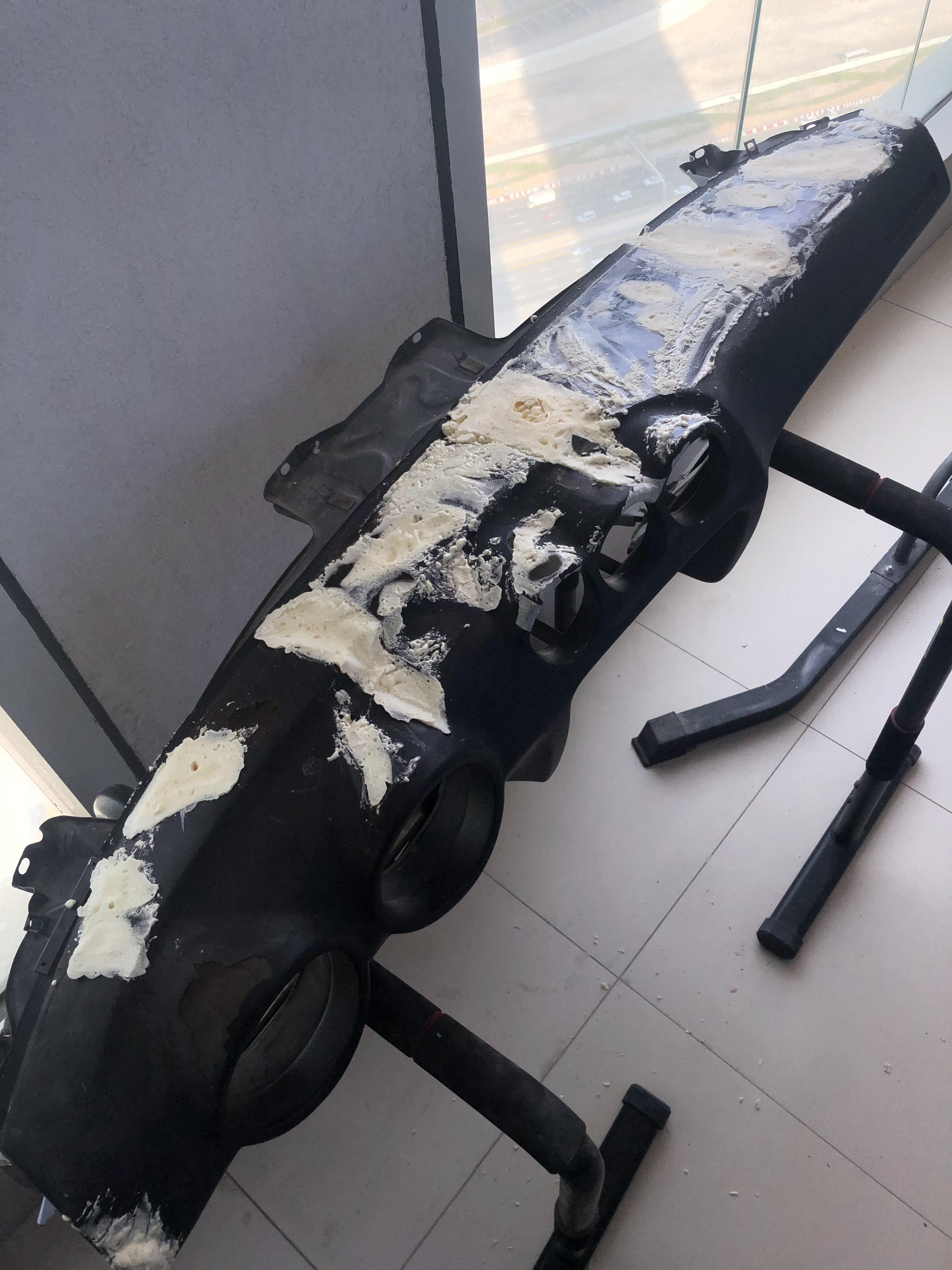

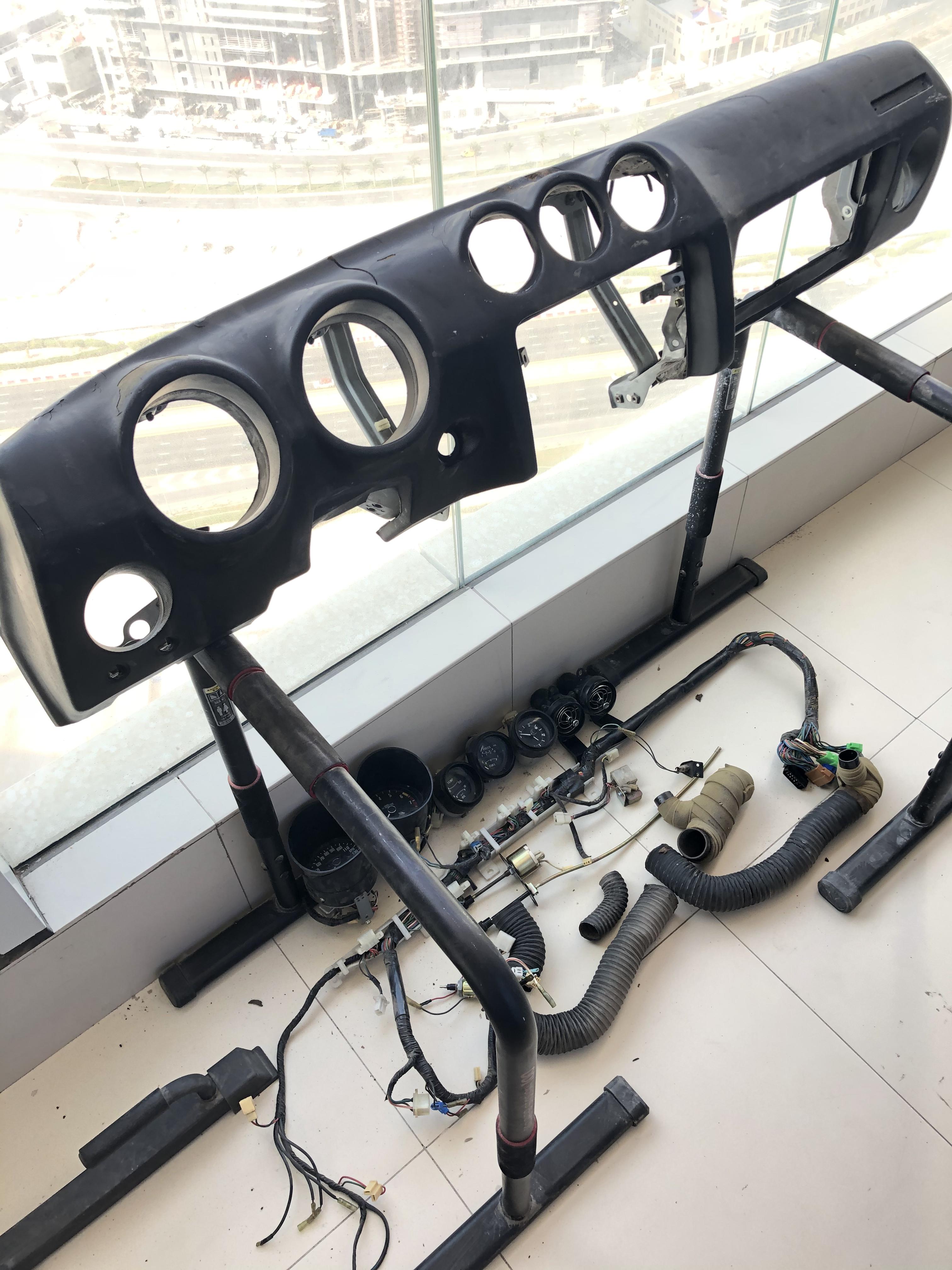

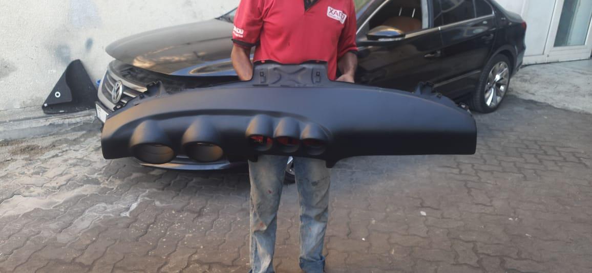

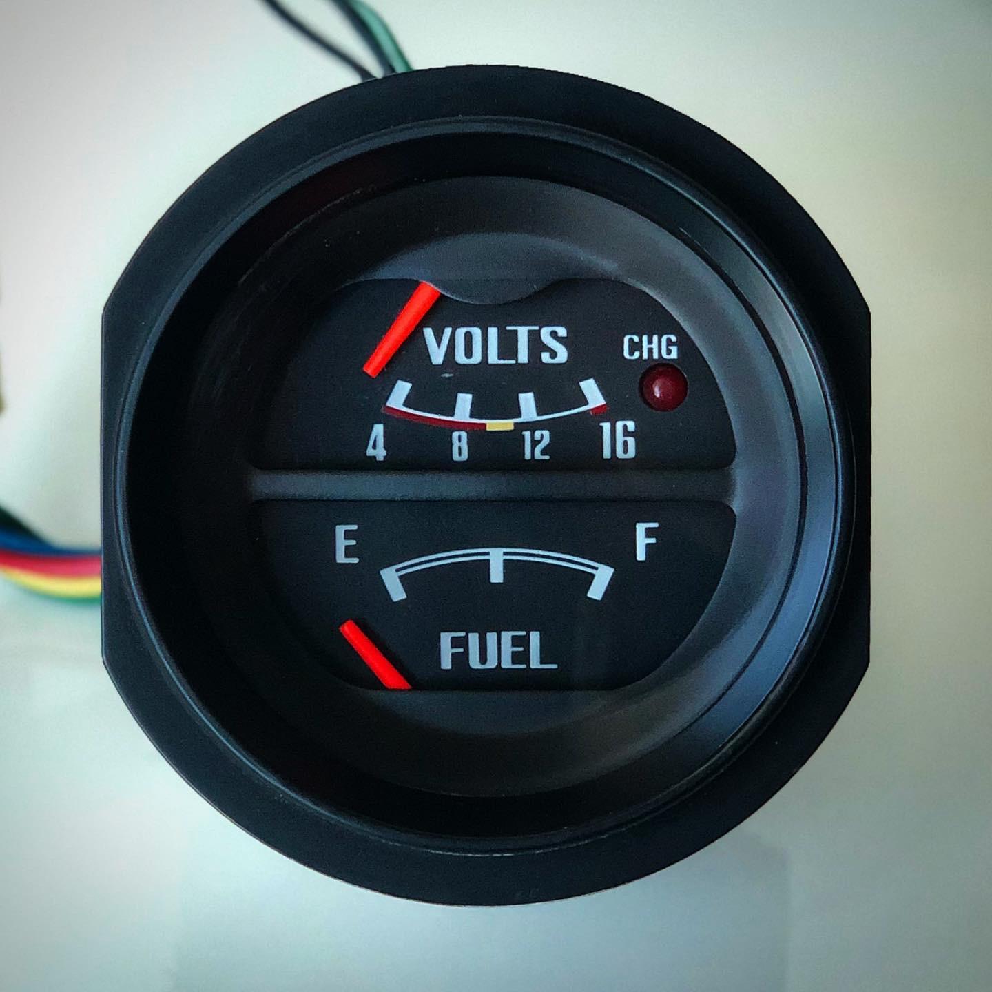

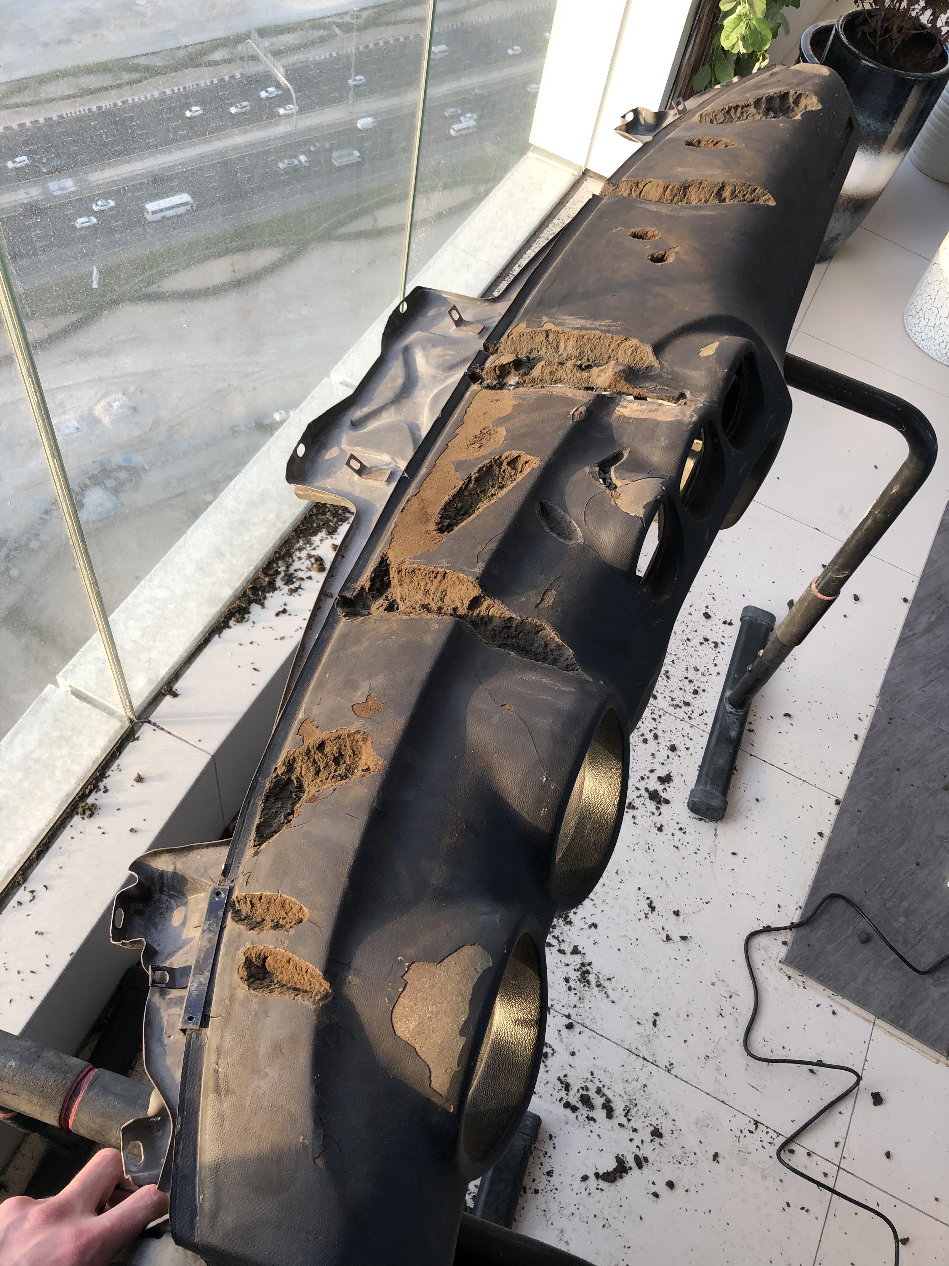

January 4, 20214 yr comment_613854 I love the fact that your restoring your dash on the 60th floor of an office tower, the shell looks to be in great shape. Looking forward to the next set pics. Would you mind posting where you found those LED rings for your gauges? I sold my 77/280z to a dealer in Dubai last year, I think they still have it on the floor, https://www.tominiclassics.com/featcar/datsun-280z/  Link to comment https://www.classiczcars.com/forums/topic/64925-1976-280-z-from-ohio-to-dubai/#findComment-613854 Share on other sites More sharing options...

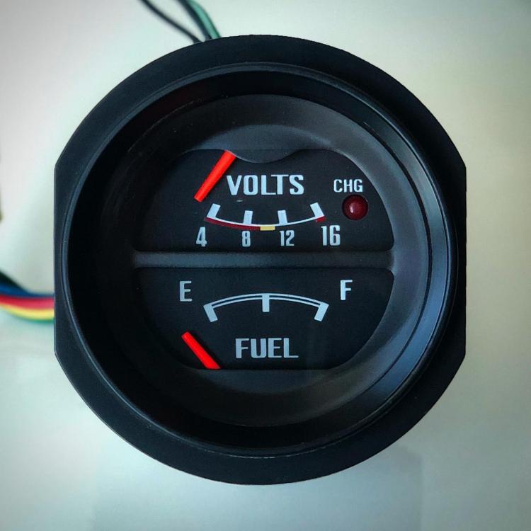

January 4, 20214 yr Author comment_613859 1 hour ago, grannyknot said: I love the fact that your restoring your dash on the 60th floor of an office tower, the shell looks to be in great shape. Looking forward to the next set pics. Would you mind posting where you found those LED rings for your gauges? I sold my 77/280z to a dealer in Dubai last year, I think they still have it on the floor, https://www.tominiclassics.com/featcar/datsun-280z/  Thanks ! The air is a bit cooler up here, so might as well enjoy ! The shell was not too bad indeed, beside all the previous welding/patches. I got the LED rings from amazon, links below: 60mm for the Water Temp and Oil Pressure: https://www.amazon.com/gp/product/B00W6ZXQOO/ref=ppx_yo_dt_b_asin_title_o01_s00?ie=UTF8&psc=1 (can't fit it in the Volt/Fuel one, so replaced original bulbs with LED ones https://www.amazon.com/gp/product/B01E8MYSOY/ref=ppx_yo_dt_b_asin_title_o01_s01?ie=UTF8&psc=1) 110mm for Speedo and Tacho: https://www.amazon.com/gp/product/B00W6ZXROS/ref=ppx_yo_dt_b_asin_title_o01_s01?ie=UTF8&psc=1 They catching the power from the original bulbs, either through the connector pins for the small gauges, or splicing directly on the cables for the bigger ones. I have seen your car at Tomini, did they ship it from Canada to Dubai directly ? Link to comment https://www.classiczcars.com/forums/topic/64925-1976-280-z-from-ohio-to-dubai/#findComment-613859 Share on other sites More sharing options...

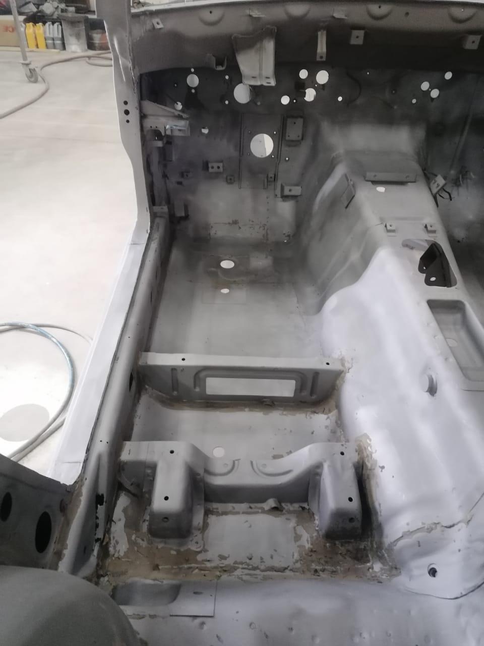

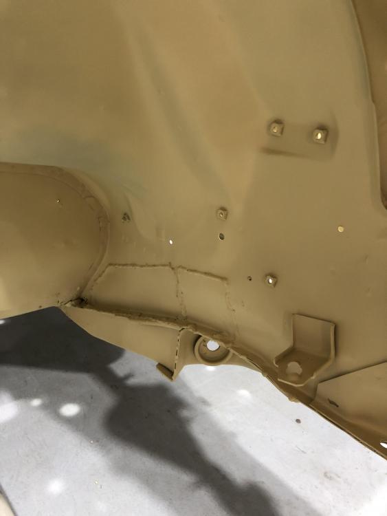

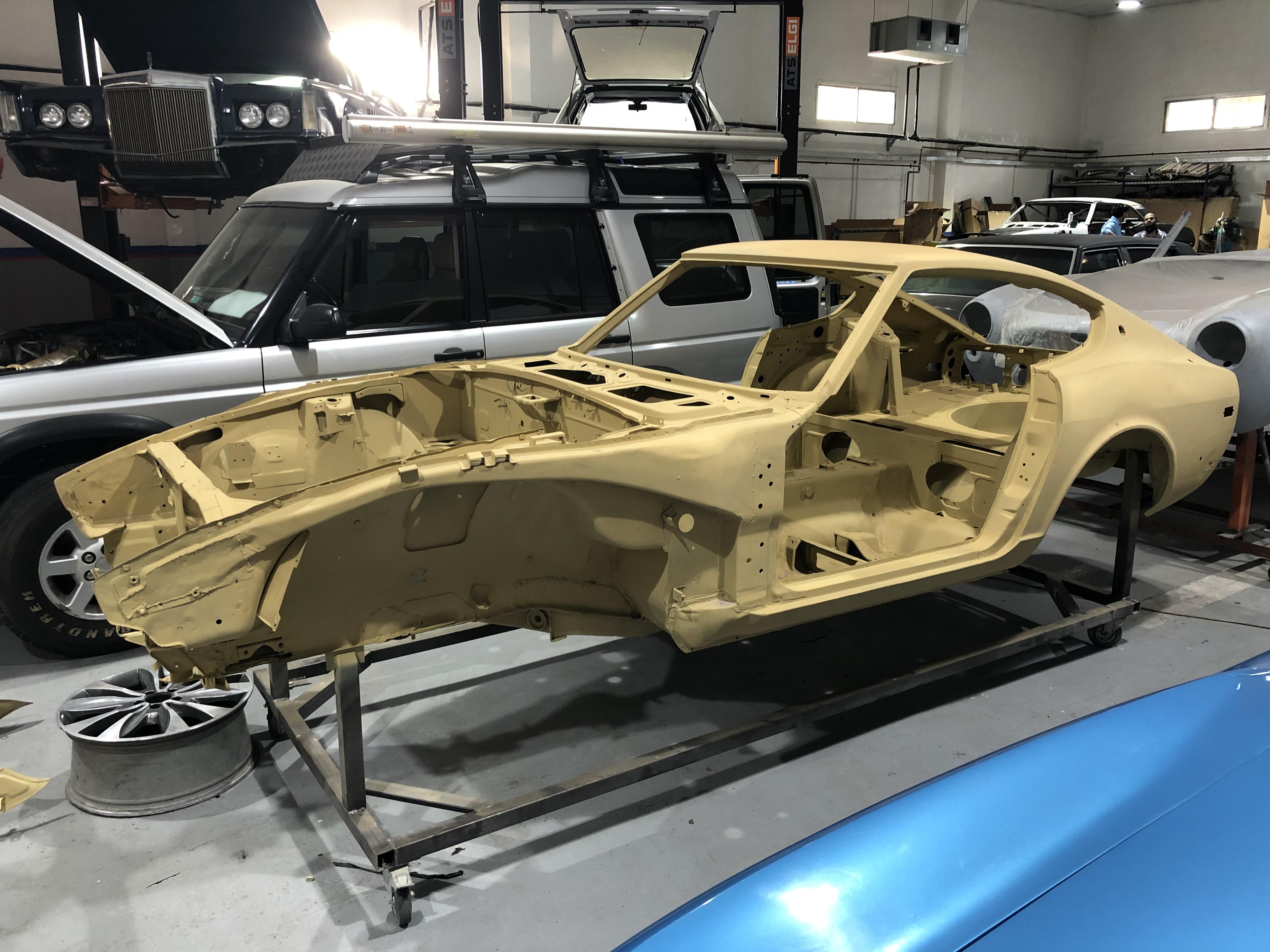

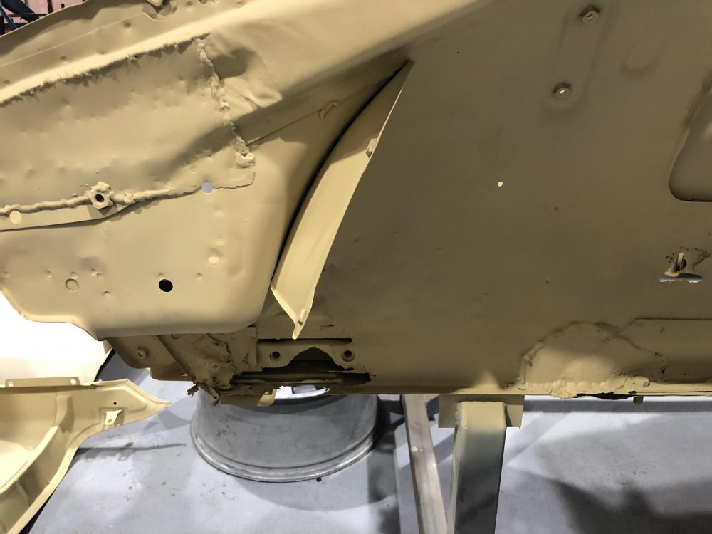

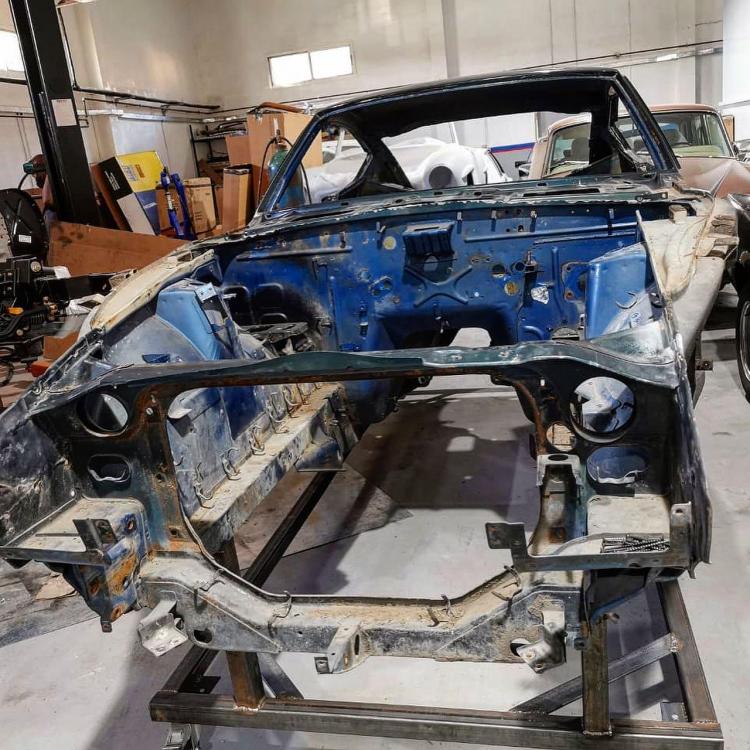

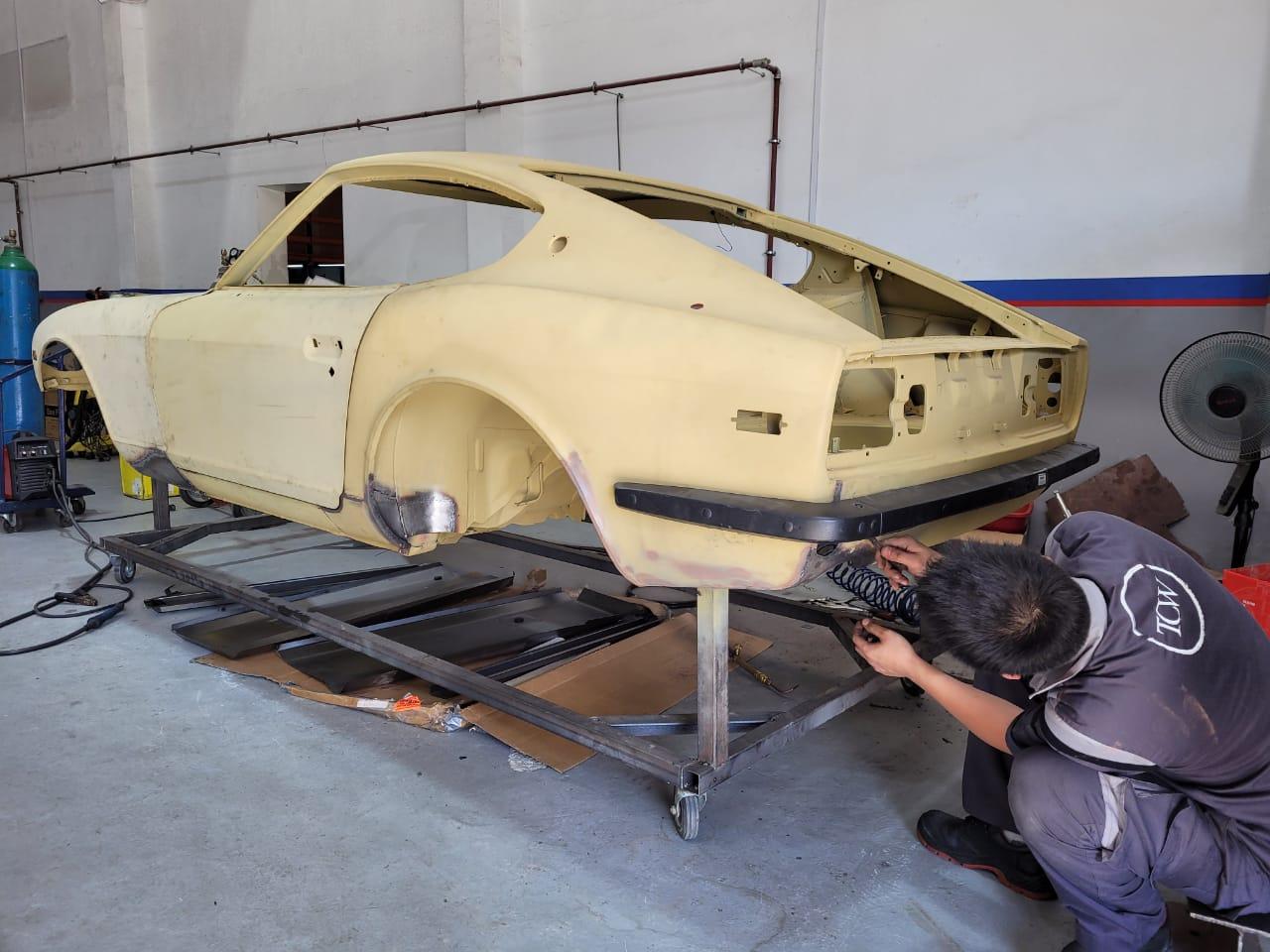

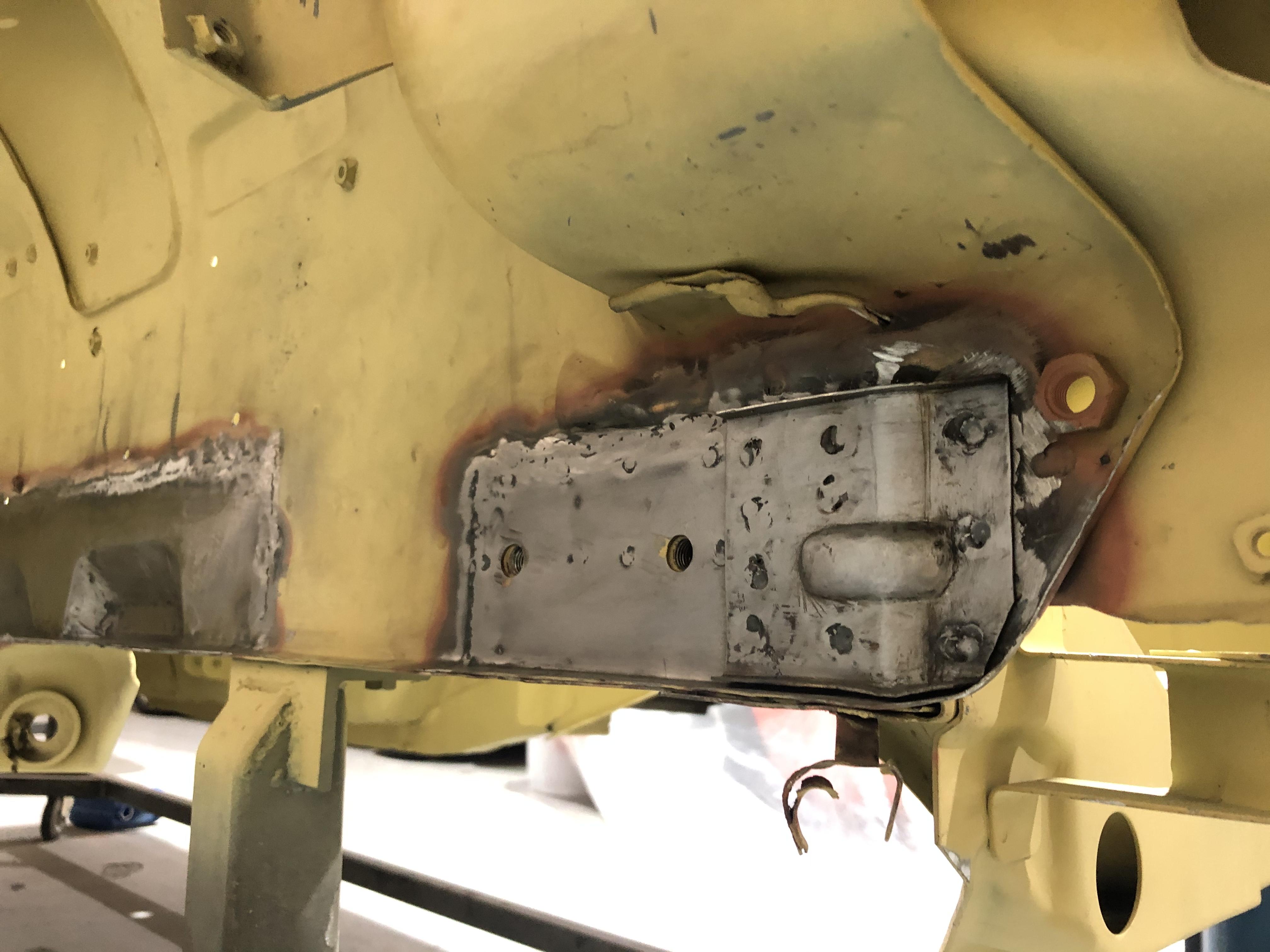

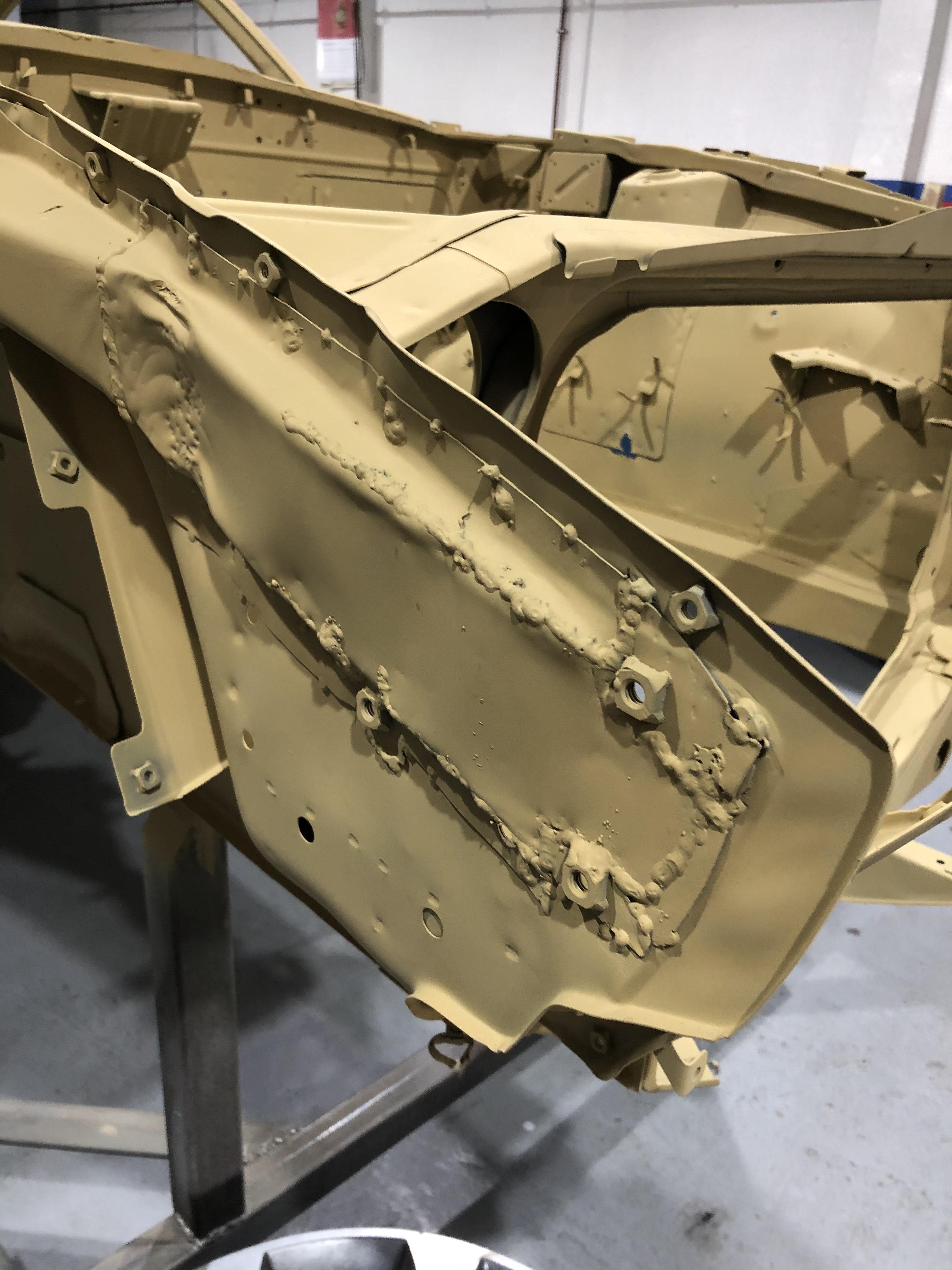

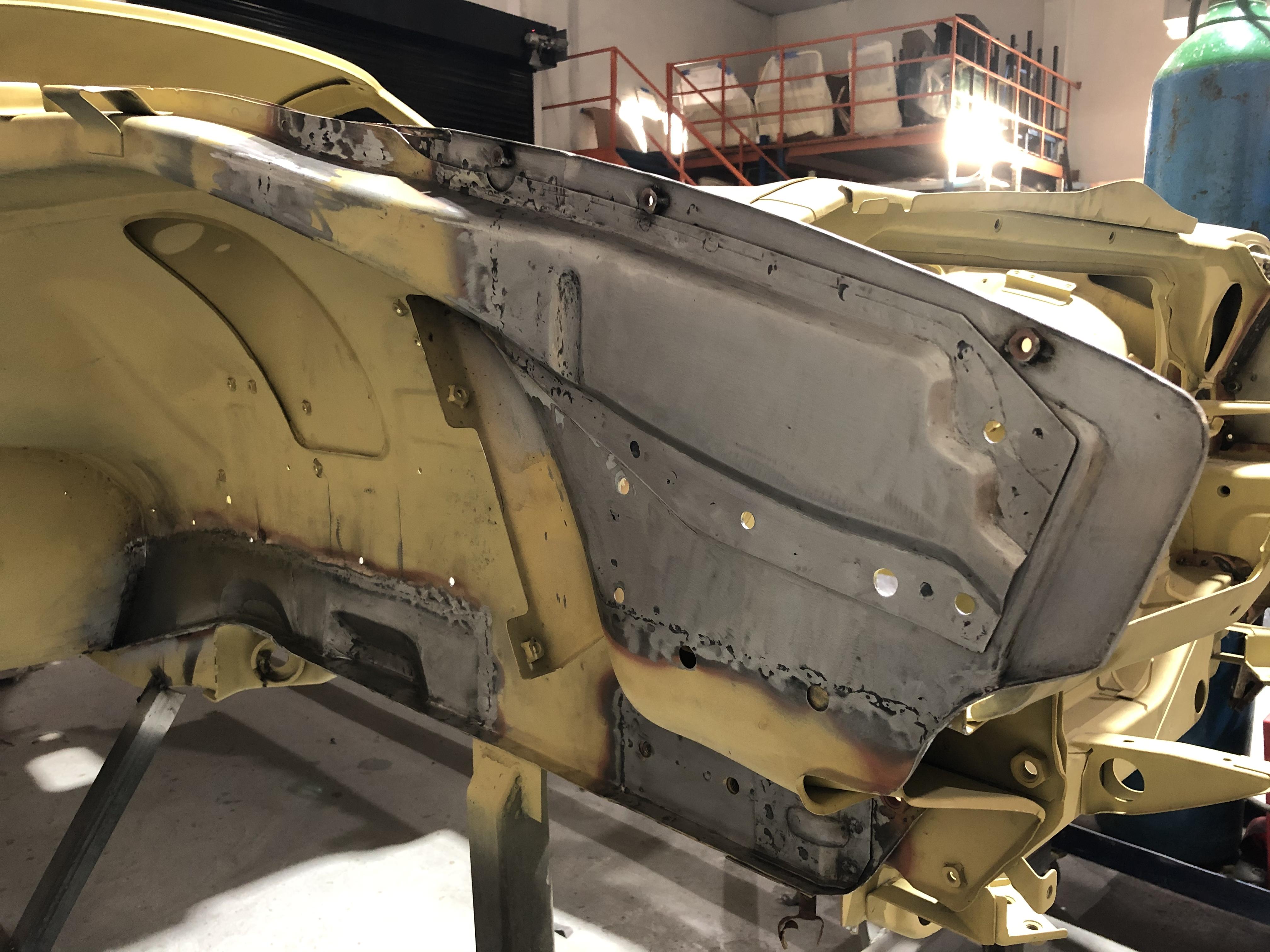

January 4, 20214 yr comment_613861 Welcome to the group! I salute you for taking on such an extensive restoration on a 280Z. It is a bit disheartening that so much was paid for a vehicle, to hadve it shipped across the ocean only to discover such shoddy collision and rust repair work was performed on it. Hopefully the seller was totally upfront with you on the true condition of the vehicle during the sales transaction. That said, the car is now in good hands, and will be given a better life. Looking forward to seeing pictures of the rebirth 😊  Edited January 4, 20214 yr by DatsunZGuy Link to comment https://www.classiczcars.com/forums/topic/64925-1976-280-z-from-ohio-to-dubai/#findComment-613861 Share on other sites More sharing options...
January 4, 20214 yr comment_613872 The orange needle really makes the gauge pop, possible to get a photo of the lights on? Link to comment https://www.classiczcars.com/forums/topic/64925-1976-280-z-from-ohio-to-dubai/#findComment-613872 Share on other sites More sharing options...

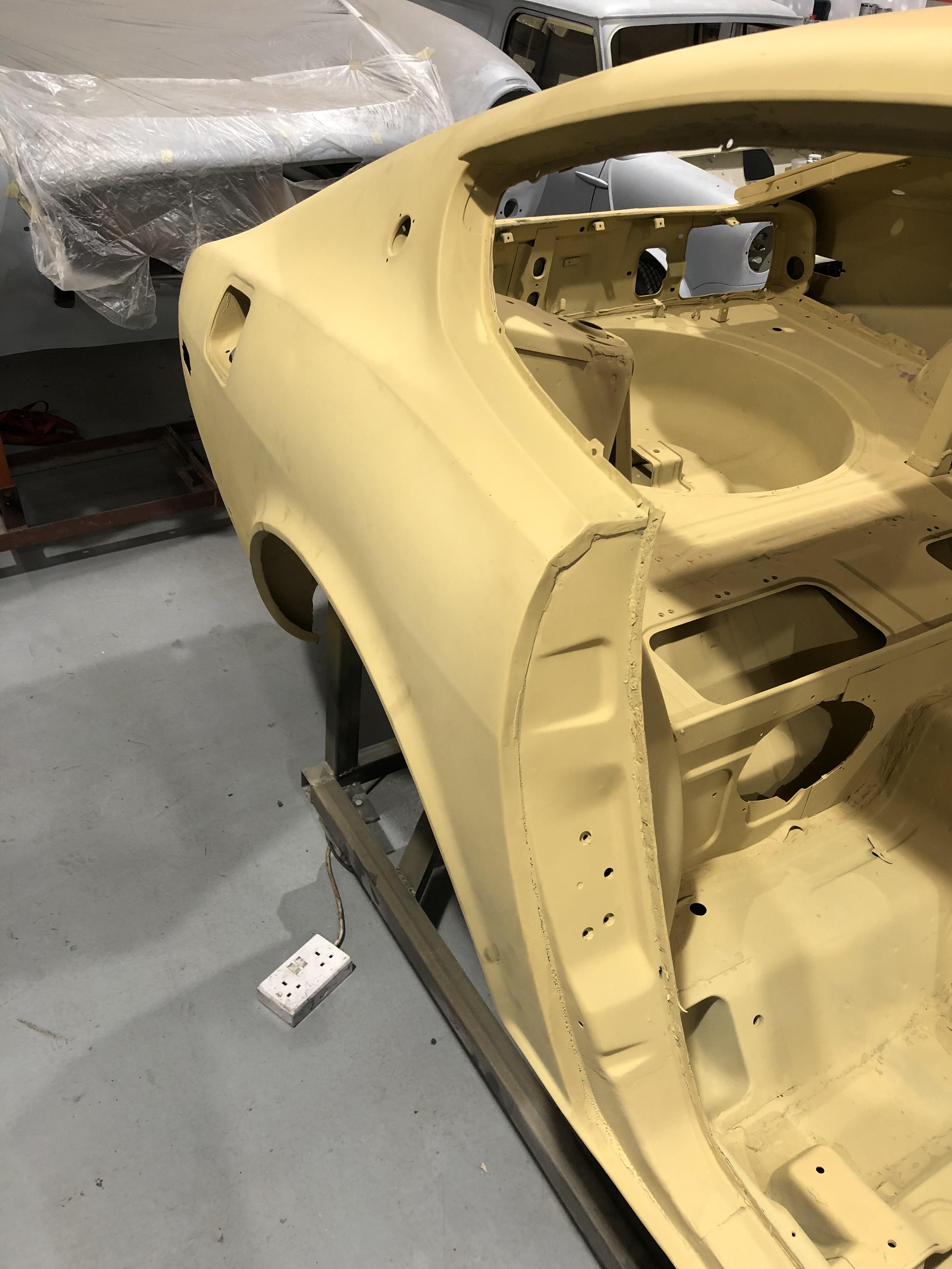

January 4, 20214 yr comment_613883 Good luck with the floor pans.... they aren't a "drop in" kind of repair at all! Â Link to comment https://www.classiczcars.com/forums/topic/64925-1976-280-z-from-ohio-to-dubai/#findComment-613883 Share on other sites More sharing options...

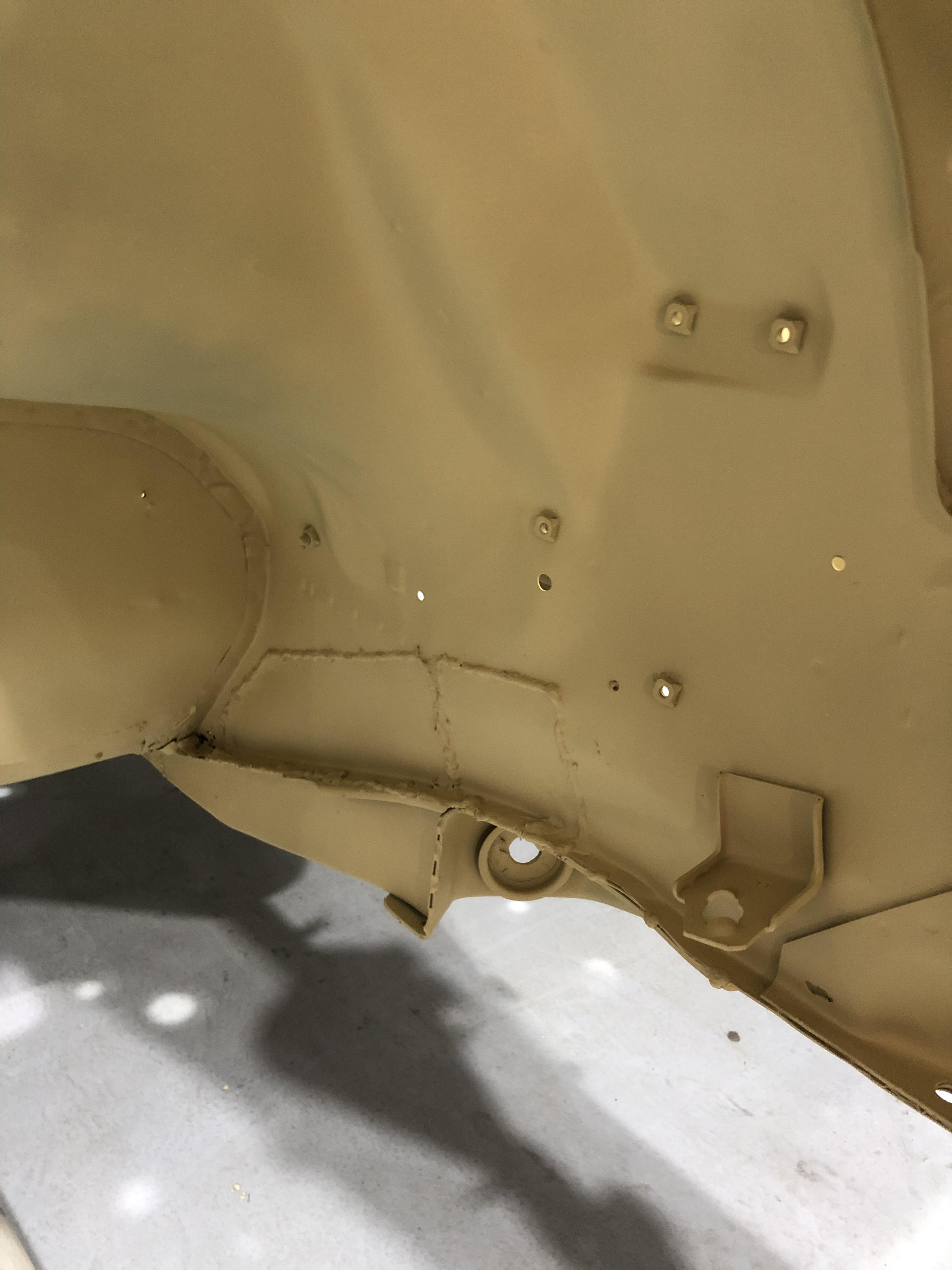

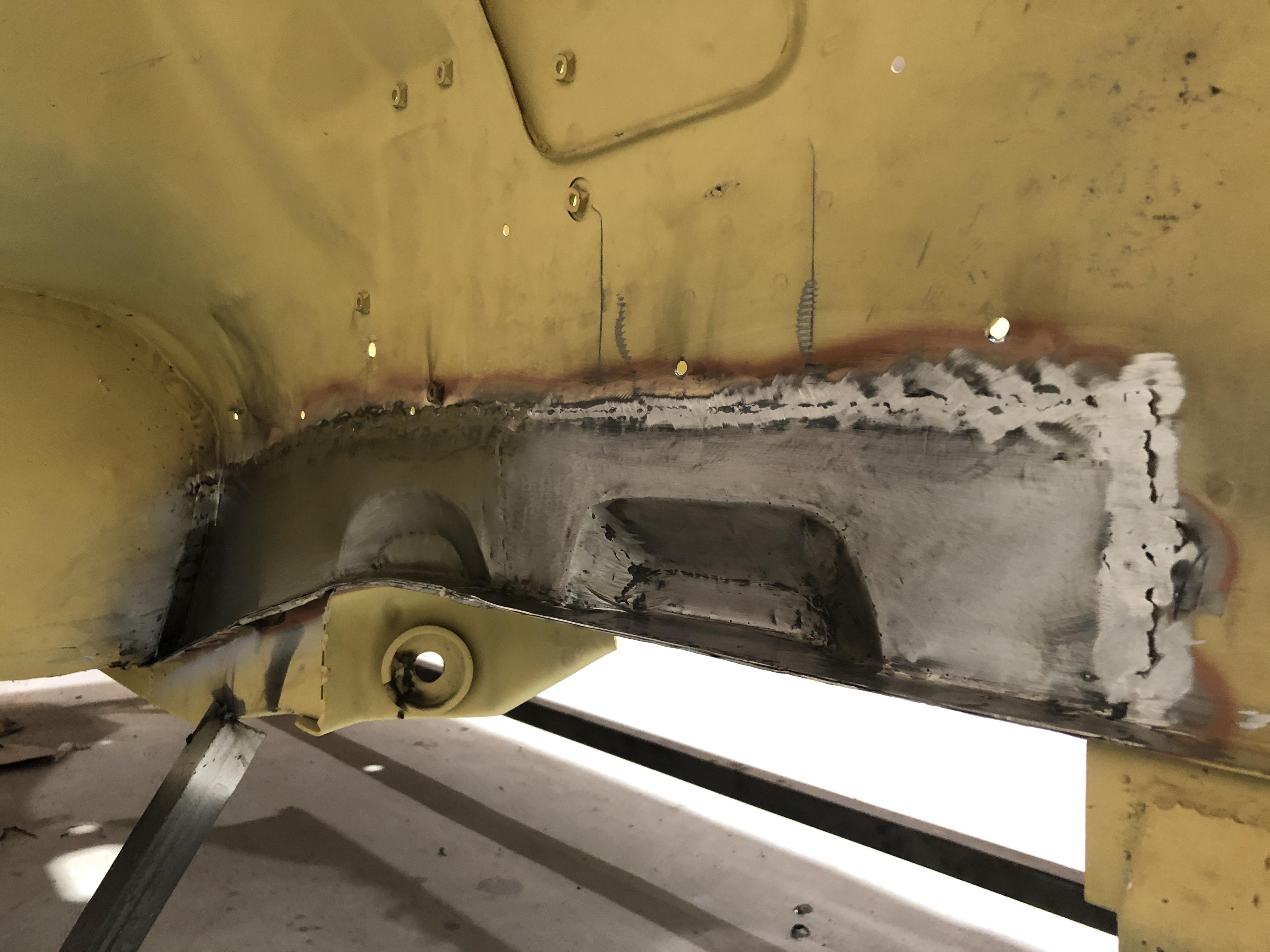

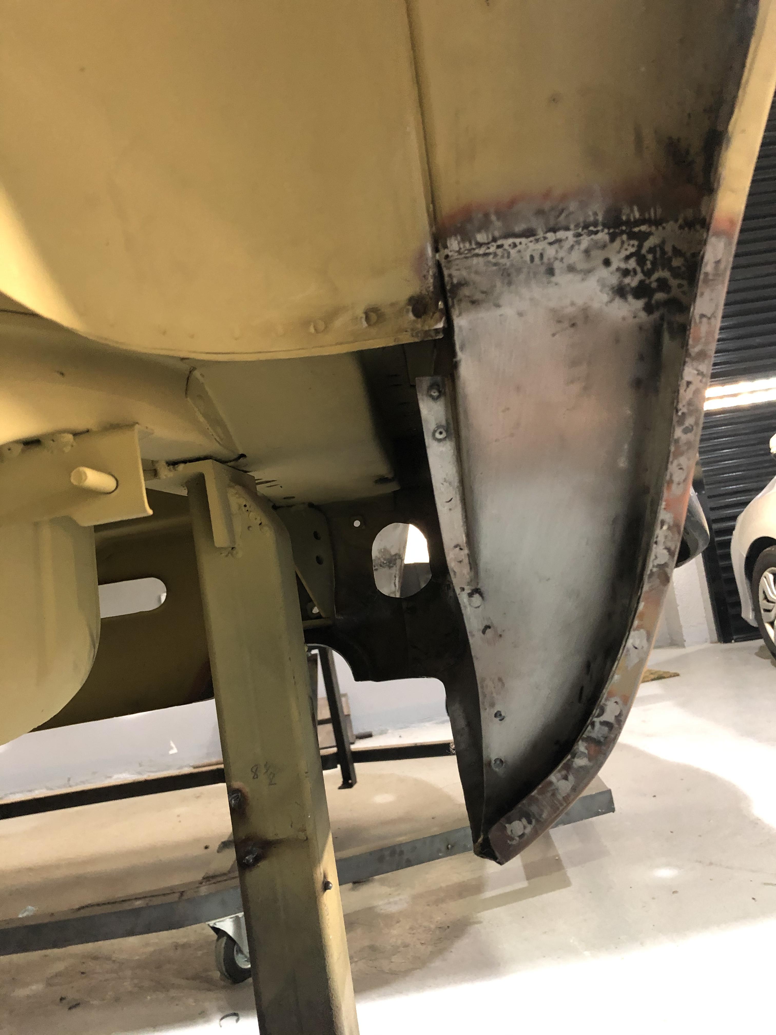

January 5, 20214 yr Author comment_613907 12 hours ago, DatsunZGuy said: Welcome to the group! I salute you for taking on such an extensive restoration on a 280Z. It is a bit disheartening that so much was paid for a vehicle, to hadve it shipped across the ocean only to discover such shoddy collision and rust repair work was performed on it. Hopefully the seller was totally upfront with you on the true condition of the vehicle during the sales transaction. That said, the car is now in good hands, and will be given a better life. Looking forward to seeing pictures of the rebirth 😊  Found it ! The previous owner was cool and provided many pictures of the car as it was displayed on BaT. The body repair invoices from 1998/1999 were also provided but not so clear, and not done during his ownership and I guess he never stripped the car down to check what was done already. Anyway, I got lucky to not have much rust for a car staying 40+ years in Nebraska / Ohio, with matching number engine, all the original ID plates, lot of spare parts (extra gearbox, extra diff., 4 shocks, historic from 1998 onward, original airbox +1 extra etc...) and a cool story to tell ! I am still looking for the original owner from 1976 and already managed to get in touch with the one from 19998-2006, who kindly made a request to the DMV in Nebraska. Link to comment https://www.classiczcars.com/forums/topic/64925-1976-280-z-from-ohio-to-dubai/#findComment-613907 Share on other sites More sharing options...
January 5, 20214 yr Author comment_613908 9 hours ago, heyitsrama said: The orange needle really makes the gauge pop, possible to get a photo of the lights on? Thanks buddy, I'll take and share some pictures once installed back in the car. Link to comment https://www.classiczcars.com/forums/topic/64925-1976-280-z-from-ohio-to-dubai/#findComment-613908 Share on other sites More sharing options...
