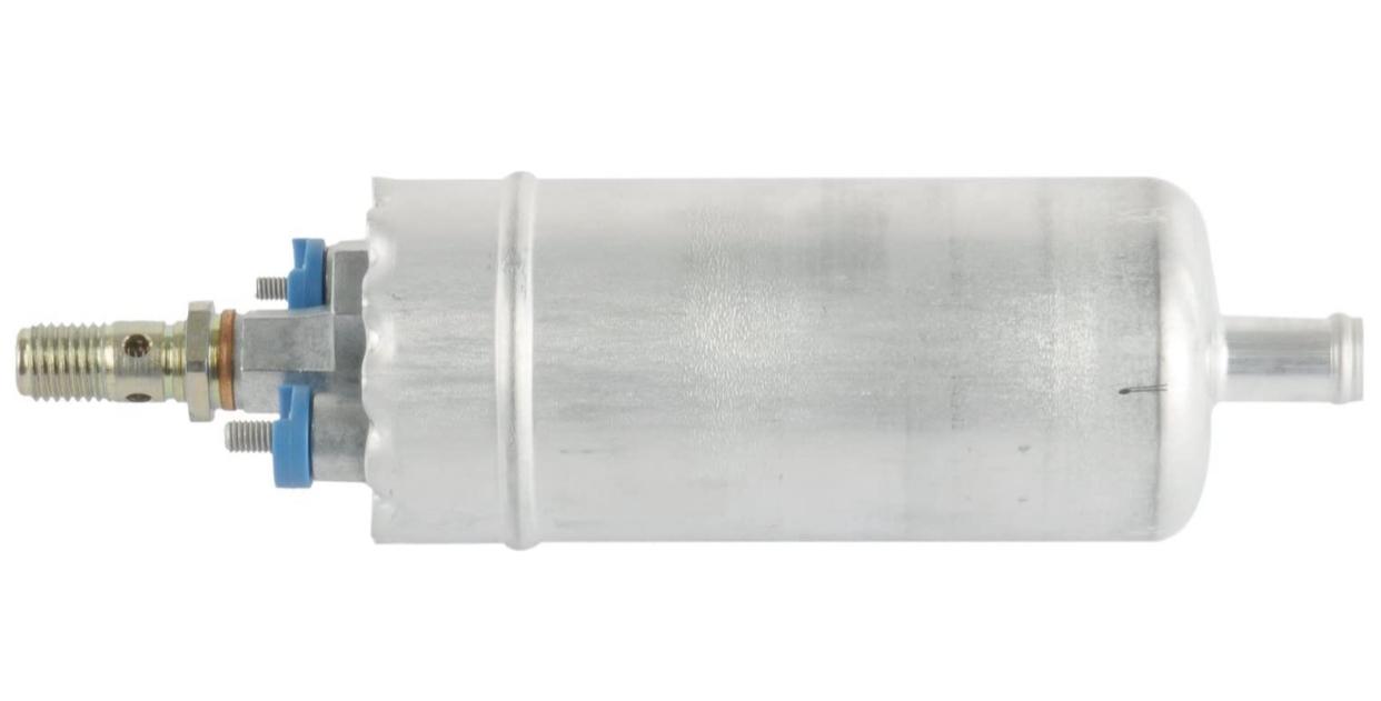

Bosch probably makes good quality.  Hard to say these days.  But that pump doesn't have barbs for the hoses, it's made for Ford fuel lines.  You want barbs on the high pressure side. I think the threaded end is outlet so you could probably find one.

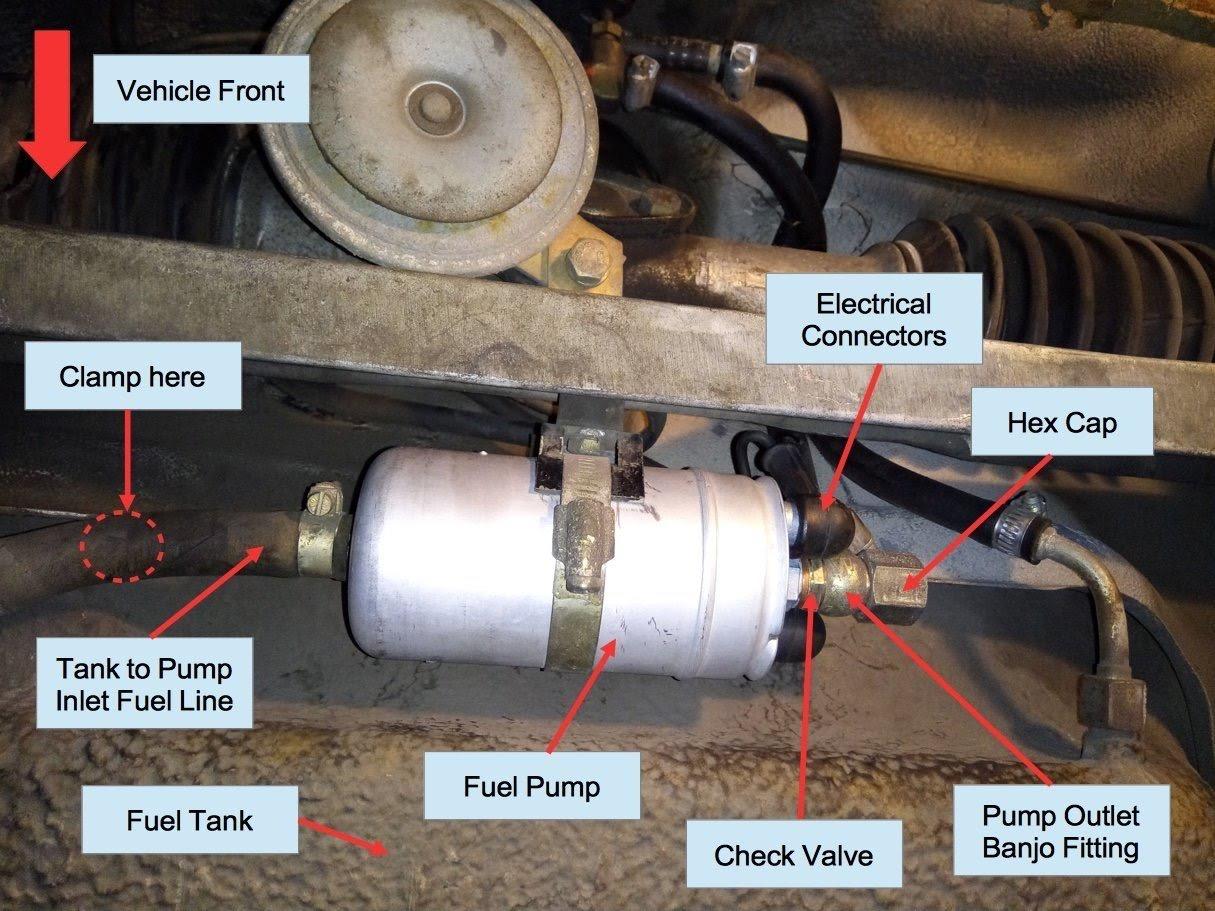

Where did you find the inlet and outlet info for the Bosch. I was trying to find that and just took a guess due to similar shape and size..
Bosch 69459 OE Electric Fuel Pump 1987-1990 Peugeot 505, 1974 Porsche 911, More https://www.amazon.com/dp/B000BZGHB0/ref=cm_sw_r_cp_api_glc_fabc_ltO6FbGH2FN7F
This fuel pump looks like it will work. I looked at a diagram for Porsche 911 and they have the same flow direction.
