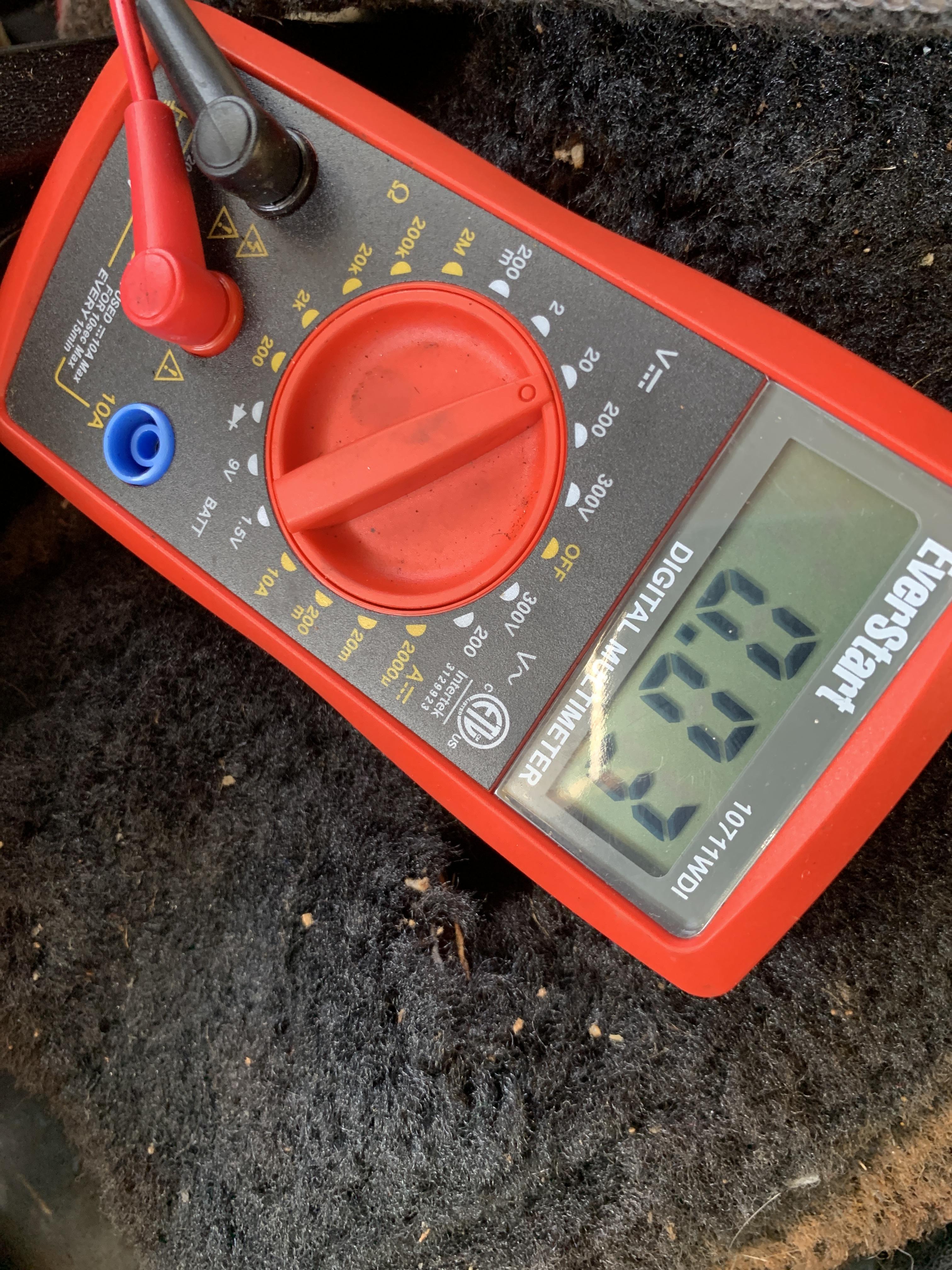

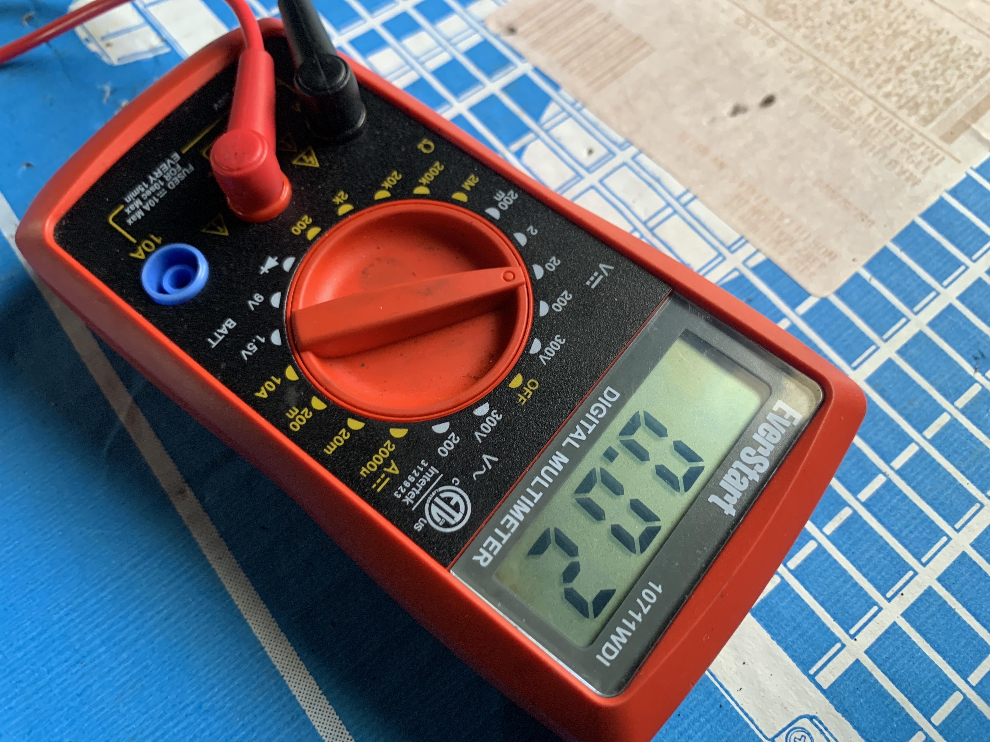

Update on the fuel electrical.. I’m getting .03- .05v to the pump wires. I’m guess it may be a bad ground or relay?
Describe the testing conditions:
Key position?
AFM flap?
If the key is on ON with the flap closed, the relay is not going to complete the circuit to supply power to the fuel pump.
The fuel pump relay does click when you put the car in the on position. How do I check if the voltage coming out of the relay is around 12 volts? Can I tried to unplug the connection between the relay and the green and blue wire in the car but it seems to turn the relay off.
You will need a probe that can reach inside the connector at the fuel pump relay. That will also mean you will need someone to move the flap in the AFM while you are measuring voltage. You will not see voltage for the fuel pump relay unless the key is in START or unless the key is in ON with the AFM flap open.
Key position?
AFM flap?
Key is on the on position afm untouched. I will try that. But when the car is on and fuel pump doesn’t make any sound.
I will also do the probe suggestion! And let you guys know what I find out
