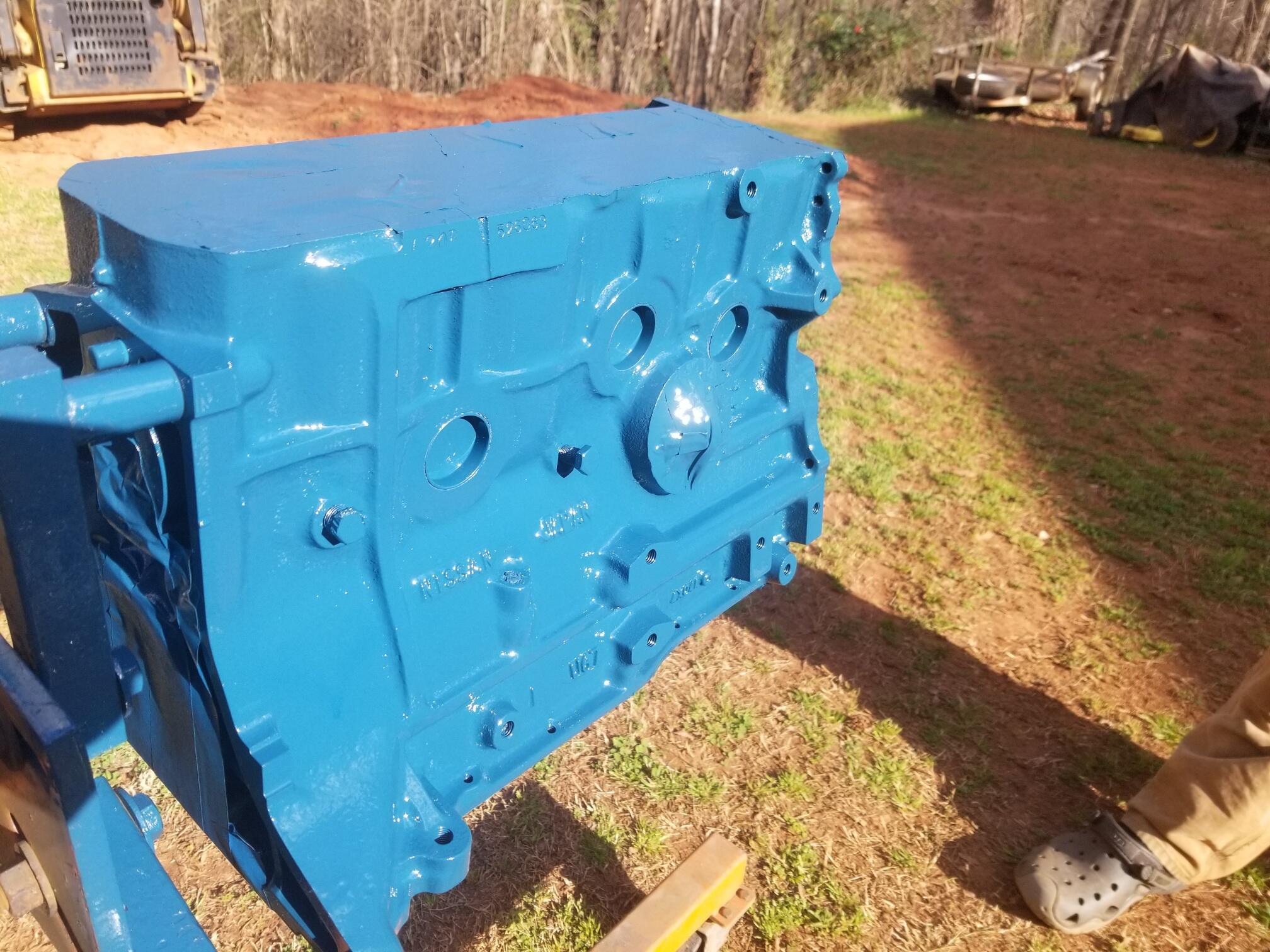

January 17, 20223 yr comment_634380 I sprayed Chrysler Corp Blue engine enamel on a couple of pieces. I’ve read that it’s supposed to be close but I’m not sure.To me it doesn’t look like it has enough green in it, but if you google the color some do look greener.Sent from my iPhone using Tapatalk Link to comment https://www.classiczcars.com/forums/topic/64870-l20b-codys-goon/?&page=2#findComment-634380 Share on other sites More sharing options...

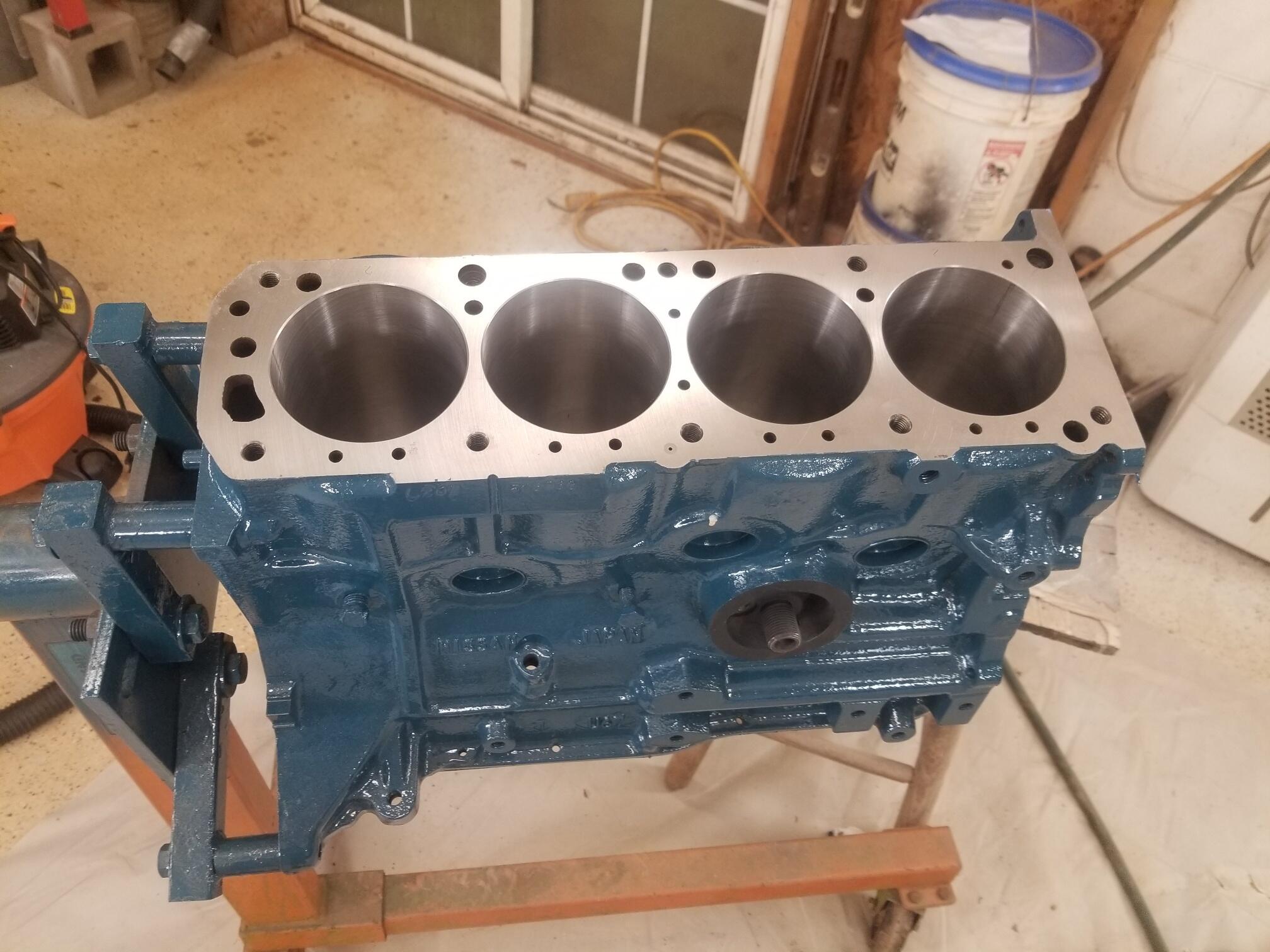

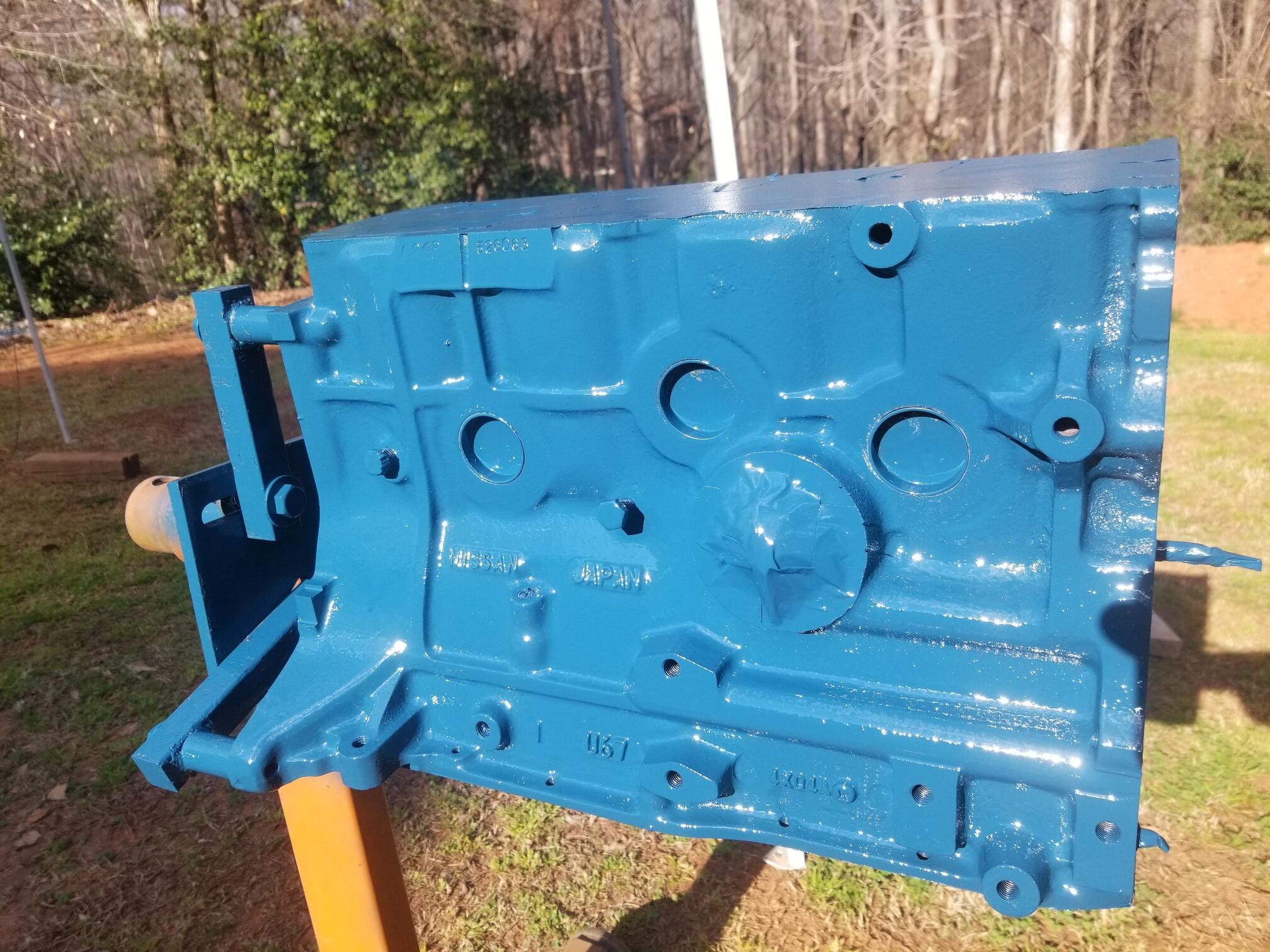

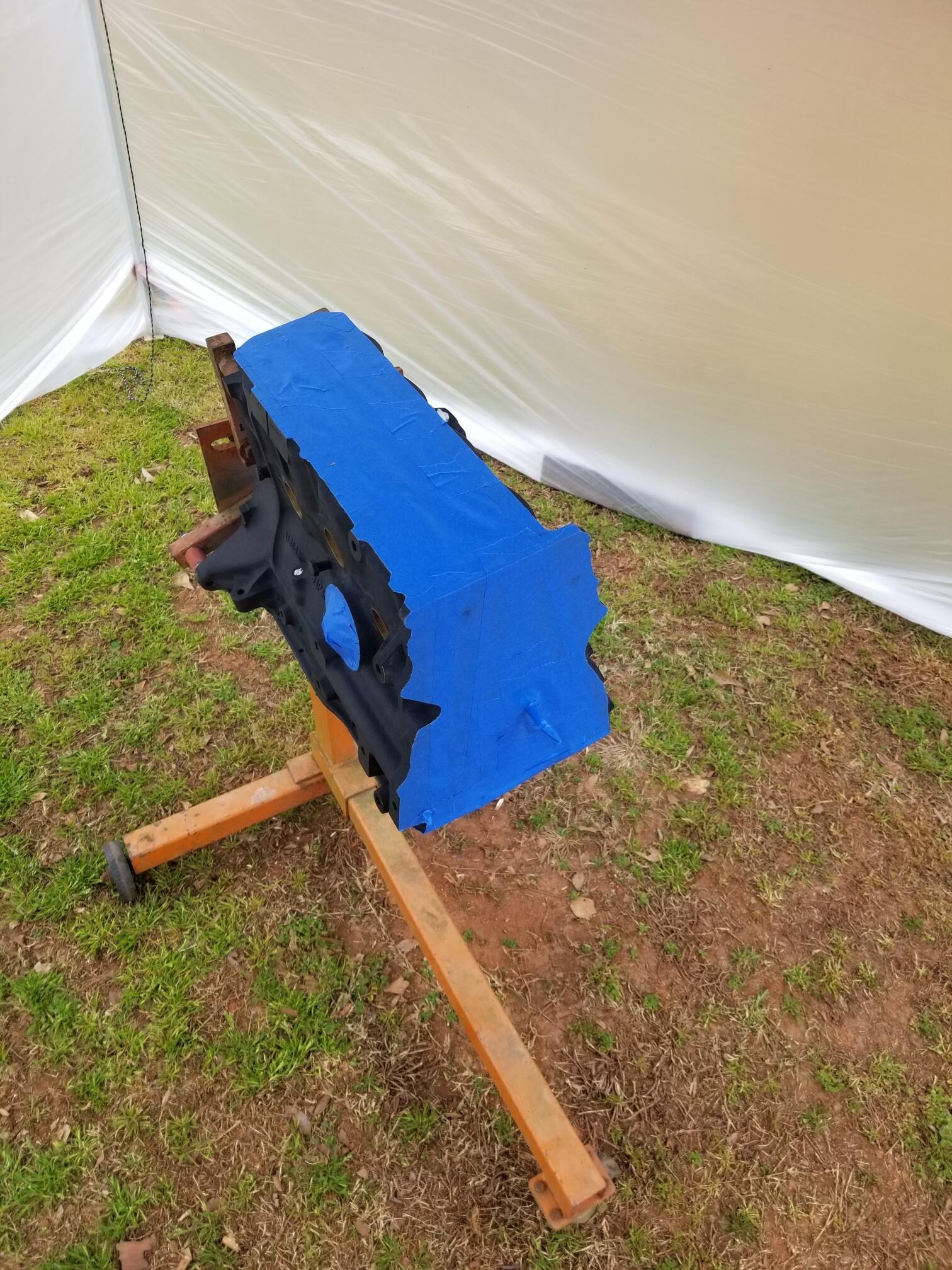

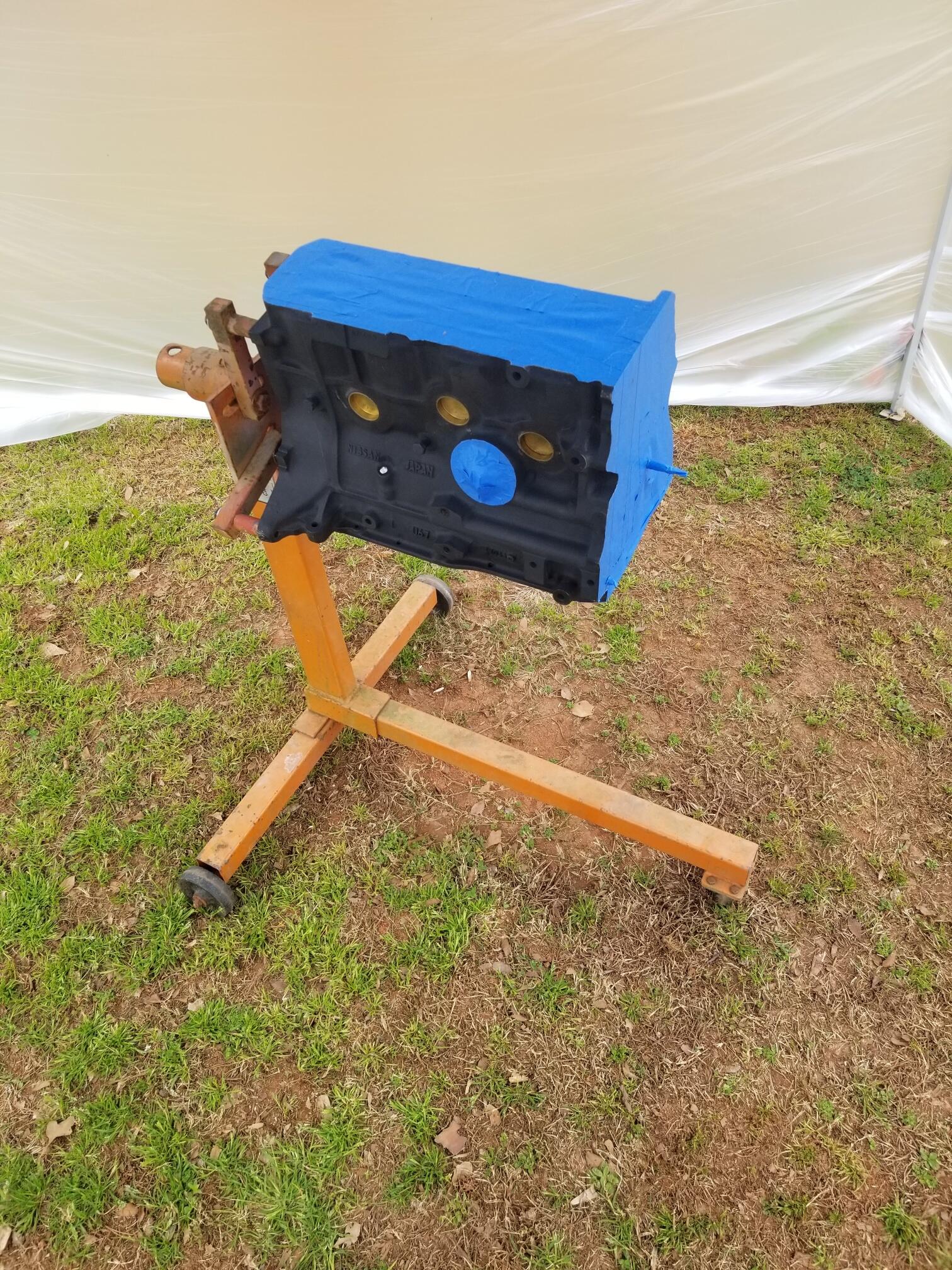

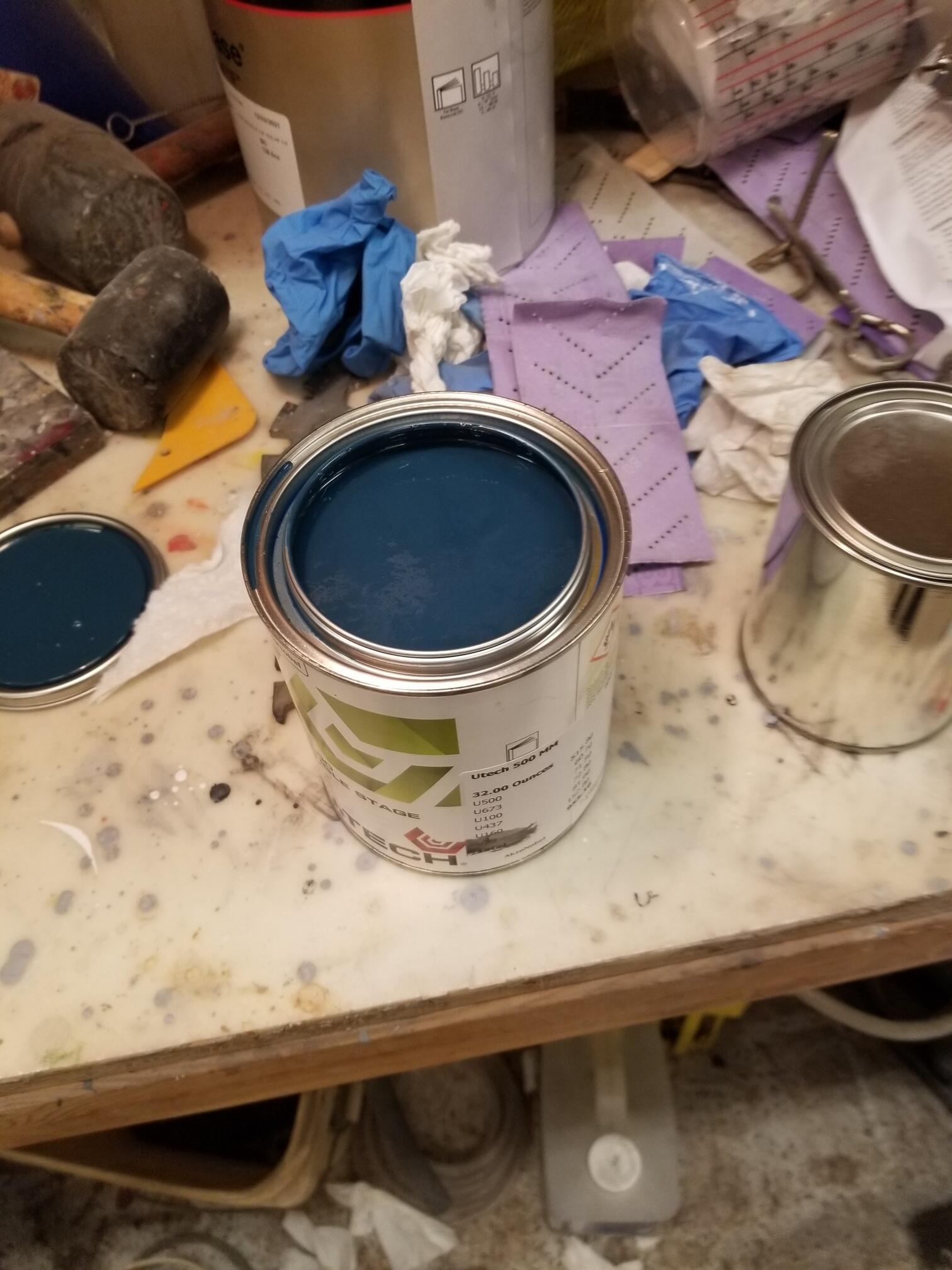

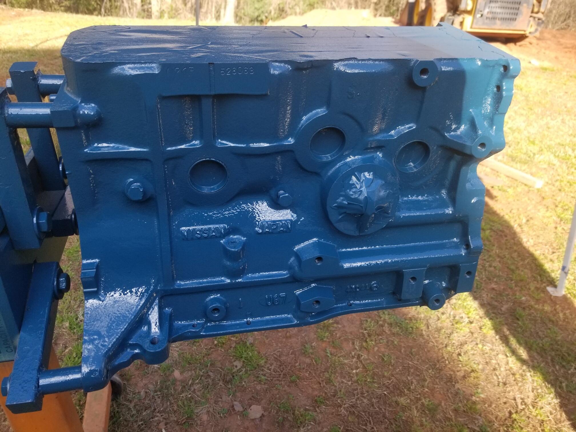

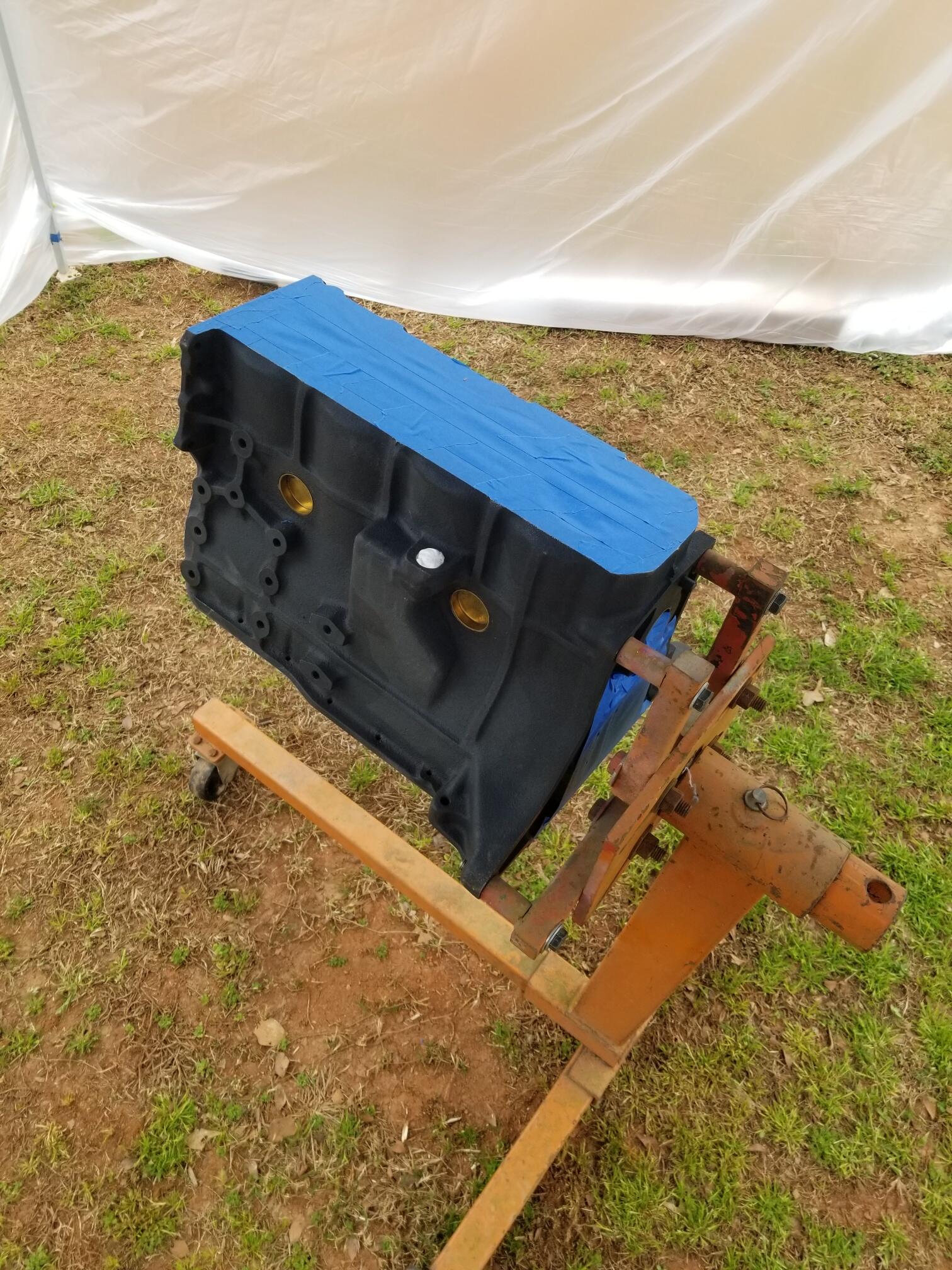

March 7, 20223 yr Author comment_636887 So i went to my local paint shop and had some single stage made up to match an alternator bracket that still had some factory blue on it. Cody got the block all taped up last weekend but ti was too cold. S o I sprayed it this weekend. It's much darker than it looks in the sunlight. Much more like the paint in the can looks. He is planning on working on the rotating assembly next weekend Link to comment https://www.classiczcars.com/forums/topic/64870-l20b-codys-goon/?&page=2#findComment-636887 Share on other sites More sharing options...
March 7, 20223 yr comment_636894 Just on the right, that spot with some sun on it tells me you just hit the jackpot i think.. thats the tippical blue NISSAN engine color! Link to comment https://www.classiczcars.com/forums/topic/64870-l20b-codys-goon/?&page=2#findComment-636894 Share on other sites More sharing options...

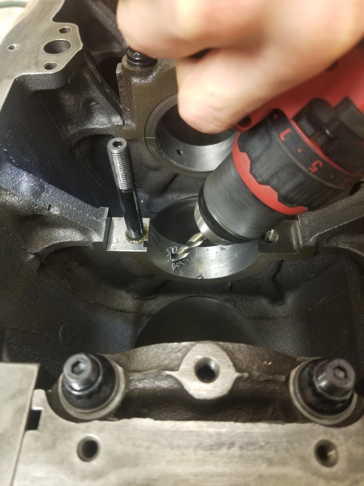

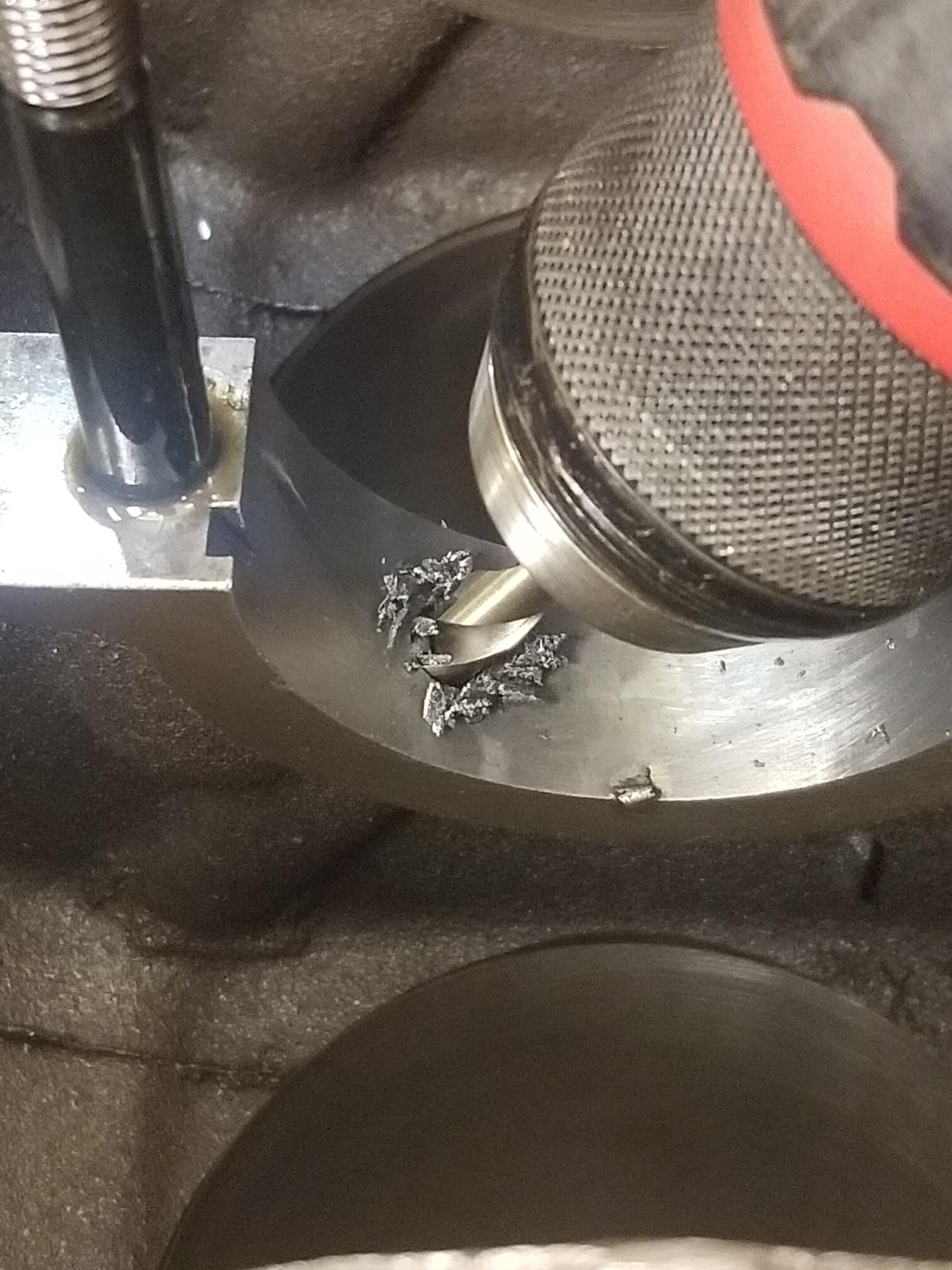

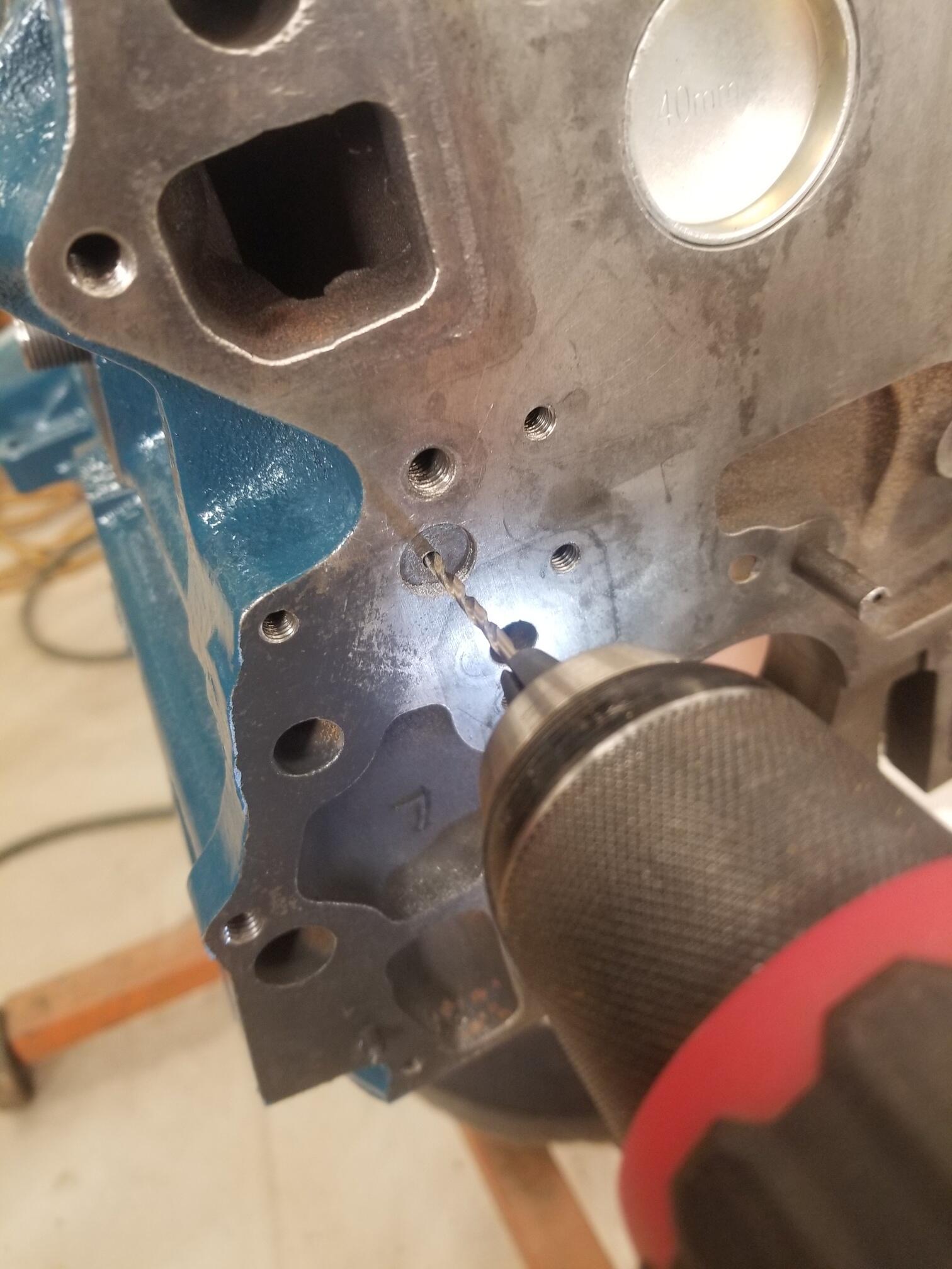

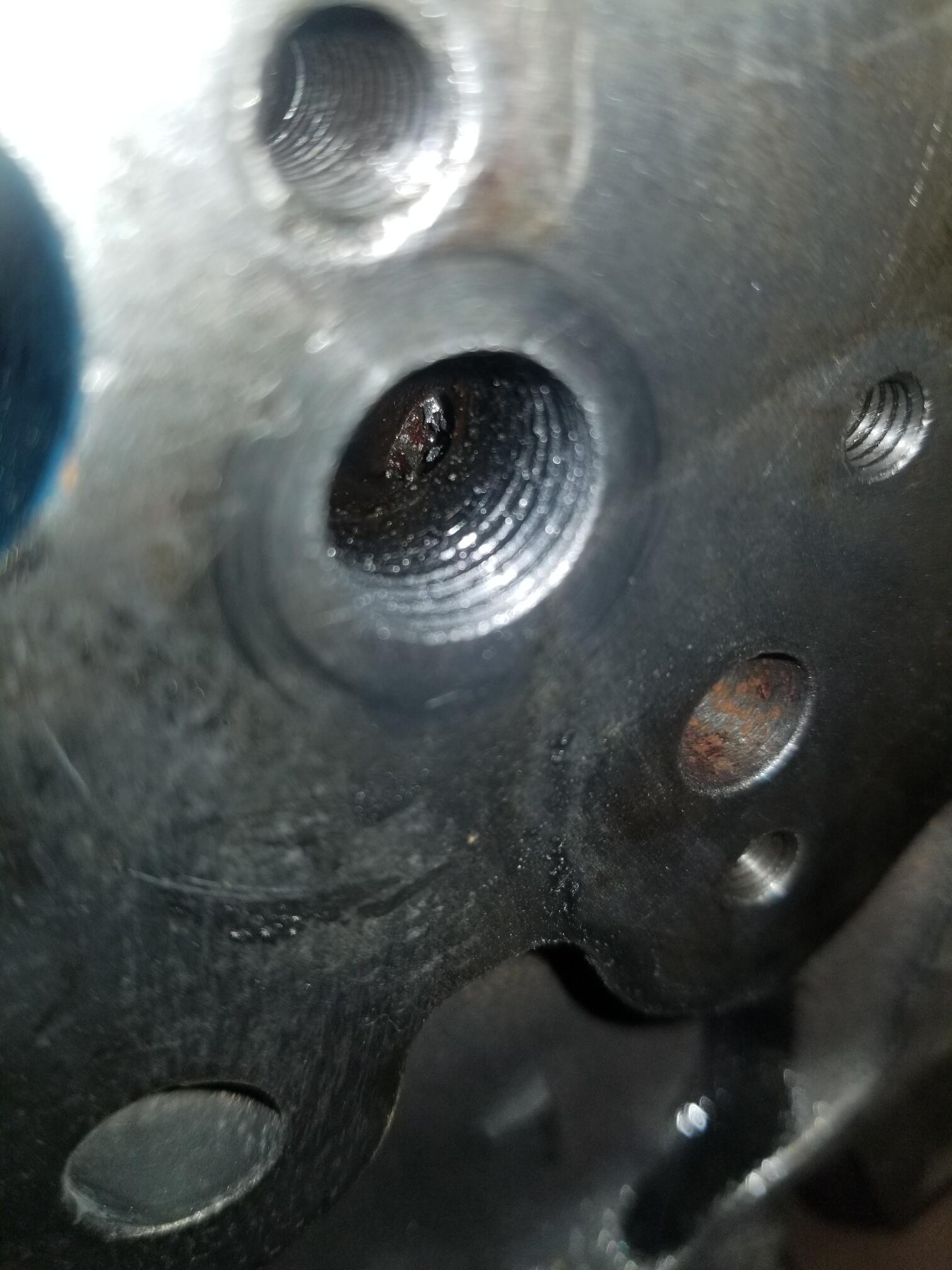

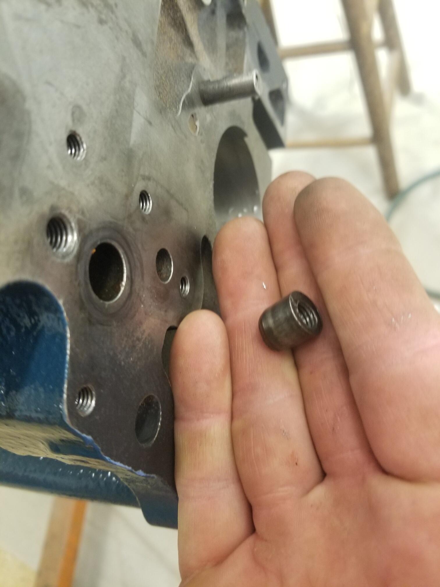

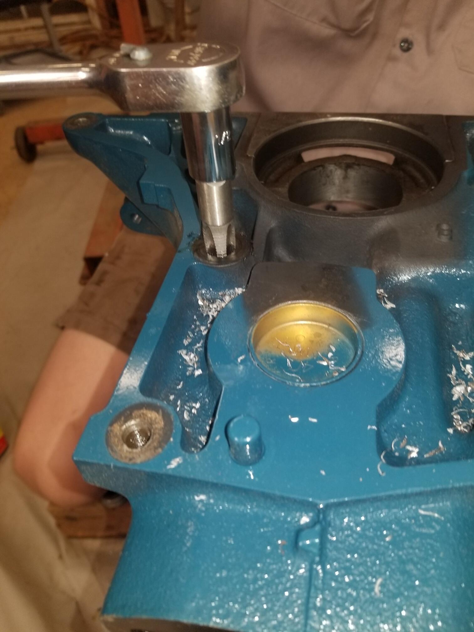

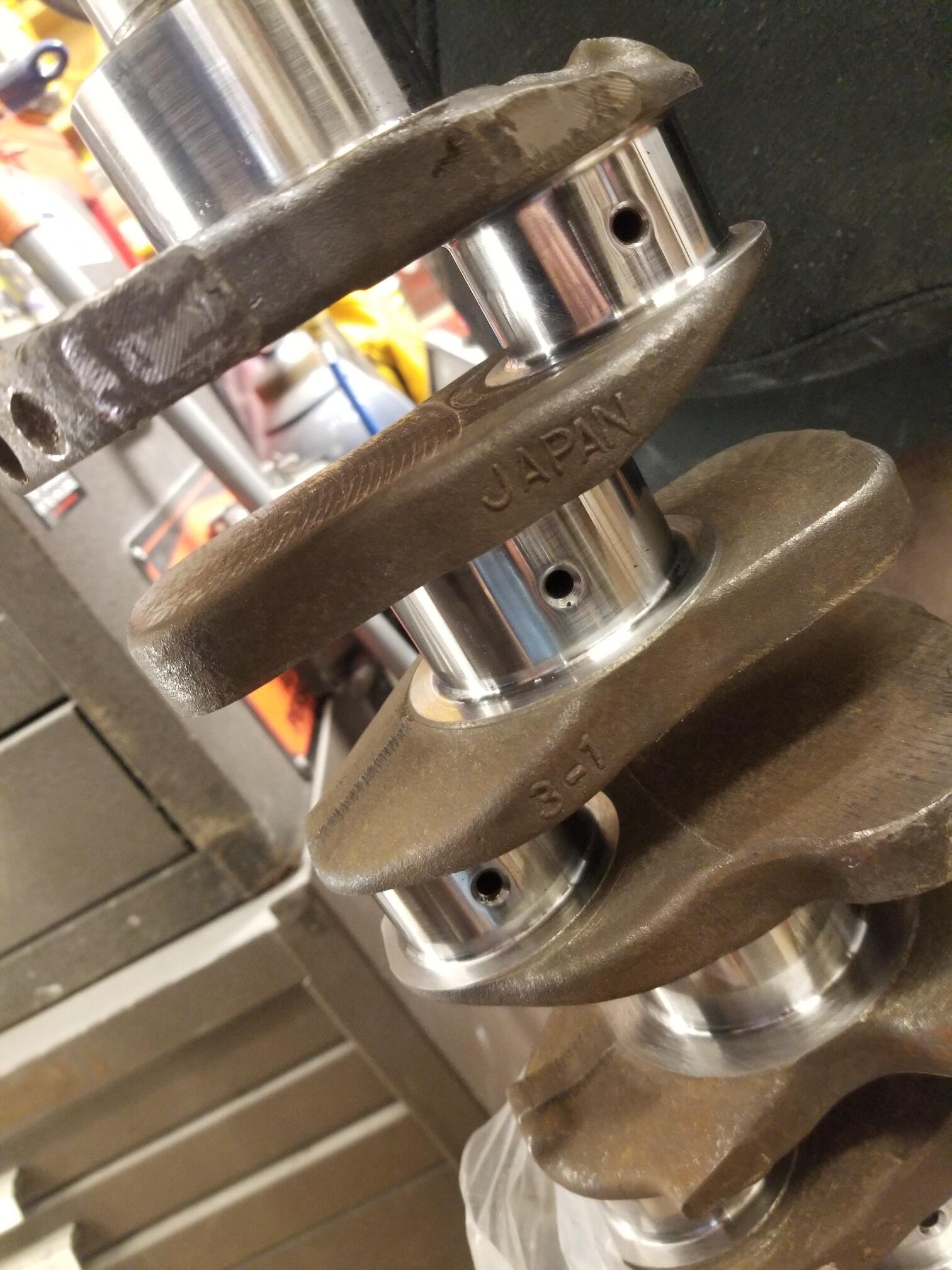

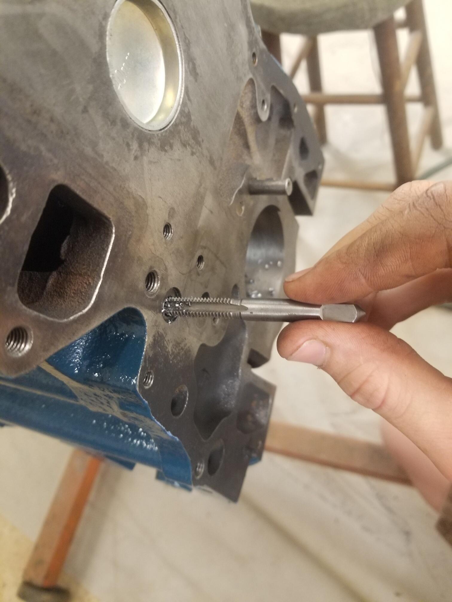

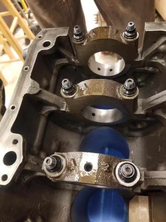

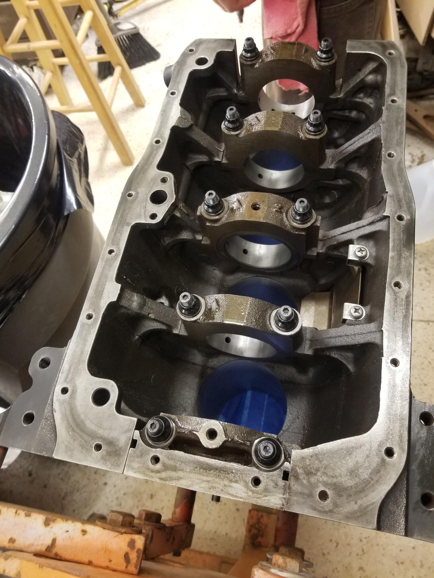

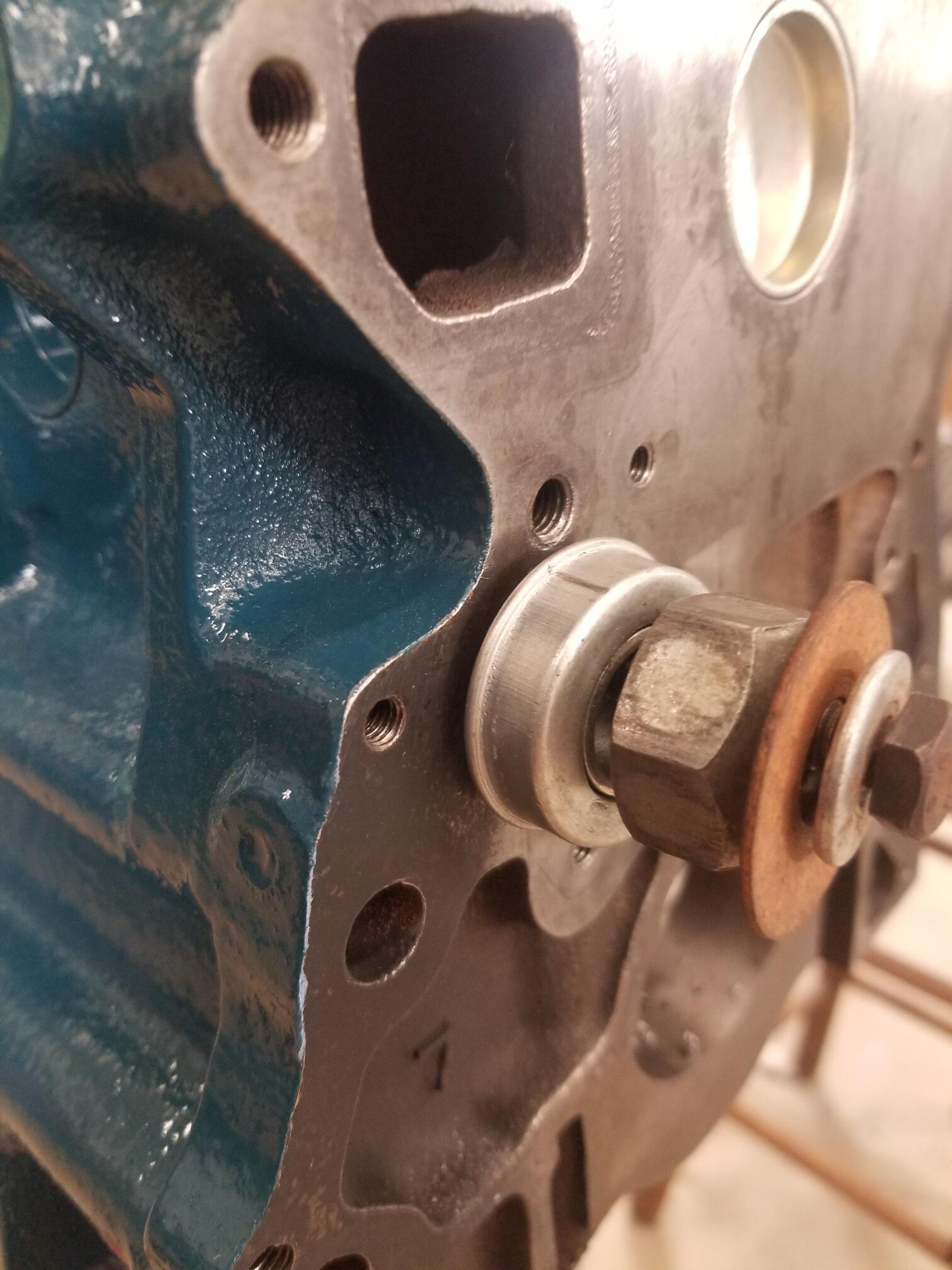

June 4, 20223 yr Author Popular Post comment_641238 So let’s see about a little update: Cody and I started working on his motor maybe a week ago or so We had to decide if we were going to drill the mains out or just slot the block side of the main cap and add a feed hole in the bearing. I looked in Honsowetz’s book and he recommends opening those feed galleys up to 5/16 or 0.313”. Which if I calculated it right is a 62% increase. So Cody and I discussed it and felt more comfortable with drilling the mains. Partly because we’re not making a lot of grit in the engine block. We started by getting the end plugs out of the main galleys. That way we could properly clean and wash the block later. They were stouter then I expected… A little homemade puller big enough for the plug to pass through it We didn’t want to drill the supply mains and realize we couldn't get the main galley open to clean it out. Then we worked on tapping the ends of the main galley for brass plugs We may have to make these deeper but I didn’t want to make them too large since the 3/8 NPT tap is tapered. On to drilling… So this is really sketchy because the metal drills pretty easily but only the very edges of the bit are cutting. We used 3 different sized bits to work up to 5/16”. They didn’t need to be special because you’re not drilling overly deep. We were concerned we might break a bit but with a little cutting oil it went pretty good. We were going to clean the block up and get ready for setting the rotating assembly but I can’t find the main bearings I bought! I went by the machine shop last Tuesday and he didn’t have them. Even though I’m pretty sure I took them, but I can’t be sure I didn’t pick them up. The problem is, right now they seem to be unavailable everywhere. Neither Clevite or King. I found some vintage TRW’s on ebay I have coming my way and I have an order in for some Kings from another place. Hopefully one of them will get here soon. Cody would like to have a running car by Zcon. He will have to hustle! It’s doable but he will have to focus to get it done. Link to comment https://www.classiczcars.com/forums/topic/64870-l20b-codys-goon/?&page=2#findComment-641238 Share on other sites More sharing options...

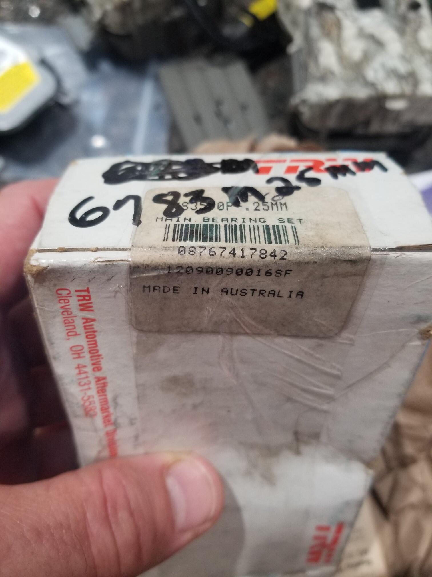

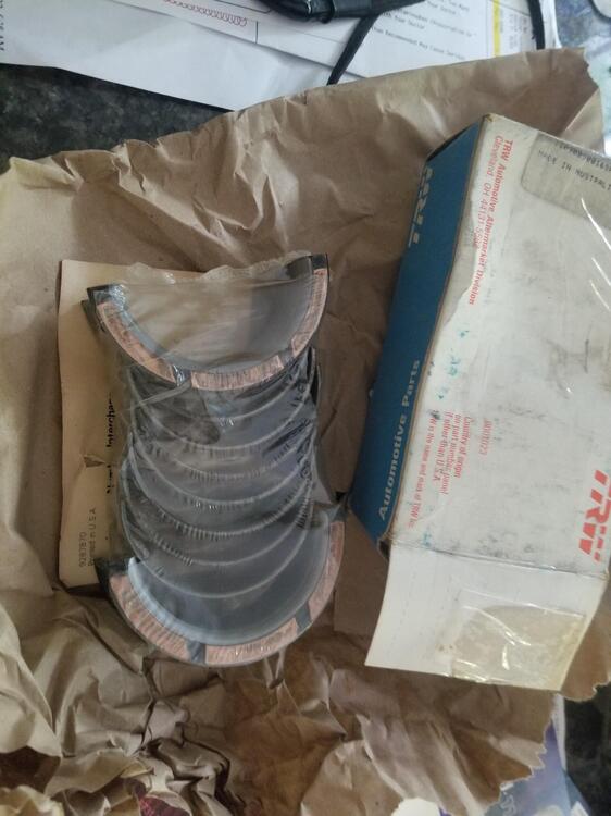

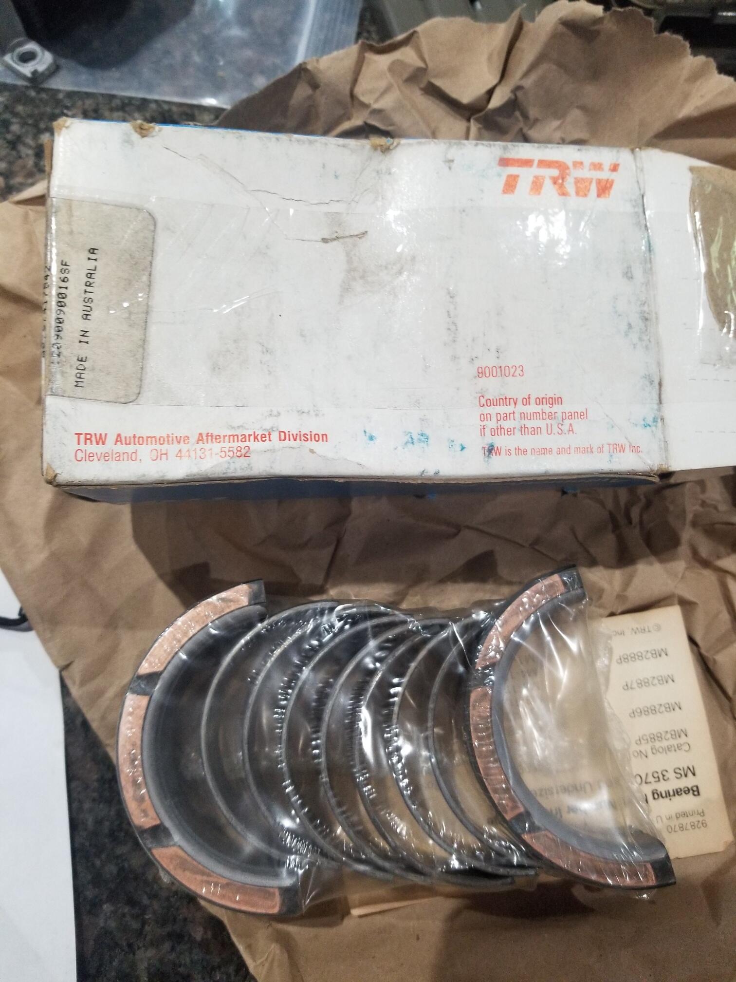

June 11, 20223 yr Author comment_641438 So I received the vintage TRW bearings yesterday. We may end up using these. We'll see Link to comment https://www.classiczcars.com/forums/topic/64870-l20b-codys-goon/?&page=2#findComment-641438 Share on other sites More sharing options...
