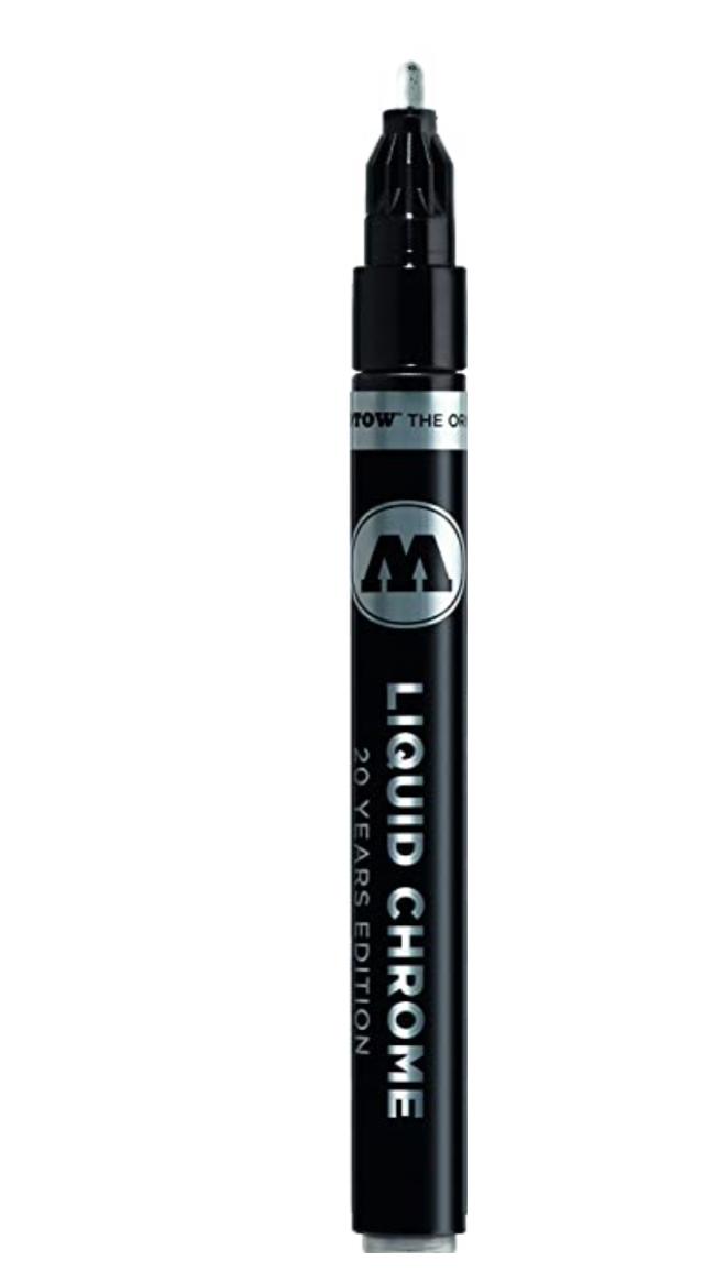

Has anyone used Molotow Burner Chrome Spray Paint https://www.hobbytown.com/molotow-burner-chrome-spray-paint-150ml-mlw443/p823931

I've used Molotow and it works OK for narrow lines but it might not be the best option for a part that requires a wide area since you'll end up with "brush strokes".
