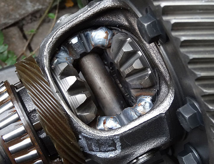

Here are some images of welded diffs.  Some people just do a few solid welds, some people go crazy and fill every crevice.
Here's a funny article about the "benefits" of welded diffs.  Those open diffs are unpredictable!
Edited by Zed Head

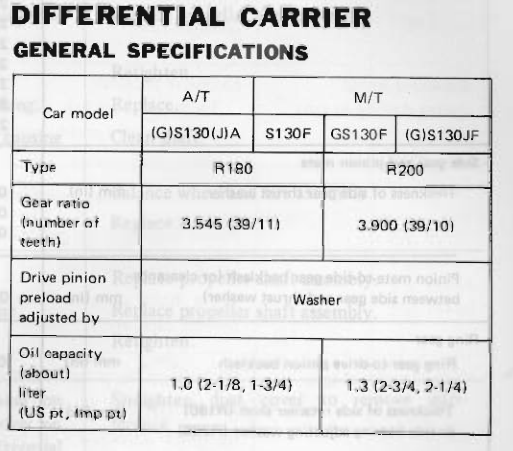

39/10 is what you're looking for on the ring gear stamp.
that looks like it would make turning very difficult. I guess if you  were drag racing this would be helpful. Would really scrub off rubber if you were to turn with a diff modified like this.
They do it for drifting.  It's just a cheap hack, just need a welder and some welding material.  I wonder if anyone has tried JB Weld.  That would be a great JB Weld ad.
Hugely helpful Zed, this is a perfect visual.
