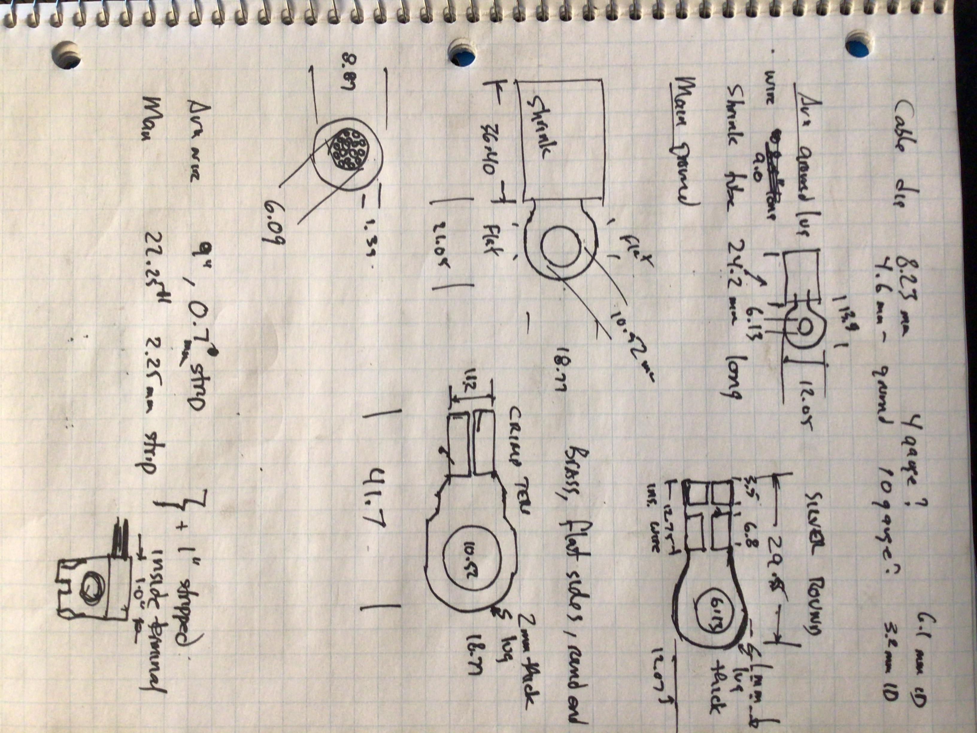

I really don’t want to get in the reproduction parts business, at least not yet. I do want to produce “reasonable” items that come close to the originals at first glance at a reasonable price for my own projects.
I will include my rough notes and doodles of the detail measurements of my negative cable. Sorry for the not-perfectly readable scribbles. No I’m not a doctor.

When I posted above I had not yet read your exchange with Rich (motorman7) regarding creating the cables using the Pep Boys type terminal ends. You guys continually amaze me in your inventiveness and adaptations using off the shelf pieces, getting very acceptable (reasonable) results.
To Everyone: Please accept my apologies if my comments appeared to be disparaging of anyone chosing to make their own. That was not my intent.
