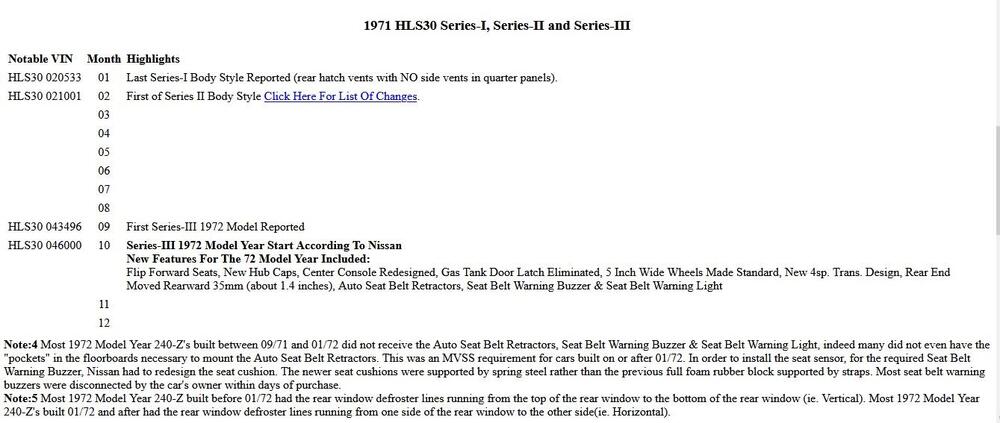

Here's a screenshot of a section from a page on your zhome.com site where no less than three of these 'Series' definitions pop up within the same production year of 1971. We have chassis numbers ('VIN') given as end and start dates for lists of new equipment and spec changes, as well as 'Model Year' added into the mix.
Clearly, 'Series' numbers are being linked to content:

So 'Series 1' and 'Series 2' etc are shown - QED - to be inaccurate, ill-defined and - finally - superfluous terms, right? What's really important are the full chassis number, the exact market variant/sub-variant (a suffix becomes handy here) and the production date. Then we consult the factory literature.
