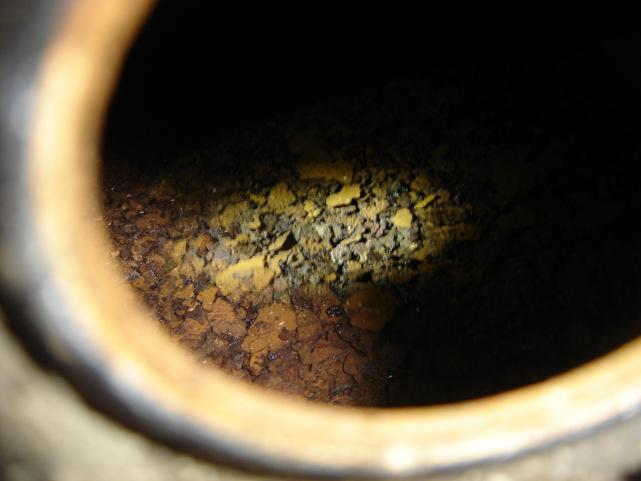

Next time it dies take the hose off the bottom or "in" of the filter. Blow back to the tank with your lungs. If it's hard to do at first then gets easier, and you might also hear some bubbling noise from the tank, my guess would be a crudded up gas tank. Your problem and attempts to fix are exactly like mine when I bought a '72 that would only run long enough for me to get away from my house and then walk home to get help towing it back. Then I tried the blowing back trick to clear the gunk out. That would let it run long enough to get home.
Here's what came out and a shot with a borescope. It wasn't rust just years of rotten gas that turned to varnish. Goodluck, I hope you figure it out. Cliff
