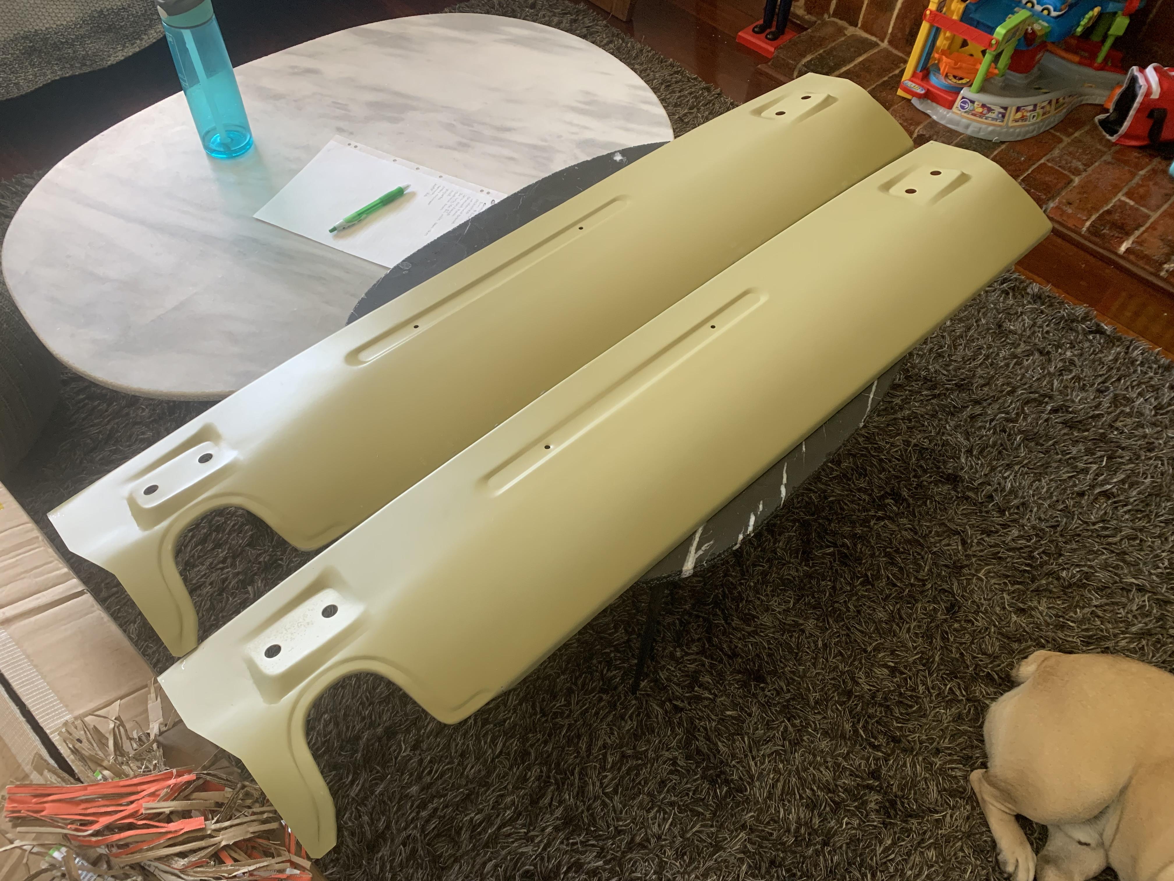

Early Xmas present arrived...
out of the uk from auto panel solutions
Ryan - I'm being uber dense - these look like a rear lower valence (??) but, if so, why do you need two? I haven't worked on this area at all so probably don't understand at all how the sections are made up.
Not dense at all Jon! I only need one, I shared the shipping costs with another guy to get it to Australia from the uk. 140£ (~200USD) to ship it!!!! By the time I finish the restoration I think I will have spent more in shipping than buying the car!

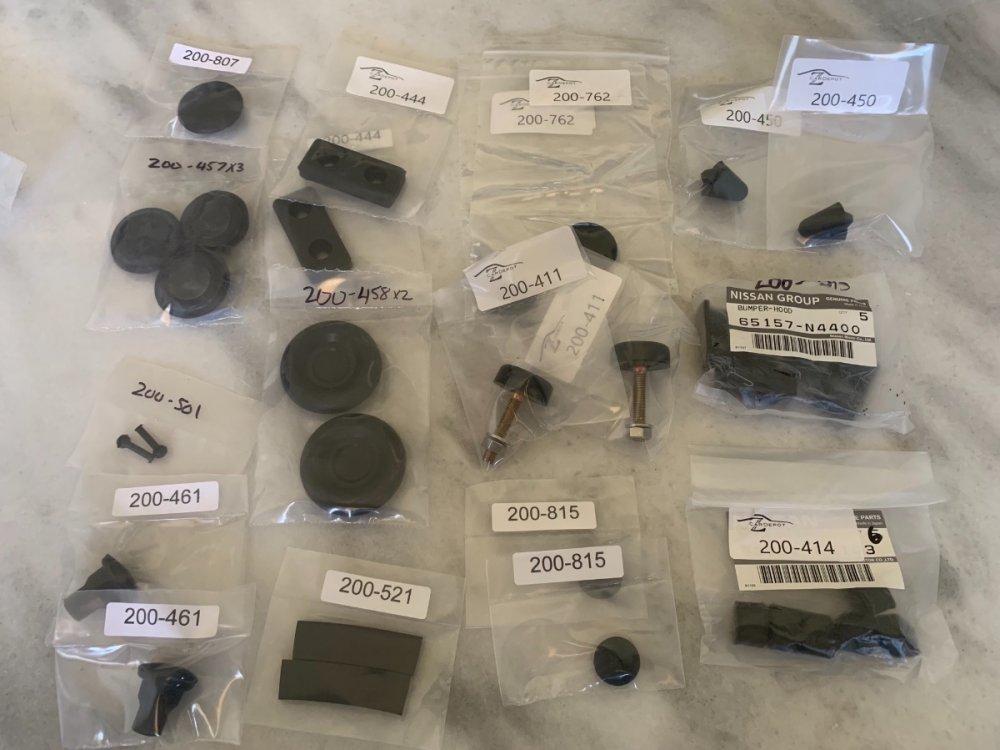

weatherstrip kit arrived along with rubber and grommet kit all from z car depot. I am 90% confident that the zcardepot kit is straight up the precision kit. All parts are corresponding to precision’s part numbers, arrived in a precision box, some parts did not come in precision branded packets but upon watching some of the precision installation videos on YouTube some of the packaging looks unbranded. Also came with a precision kit packing list. So unless z car depot goes through the trouble of  restickering all their kit with precision part numbers. I’m pretty sure I have a precision kit. What I don’t get is the 200 USD price difference? Zcardepot 289 USD and from precision 468 USD!
Rubber bumper and grommet kit was a bit of an impulse buy, but contains a lot of parts I assume I’ll need at some stage.
My rationale in these purchases is that I will need door seals to start gapping panels and doors when I replace my outer rockers. Zcardepot had black Friday sales which meant the amount I saved covered the shipping I have to pay to get it to Perth. So I pulled the trigger.

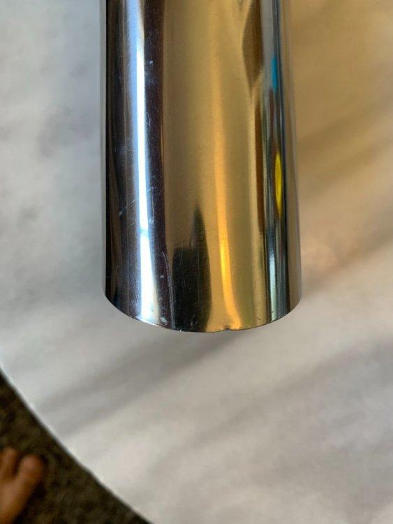

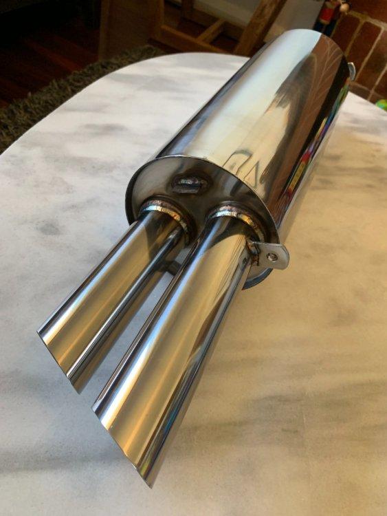

I did receive my blemished zstory jdm muffler. Which is a very nice unit, and for 260$ aud including shipping I couldn’t resist. I don’t know what my plan is to minimize the blemish just yet. slight damage during shipping but nothing unfixable, may just need to have a machine shop shave the tip.
Take a round piece of hard wood (piece of your broomstick) and give the pipe some little hits with it, from the inside of the pipe.. you will get that super smal dent out.. Just carfully with small hits. 😉  (or scuff it with the wood from inside to outside.. take your time. )

the SU carb guys in Oregon should be able to hook you up with SU carb hardware.
Like Zed pointed out, a bit of wood on the inside (hardwood, like oak, or even better, ironwood), and use a hard plastic mallet on the outside to tap down on either side of the downward deformation should straighten it up. You will likely need to sand and polish the stainless after, to clean up any marring or scratches.
It won’t even be noticeable.
Thanks X I have packed the muffler away for now but I will give this ago when the time comes, thanks for the advice.
