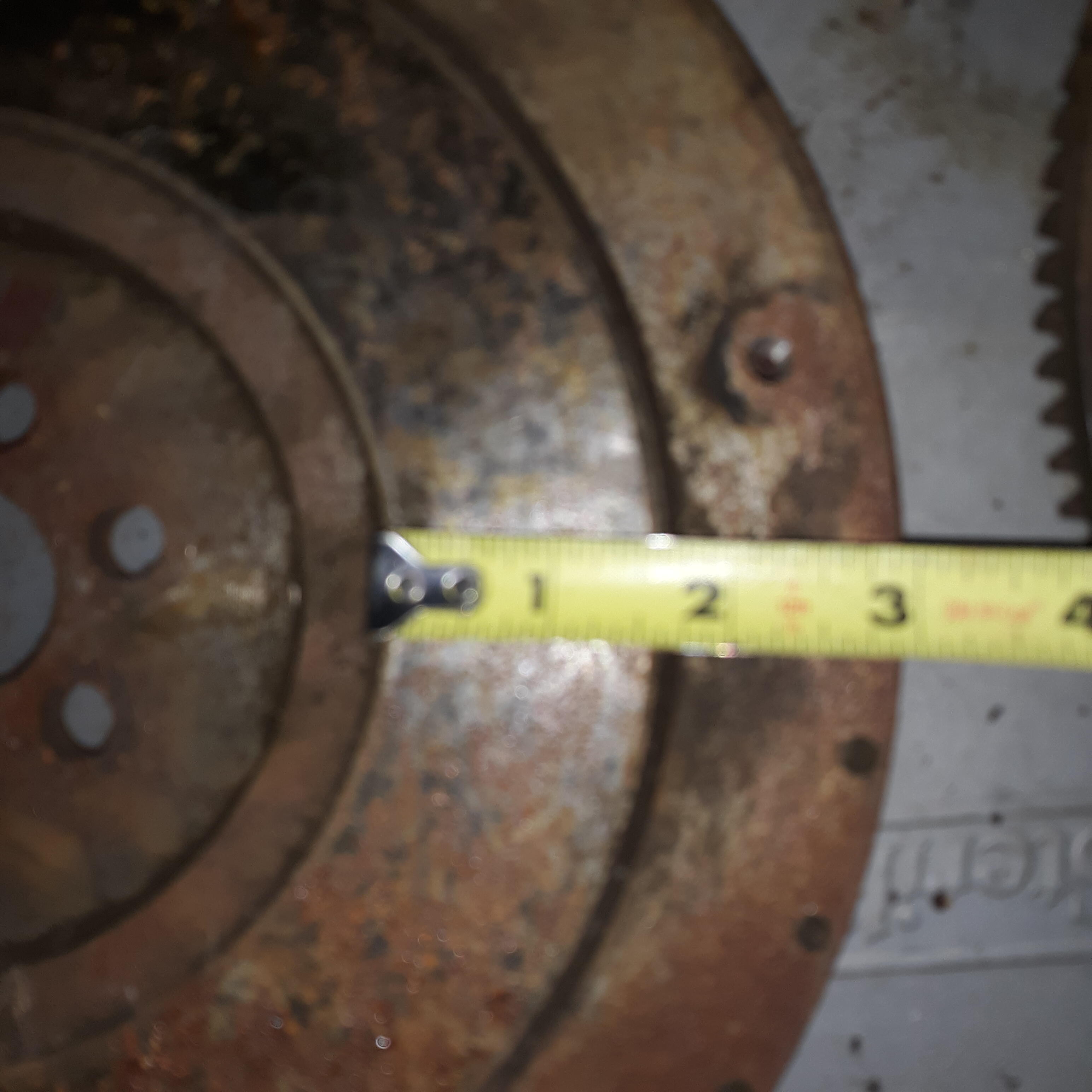

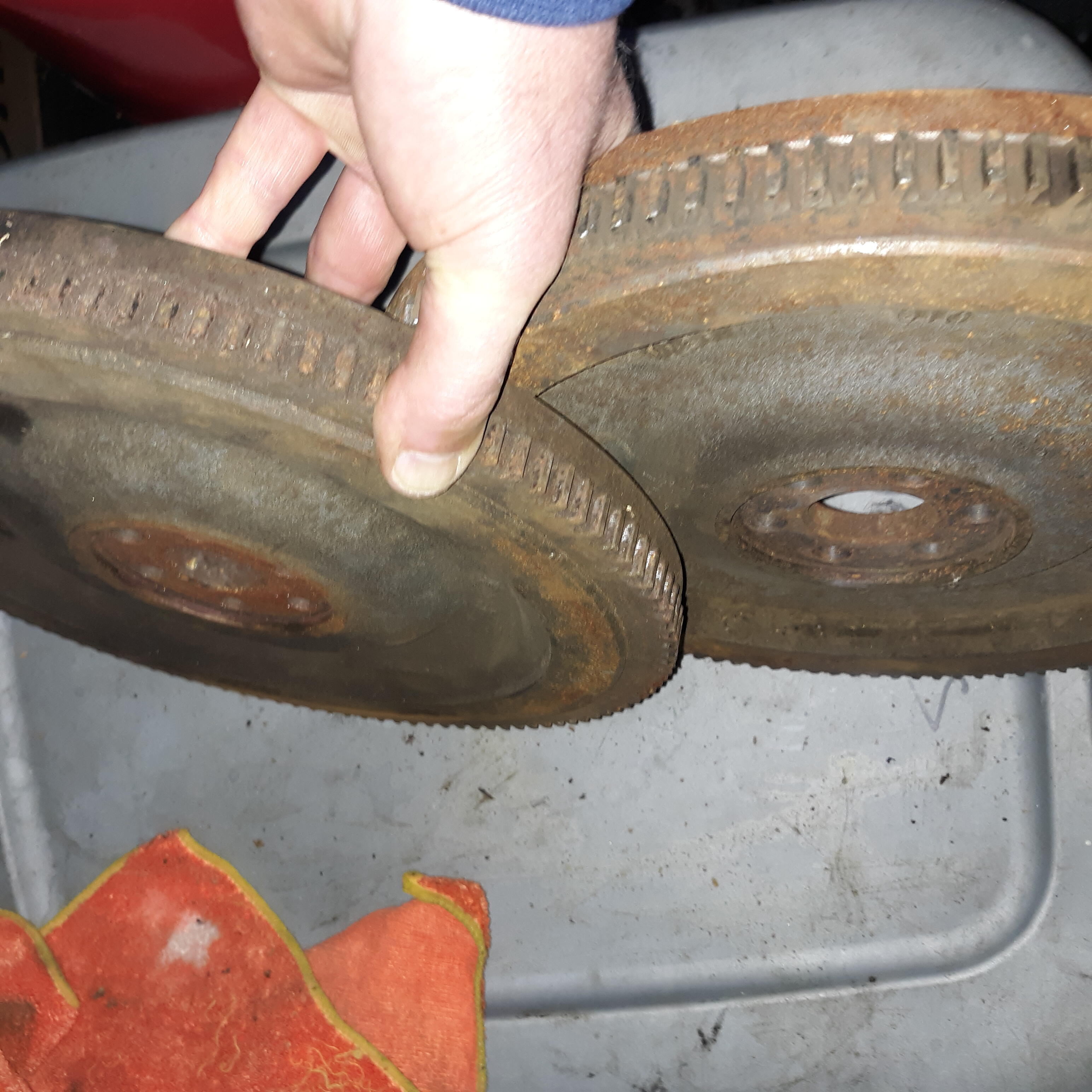

now here’s a dilemma. The flywheel below was pulled from a 2+2 in 1995 or so. It was a ‘77 2+2 at Autogator in Sacramento. But I only unwrapped it today. What do I have? Did someone put a coupe driveline in a 2+2, or is this a 2+2 flywheel?

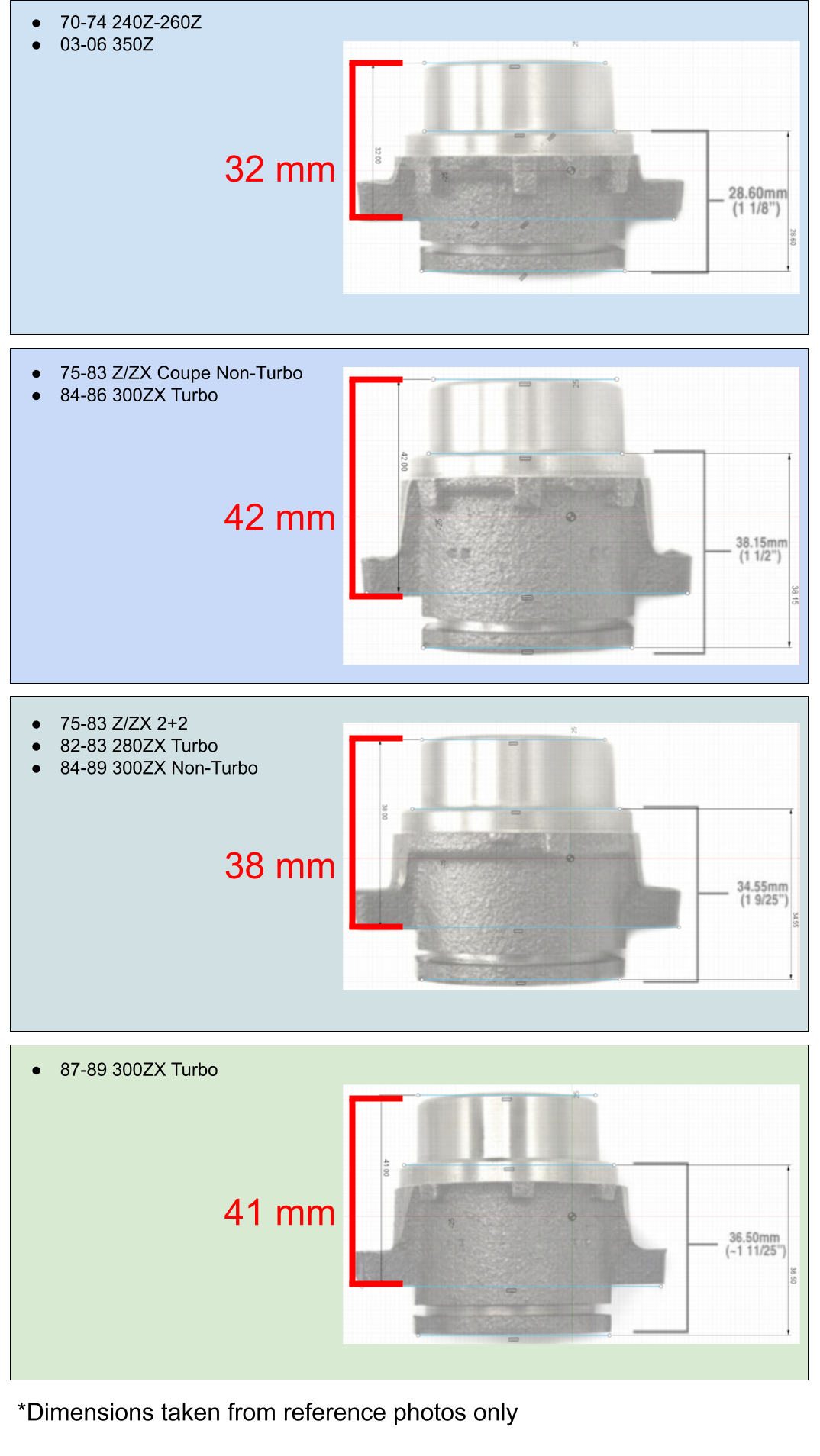

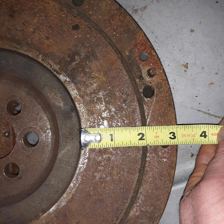

Looking at my 225 and 240mm hubs, yours looks like a 240mm. I took some measurements of the friction disc of both and a crappy pic of the difference in the hubs. Hope it helps.
225mm
240mm
Edited by siteunseen

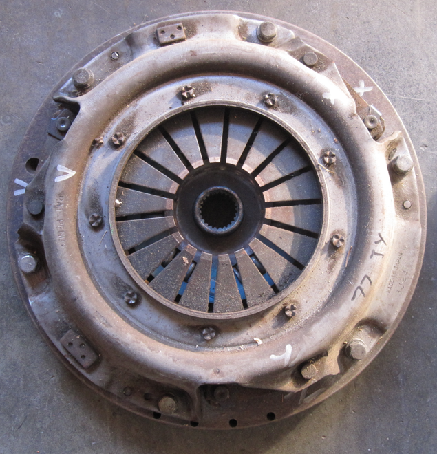

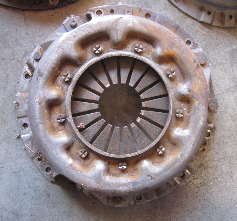

Cliff's method works.  Another is the bolt pattern.  Nissan did not drill theirs for both.  225 is 6 evenly spaced bolt holes, 240 is 3 sets of 3.
225
240

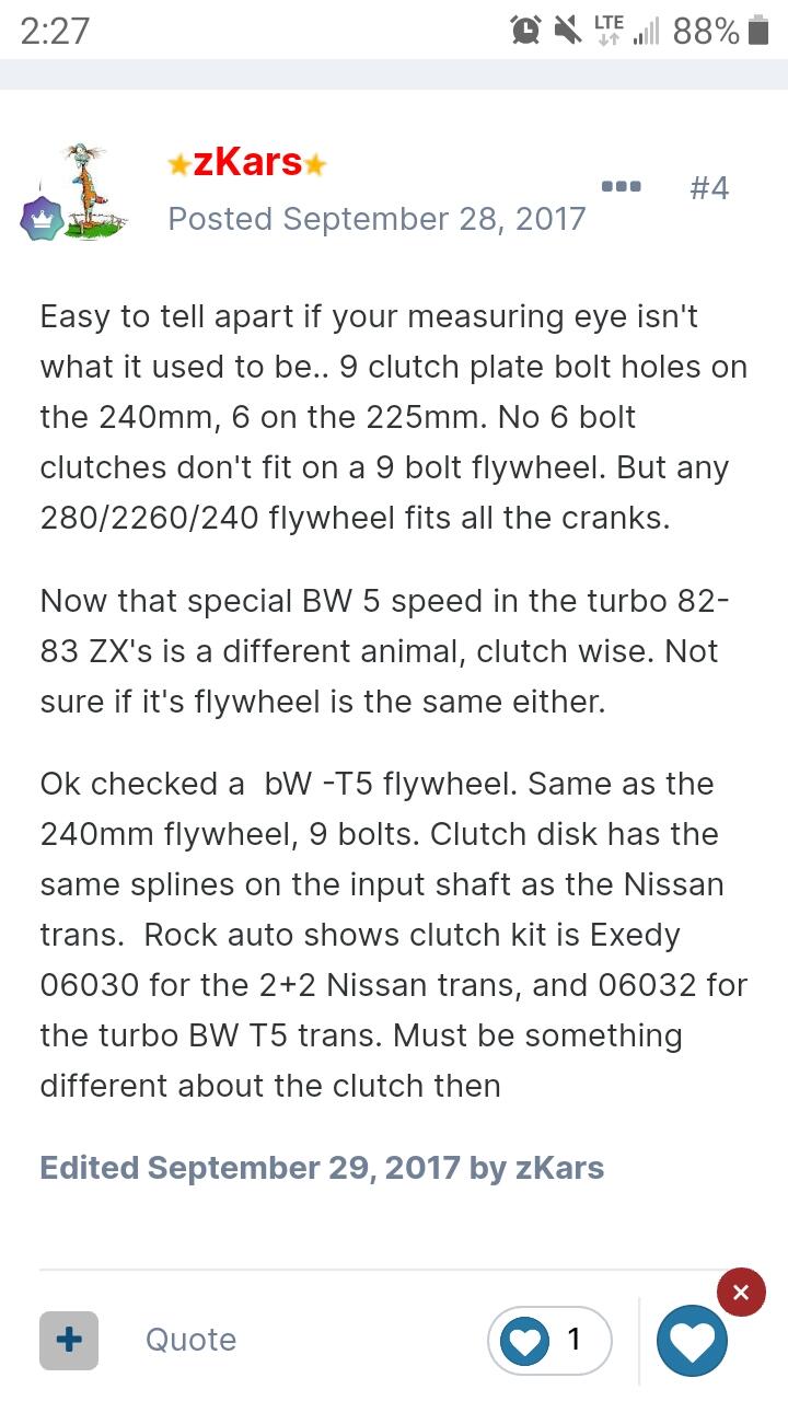

I just found this from zkars too while you were posting.
