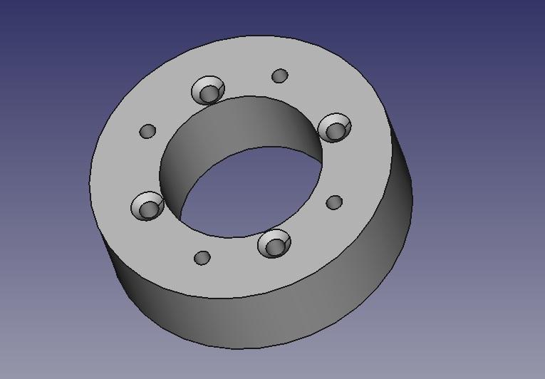

Not sure I can. Instead of having my friend Larry make it at the SpaceX machine shop, this prototype is being made at the UNR Technology Lab by my son. He is actually a UNLV student but because of Covid, he has access to the lab up here. We were actually going to make the first one out of wood or plastic but opted for aluminum CNC as it just might work!
I will open source the drawings so others can do this as well. DBW is the shizit!

Well I'm sure I'm just becoming a PITA at this point, but I got some questions about your adapter...
First, why the two different sized holes? And if the answer is "the larger holes are clearance pass-thru holes for the screws into the intake manifold and the smaller holes are going to be threaded to accept bolts to hold the new throttle body", then there's a problem... You have the holes swapped.
The holes on the smaller circle should be the pass-thru clearance holes and the ones on the larger bolt circle should be threaded.
Other question is I don't see the countersinks for the heads of the screws to attach to the intake manifold. Are you just going to put those in manually after it comes out of the CNC? Same with the threads for the other holes?
Sorry for being a pain!
No prototypes were injured by the drilling of holes. That will be done later when I’m sure what eTB I’m using. You sir, are not a pain.
Good. And since I'm not a pain, maybe I just need to try a little harder.  LOL
So using my (admittedly incomplete) understanding, here's a reality check of what the adapter could look like. 130mm OD and 70mm ID. I tossed in some countersinks too and it highlighted a potential issue. With a 70mm ID, there might not be enough meat for the countersinks. If that's the case, you might have to resort to a counterbore instead.
In any event, here's what I whipped up:

So my son did a rework which I haven't seen. I suspect it was to properly position the holes. He says that he just put visual holes in the drawing for now. He doesn't want the holes put in until I decide I'm using the 350Z DBW for sure. I guess, I'm driving him nuts. I told him it's payback for having to go through his adolescence with him...
