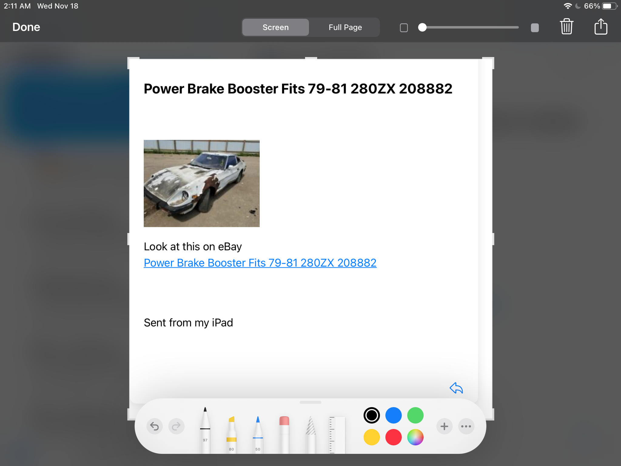

Well in the 'nothing can be too easy on this car' column, I contacted Power Brake Exchange to buy a 79-81 power brake booster and they don't have one even though their website says they have one in both locations. Dude was apologetic but says "our website hasn't been right in a decade or so."
I put a WTB on Facebook Datsun Parts and Needs but if you have one, let me know!

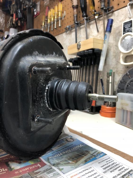

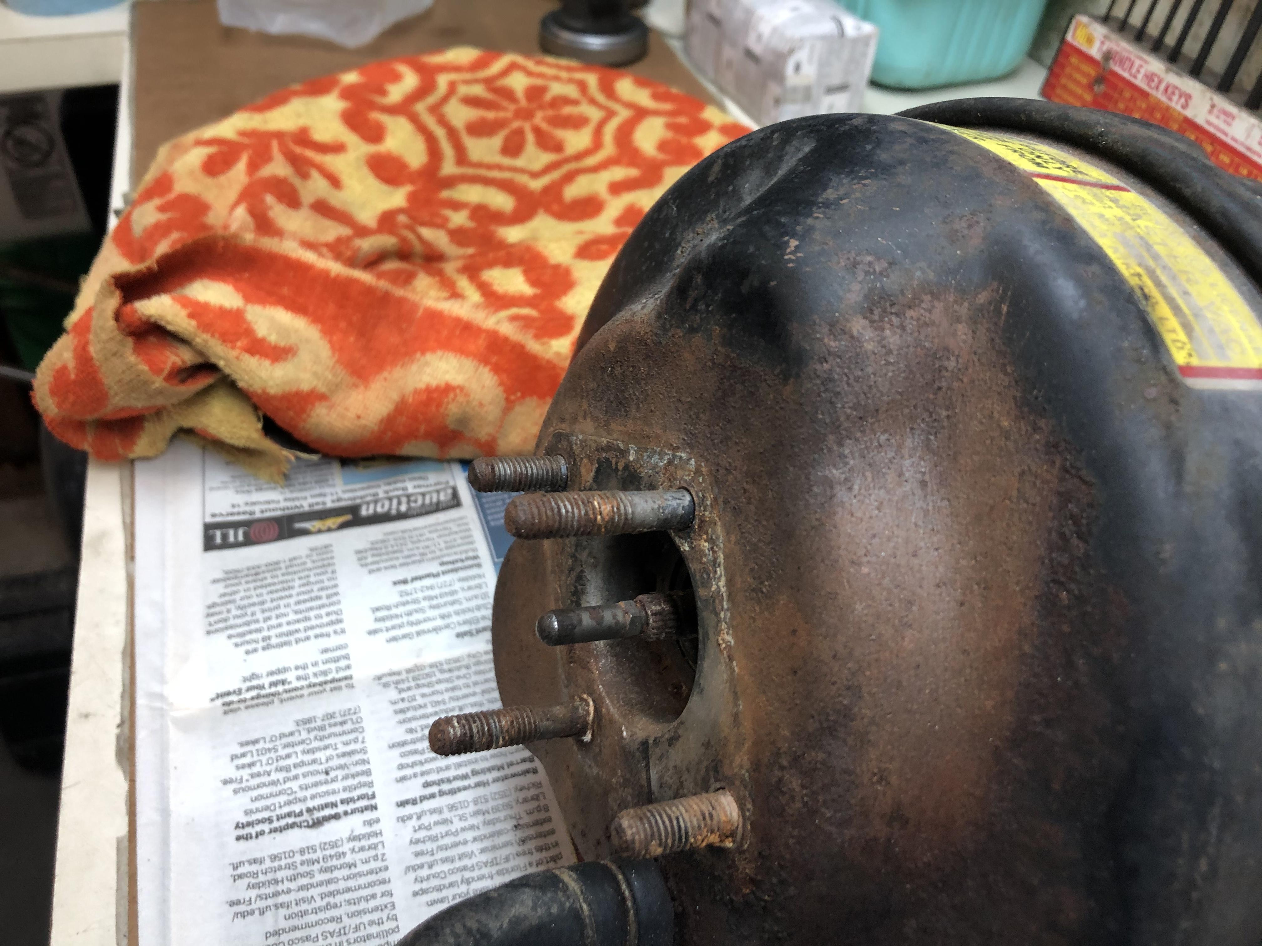

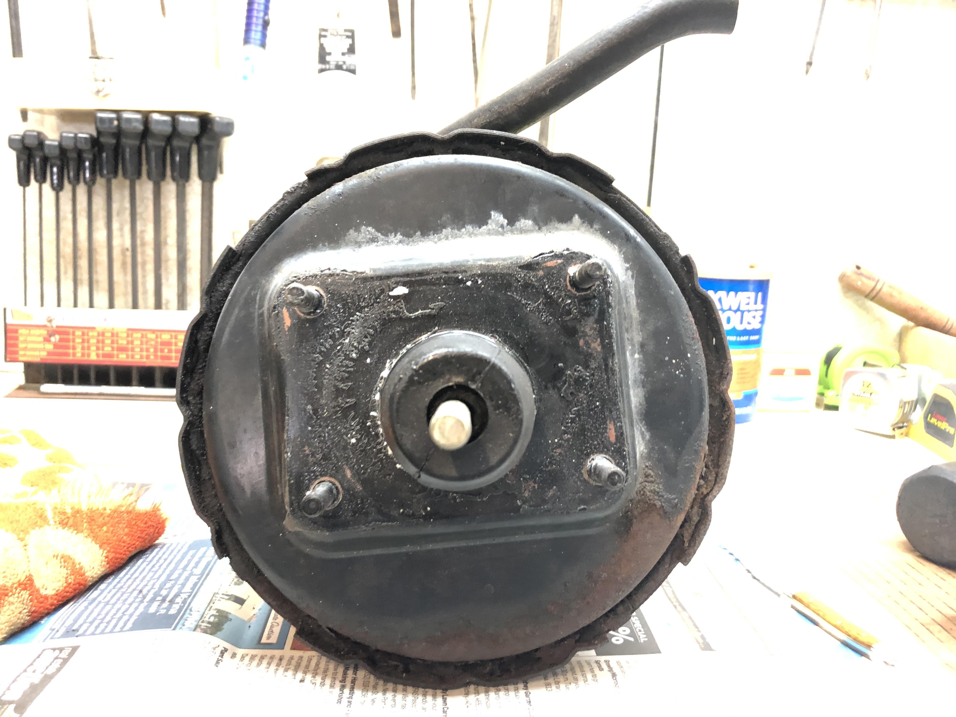

Ok, Here ate some pics of my 1978 OEM booster.
The dimensions are:
Top horizontal stud dimension left to right. center to center.  3 5/16”
Vertical center to center 2 3/4”
Overall booster diameter 9”
