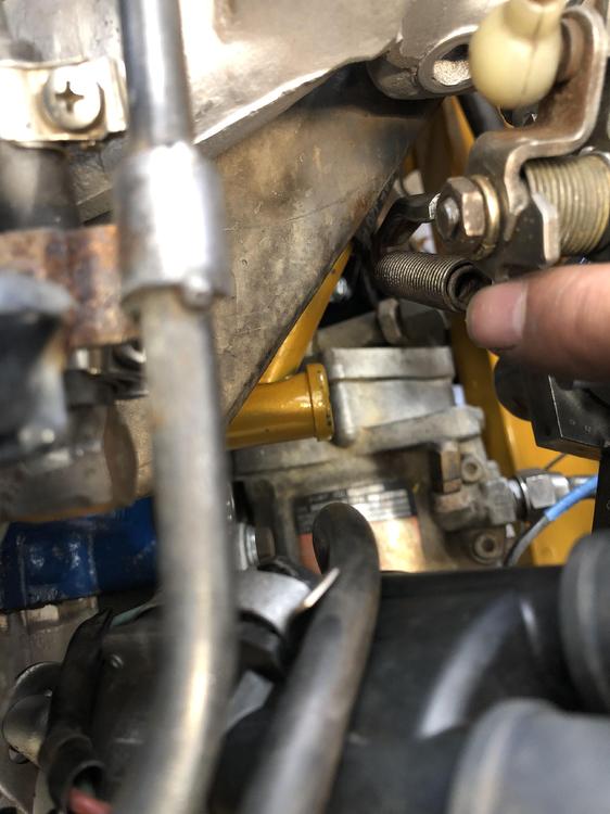

Is the throttle return spring intact?  They tend to rust and break off.  The throttle body itself has a weak spring but there is an external one also.  You can check if the throttle is sticking by pushing the blade close by hand or lifting the gas pedal with your foot.

about the spring on the throttle, yeah.  It is weak.  I don't think there is a stronger spring out there.  I might have to add another spring to the rod and pull it back and mount it to the throttle body.

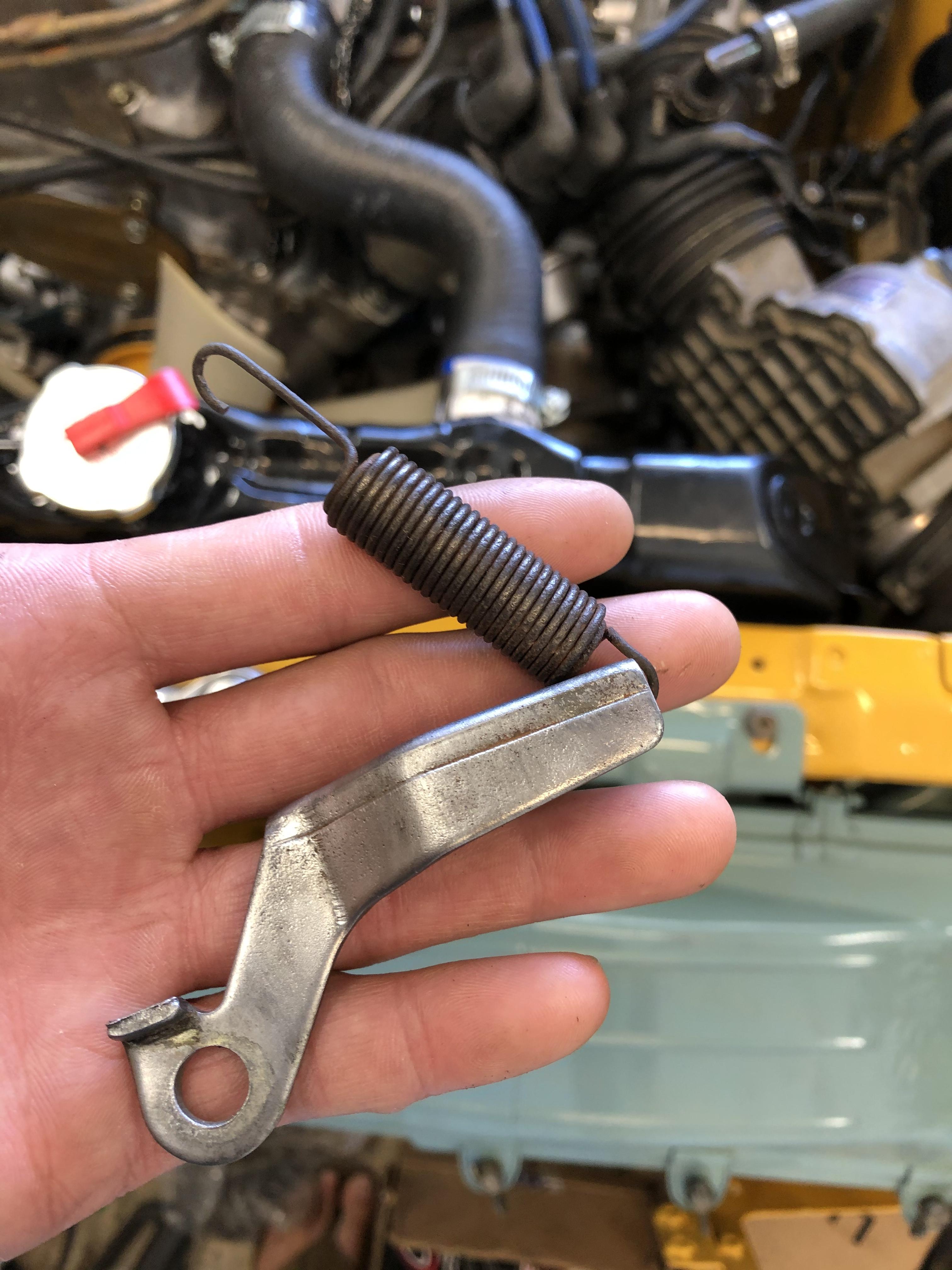

Dug into my boxes (btw, boxes getting smaller and smaller... pretty happy about it) and found this.  Look at the spring on the throttle body and notice there has to be something connect to that pin hole... low and behold, it supposes to bolt into one bold of the throttle bolt to the intake manifold.  She now is so snappy.  RPM goes right down when release the throttle or gas pedal.  Need more clearance of the carpet but even with the obstructing of the new carpet, she is snappy.

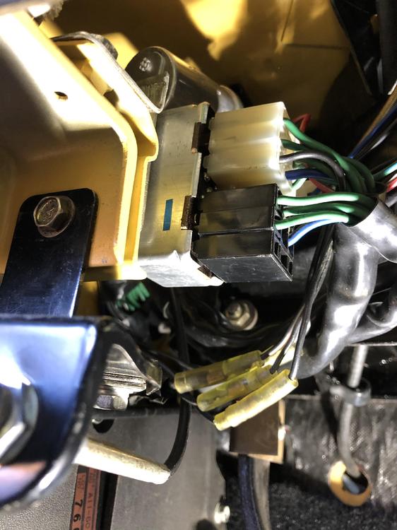

Hi all,
when I took the harness out, I don’t remember remove any connector if not necessary.  I told myself this is a long term project.  I want to leave things as intact as much as possible.  Beside, the harness didn’t have to go to any holes like the passenger side where wires need to get into engine bay.  I must have took it off but can’t remember why.
in case anyone interest how the connectors orientation, take a look at the picture below.

2 hours ago, Captain Obvious said:
 I don't have the spare parts laying around to check for keys, but looking at the pics, I don't see anything.
A faint memory has crept in to my brain of colored stripes on the relay and maybe the plug.  Very faint...  Black and green?  The funny thing is I also vaguely remember wondering why they were there.  Maybe I missed it.
Edit - I just looked at the picture and see a blue stripe.  Maybe that's the one.  I  don't see a match though.
Edited by Zed Head
another area to watch out for is the hazard flasher vs turn signal flasher. IIRC they have the same plug and the units are located in the same area (under dash driver side), Think it may be that one cable is too short to allow incorrect plugin but not sure about that. The actual flash units are much different is size (same pin out), I don't know if they are interchangeable.
There are different part numbers for the hazard flasher and turn signal flasher in the parts manual. The hazard flasher part number is still available in the Nissan system, but the turn signal part numbers are NLA. Of course, when I swapped out all of the lights to LED, I went with electronic flashers that for all intents and purposes are interchangeable...but I digress.
