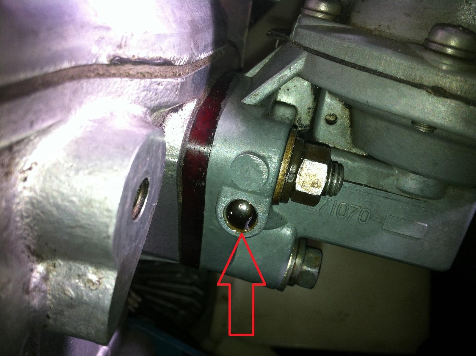

Mine leaks at the pin for the rocker arm. Just a very small leak, but it makes a hell of a mess over time if I don't wipe it up on a regular basis. To bad that pin is not serviceable.?
