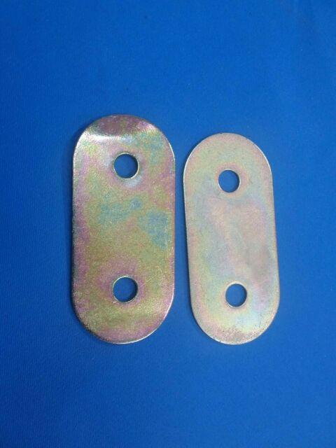

May 3, 20204 yr Author comment_598687 Ordered the outers from Summit, waiting for the package! Thanks all. On a separate question... when looking more closely at the sway bar bushings, the brackets seem too small for what I got (many years ago, bought the energy suspension bushing set). The bushing is 18mm and fits the sway bar perfectly, but if I put that bushing on the original brackets, the bracket doesnt fit flush to the chassis. am I wrong to just tighten them until they just squeeze the bushing tighter? Not sure if that would just bend the bracket and not squeeze the bushing. The bushings are poly, so I dont think they'll give that much. Or should I buy new brackets? Link to comment https://www.classiczcars.com/forums/topic/63932-outer-tie-rod-ends/#findComment-598687 Share on other sites More sharing options...
May 3, 20204 yr comment_598688 You should have two plates that go under that bracket onto the frame. They'll make up a little distance for you. Just tightening them down will be fine. Link to comment https://www.classiczcars.com/forums/topic/63932-outer-tie-rod-ends/#findComment-598688 Share on other sites More sharing options...
May 3, 20204 yr comment_598689 I have to apologize, just waking up and getting some coffee flowing but I realize the plates will also raise the bushing. Anyway, I say just tighten them down. That front sway bar is a real booger bear to put on by yourself. I used a jack to hold one side up while bolting the other side. Edited May 3, 20204 yr by siteunseen Link to comment https://www.classiczcars.com/forums/topic/63932-outer-tie-rod-ends/#findComment-598689 Share on other sites More sharing options...
