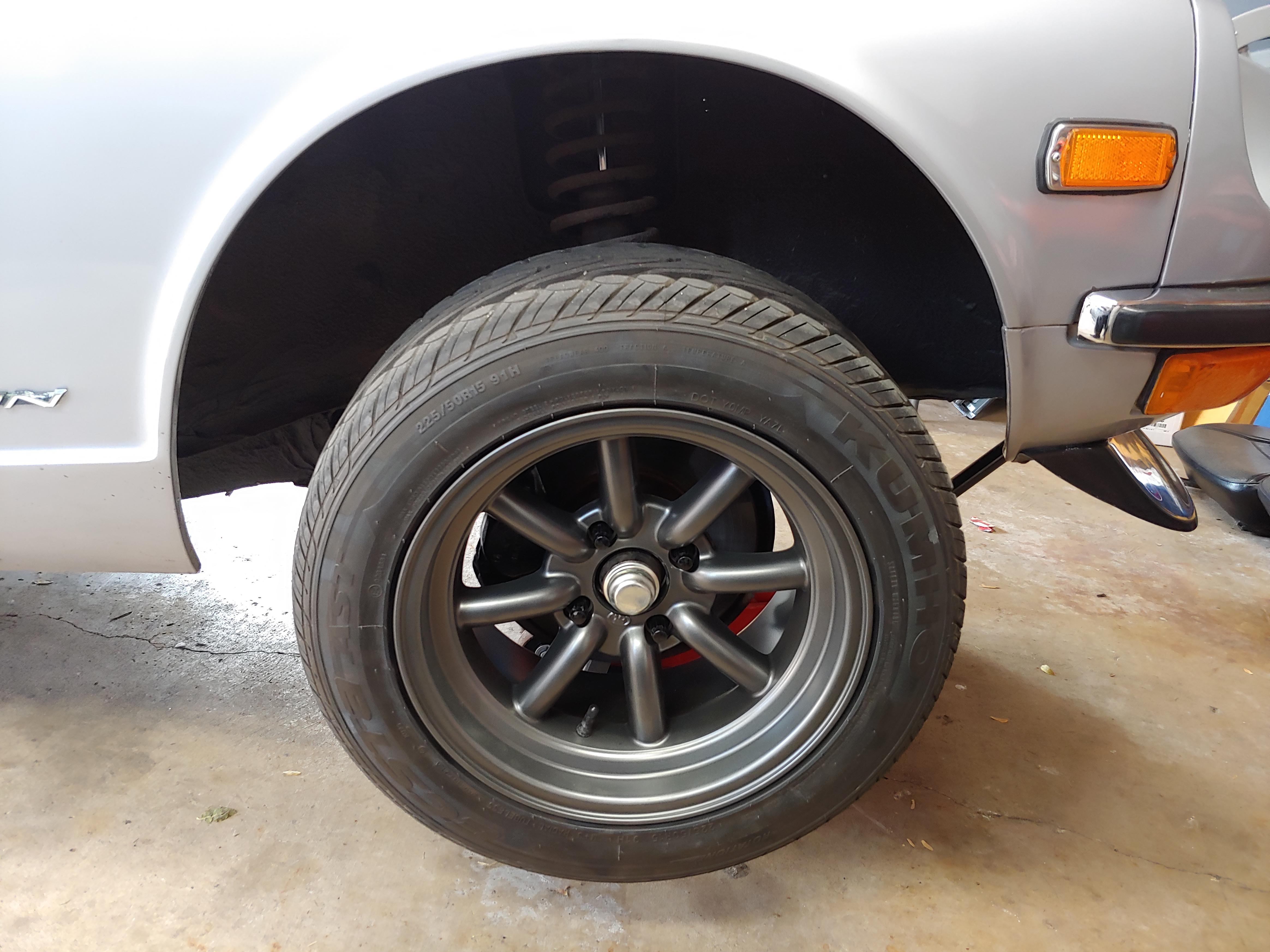

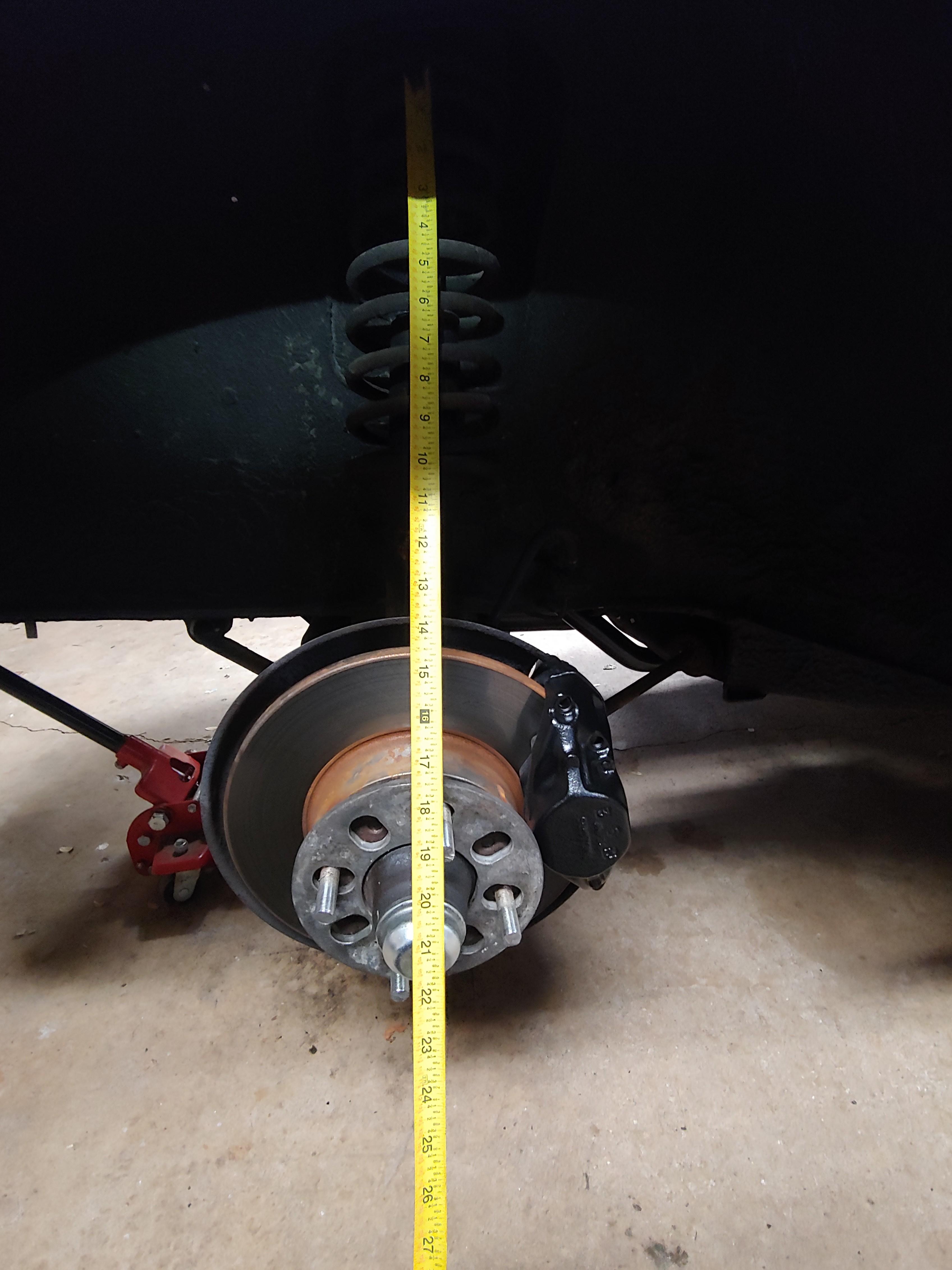

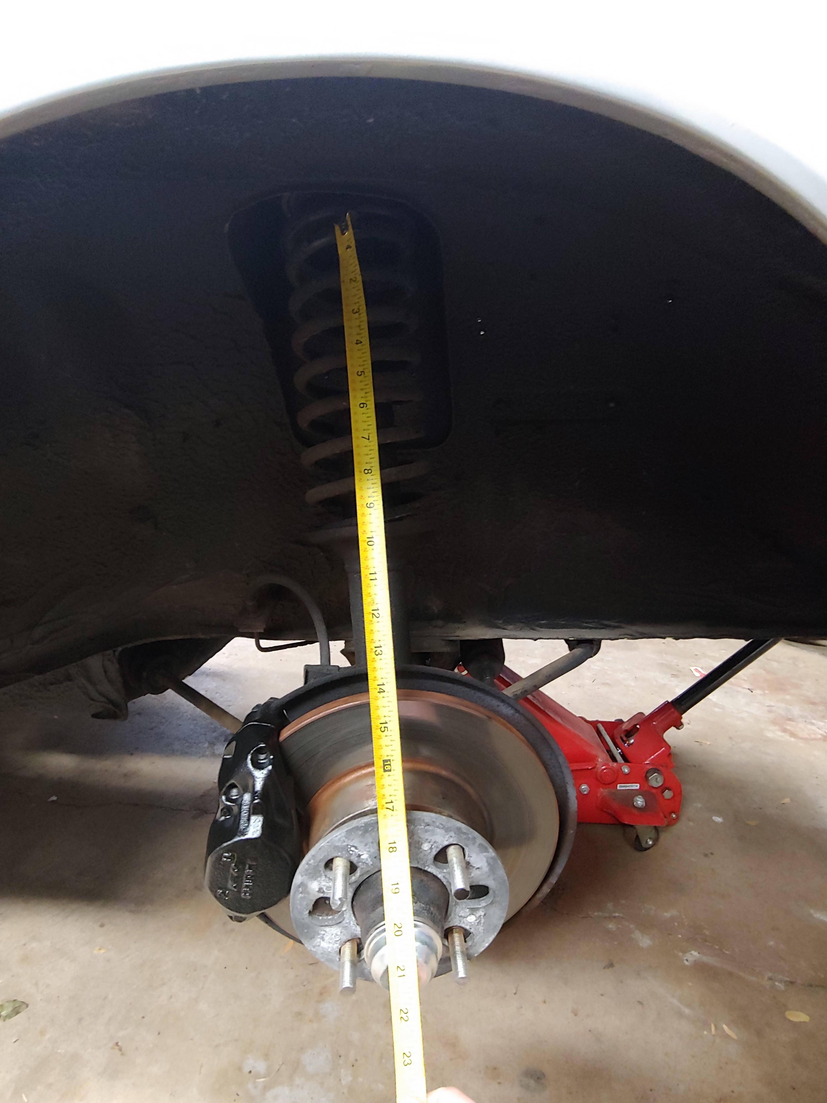

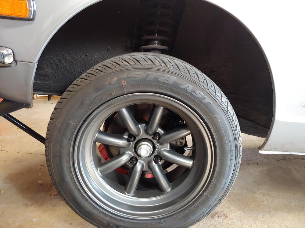

Good Morning,  a new issue showed it ugly face after I installed new wheels. When from 15x7 to 15x8 and now R/F tire rubs bumper when turning left.  I have read that nissan designed R/F caster to lead a little , but this is too much.  Can this be adjusted?  Also noticed that left front wheels poke is more that right side by 8mm.  Any suggestions?  Has anyone adjusted subframe for this reason.  No frame damage is apparent

Your photo shows a tire size of 225/50X15 and a calculator says you are about 1" smaller diameter than OE so that is not the problem.  Other than the 8" wheel width being the issue , are you running a 0 offset?

Hello. They are 0 offset.  I drove this car for 2 year with the previous wheels 15x7. Using the same times as now (225/50) and had no issues.  You can clearly a smaller gap in front of tire compared to the left side.
