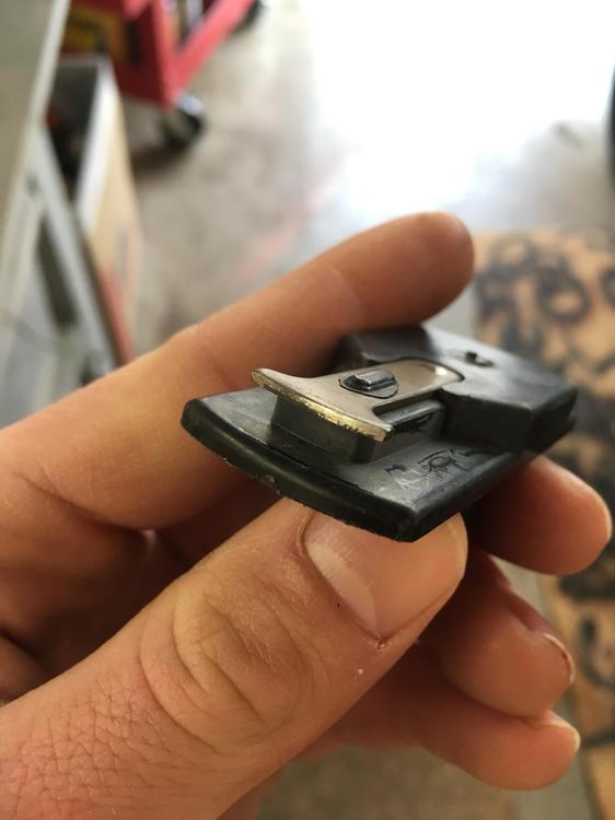

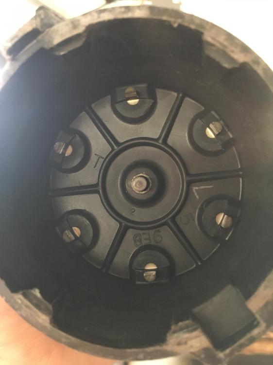

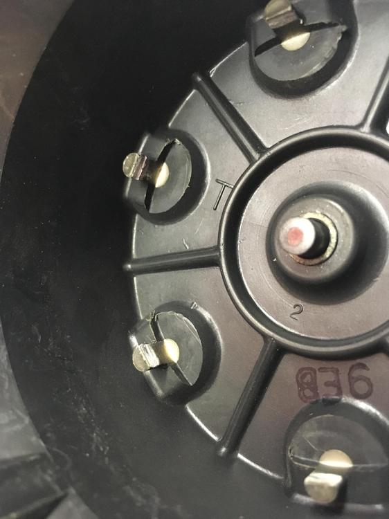

I've finally got my 1978 280z idling decently... Kind of. It's been really touch and go. My distributor has been doing this weird thing where it starts making a grinding noise and then stalls the engine. Doesn't do it 100% of the time, but when it does, it's typically when I rev the engine or attempt to put the car into gear. This is leading me to believe that it has something to do with the oil pump or spindle rod or something. I've attached some photos of my old distributor cap and rotor and you can see where there's been interference between the rotor and cap. I have since replaced the cap, but continue to experience the same issues. Any thoughts? Anyone seen this before?IMG-2238.JPGIMG-2237.JPGIMG-2239.JPG

IMO, it's either bad dist. bearings allowing side play in the dist. shaft or a bad rotor. I had a cheap cap and rotor in my 521 that ended up looking like that. New Bosch products cured it.

Well for me, it's just important for it to at least run right now. And that interference is causing the engine to stall I think.
