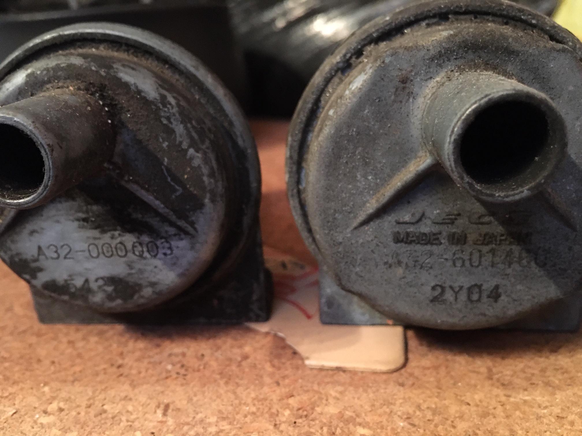

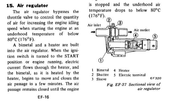

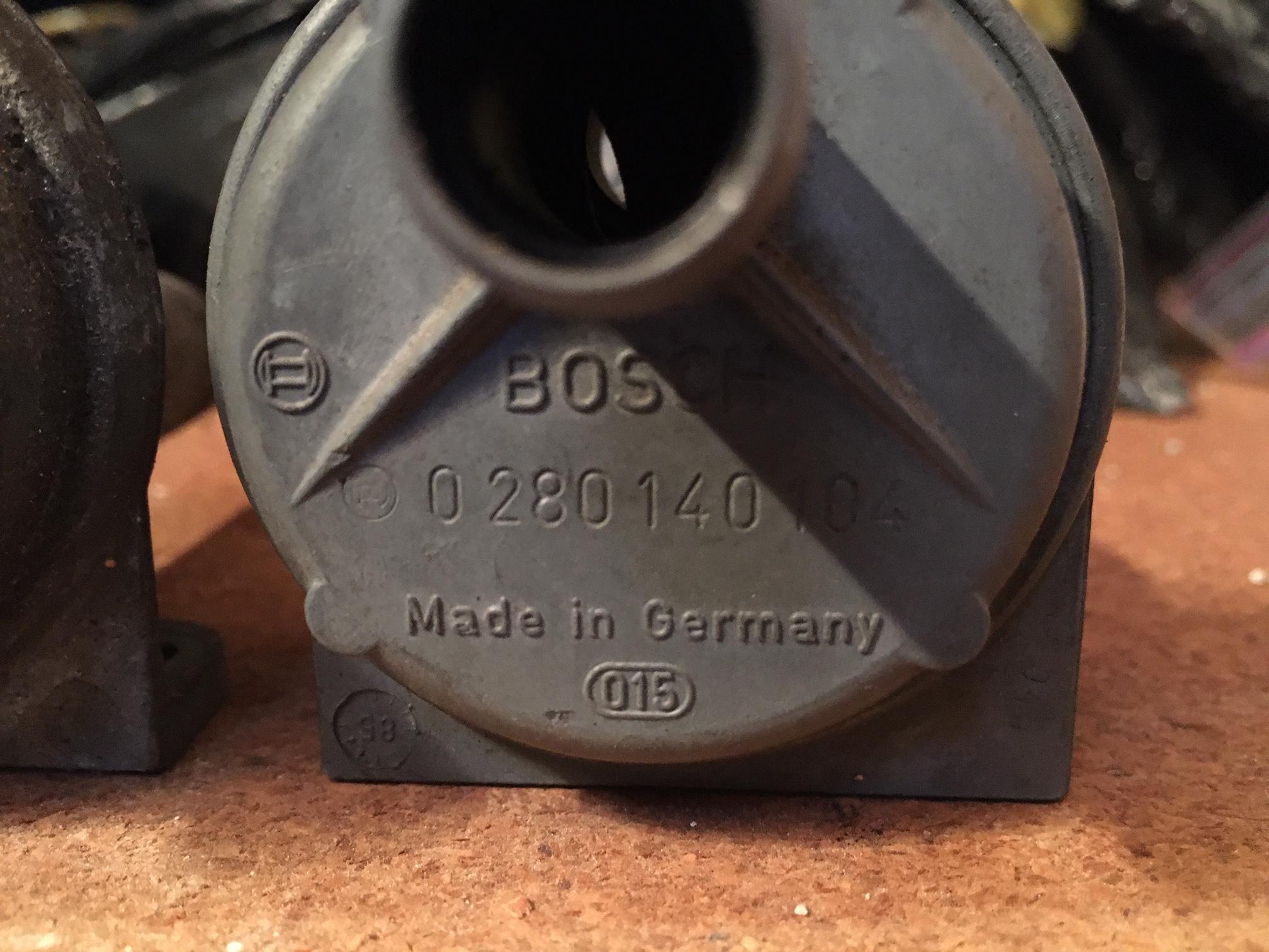

Pic's added : 1 Bosch, and two Japanese with different numbers on them. They are all about half way open. I really never looked into how to test them. I am not sure what the difference would be in the different models. What was your statement reference about it being broken? The FSM shows the test is with power not just temp. did you try this test? Looks like powered heat closes it, and ambient temp opens it but it does not say how much.

rcb is right, it just needs to close when warm.  It has a heater inside it.  If it's open at room temperature that's good.  Apply 12 volts to the terminals and it should close in a few minutes.
But it's not a vacuum leak if it doesn't close, it's a throttle blade bypass.  Like opening up your idle speed screw.
