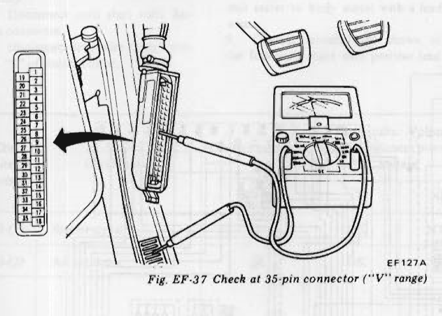

The coolant temperature sensor is the most likely cause, based on your symptoms.  You need to measure the resistance at Pin 13 of the ECU connector to ground to know for sure.  Installing a new one won't help if the wires aren't connected to the ECU.
I just now realized, after many years of browsing through FSM's and Fuel Injection Guides, that this drawing has the pins numbered, right in the drawing.  I never looked closely enough before.
  Installing a new one won't help if the wires aren't connected to the ECU. - Zed Head

And thank you for attaching the exact connections with pins
Edited by Cyrillink

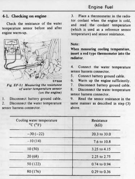

The only way to be sure that that the wires are intact from the coolant temperature sensor to the ECU is to measure resistance at the ECU plug.  If you do that you are testing the wires, the sensor, and every connection along the way.  I would not do anything to the coolant sensor, not even remove the plug at the sensor, until I measured resistance at the ECU plug.  Start at the the end, not the middle.

Tested the resistance and i was able to get a reading back, the reading was similar to when the sensor was pulled out of the car for cleaning.  Took out the plugs cleaned them to make sure everything is well.
Car did the same thing. Blue smoke, rough idle while only holding the paddle down.
Without the actual number and knowing where it was taken, can't really tell what you're saying here.  It might the the most important measurement you can make on the EFI systems.  "a reading back" doesn't read well.
car is indoors with the heat on to 60f
sensor reading from the ECU Harness 2.07k Ohm.
