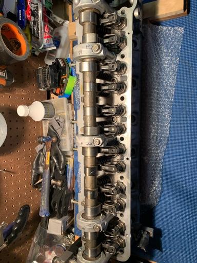

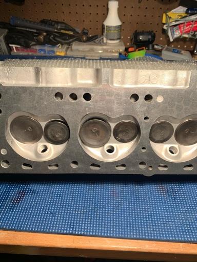

Head is finally in my garage and looks pretty good. $300 for all the work.
Cleaned, replaced valve seat, and complete valve job.
I just wish I had time to put this engine back together.

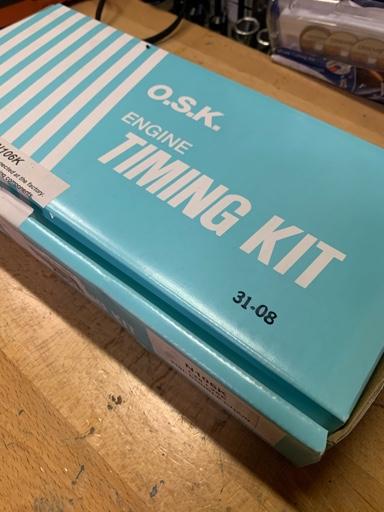

Side notes. This is double confirmation that the OSK timing chain kit doesn’t have the V-notch on the sprocket. Was $68 on EBay. Nice kit IMHO.
Rod bearings arrived too. I purchased tri-metal standard bearings made by Taiho $38. Tried to buy the Clevite 77 P- series but they are no longer available anywhere in STD sizes for Rods.

you may want to make your own notch. I would put the two sprockets back to back, then using the old one as a guide, scratch in some marke where it should be. then use a v cut file and make your own. easy to do while its apart.
did you try spinning the camshaft with the valve gear not in it? looking for a nice low drag, no tight spots spin.
Dave, I put the old sprocket on and spun the cam about a 1/2 turn to try and stop any of valves from protruding past the deck.
Good idea with the sprocket but I could also check the timing position using the old sprocket and then once set put the new one on in the same hole.
I am thinking mainly to make sure things line up, some times installing the sprocket can get dicy with what link its on. Plus you will want it to check for wear later on.
I would suggest you remove all the valve rockers and make sure you don't have any tight spots on the camshaft. If it does you maybe able to correct with careful tightening of the cam tower bolts.
I'm going to guess the machinest checked the cam's movement before he put the valve train on. $300 should cover something that simple.
