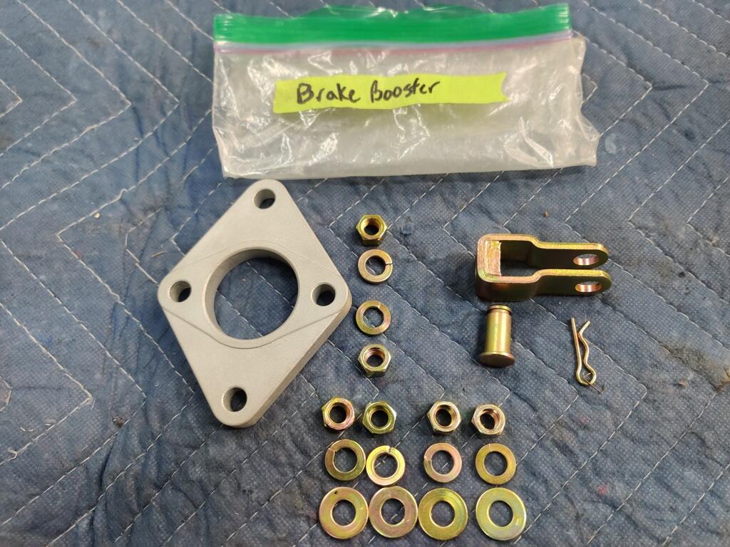

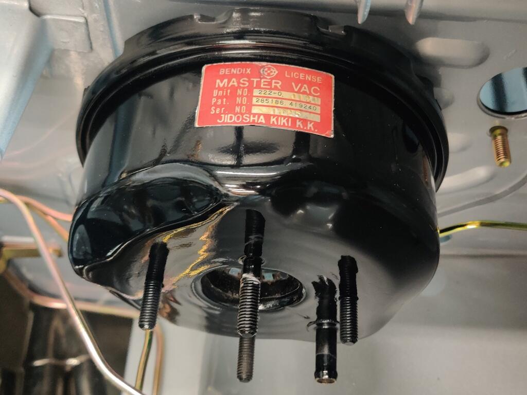

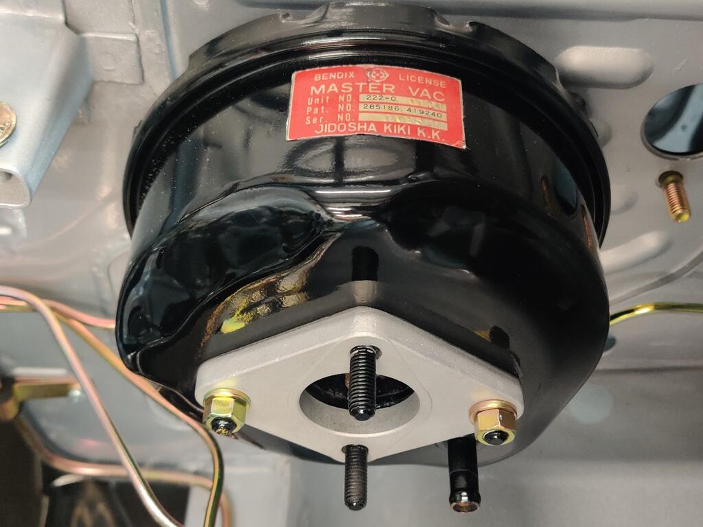

I wasn't able to spend much time working on the car today.  Just a few pics:
I used silicone rubber between the master vac and the firewall to keep water from finding its way into the car in the future.  I like how the master vac paint came out.  I was able to save the original master vac sticker.

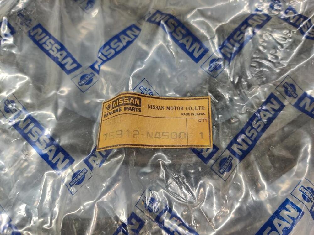

I also pulled out the box of OEM rubber items that came with the car.  I put the main hatch seal in place all the way around the hatch opening (without glue) and shut the hatch on it.  I will leave it like that for a few days, which ought to help it relax/fit the opening a bit better than straight out of the bag.  I also started assembling the headlight buckets with the new bits I got from 240zrubberparts.com.  I bought the headlight harness rebuild kits, which include new rubber grommets to keep water from entering at the point where the wires go inside the bucket, new sleeves for the wiring, and new rubber enclosures for the plastic connector.  Can anyone tell me which ends is supposed to have the yellow tape (bucket side or harness connector side?

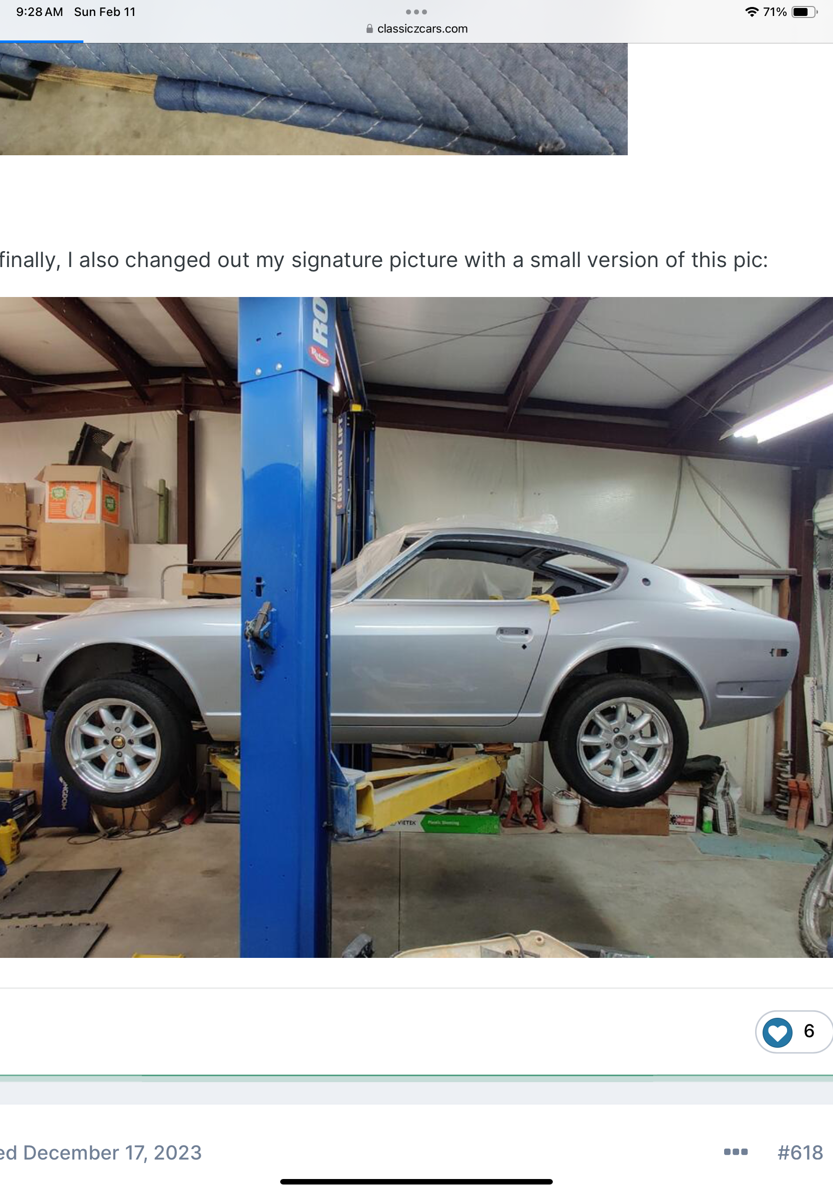

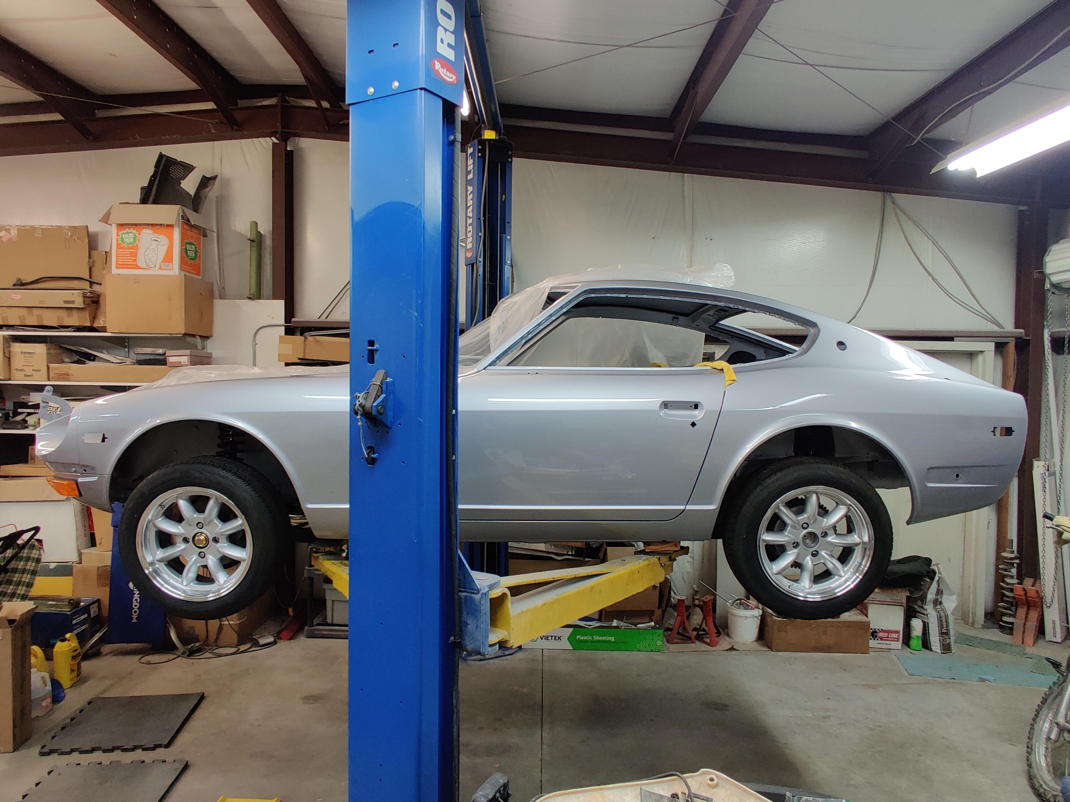

And finally, I also changed out my signature picture with a small version of this pic:
Wow……The S30 Datsuns are incredibly beautiful. This restoration is incredible in itself. Great job @Inline6…..I’ll bet your shirts all hang in same direction in your closet!  😂    It just doesn’t get any better than this restoration…… Perfection!
