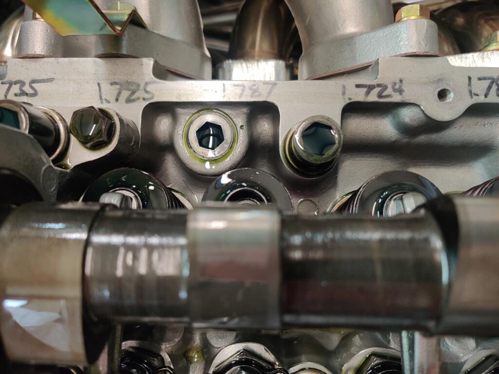

Yeah, something really isn't right.  I have snapped a bunch of pictures and talked with my engine builder, who did the work on this head.  The current hypothesis is that the SI Stainless valves I bought are too long.   The installed heights are still visible in black marker on the cyl. head:

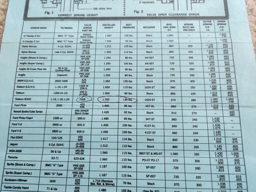

1.787" is a lot more than the specification paperwork from Iskenderian (1.700"):

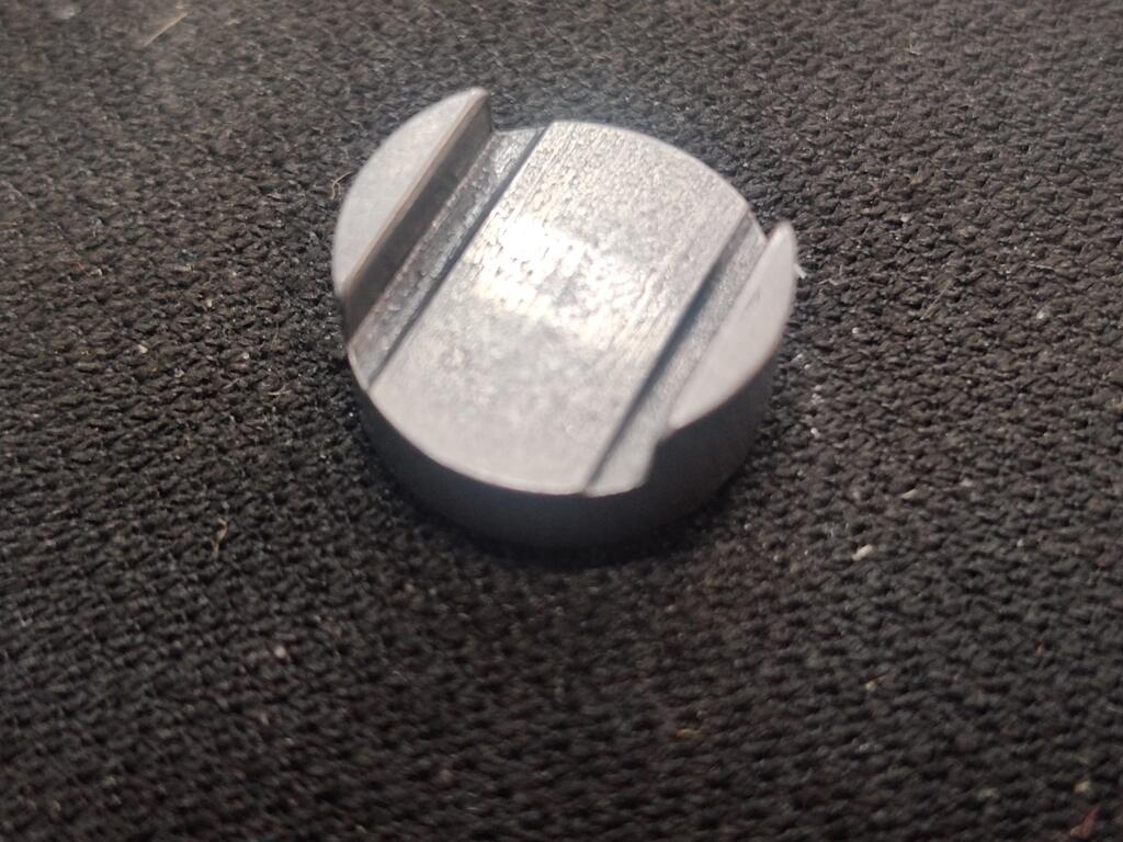

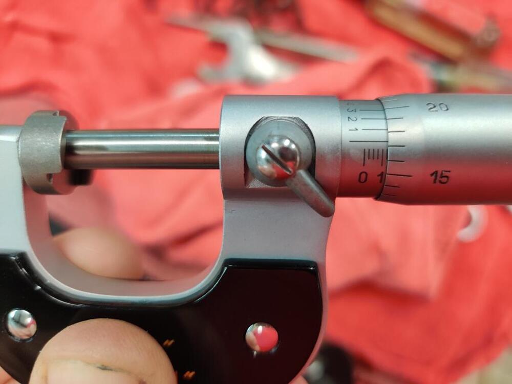

The lash cap I pulled out with the one rocker arm I removed last night is .117" and about 3 tenths.   Stock is .118".

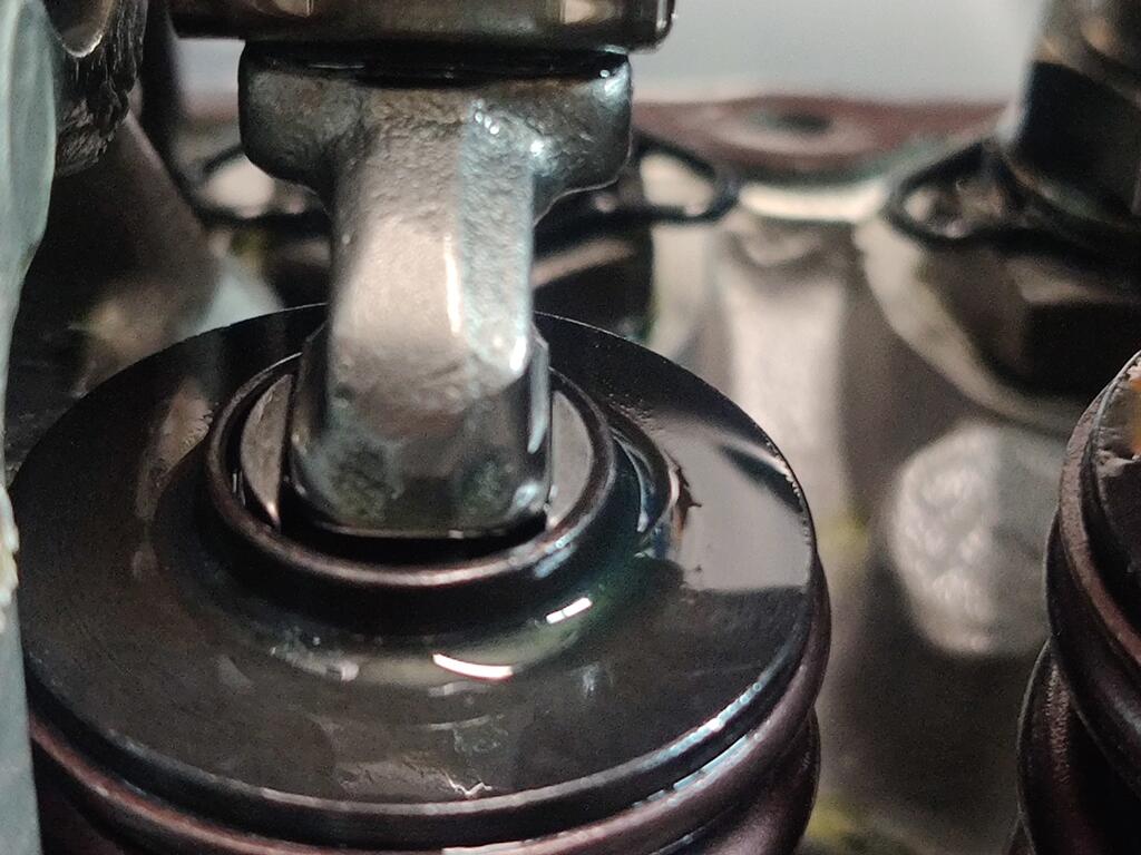

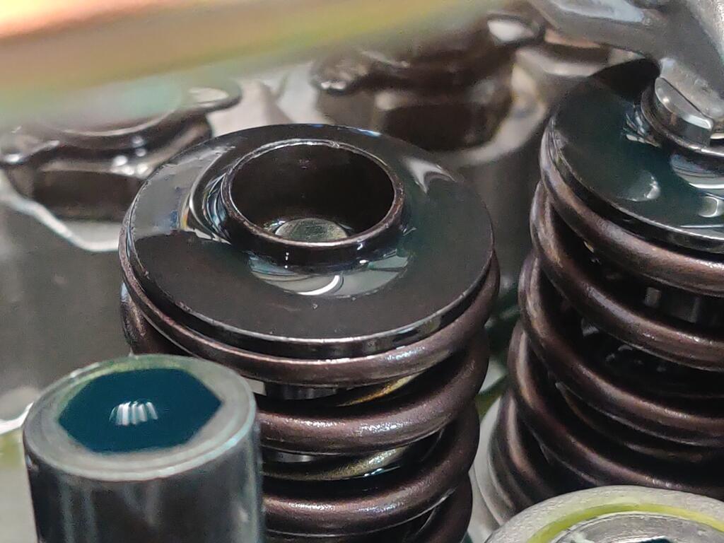

The retainers currently installed look like the Isky ones.  The depth to accommodate the lash pad is notable.  Comparing to another exhaust valve which has not had the rocker and lash pad removed, the lash pad (I am assuming also .118"/stock) is "buried" in the retainer.
So, the theory right now is that SI Stainless valves are taller than the stock valves (4.620").
I think I will have to pull the head.
My engine builder is a great guy and he has provided me with so much value over the years.  In this instance, I should have checked the wipe pattern before installed the head, but I did not.
As far as I can tell, no damage has been done.  So, I think I have been fortunate here.

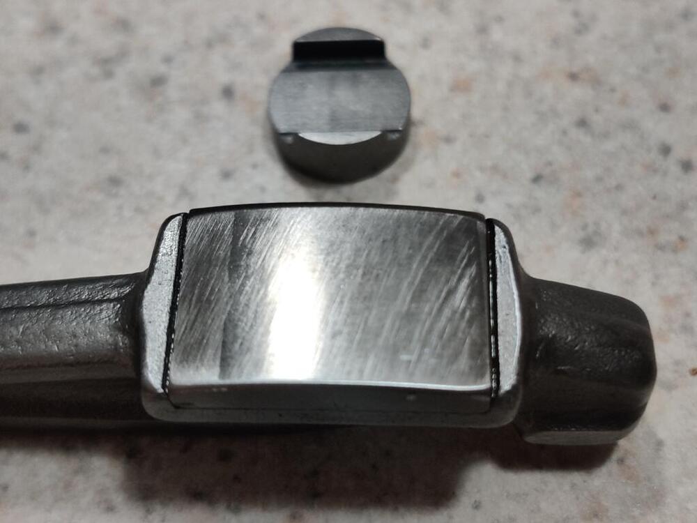

Just my opinion, but I’d work with lash pads and adjustment before I’d pull that head. This is my Stroker with Isky Stage III cam and the same valve springs as you. .160 lash pads centered my wipe patterns. Check my valve numbers….zoom in to read em. Definitely check wipe patterns before starting.

Ok.  Yeah, I am going to pull all the rockers and look at wipe patterns, and measure lash cap thicknesses first.
Edited by inline6
You can remove all rockers but one. Remove all spark plugs. Turn the engine over by hand. Get the right lash pad to center the wipe pattern on that rocker and the rest should be close.

Is the issue solvable with a lash pad change? What I mean is... The lash is too tight. Even with the adjuster all the way down. That clearly means a thinner lash pad is required. But the wipe pattern is almost off the end of the hardened pad.
What happens to the wipe pattern when the lash pad thickness is reduced? I've never messed with it in any great detail. Does a thinner pad move the contact patch towards the adjuster end of the rocker, or towards the valve tip end?
If a thinner lash pad moves the contact patch towards the valve tip, then this issue cannot be solved with a lash pad change.
