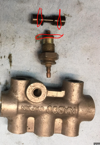

@inline6  nice work, she's looking good!  Quick question, where'd you get that beautiful brake light switch (looks like a proportioning valve)?
Mike

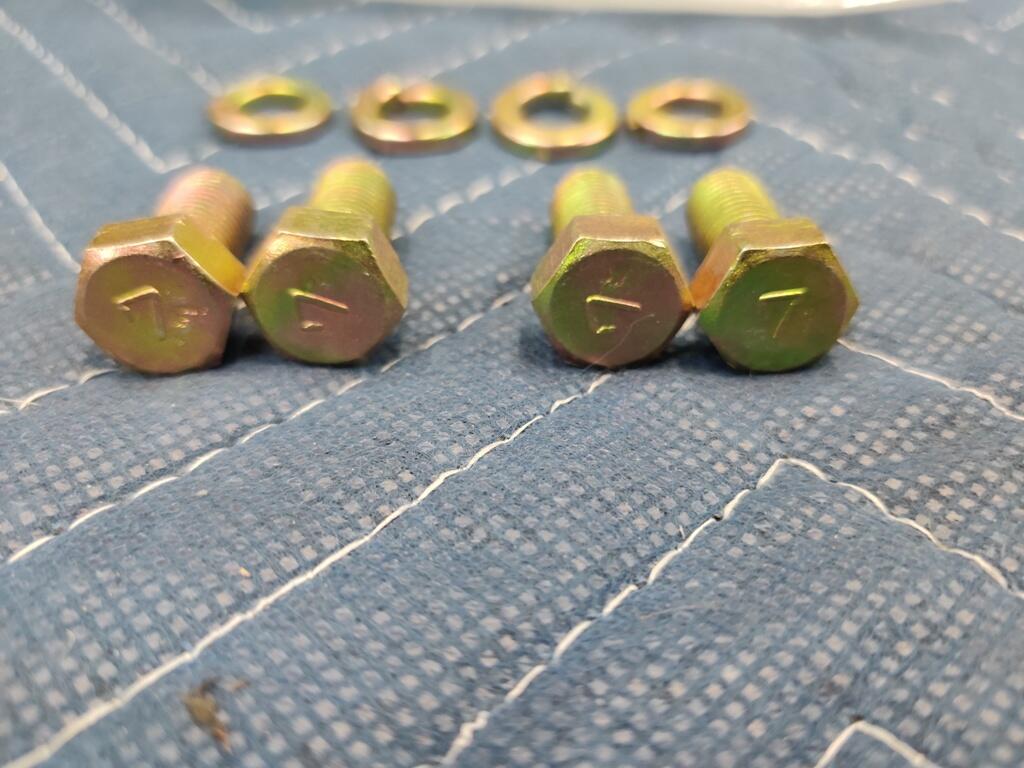

I think you are right - it is a brake light switch (not proportioning valve).  That is the one that came with my car.  I disassembled it, sent off a few internal and external parts to get them plated, and glass bead blasted the body.  I glass beaded it at 90 psi to clean... and then another pass at about 50 psi to give it a smoother finish.
9 hours ago, grannyknot said:
Beautiful, the brake switch does have that small rubber O ring but the top of the body is machined flat as is the bottom of the sensor so I put in a crush washer just to be sure.
Interesting.  Maybe I will do the same for a measure of safety.  Having brake fluid squirt all over the engine compartment and the damage that would cause... 🥶
I feel a little uneasy about reusing the original o-rings, but that is what I did.  I don't know how to source suitable replacements that would meet the performance criteria?
I know, I hear it too, "always use a new crush washer" but for the same reason as you mentioned, I have had to reuse crush washers so many times I can't count them all.
I've never had a leak out of them, aluminum or copper.
Ha!  Good to know... as I reused the original aluminum crush washers too.  I am less worried about those leaking now, given your experience with that.  Thanks for sharing.
Wonder if there is a way to determine suitable replacements for the o-rings...
Edited by inline6

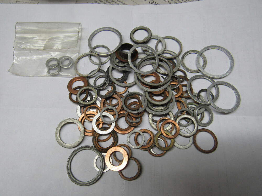

Never throw them away😉
Nice collection.  Those are the crush washers of course.  The o-rings I am wondering about are inside the switch.
Thanks Steve.  I will check those out.

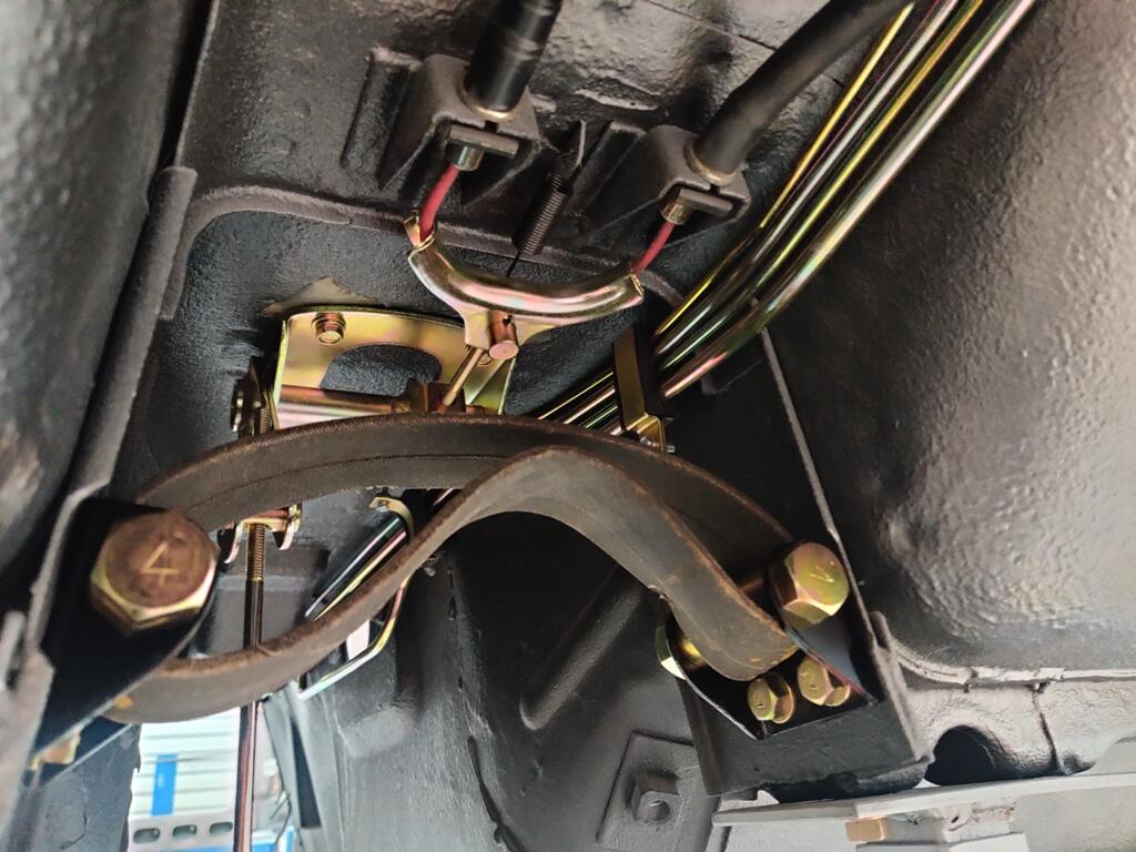

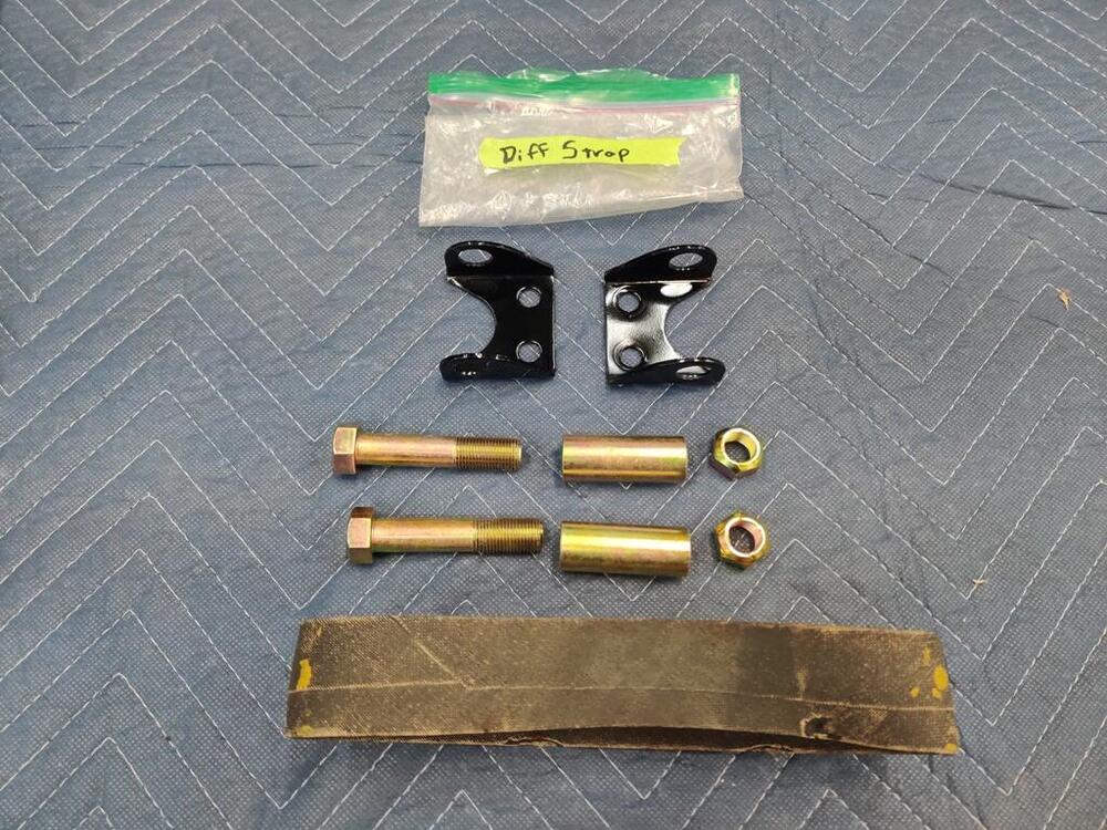

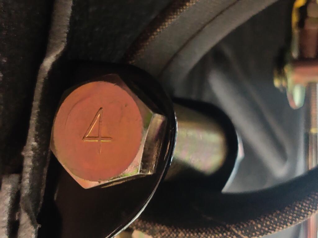

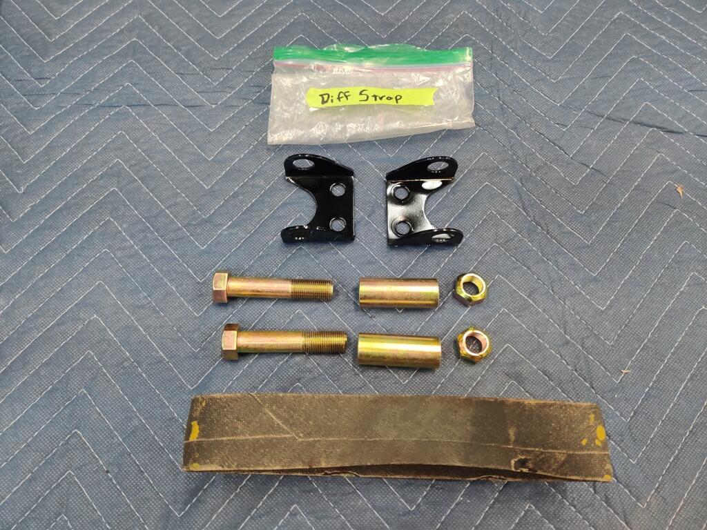

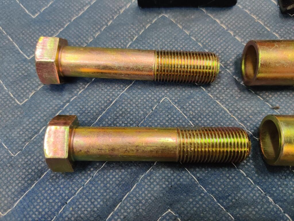

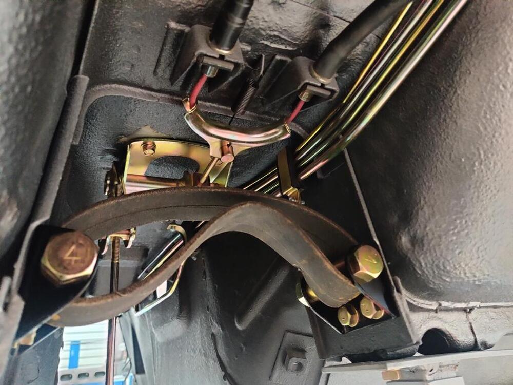

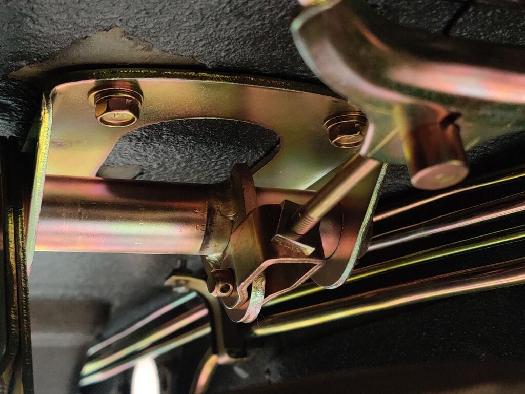

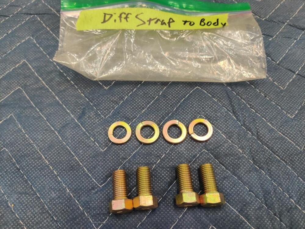

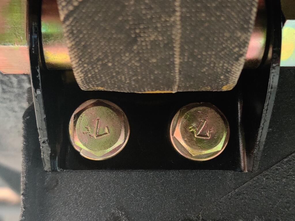

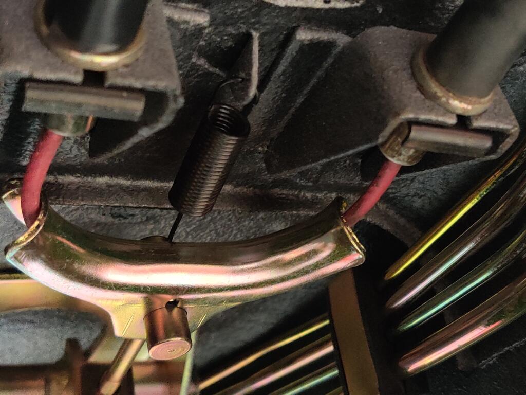

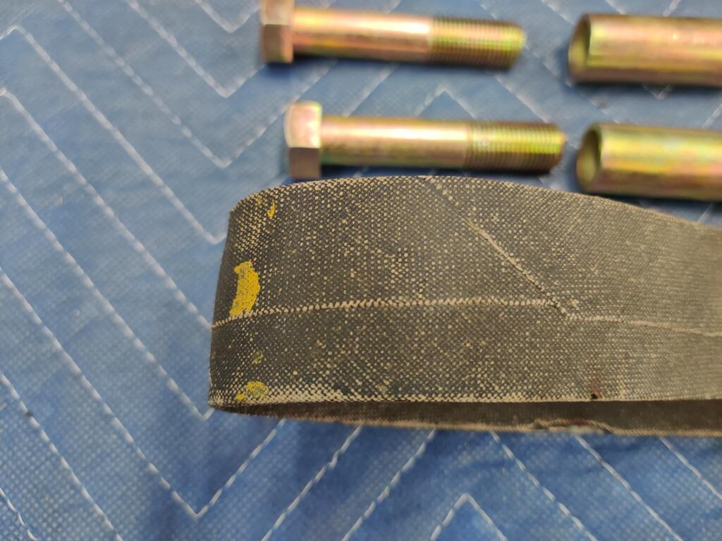

Tonight, I put the differential strap in.

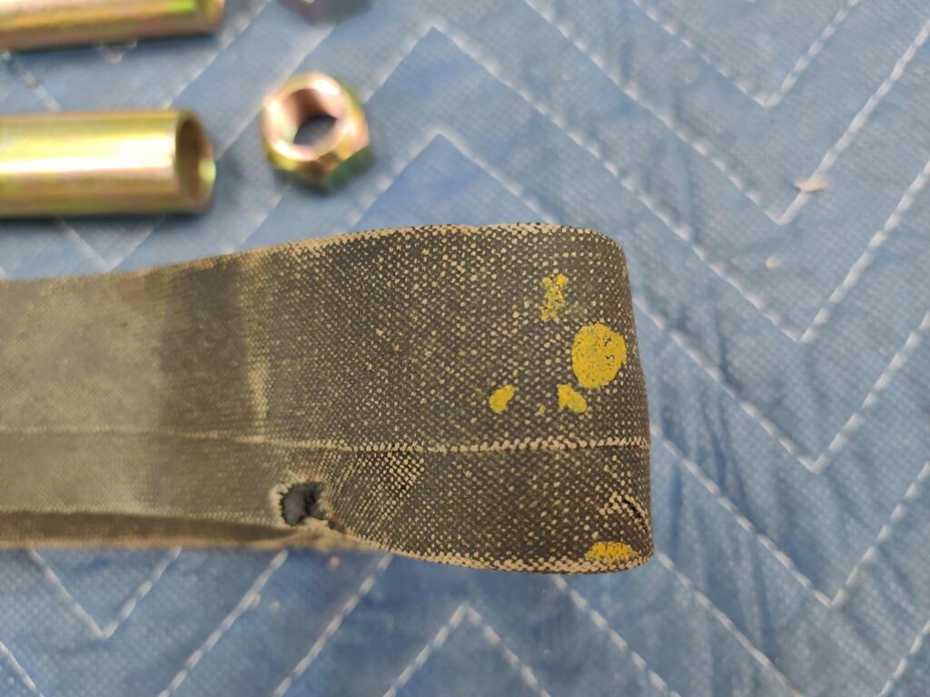

I reused the original differential arrestor strap.  It is in decent shape - it even has original yellow paint dabs on it.

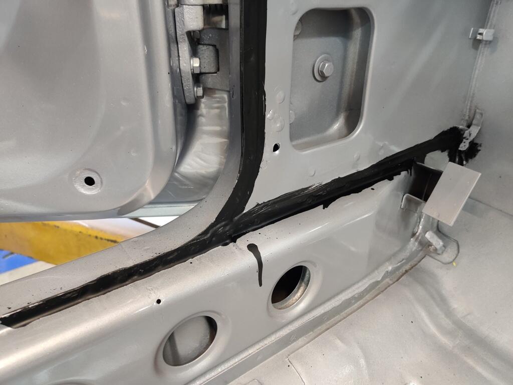

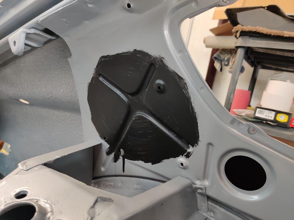

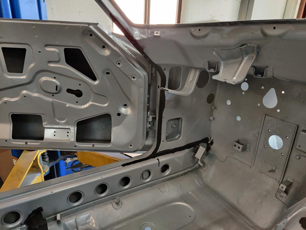

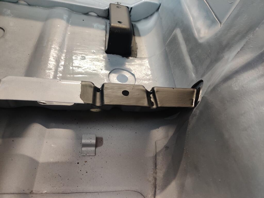

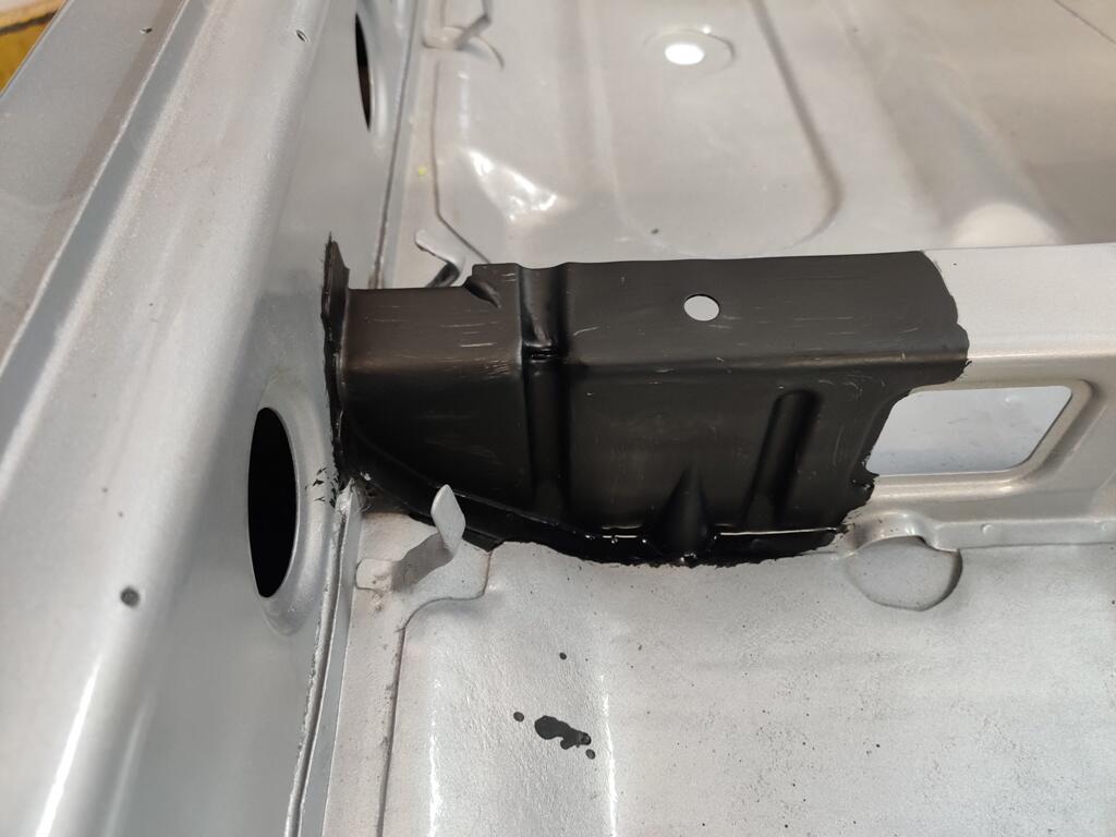

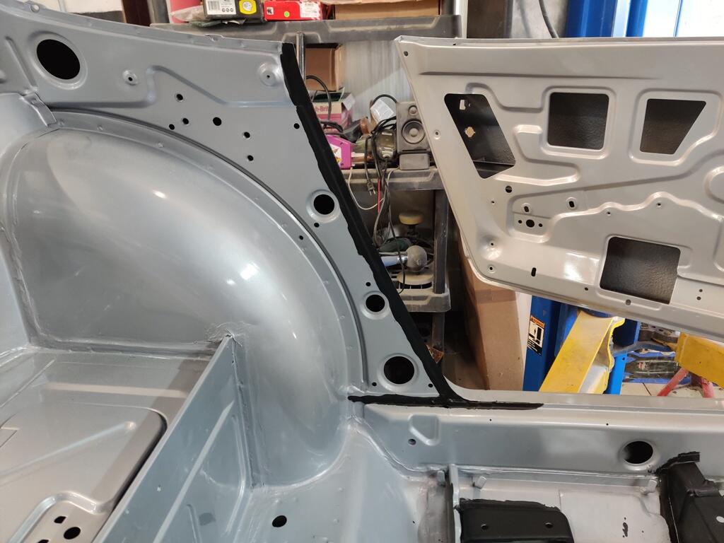

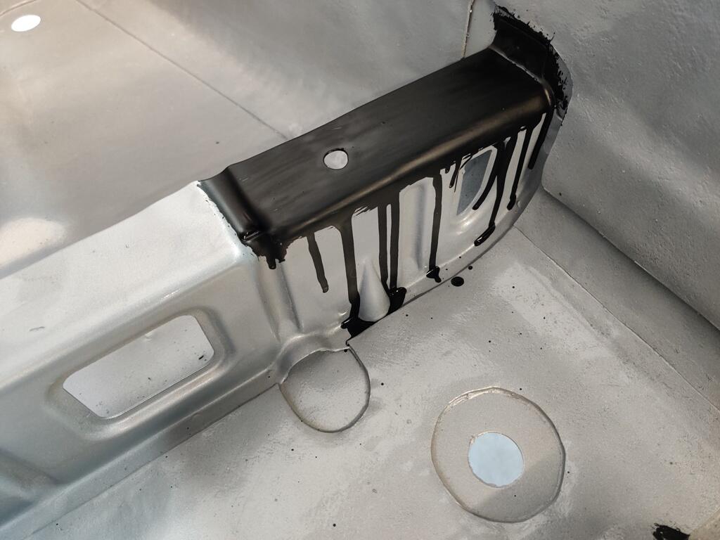

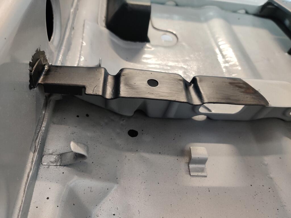

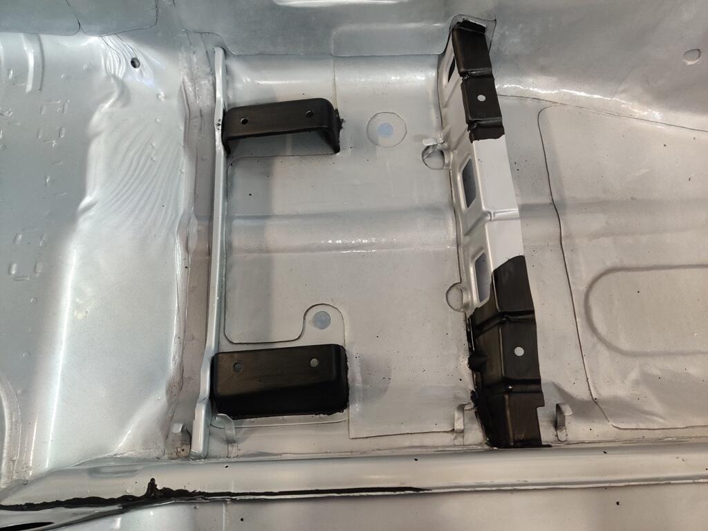

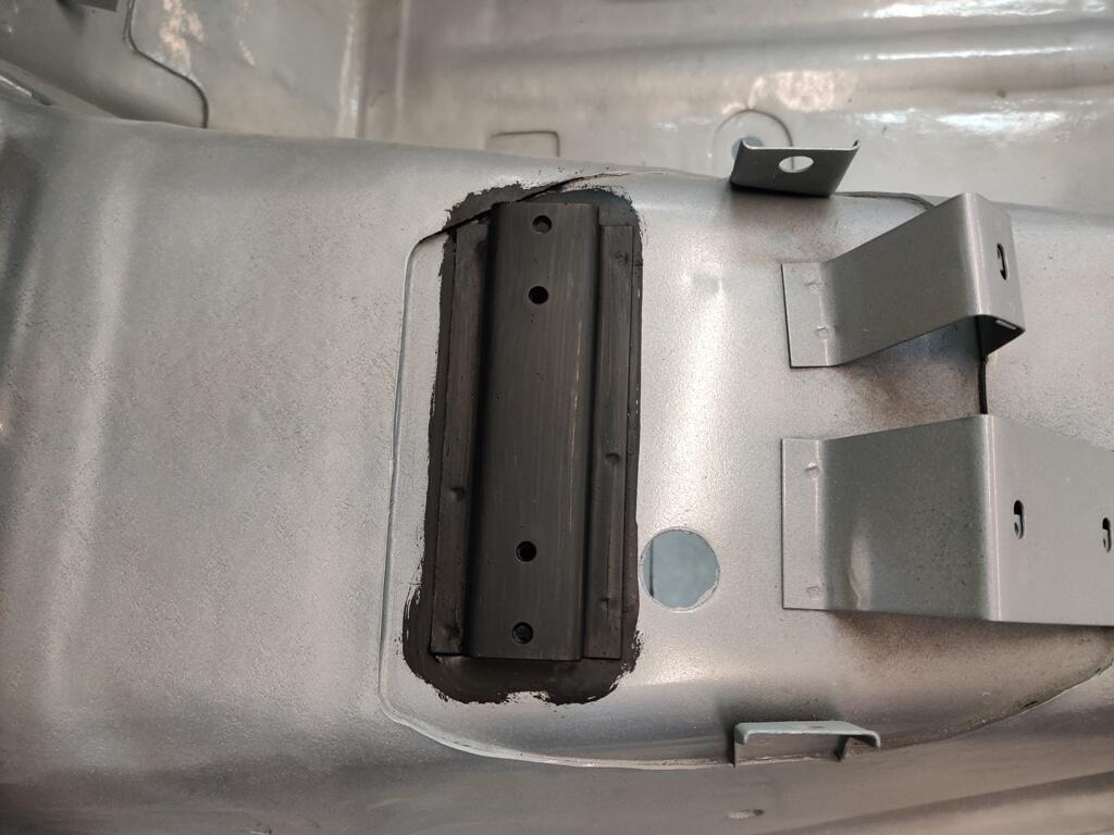

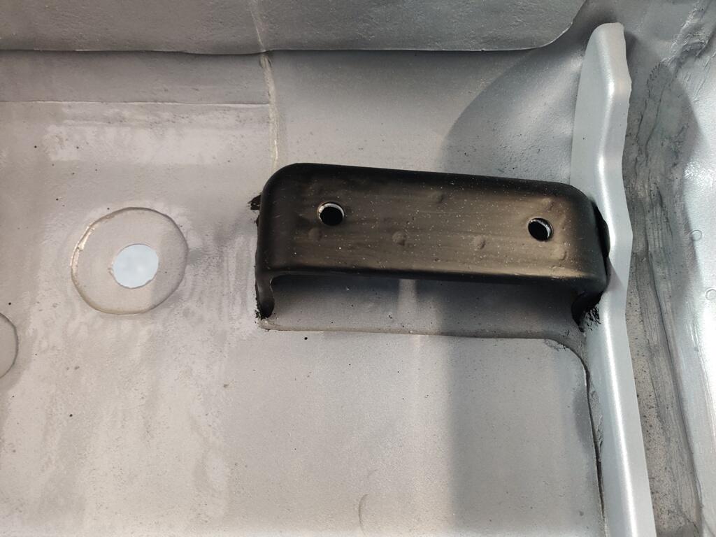

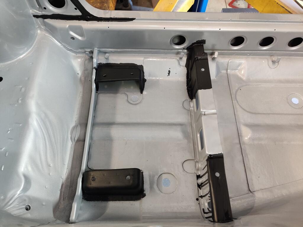

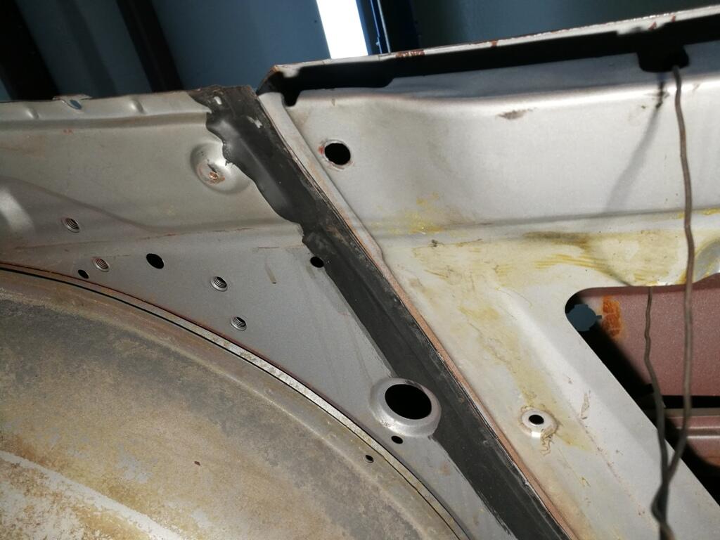

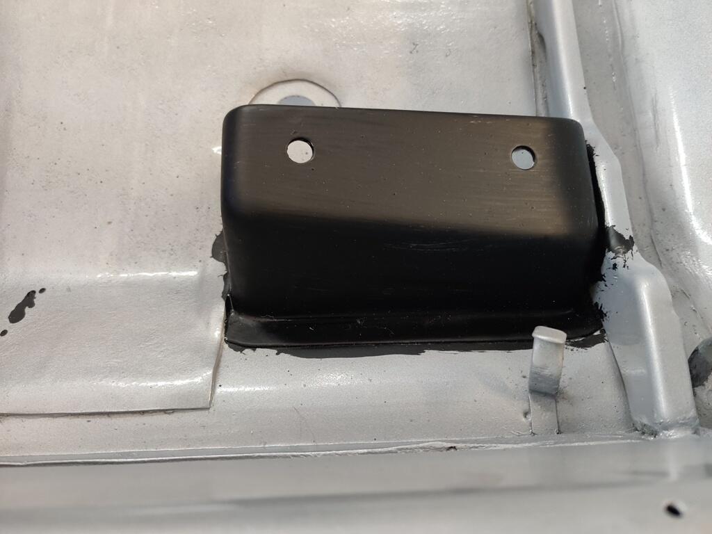

I had some fun this week end with some Krylon flat black paint.  I sprayed it into a small cup and then used a paint brush to attempt a similar look with the "black out":
Whoops on the runs and drips - ha ha ha 😆

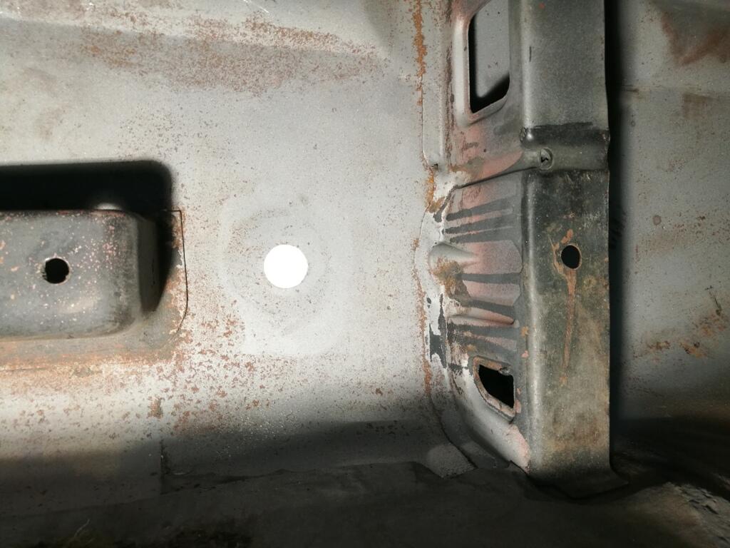

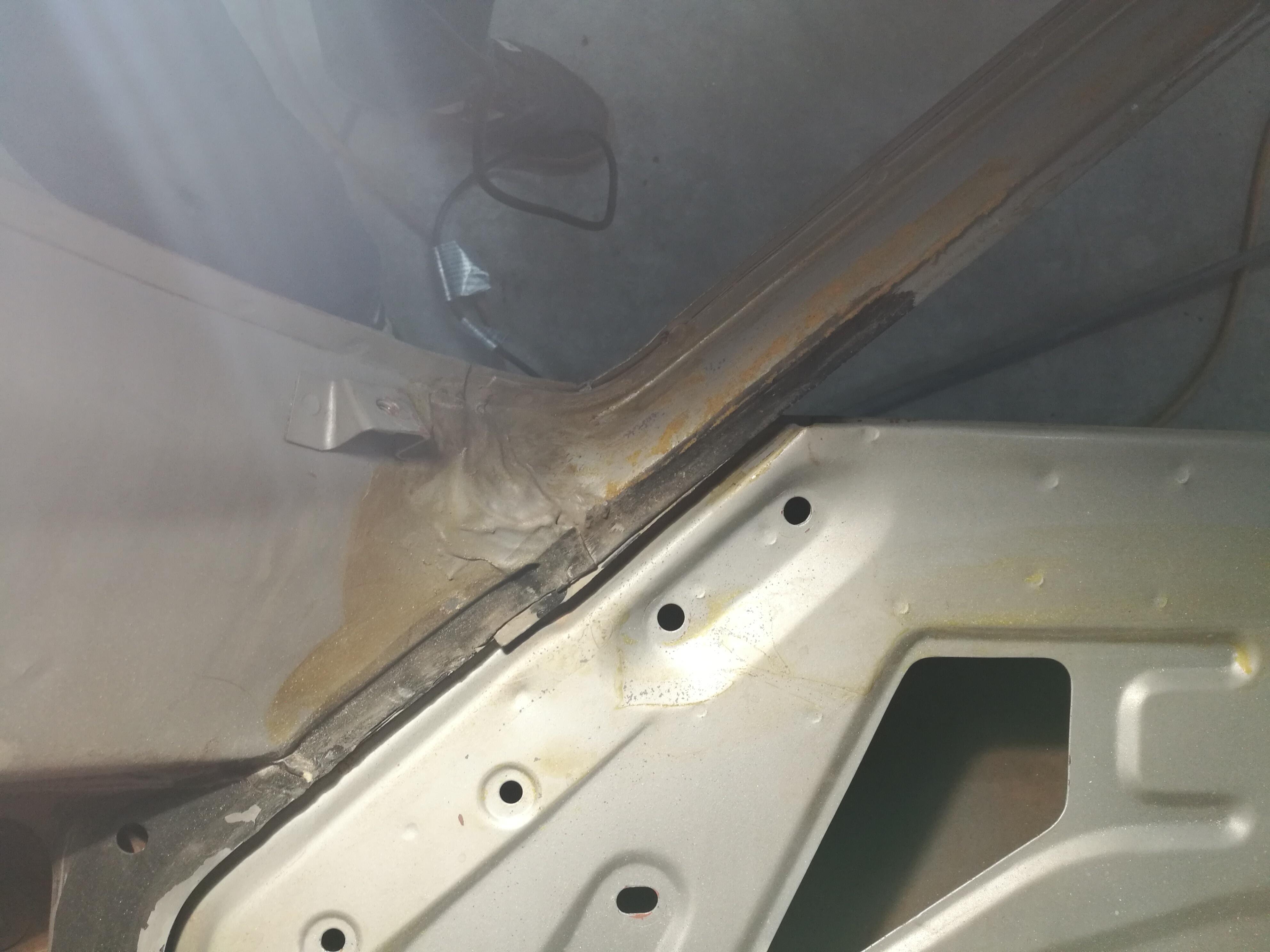

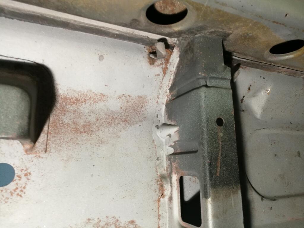

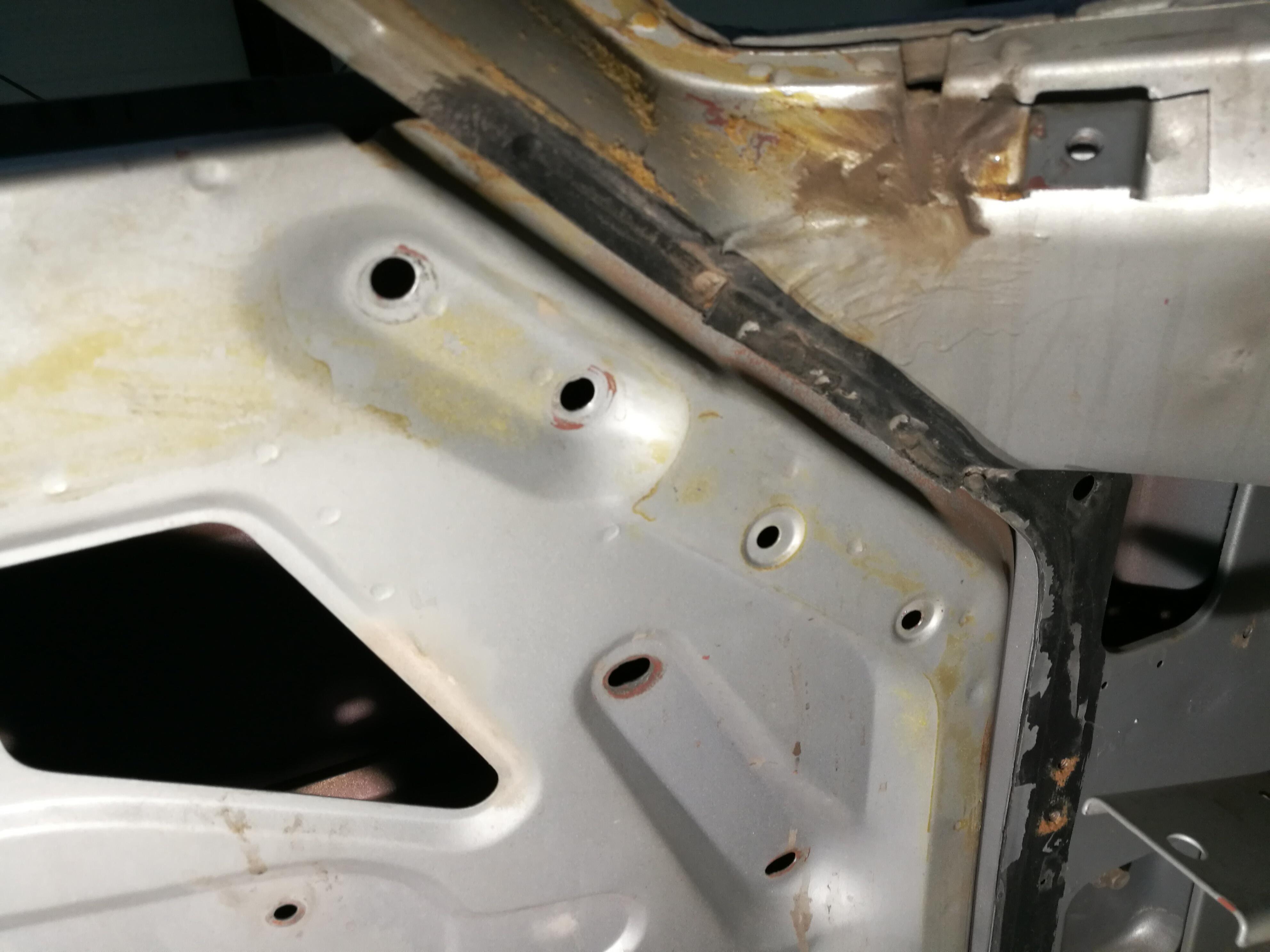

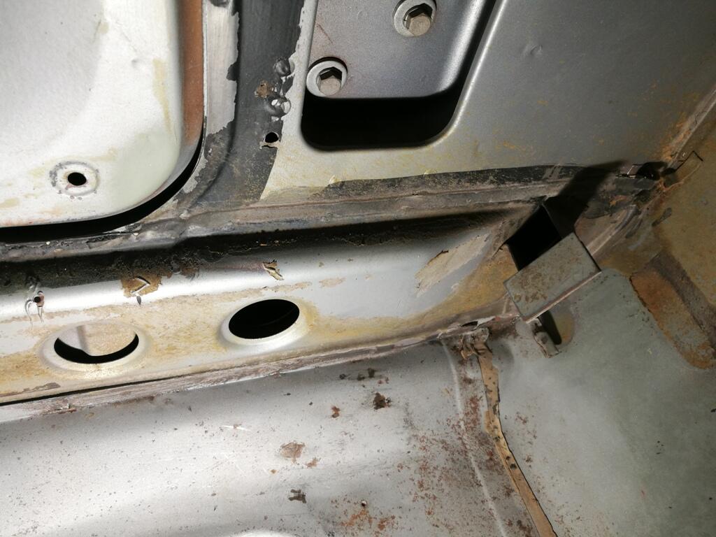

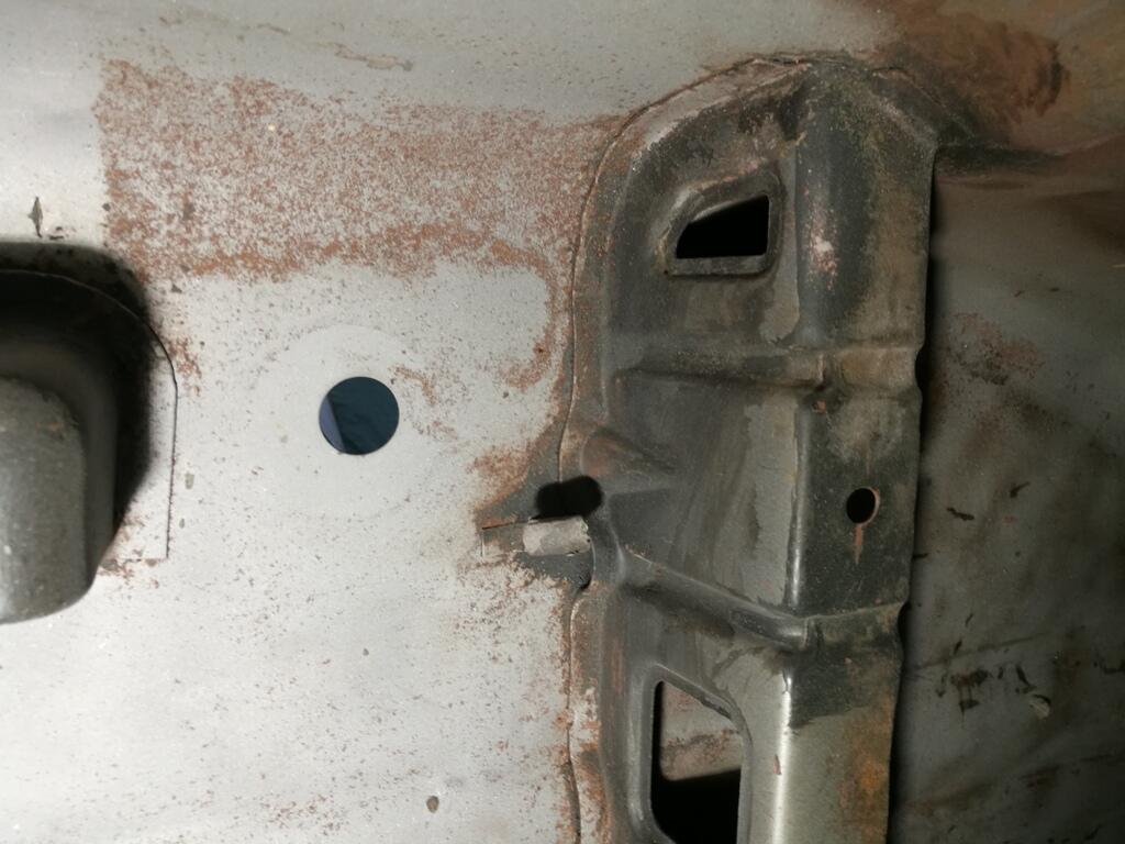

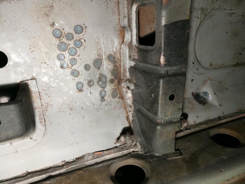

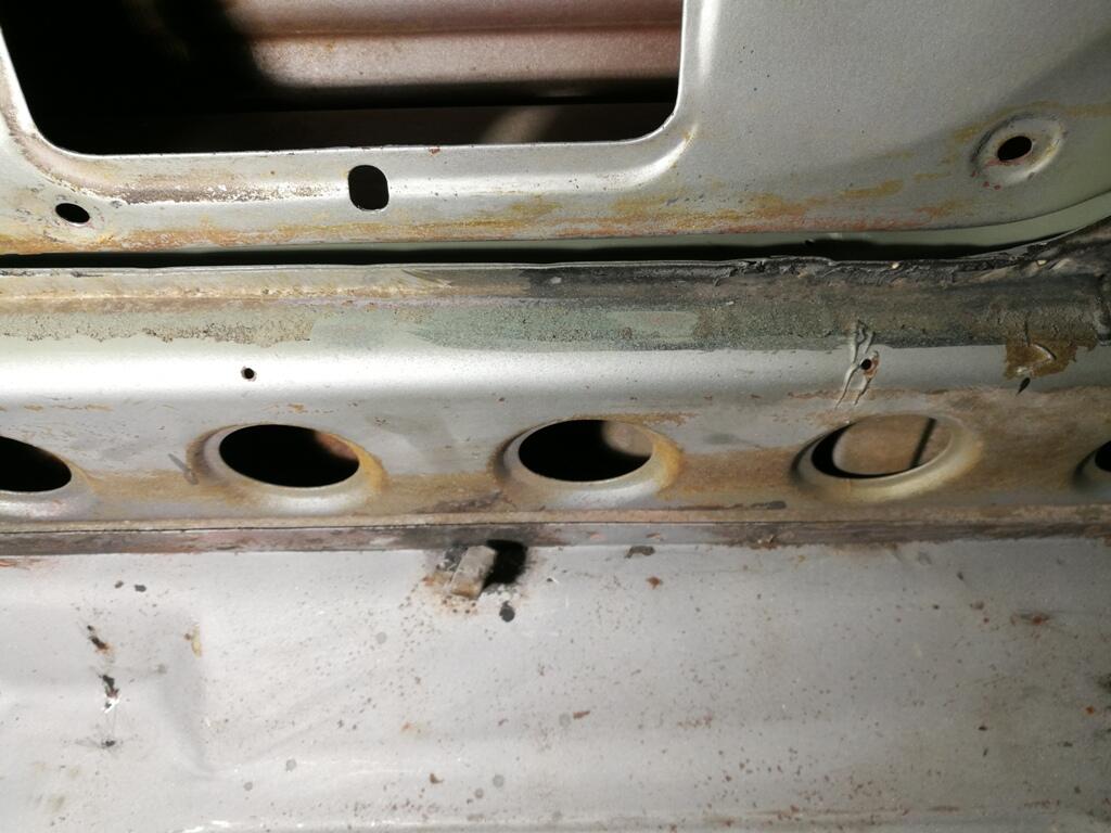

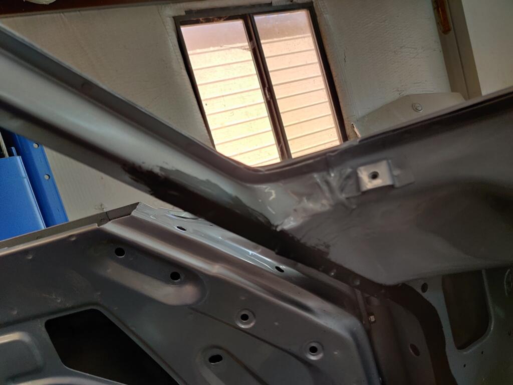

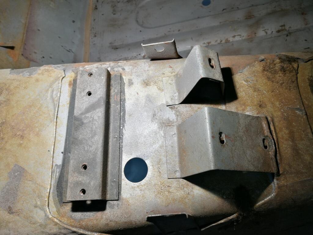

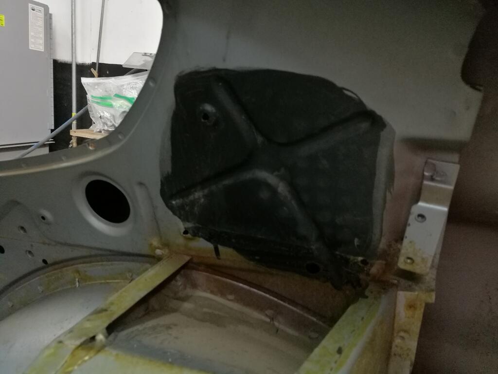

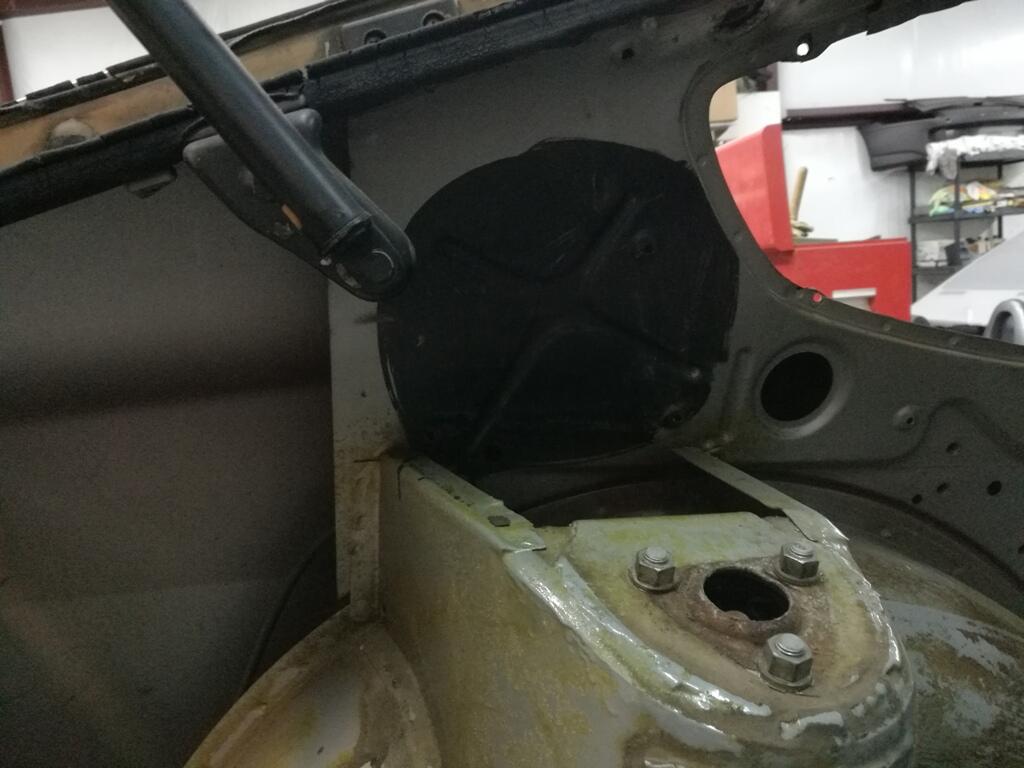

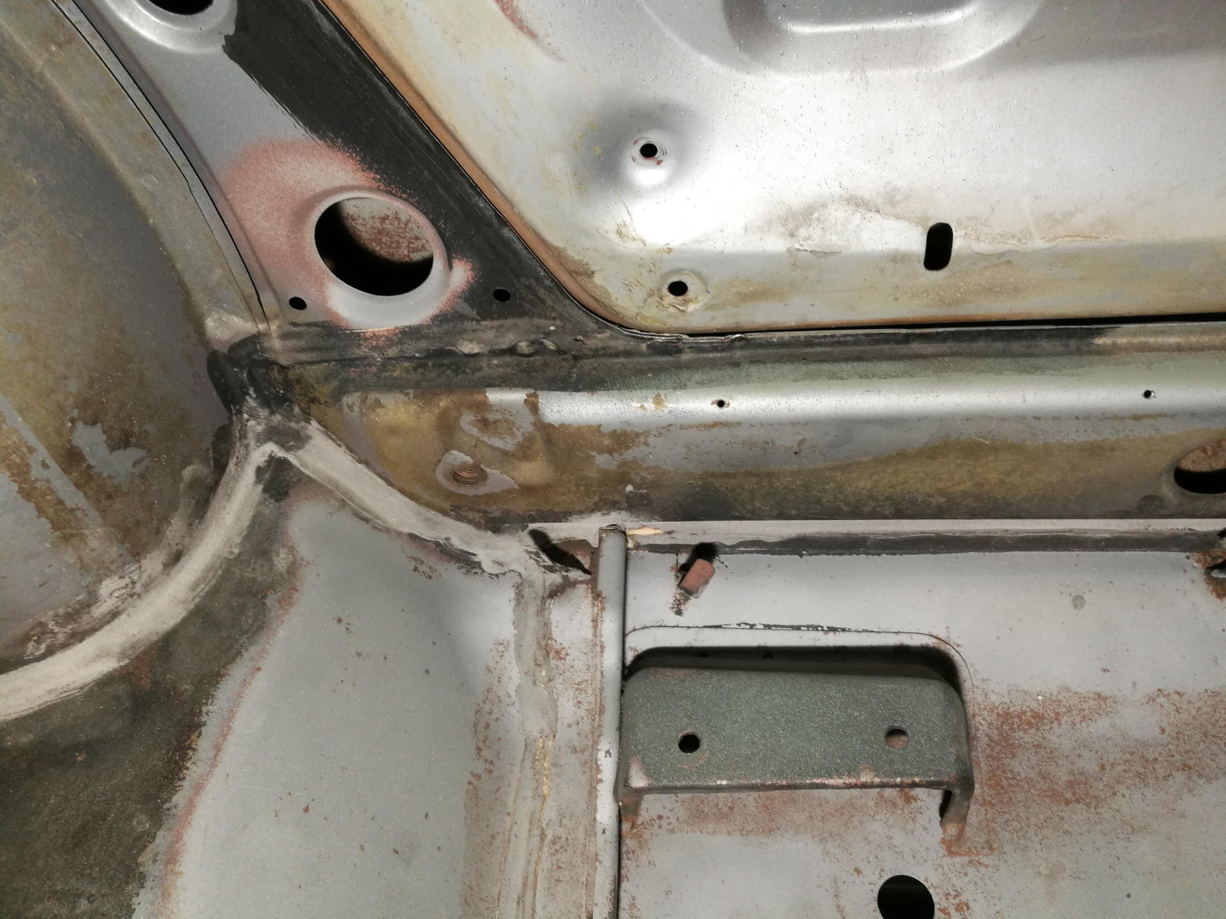

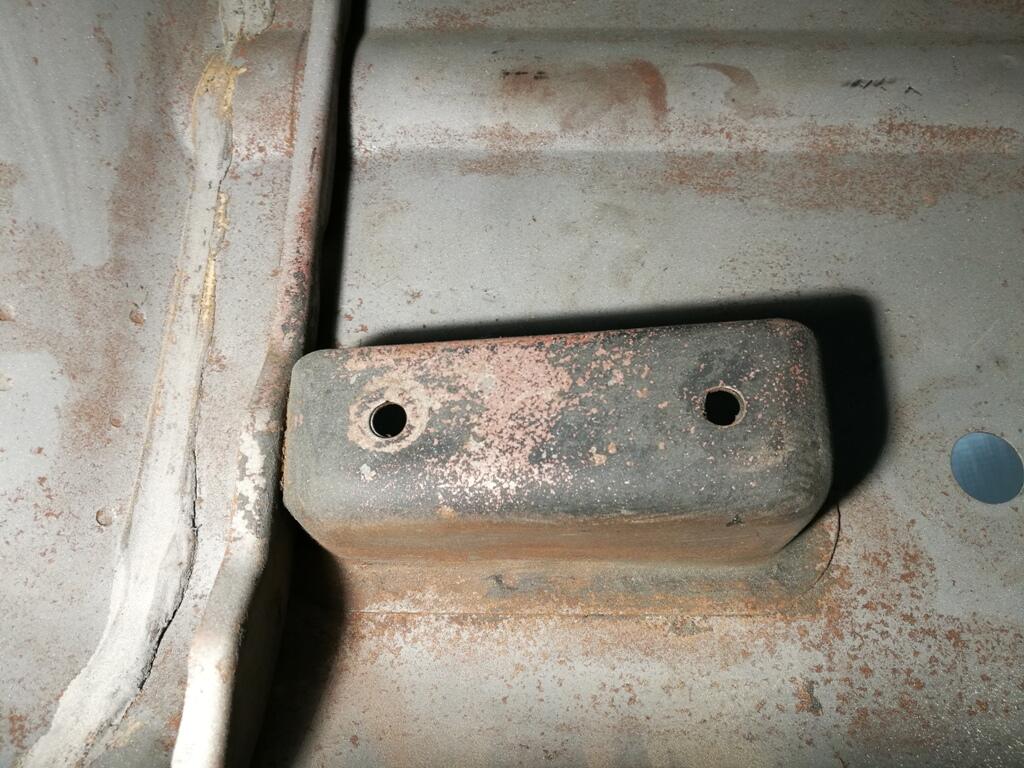

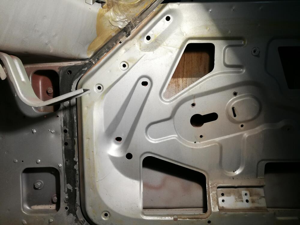

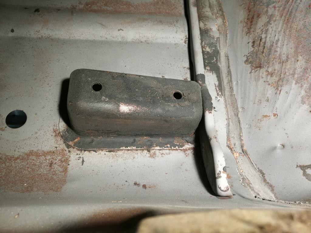

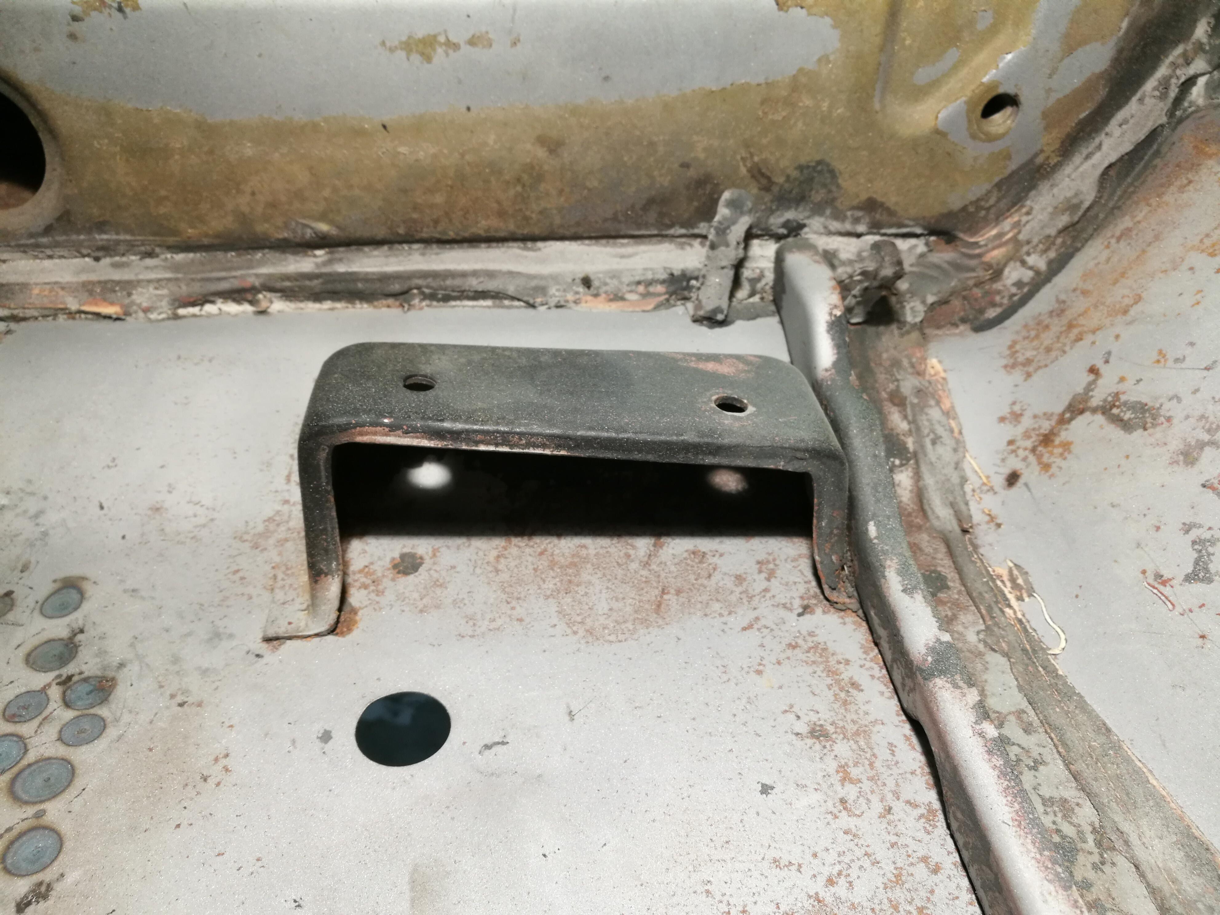

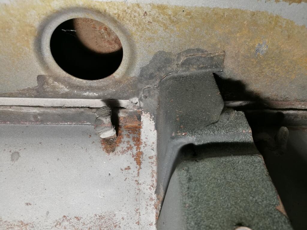

Here are my original reference pictures:
behind rear quarter panel trim.jpg  behind rear quarter panel trim2.jpg  front door edge.jpg
top of rocker and up rear door edge.jpg   top of rocker panel.jpg  top of rocker panel2.jpg
It was fun attempting to replicate the original "black out"

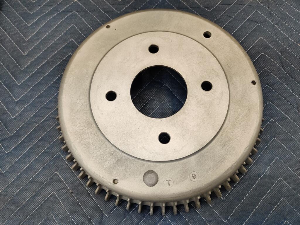

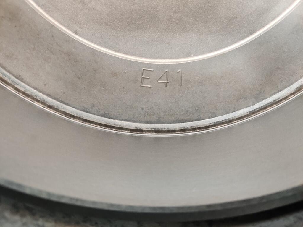

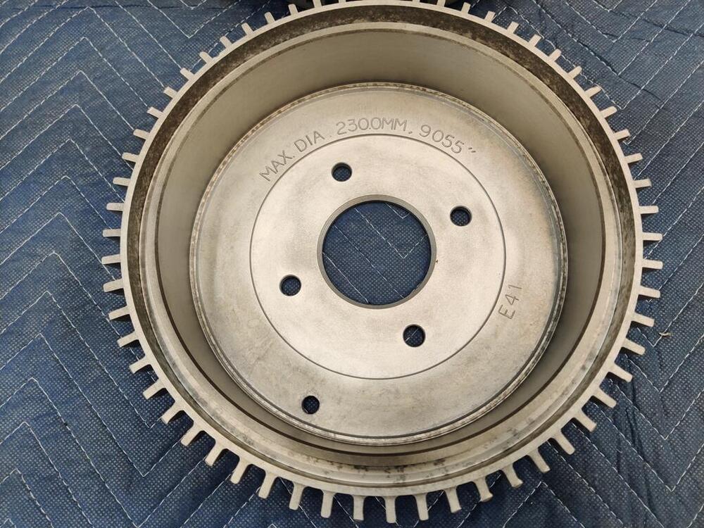

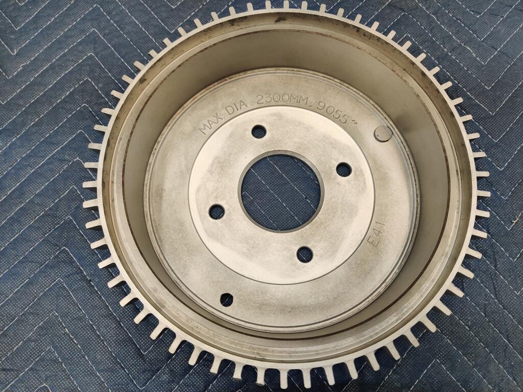

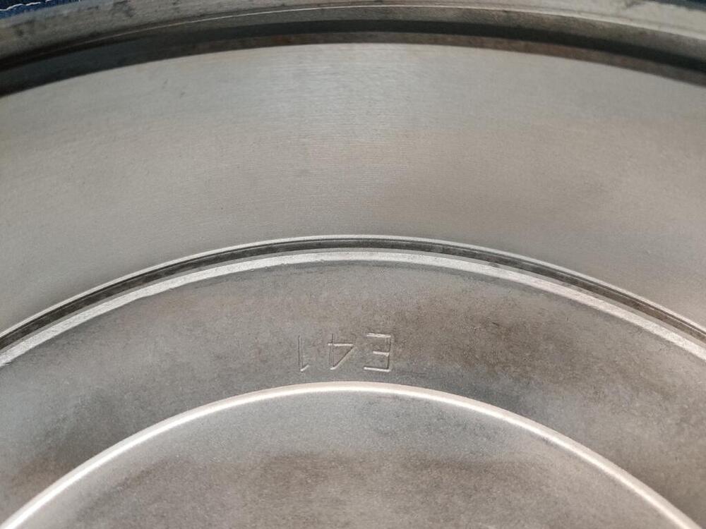

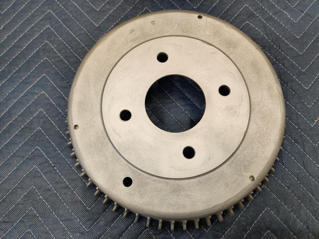

In addition to the black out, I had the drums "turned" and then I glass bead blasted them:
Unfortunately, I previous owner banged pretty hard on them with a hammer around the outer circumference.  But, that is not seen when the wheels are mounted.
