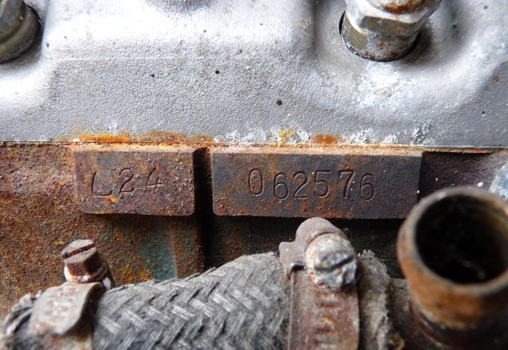

Look above the 1st and 2nd spark plugs, closest to the radiator, for the cylinder head identifying numbers. N42, N47 most likely.
Look below the head between the #5 and #6 plugs, just above the coolant split for the heater core. Looks like this :
It will be L24 L26 or L28 and some numbers. I expect an L28 as N42 casting blocks are found in early 280's
The head number is as stated above. N42 or N47 or something else as they do often get changed.

Okay so I did find it. The L28 isnt stock for a 74 260z is it?
Nope, its a 2.8 liter motor but you would need to break it down to know what you really need. Might need pistons, might not. Might need standard rings, might not
