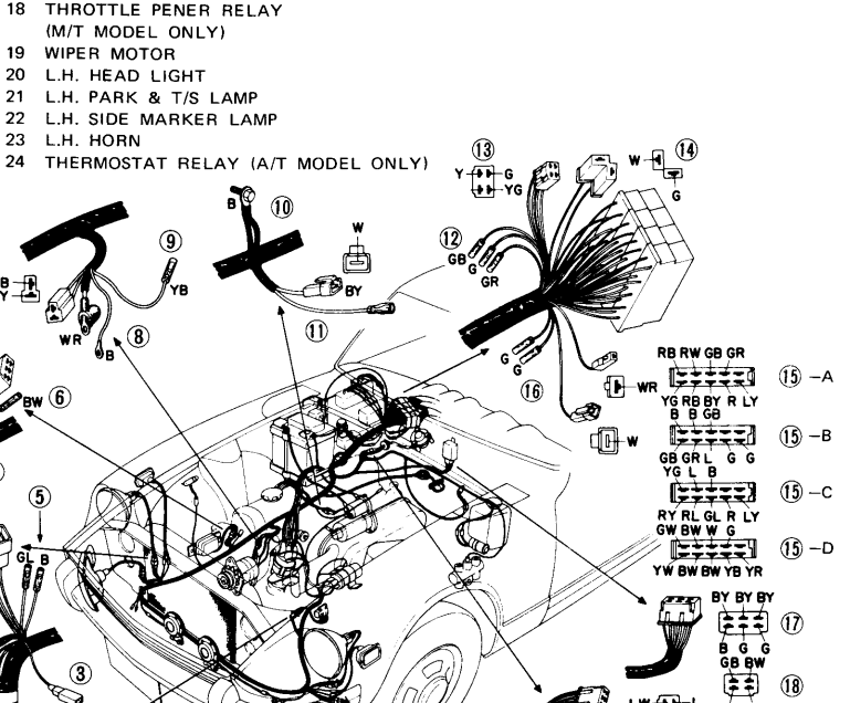

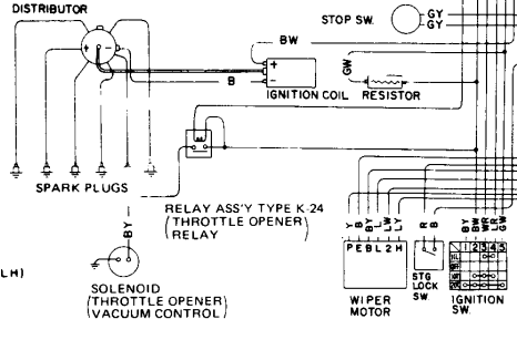

I believe it is the "Throttle Opener Relay" Part 18 below:

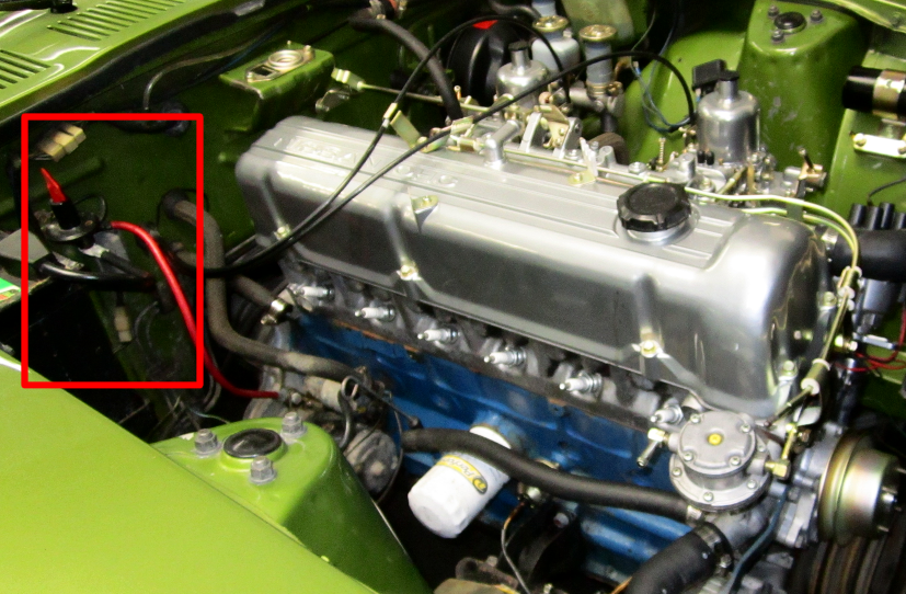

It is on the firewall between the battery and choke cable  gland
