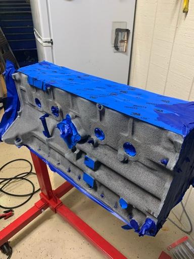

Engine Block is ready for paint.
I bought the POR-15 Degreaser and Metal Prep. Worked really good. The block is ready for prime and paint in the morning. Wanted to let it completely dry over night.

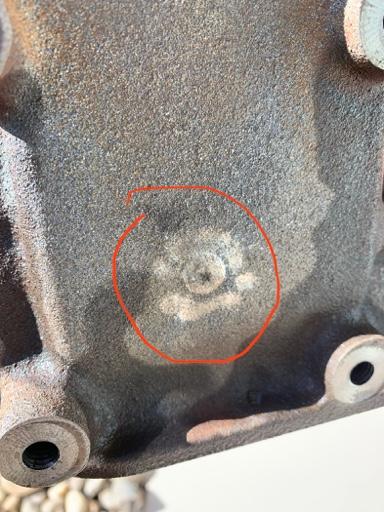

While cleaning and taping off I noticed an area on the block that almost looks like someone cut something off or filled a hole. See first couple pics.
There is nothing on the inside of the block there that shows anything done. Looks like someone grinders the outdoes a bit. This is in the area where the oil screen goes.

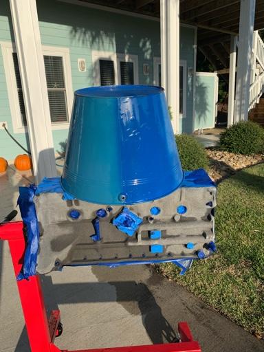

I also painted a metal bucket to test out the engine colors. You’ll see Chrysler Blue on the Left and Old Ford Blue in the Right. I also have GM Blue which I test on the bucket tomorrow.
f9c545046d187351c2a834fa1ddb2232.jpg422fbfb4986d0bfa2d490fa29d7ea154.jpge8bed391bd1fc911d040f1a69cce57c8.jpgdb72e1d0f48ce14acc12899d5822d146.jpg
I believe Chrysler is the closet match .

I think you might be right on the color. GM Blue looks close too. See pic below. GM Blue in the right.
I think all of that paint is too much straight-up blue, and not enough green.
If you don't have anything left that has original paint on it (like maybe the front pulley?), I found a reasonably close sample at Home Depot. I don't have the sample number handy, but I can get the name and number for you if it would help. You can't use that paint (latex house paint), but the value is in the "portable color standard" that you could get at your HD. It should be the same color as the one at my HD.
Thanks Captain!
I’ve decided that I’m not too concerned about getting exact stock engine color. My neighbor has an 82 ZX and the engine is 100% stock and it is probably closest to GM Blue. You can’t pick it up in the photos but it has a hint of green in it unlike Chrysler Blue which is all baby bluish. I need to get paint on this block before the rust attacks it. The POR-15 metal prep did a great job of getting the surface ready. It converted the micro rust in the pours of the casting to a polymer that is paintable. The humidity’s a bit high for painting but letting it sit too long is a worse option. I live 500 yards from the Atlantic Ocean and the salt air here is brutal on metal. I’ll post photos after.
Any clue what that area that looks like someone filled a hole. Not sure if it was that or something rubbing from the junkyard or it’s transport. I don’t see any compromise in the metal or anything else. Just wondering if other engines have this too from the factory?
