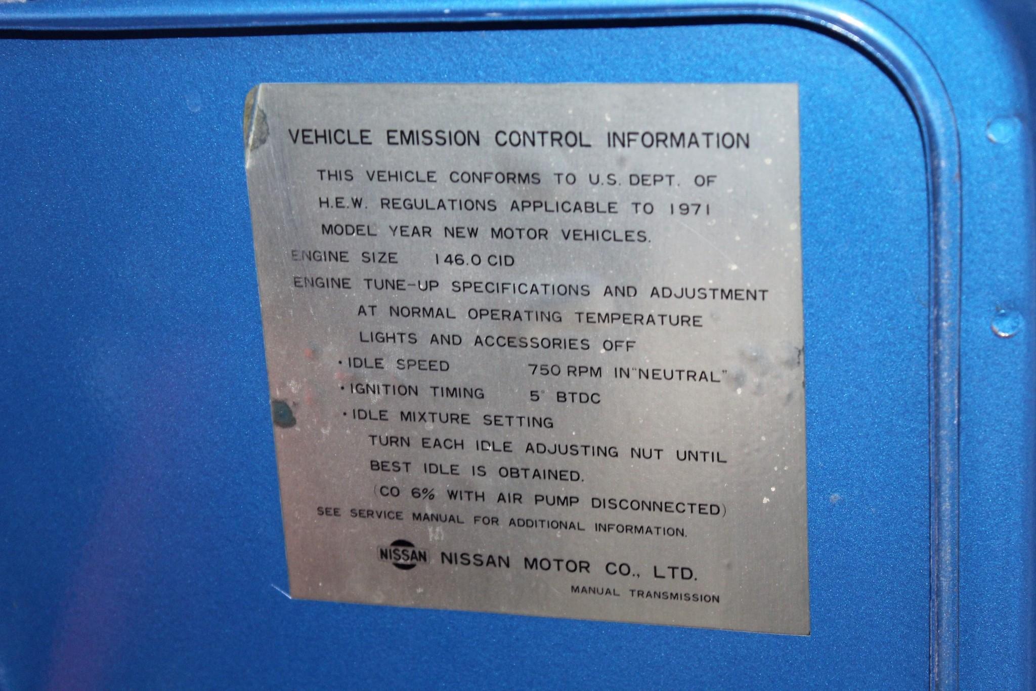

DannDZ, when I restored my car, I needed the correct emissions decal for my 1/71 car which was imported through Los Angeles
I ended up having the correct 71 emissions decals for both car that entered the country through California, and all the other domestic ports of entry.  These decal are very correct and have not been offered for sale yet, but would sell to anyone interested.
The first picture is a reproduction of the third picture, and the second picture is of both the original and reproduction California decal.
Dan
Thanks for your input. The decal you shows matches the reproduction I bought, and still have not installed, from Banzai in 2001. My air filter box "the earlier one without the snorkel butterfly and no riser tube."
I understand that "back then" dealers had some flexibility in what year to title a car. It depended on a number of factors including manufacture date and when it arrived in the U.S. As I said, mine has a manufacture date of 8/70. Unfortunately for me now, the dealer decided to title it as a 1971. I understand why, but I do wish it was a '70.
I think the biggest question for me right now is were both '70 and '71 emission stickers silver? If they were, then I more than likely have the right one "in stock." If '70 had a gold-tone, then I need to find a gold-tone sticker. May be time to call Banzai!
Both of the emissions decals that I had reproduced are gold.  And the real decals shown that I used to copy are
gold.  I was not able to find any gold repros, thus my need to make my own.
