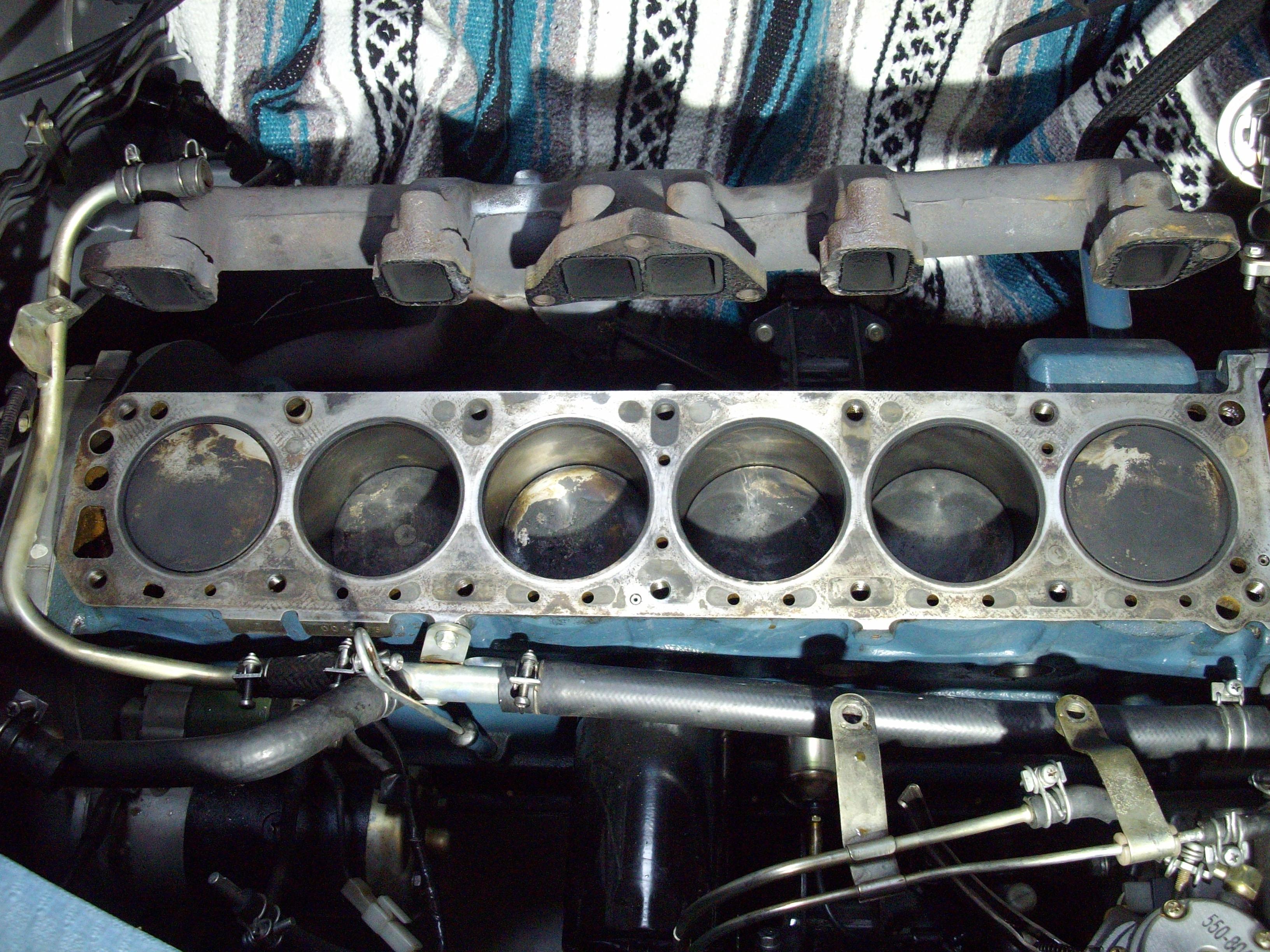

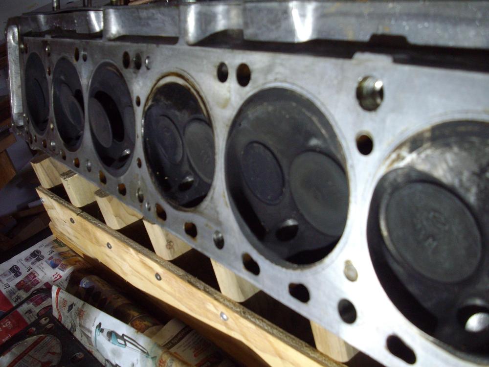

So I pulled the head off.
There is a fair bit of oily, black soot inside the cylinders. Everything looks good on the head gasket, so I have not found anything yet. As it is in all 6 cylinders I do not understand where it is coming from.

Captain: Sorry for the confusion, jonbill is correct. It has been running great, but with high oil pressure for about 100 miles or so. Then I checked the relief valve, all good with no modification. Started it up again and still had the problem.. Shut it down, installed gauge started it up and pressure was good at 61 psi.
Shut it down and installed a new pressure sensor I had. Start it up and reading was good, but started running rough. Looked in rear view mirror and large cloud of blue smoke. This all happened in the space of 15 min. The two problems might not be connected as Zed Head eluded to but it seems to me that they are connected.
