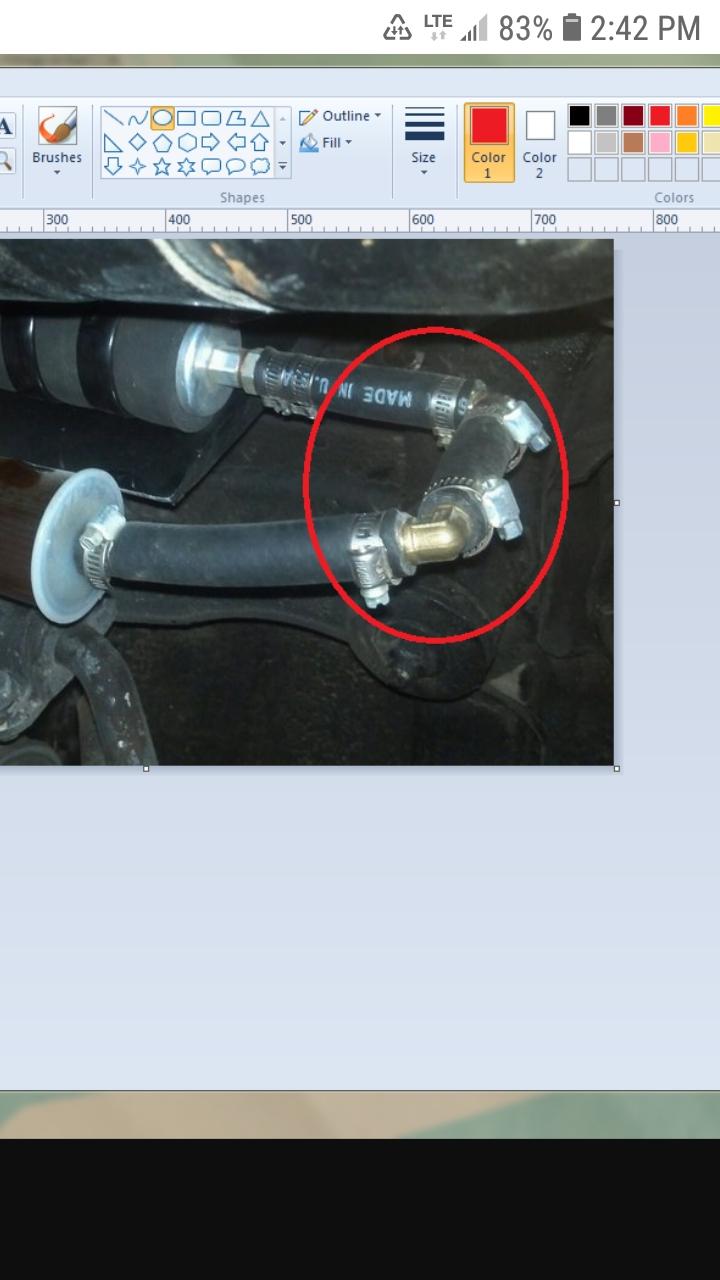

Thanks guys, l read briefly about the evap delete but didnt think it was something I wanted to tackle. (maybe I should since I had to cut 1 of the evap lines) I'll be asking the radiator shop how much it'll cost to move that elbow the other direction though :)
3/4" pex elbows make up a nice 180 degree bend and no one knows but you.
Here's the best I could find quickly
Edited by siteunseen
That's the EZ coil. From all I've read they work fantastic.
I went the cheap and in my tool cabinet route with those pex fittings.
