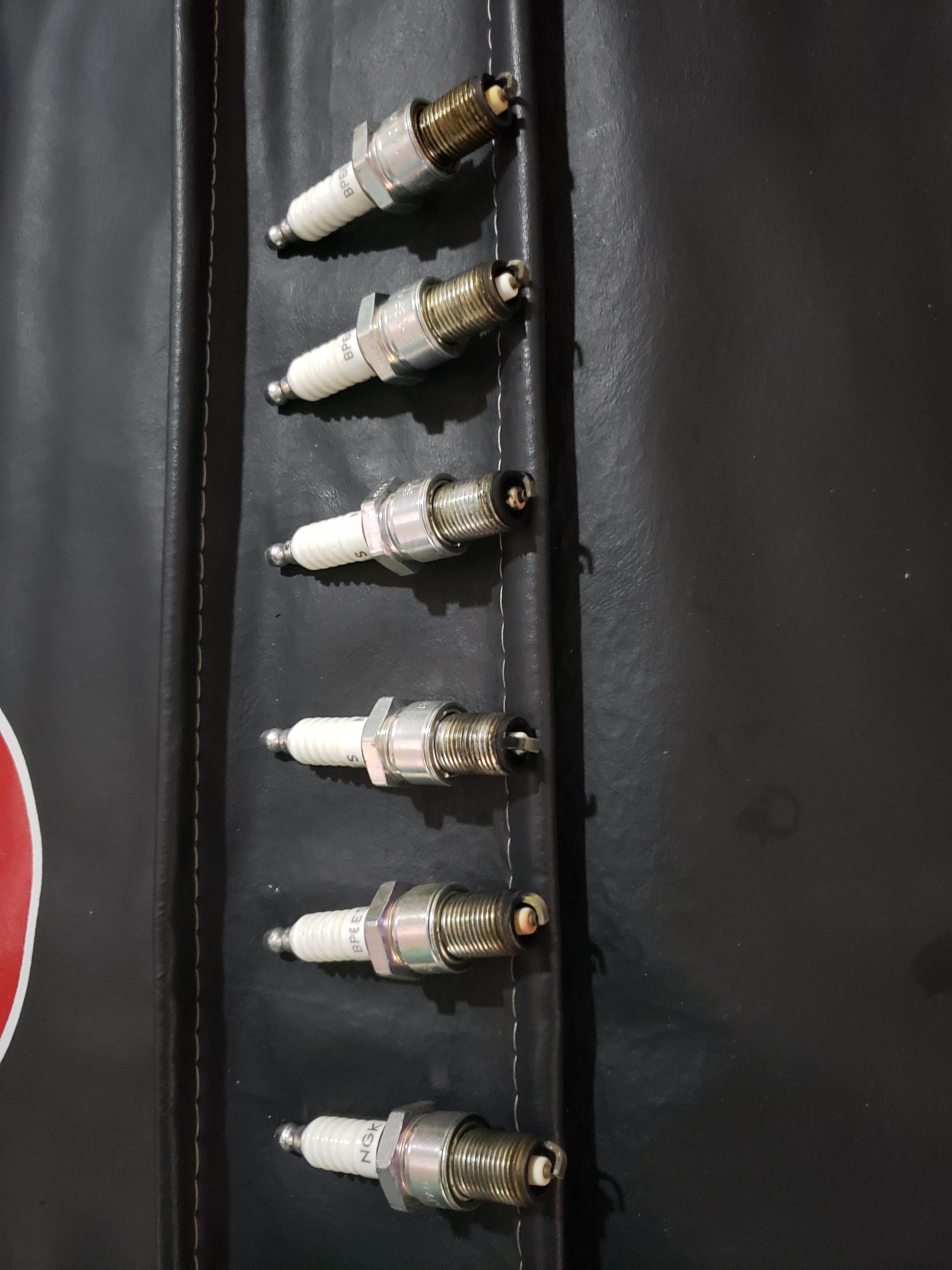

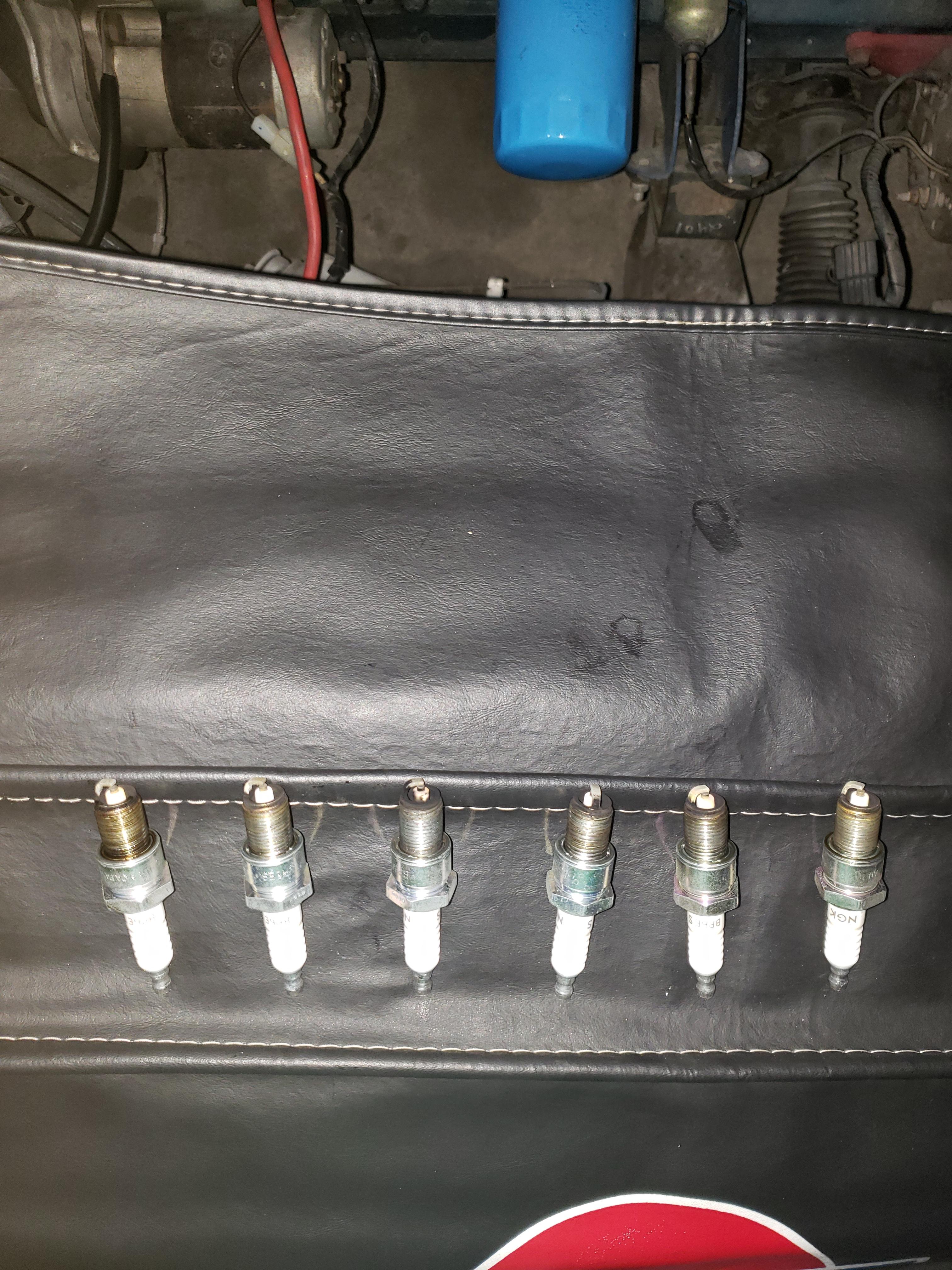

Just pulled out all 6 plugs havent got into any heavy traffic. Plugs 4 and 3 came out a little bit more black. I will clean them up with brass wire brush and try again. The order of the pics is 6 5 4 3 2 1 left to right.
 They look pretty good. Odd that 3 & 4 are a bit darker. As you said, clean 'em up and try again.
