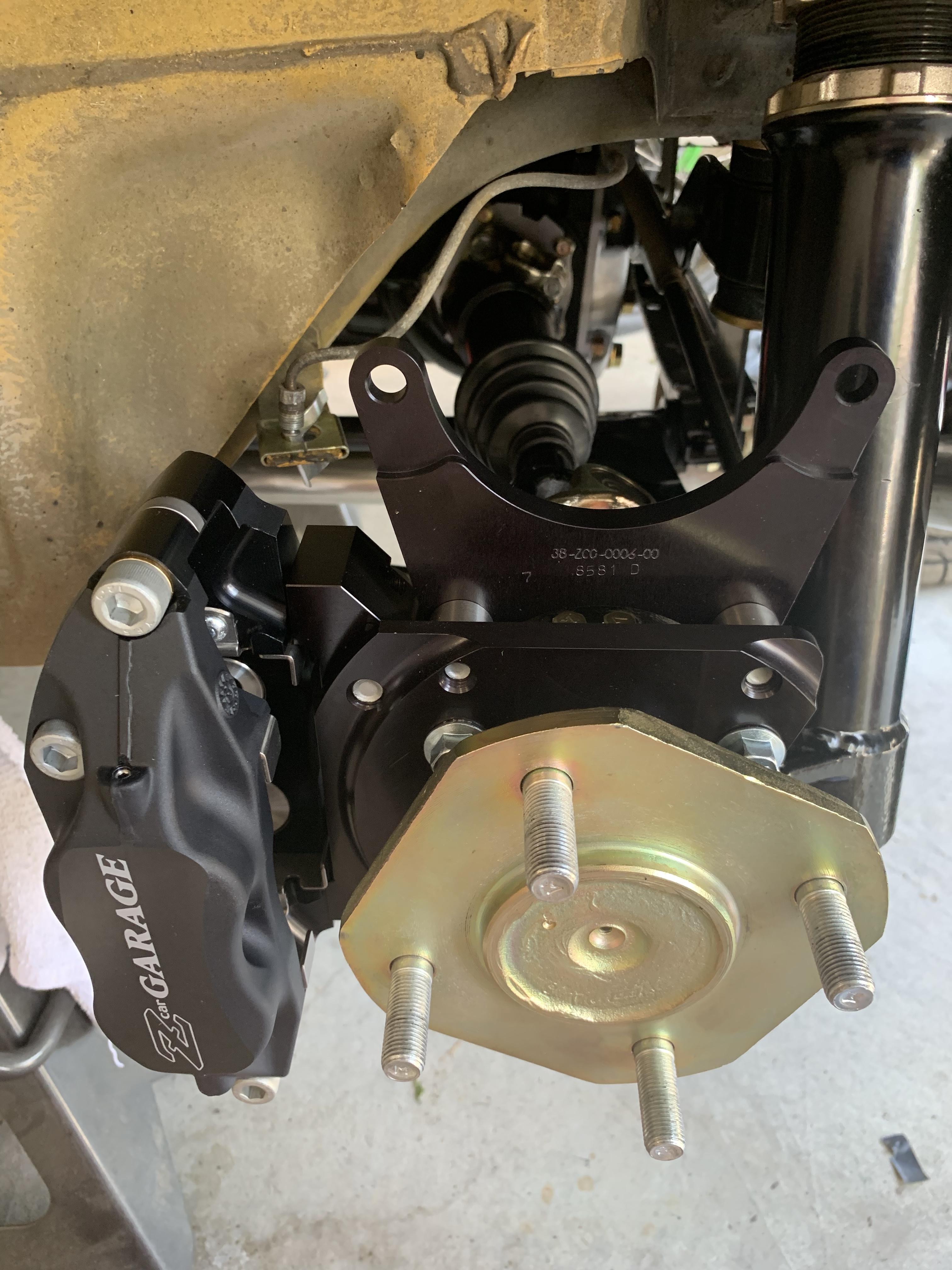

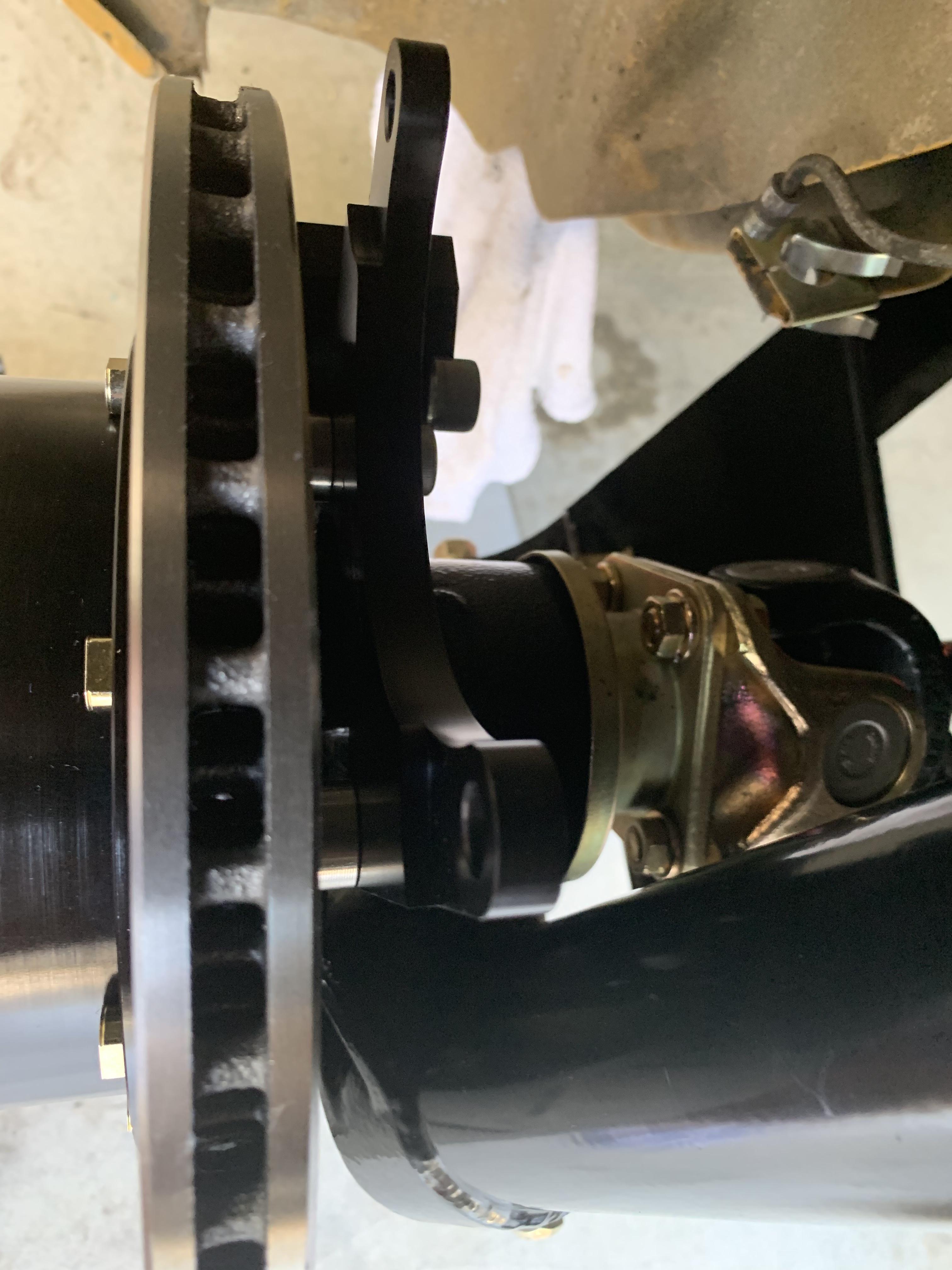

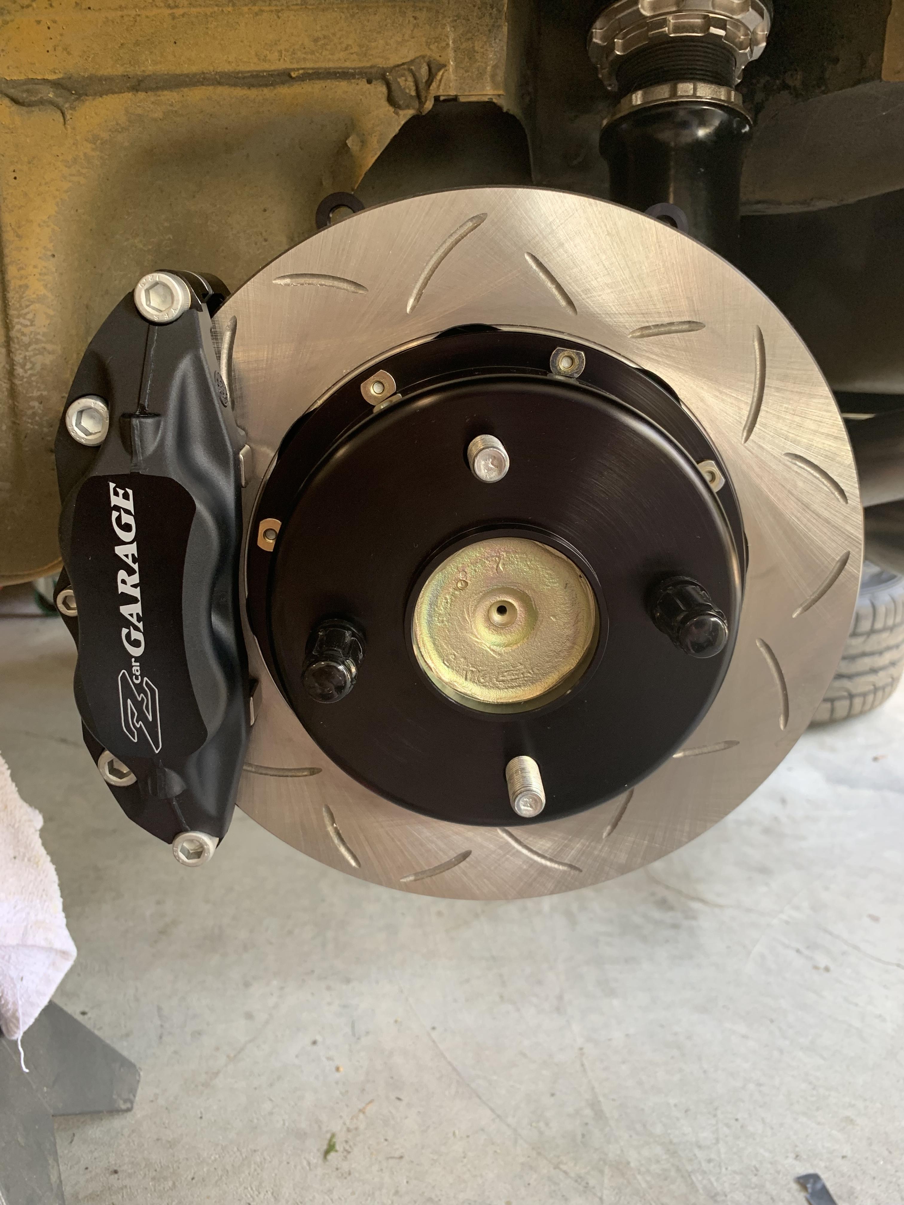

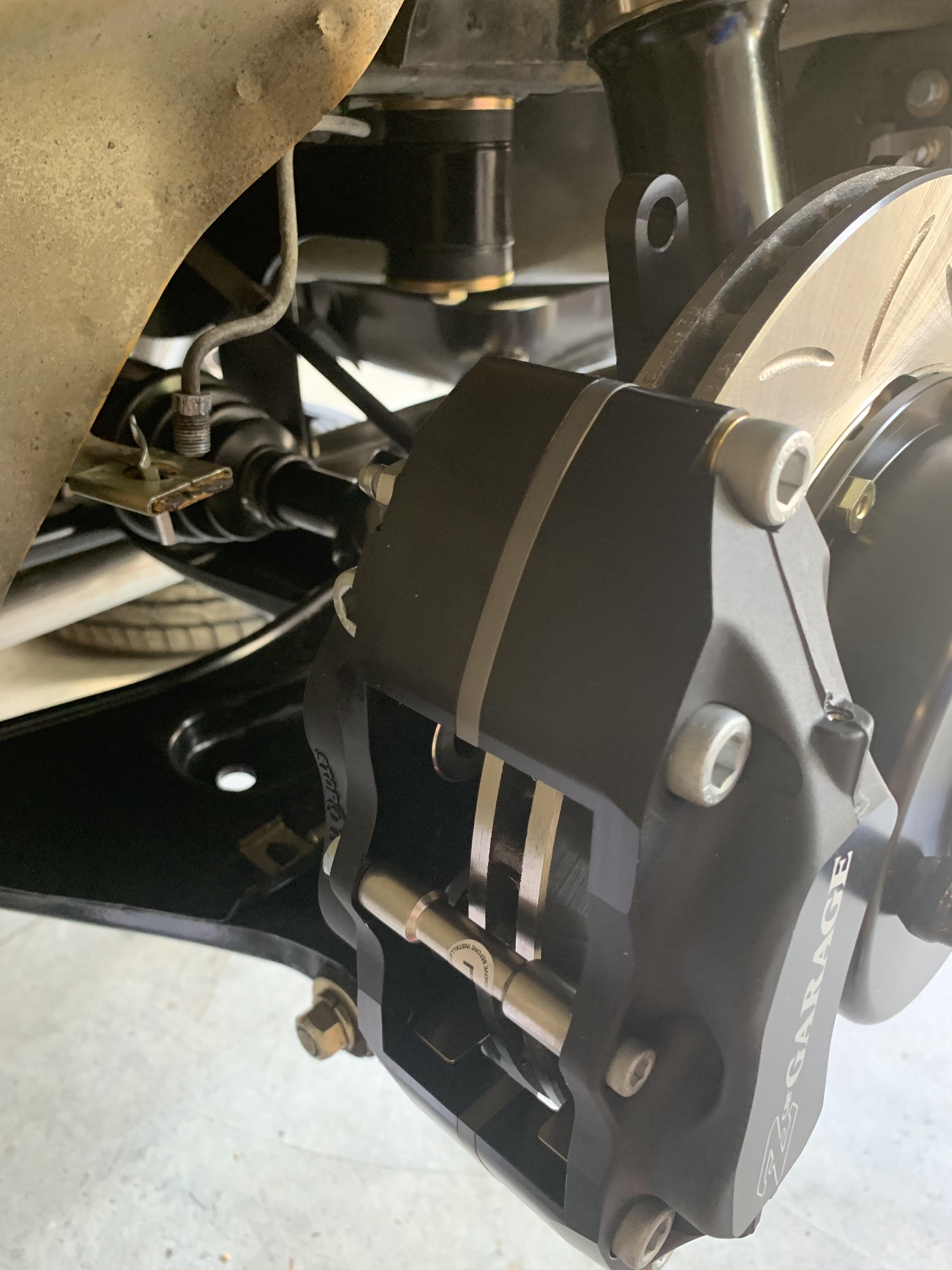

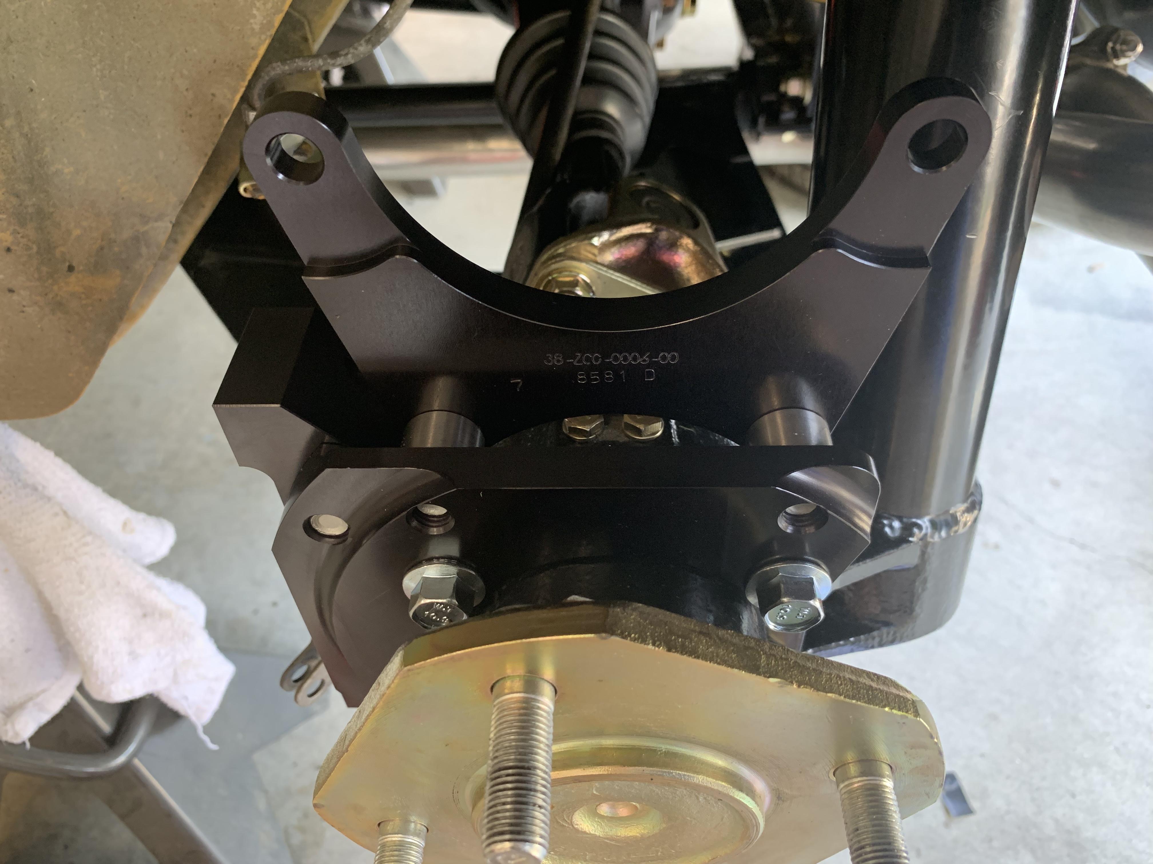

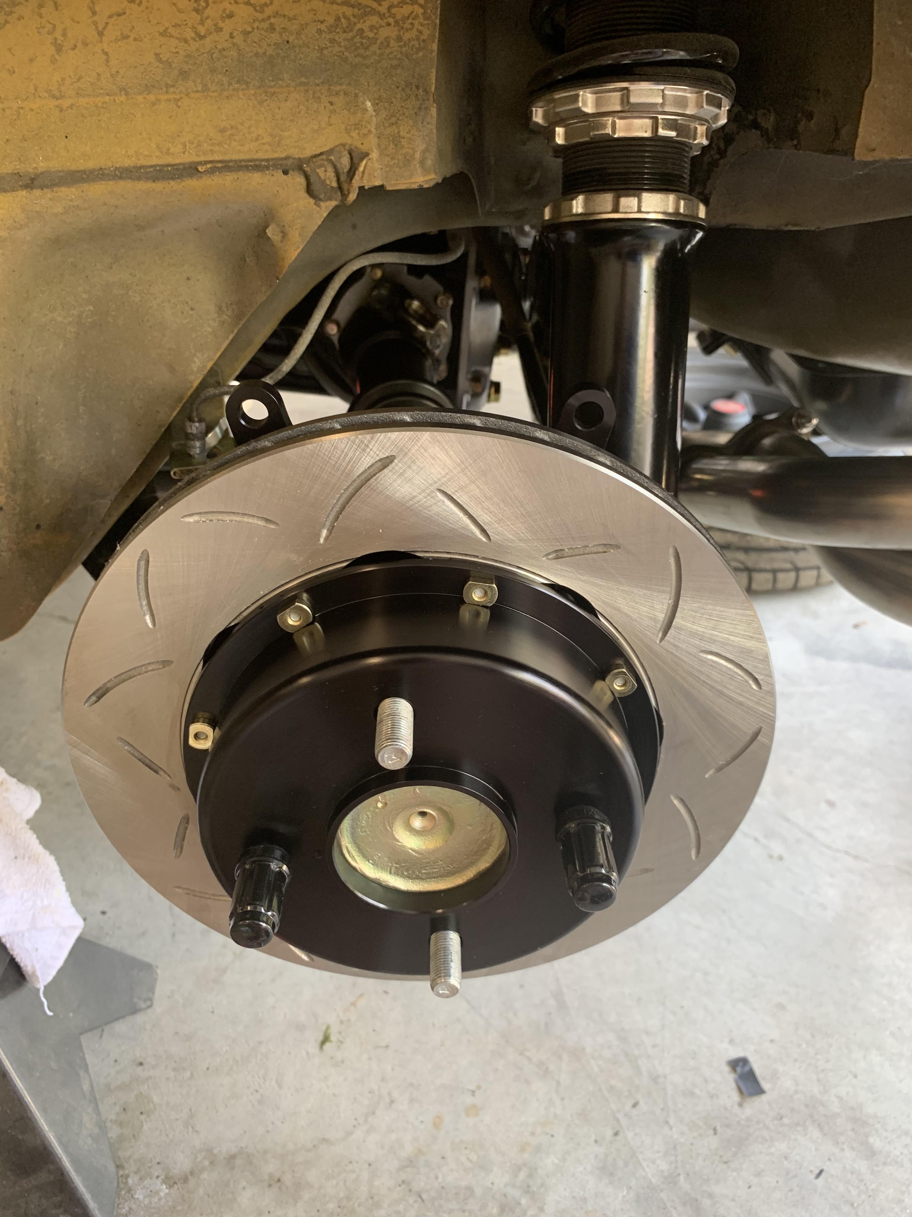

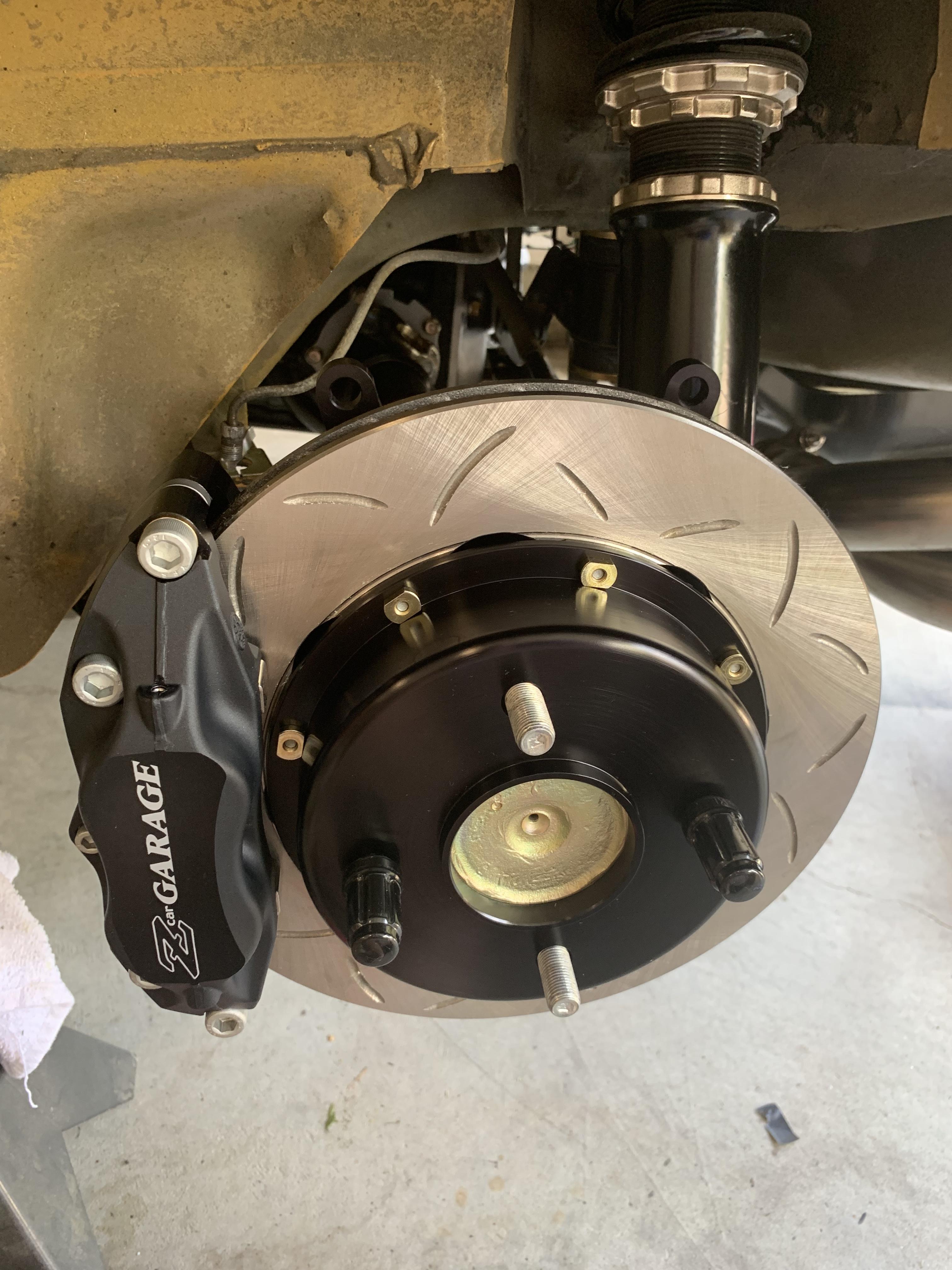

June 1, 20196 yr Author comment_576764 No proportioning valve needed. If you have a rear prop valve like me. It has to be gutted. From looks both front and rear calipers are identical. They have different cast numbers. So there must be a difference. Hopefully finalizing fronts and rears tomorrow. Then waiting on the e brake caliper and pads for the whole kit. Link to comment https://www.classiczcars.com/forums/topic/62261-zcargarage-big-brake-kit/?&page=2#findComment-576764 Share on other sites More sharing options...

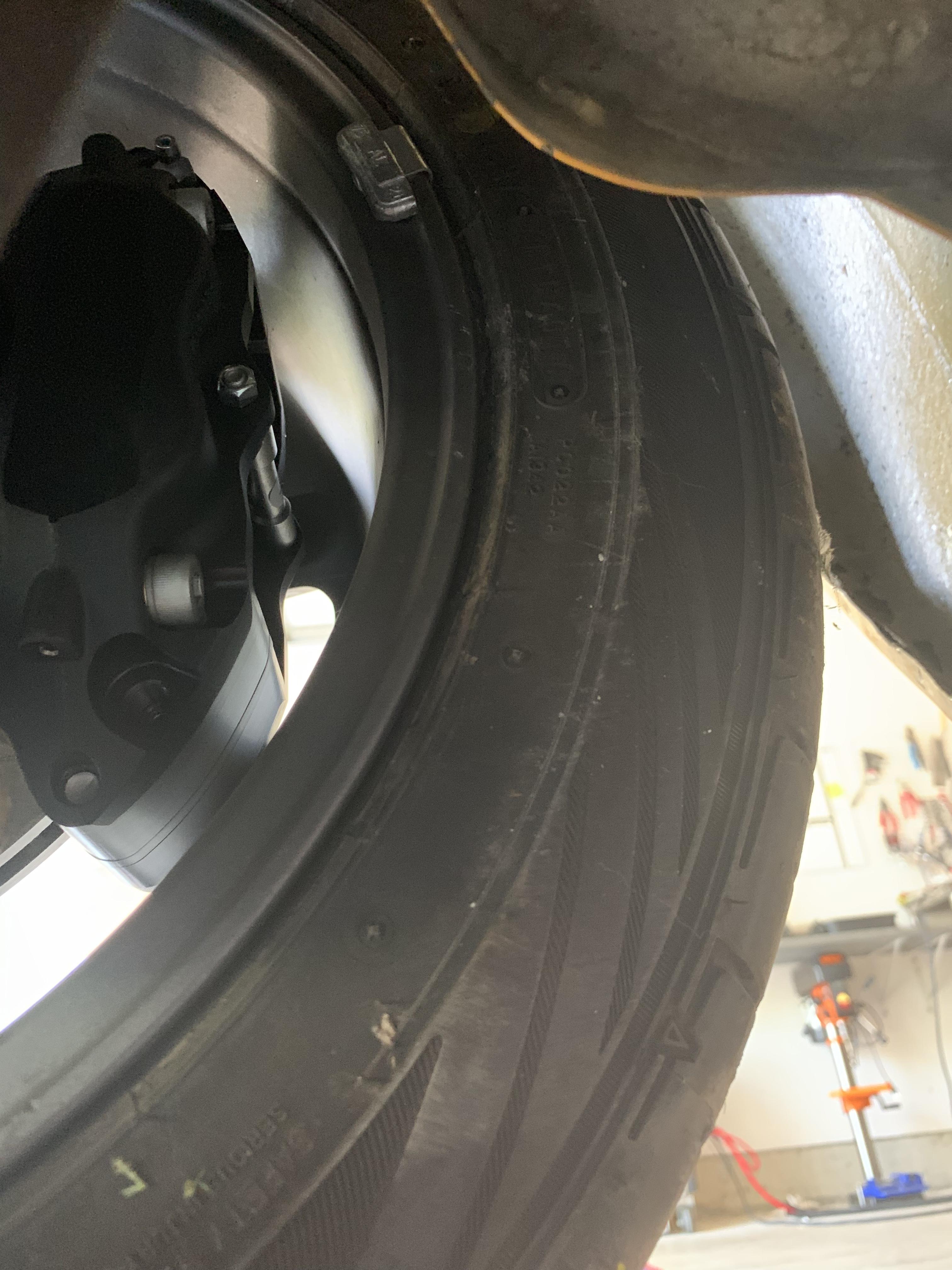

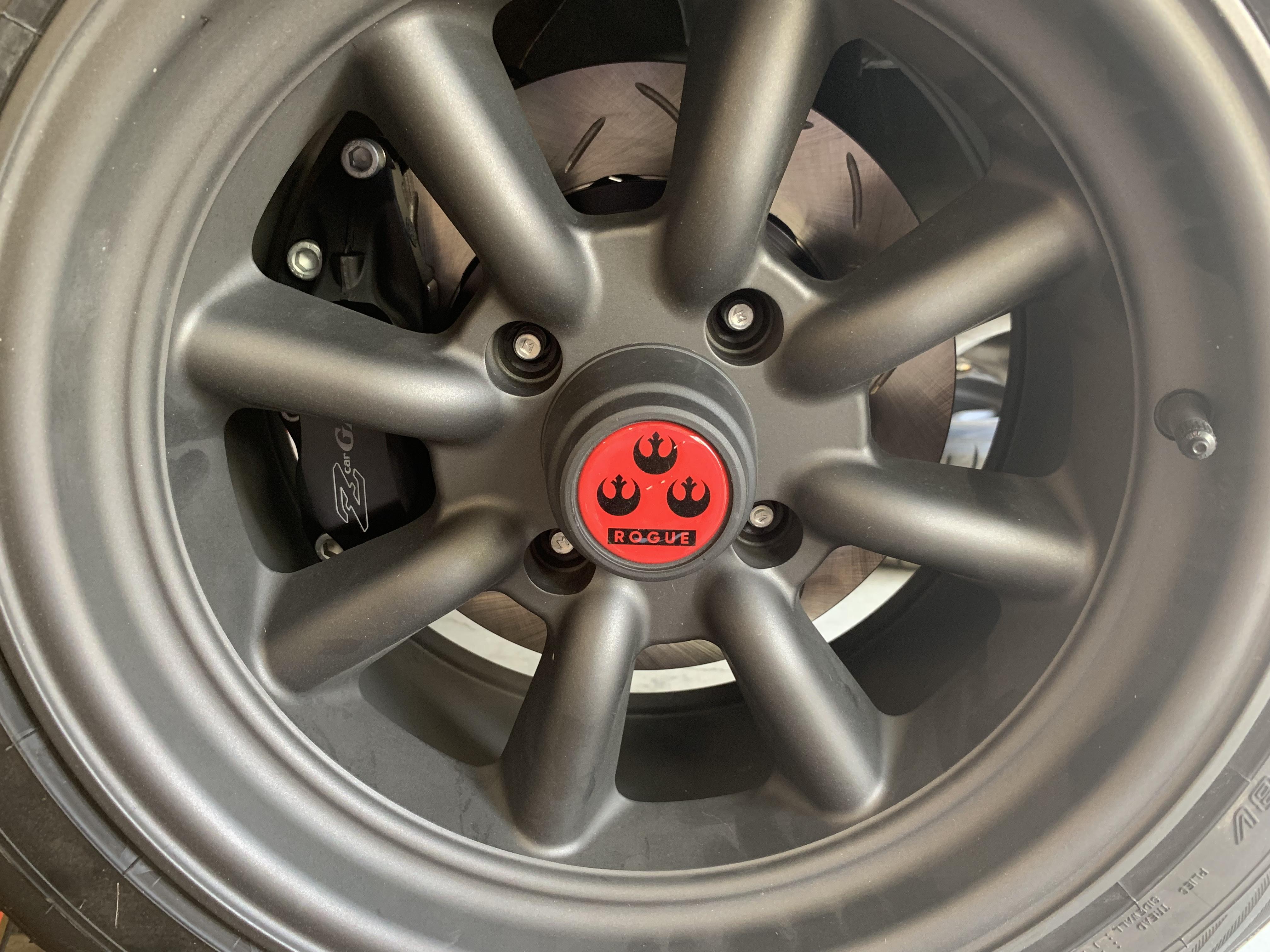

June 1, 20196 yr comment_576775 what make are the calipers? Mine are 286mm and clear 14" wheels with ease. 295 will fit under 14" Edited June 1, 20196 yr by Jason240z Link to comment https://www.classiczcars.com/forums/topic/62261-zcargarage-big-brake-kit/?&page=2#findComment-576775 Share on other sites More sharing options...
June 1, 20196 yr Author comment_576776 I’m blown away by the level of fit and finish and engineering that went into the kit. Link to comment https://www.classiczcars.com/forums/topic/62261-zcargarage-big-brake-kit/?&page=2#findComment-576776 Share on other sites More sharing options...
June 1, 20196 yr Author comment_576777 1 minute ago, Jason240z said: what make are the calipers? Mine are 286mm and clear 14" wheels with ease. 295 will fit under 14" Stoptech Link to comment https://www.classiczcars.com/forums/topic/62261-zcargarage-big-brake-kit/?&page=2#findComment-576777 Share on other sites More sharing options...
June 1, 20196 yr Author comment_576780 rear wheels clear with ease. Now time to wait for the rest of the parts to come. Link to comment https://www.classiczcars.com/forums/topic/62261-zcargarage-big-brake-kit/?&page=2#findComment-576780 Share on other sites More sharing options...

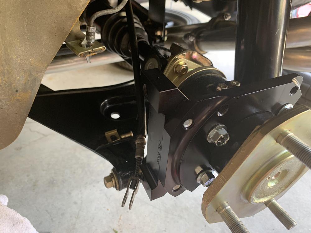

June 2, 20196 yr comment_576796 Do you know why they went trailing caliper, then leading for the rear? Is that a sticker on the caliper? Do you have to run a second caliper at the rear for parking or is it built in like the classic vw design? Link to comment https://www.classiczcars.com/forums/topic/62261-zcargarage-big-brake-kit/?&page=2#findComment-576796 Share on other sites More sharing options...

June 2, 20196 yr comment_576800 16 hours ago, duffymahoney said: No proportioning valve needed. If you have a rear prop valve like me. It has to be gutted. From looks both front and rear calipers are identical. They have different cast numbers. So there must be a difference. So if the brake system was engineered from the ground up for our cars then perhaps Stoptech has used constrictor valves in the rear calipers to reduce the flow to get the balance right for front to back pressure. Can't see too many serious track guys liking that situation but maybe ZCG offers a different option for track cars. Link to comment https://www.classiczcars.com/forums/topic/62261-zcargarage-big-brake-kit/?&page=2#findComment-576800 Share on other sites More sharing options...
June 2, 20196 yr comment_576803 2 hours ago, grannyknot said: So if the brake system was engineered from the ground up for our cars then perhaps Stoptech has used constrictor valves in the rear calipers to reduce the flow to get the balance right for front to back pressure. Can't see too many serious track guys liking that situation but maybe ZCG offers a different option for track cars. I'd put money that they're off the shelf calipers, otherwise could you imagine the costs involved? Link to comment https://www.classiczcars.com/forums/topic/62261-zcargarage-big-brake-kit/?&page=2#findComment-576803 Share on other sites More sharing options...
June 2, 20196 yr Author comment_576804 Well I’m assuming stop tech has massive amounts of resources (foundry, their own tooling etc in china..). I was told ground up design. But I would guess off the shelf calipers? Only thing that leads me to think they aren’t is the fact that I had to wait for a batch to come from overseas. Since there were no calipers in the US. The kit gets used on track cars. It requires the stock MC. I bet it’s a exact ratio of front to rear bias. Factoring in caliper size piston size, then pad size then mc pressure front and rear. You could always use a adjustable rear if you wanted. Link to comment https://www.classiczcars.com/forums/topic/62261-zcargarage-big-brake-kit/?&page=2#findComment-576804 Share on other sites More sharing options...
