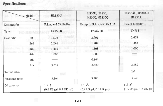

The 620 used the L16, L18 and L20. They have the same bolt patern and bolt position as the L28. It will bolt in, but first gear will be very low.
I think the 620 has a 1st : 3.592:1
280Z 1st : 3.321:1
280ZX 1st : 3.062: 1
Did you get one to try? They are geared pretty tall.

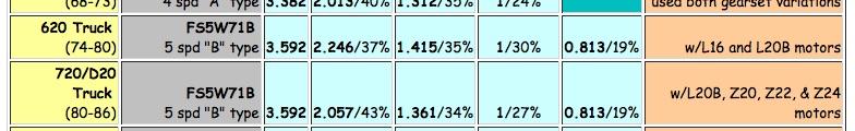

Here is some more info on the different transmissions.
http://datsunworld.blogspot.com/2016/03/datsun-l-series-transmission.html

Looks like the 620 has the 240Z ratios, doesn't it?  Better measure the length.  It might be shorter.
