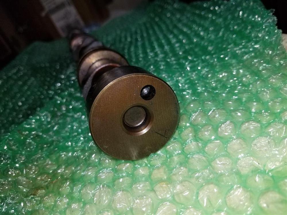

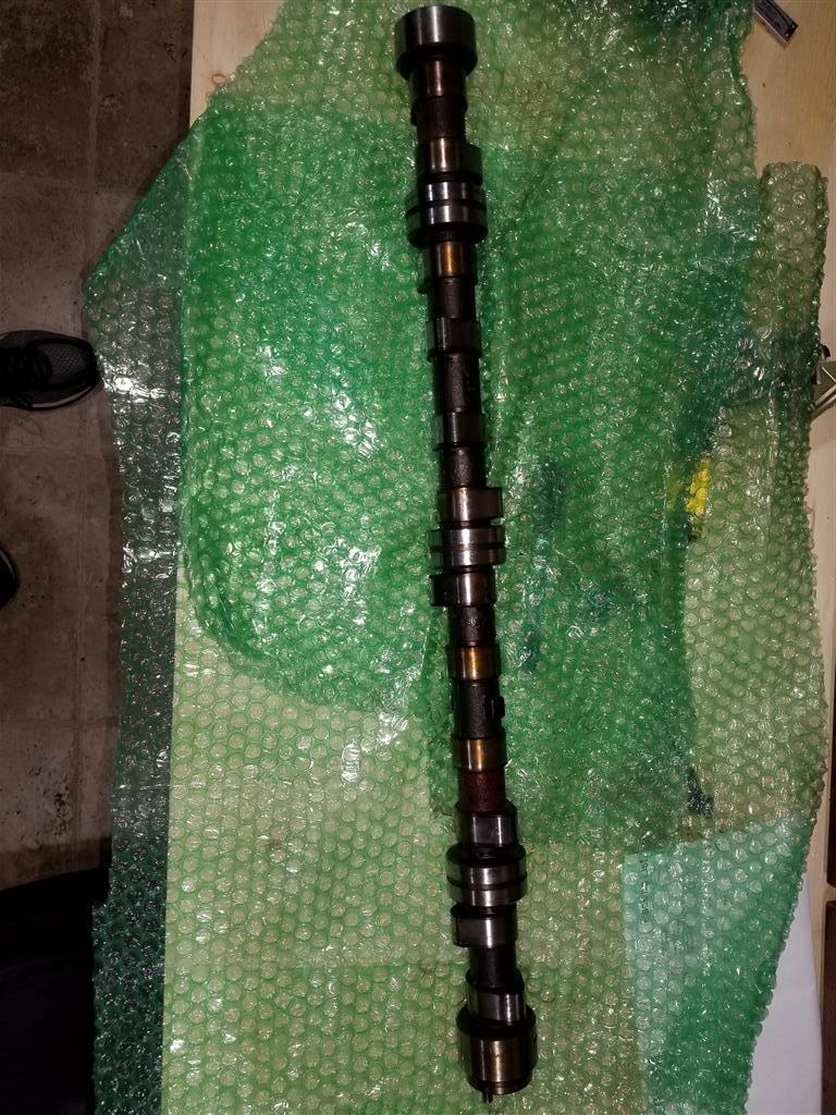

@Captain ObviousI have an A cam that I think was from an N47. I acquired it by itself without a head at some point though. It has oil holes in the lobes. Lobes are clean as are bearing surfaces. 2nd lobe from sprocket measures appx 1.585 which is the same as a low mileage n42 A cam I have on a head that I know has never been rebuilt, nor cam cut. So, if your cam is uncut and you have original lash pads, should slide right in...assuming you are able to sort out the cam tower mounting mess.
If you would like to have this cam, message me with your address and I will ship it to you.
See two photos.

Wowsers!! Yes, that's exactly what I have now. Both pieces. Haha!!
I measured my lobes at 1.585, so the same as what you have there. I'd love to have it! Thank you so much for the offer!!
PM on it's way!    :beer:

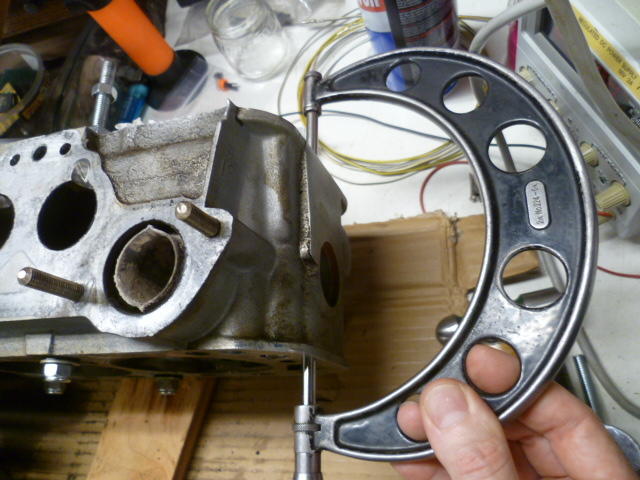

I cleaned off the measuring surfaces and even broke out the big guns. More accurate than the springy calipers for things like this. I don't know the last time this ol' girl saw the light of day, but she's still got it where it counts:
Installed the correct anvil, checked her against the measurement standard rod, and then rechecked the head. I get the same thing I got before. About 4.254 inches or about 108 mm.
So I don't know if they changed the head thickness over the years, or if yours has been cut.
