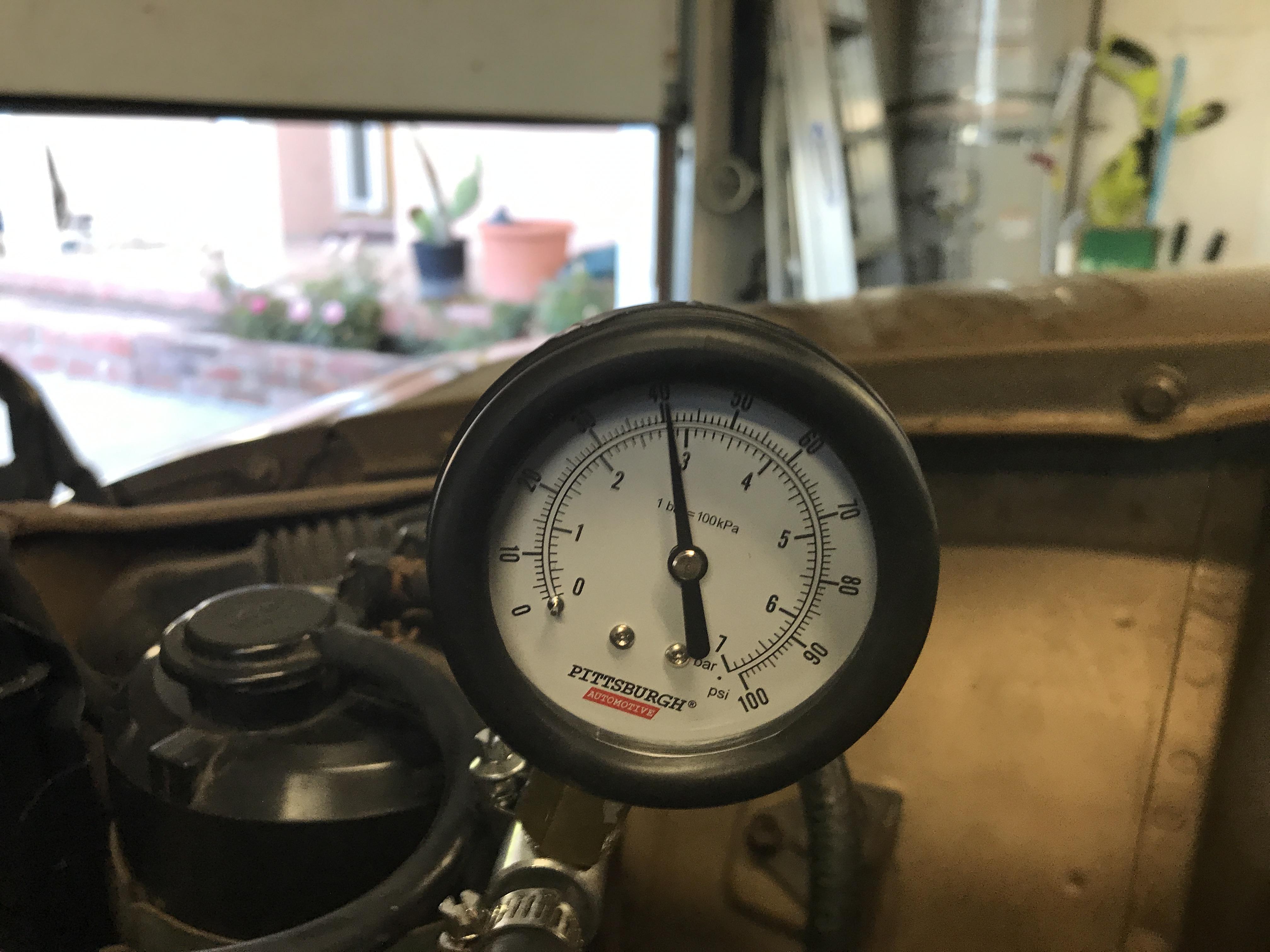

2). Fuel pressure reading while the engine is running = 41 psi (see photo 2) [PRESSURE UP]

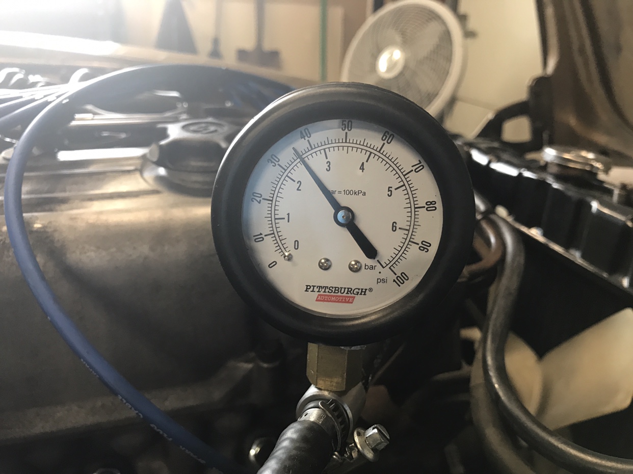

3). Fuel Pressure with FPR Vac. line disconnected = 44.5 psi (see photo 3) [PRESSURE UP]

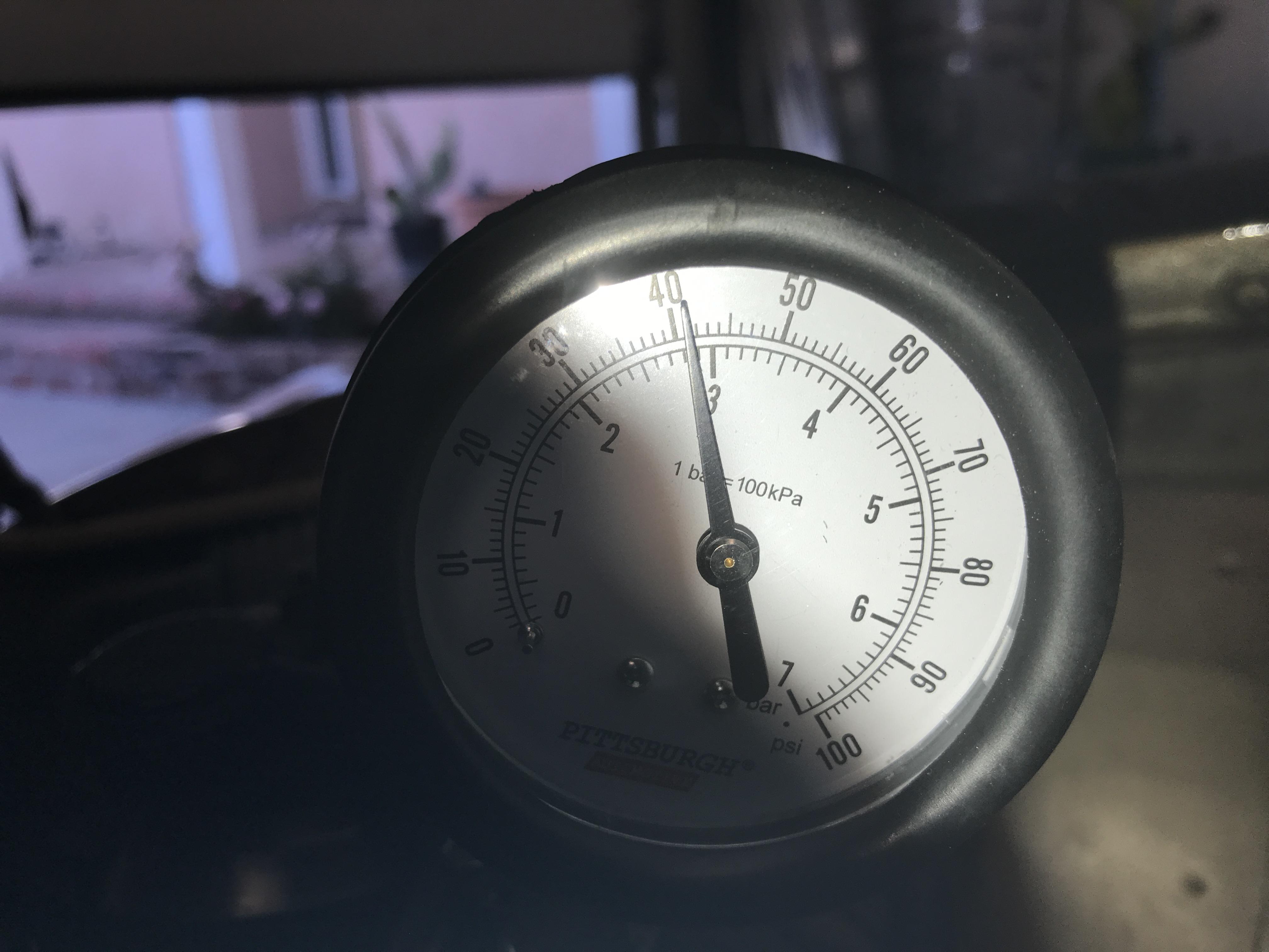

4). Fuel Pressure while Sucking on the vacuum hose from the FPR = 40 psi (see photo 4 & video) [PRESSURE DOWN]

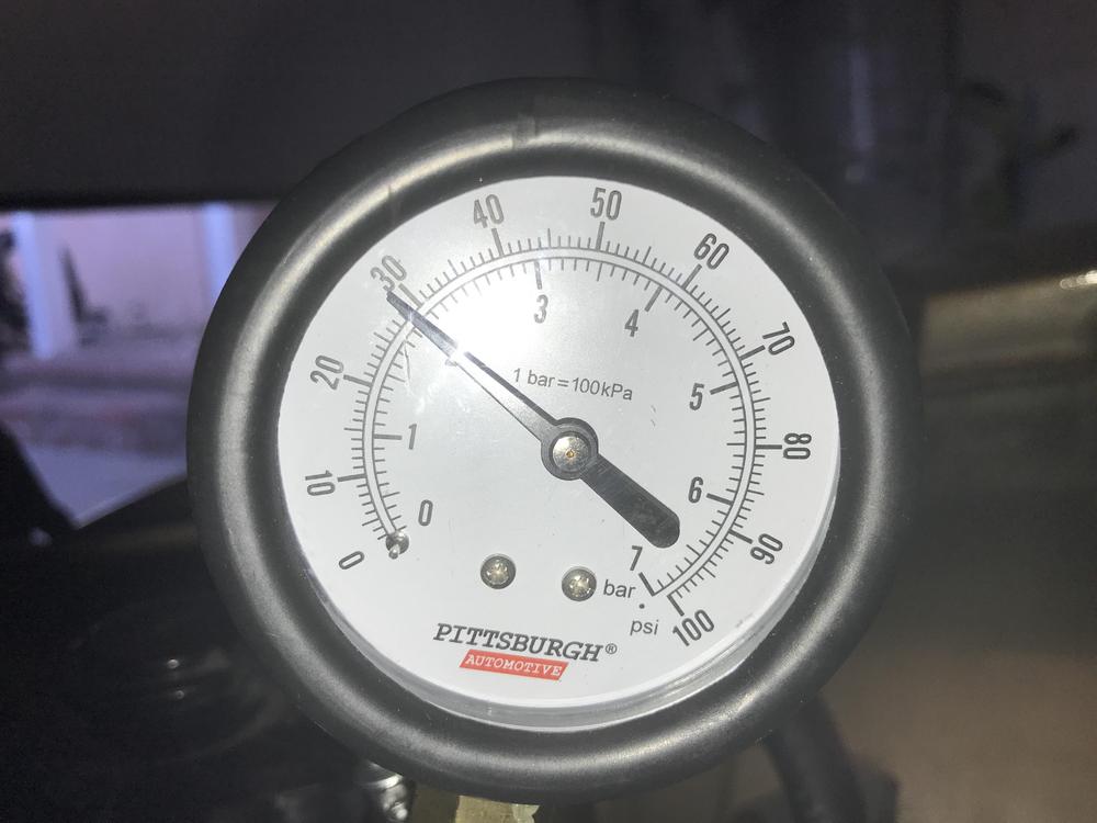

5). Fuel Pressure while Blowing on the vacuum hose from the FPR = 44.5 psi (see photo 5) [PRESSURE UP / NC]

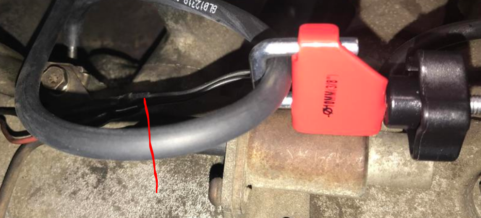

If so, do you think this rig will work to quickly check fuel pressure with vac and without vac? (see photo)
Where the VAC is open (or ON) if the hose clamp is open and the VAC is closed (or OFF), if the hose clamp is closed.
If you cut the line where I marked and have some sort of connector it would work.  But the clamp alone won't work because there will be vacuum inside the FPR.  You have to release that vacuum.
So, you'd clamp the hose, then release the vacuum.  That would close the potential vacuum leak, but let the FPR vacuum out.
You could also put a T fitting in the cut section and block the third connection.
