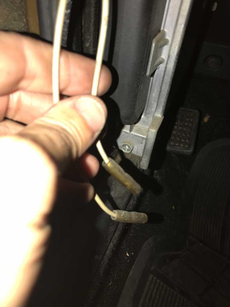

OK so I just took the kick panel off the ECU so I could tap on it and I found these 2 white wires just hanging there. (see photo)
Any idea what these are for and if they are supposed to be connected to something (or each other)?

Also, see photo above regarding 2 white wires found unattached behind the ECU kick panel.
Any thoughts on what they are and if they should be attached to something??

The white wires are for testing.  They just sit there, doing nothing.

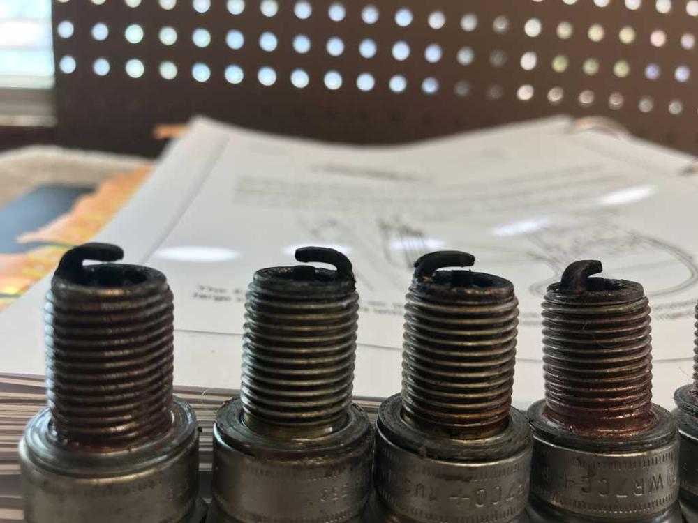

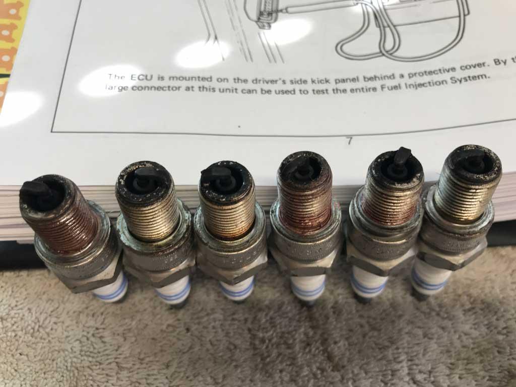

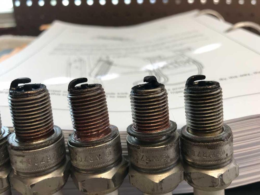

See old spark plugs in attached photos. They all look the same. Black, not wet, a bit worn out.
Those are fuel fouled for sure. You need to test fuel pressure . Then start checking all connections. Read the EFI BIBLE , and get your multimeter out.

Plugs clearly so rich, OR are the an incorrect heat range, guessing rich.
common thing causing rich
  • incorrect fuel pressure (too high), defective FPR could even be leaking raw gas into the manifold.
  • defective or incorrectly connected water temp sensor
  • Leaking injectors/stuck injector/defective cold start system (injector or thermotime switch).
  • AFM, if been prior monkeyed with, a common thing as its just too tempting to go mess with it.
  • ECU (diagnostics are if everything else is ok, then its got to be the ECU, but you really really need to eliminate everything else).
as a start, fuel pressure, then listen to injectors to make sure they are all clicking, then pull the cold start and make sure its working properly. I will not go into the specifics that is what the FSM is for on how to test all the systems.
