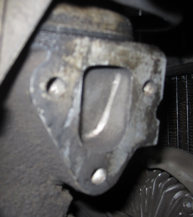

You have the mechanical fuel pump mounts, for carb'ed engines, along with the self-oiling camshaft that came in about 1977 in the US market.  Here's a picture of the boss for the pump, but unmachined, on a 1978 US market engine.  A snip from your picture follows.

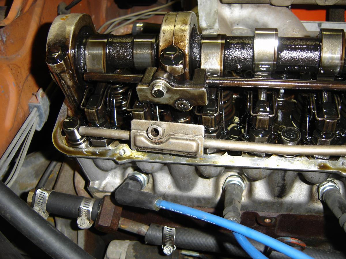

Here's a shot of my E88 with the early spray bar attached and the newer design laying beside it.  The newer one came off an N42 head that was changed to a newer oiler cam.  This was a common upgrade from all I've read.  Those spray bars a problematic and should be checked often, like every oil change for my 240.
240 spray bars...
280 with a oiler cam...

Correct. Your version of your head and the cam does not require the oiler bar.

Make sure the cam tower's oil holes on the side are blocked off (in case they are the early type for an oil bar).
The cam towers look to be the early type. You can see the bolts just sticking out. Someone may have been running both the internally oiled cam and the spray bar. You need to block off the cam tower spray bar locations. Also on start up you need to verify that the cam is oiling. Don't assume it feeds oil out all the holes, verify!

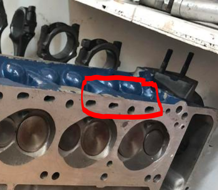

So it sounds like the mechanic was was right or partially right.  If you look even more closely at the head it looks like it's been shaved, the combustion chambers aren't round.  It might not be a typical "L28" head.  Maybe an E88,which was a popular head for modifying, with a cam swap to a later self-oiling cam.  The cam towers might already be blocked off if it's been running after it was rebuilt.
Look at the bottom edge of the head right about where I circled in the picture below and you should see a letter and two numbers cast in to the head.  E88 or N42 are most likely.
