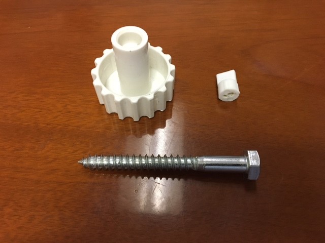

Very nice home made adjuster, lapriser.  This actually reminds me that last year I told Joseph that I would post the easy & cheap long neck adjuster tool that folks have made over the years.
If you look at the bottom of the KONI supplied adjuster knob, you will see that the tip with the elongated adjuster slot is actually an insert into the end of the adjuster knob.  There are actually two different KONI adjuster tab sizes so we have two different inserts depending upon what tab size is used for your application. Although a somewhat tight slip fit, you can remove your insert easily by taking something like a largish wood screw that will bite into the plastic enough to pull the insert out.  Be carefully not to deform the intentionally soft plastic of the slot too much.  Now you can glue or epoxy (anything hardening really that will fill the voids) that insert into the end of either a screwdriver-like nut driver tool or into a small 1/4" drive socket that you can turn with a 1/4" drive screwdriver-like handle. I bet you probably have an old one at the back of your toolbox that you never use.  I don't recall the exact size nut driver or socket needed to fit it into but it is somewhere less than 1/2" or 12 mm size (maybe 10-11 mm or 3/8"-7/16'" range?).  If you don't have these tools at home, they can be had for cheap at Harbor Freight, some brand X tool kit, etc.  No need to spend Snap-On or Mac Tool levels of money on something that could be had cheaply or you likely already have and don't use.  There is a good chance you can make this tool with a screw, a hand tool and glue that is already in your garage and not have to spend any money or more than 10 minutes time.
Although you could make your adjustments turn the socket with 1/4" drive ratchet and small short extension, I really suggest using the screwdriver type handle and not a ratchet to reduce the leverage and remove the tendency to over torque/over tighten the KONI adjuster tab and snap it off.  The small diameter of the screwdriver handle makes is easy to toss in the glovebox or toolbox for quick adjustments with the twist of a wrist without overtightening.  Easy-peasy.
