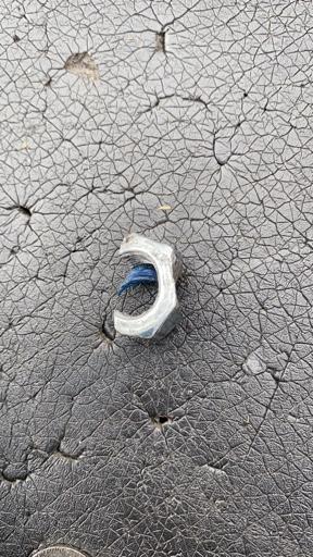

You won’t be disappointed! Just a heads up on the locknut that comes with them, while installing mine, I decided to undo one side to have a second look and on the way up, it started to get stiffer and stiffer until it welded itself on!!! I had to grind off a part of it on the flat side of the damper shaft with a dremel and chisel it off!!!
Being a stainless steel nyloc nut, it produces a lot of heat if turned quickly as I did (by hand) and produces some galvanic reaction of sorts. Moral of the story? Go slow or ditch the lock nuts for something better.
Stainless Ny-locs are a dangerous thing, especially if you aren't aware of the issues. Stainless is prone to galling and that's exactly what happened to you.\
If they ran a stainless nyloc onto a stainless shaft, they were asking... No, wait...  BEGGING for trouble.

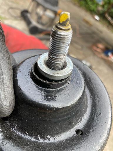

The “galling” cost me 5 hours for a 5 min job!!!!!! So it’s really worth heeding the warning. Had to go really carefully with the dremel to avoid creating too much heat; regularly cooling it gently and avoiding potential damage to any seals. Also once the shaft and nut are in the strut hat / cap thing, there is diddly squat room to get anything in there.

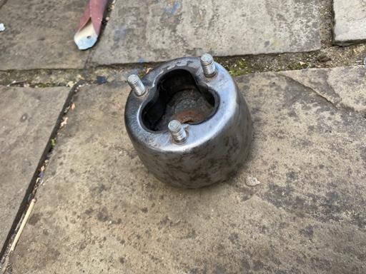

This is what I call the strut cap / hat thing - which I had buy another of and take back to bare metal / de-rust / treat and paint with chassis paint!

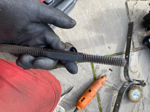

I tried to recover the threads with a thread file, but to no avail as zooming in showed me how the galling had eaten away some of the thread. A fat 5mm washer was employed to use the undamaged threads above it. Not ideal, but it worked well.

You’re not kidding! My language was definitely not family friendly and I had to walk away from it for a day or two. The thread is metric fine, so beware you don’t end up forcing metric coarse threads onto it.
This is what I used in the end which is consequently the same size as the ones on the compression rods, moustache bar, diff insulator’s long bolts etc. They were also on my previous shock absorbers.

Yup. That's typical galling. Here's some links that talk about such things. Some of these even specifically call out stainless nyloc nuts:
https://www.boltdepot.com/fastener-information/Materials-and-Grades/Thread-galling.aspx
https://www.anzor.com.au/blog/what-is-stainless-galling
https://www.westfieldfasteners.co.uk/Ref_Thread_Galling.html
The bottom line is usually... Use lots of lube and go slow. And even then, don't do stainless Nyloc on stainless threads unless you're an expert. Now I don't know if Koni's damper shaft is stainless, but it might be. Did they supply the stainless Nyloc nuts with the dampers? All those parts were in the same box?  Seems they would know about the risks. Especially by now.
