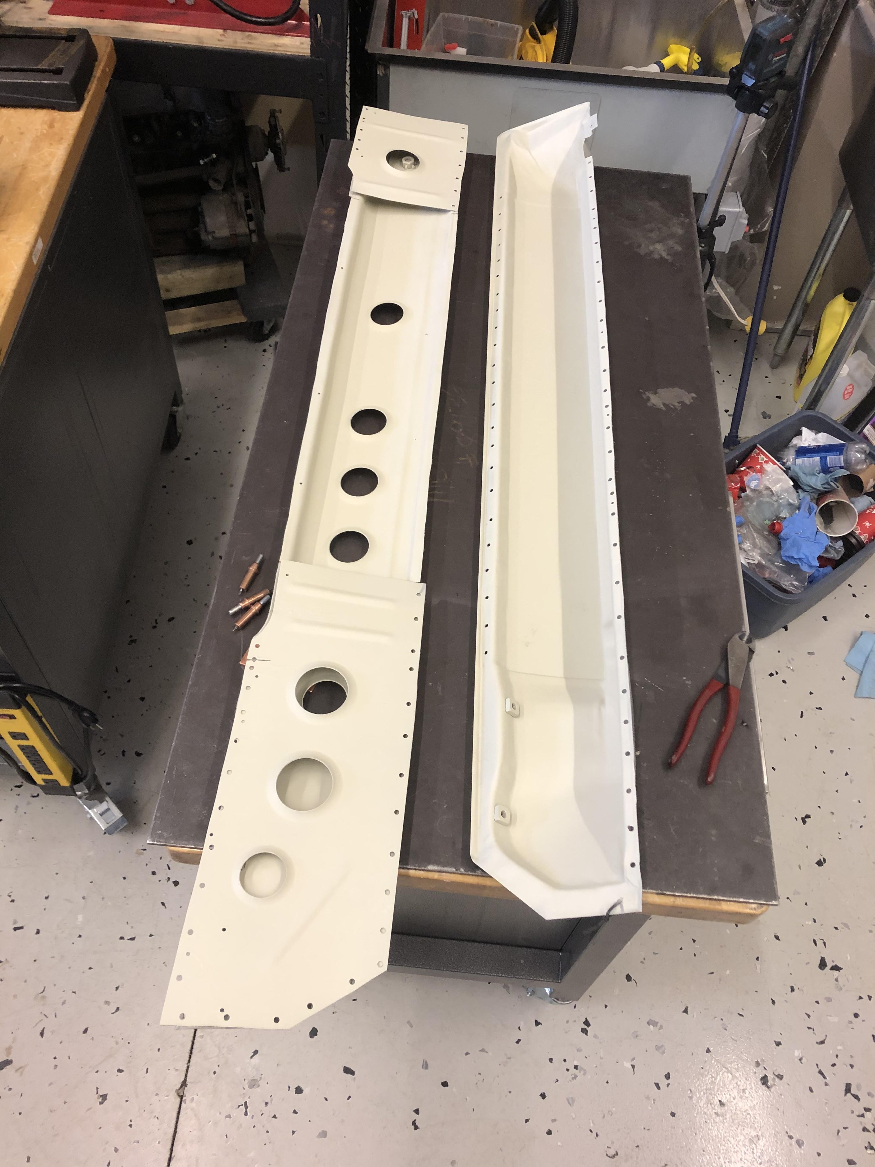

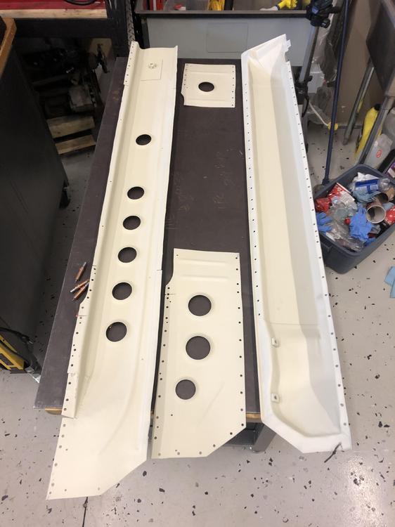

Got a chance to test the painting in the prep booth with some rattle can 2k epoxy primer....
It worked great .  You can see where the overspray got drawn into the filters ....
Parts came out fine ... welding them in tomorrow hopefully....
Rattle can epoxy primer is ridiculously expensive though.  $23 and that took the whole can ...so definitely a laziness tax included in the price.
Yup, I got suckered into buying a can too. What a waste....
HVLP guns are so easy to use and the results are better. Can't wait to see this project move into high gear!
